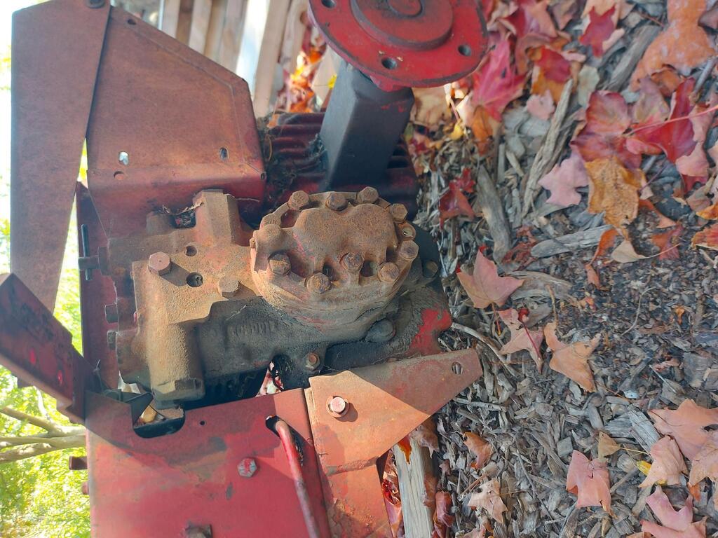

Camdenlake 1 #9 Posted September 1, 2024 7 minutes ago, squonk said: All of the linkage will need to be swapped over. If the 518 has hyd. lift and the C 120 does not, you will need parts from a hyd lift trans Sunstrand to work and maybe the arm that hooks to the rockshaft that the lift cylinder actuates Mine is manual and the parts unit also appears manual to my eye but what do I know lol. Pic attached. Share this post Link to post Share on other sites
squonk 48,427 #10 Posted September 1, 2024 That looks like an older Sunstrand Hydrogear Transmission Share this post Link to post Share on other sites

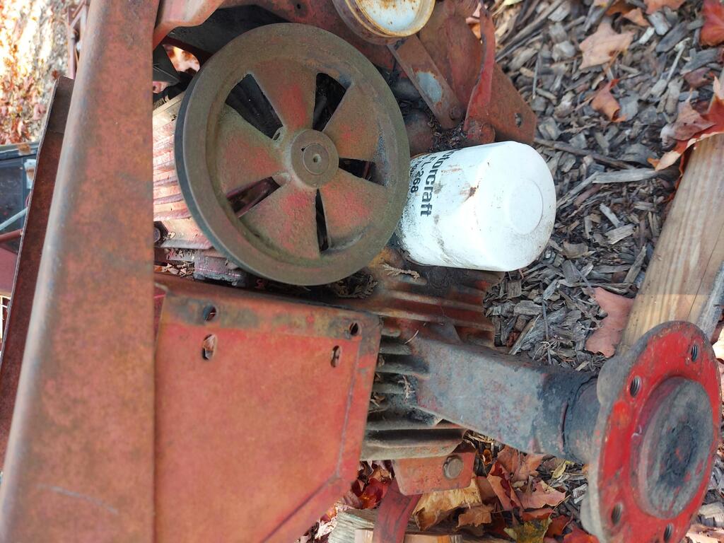

oliver2-44 11,847 #15 Posted September 2, 2024 5 hours ago, Camdenlake said: The transaxle looks like it needs the axle seals replace as a minimum. Check if the axle hubs move up/down or side to side any. Any more that a tiny tiny bit of movement indicates the axle bearings need to be replaced. This is not a terrible complicated job. 1 Share this post Link to post Share on other sites
