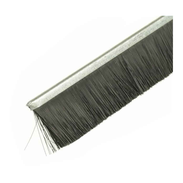

sjoemie himself 3,106 #5 Posted August 14, 2024 21 hours ago, pfrederi said: brush hanging on the choke knob... reach around occasionally and sweep it off. Rubber strip on the deck is pretty good IMHO. Your brush gave me an idea, maybe attach a bristle strip over the screen to automatically brush debris off? 1 Share this post Link to post Share on other sites

johnnymag3 2,646 #10 Posted August 15, 2024 The fixed brush idea will only keep debris off of the visible surface of the screen....it is still going to be sucked in and guided over the top of the engine and the head cooling fins as designed. The block off in front of the mower deck is a better idea. Blow out debris after each mow to keep overheating problems away, and I like the hanging brush idea ...especially if you are mowing for long periods. The increased airflow is beneficial whenever that engine is running! 1 Share this post Link to post Share on other sites
