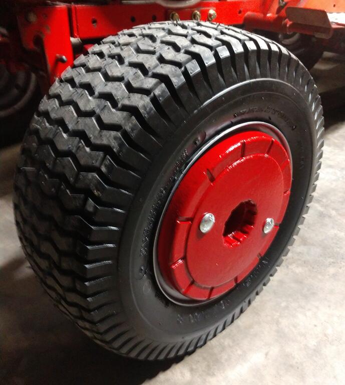

Moparfanforever 940 #1 Posted August 9, 2024 Tried fitting a pair of front wheel weights on a 520 and they hit the lip of the bearing cover ,so no go. I guess there are front weights made for a 520?? Has anyone modified regular front weights to work on a 520?? Thanks!!! 1 Share this post Link to post Share on other sites

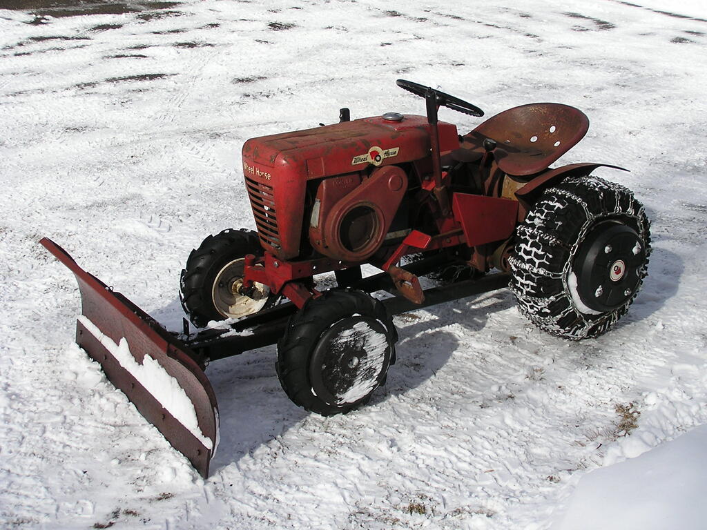

ebinmaine 80,911 #8 Posted August 9, 2024 11 minutes ago, Moparfanforever said: No nasty thorns that I am aware of, but knowing my luck, if they are there , I would find them!! I have many back tires filled, I may fill the front tires. I would think WH would have made a set of front weights for the 520 ?? On my snowplow horses I use oversized and fluid filled tires up front to help with steering. Not sure of your intended usages... a larger tire obviously will hold more fluid. We have no 520s so we're unfamiliar with them. @JCM any thoughts? Share this post Link to post Share on other sites

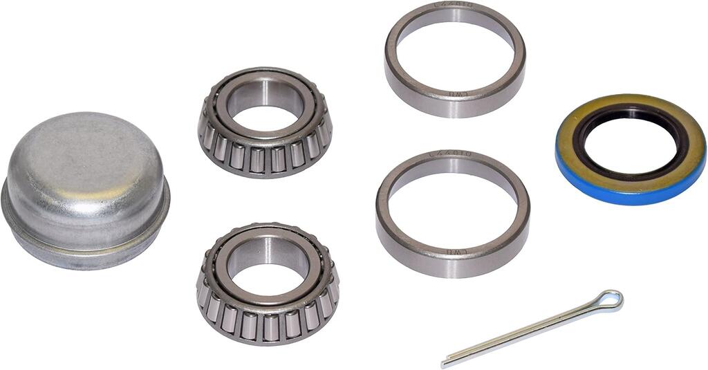

Moparfanforever 940 #9 Posted August 9, 2024 @peter lena,all good ideas, but 520's have a tapered bearing on the outside with a castle nut. I did clean and repack and new slimey grease, you would be proud !! Although I do frequently, I hate greasing things. No matter how careful I am, I seem to get just as much grease on me as the tractor. 1 Share this post Link to post Share on other sites

ri702bill 13,189 #12 Posted August 9, 2024 (edited) 37 minutes ago, Moparfanforever said: That would work, but there would be a gap between the weight and the wheel. Not sure I could live with looking at the that all the time. Size the length to be as short as practical to get the weights up close to the rims?? I have made my own front weights out of used barbell weghts. Thet do come in 2 different center hole sizes.... for roughly 40% of what OE ones cost used - if you can find them..... these sit centered on the outer rim lip edges. Edited August 9, 2024 by ri702bill Share this post Link to post Share on other sites
lynnmor 9,050 #13 Posted August 9, 2024 38 minutes ago, Moparfanforever said: @peter lena,all good ideas, but 520's have a tapered bearing on the outside with a castle nut. I did clean and repack and new slimey grease, you would be proud !! Although I do frequently, I hate greasing things. No matter how careful I am, I seem to get just as much grease on me as the tractor. While you are greasy is a good time to pull the spindles out of the axles and check the roller thrust bearings and clean that mess. I am in the process of replacing mine right now and found one side with bad rollers. Wheel Horse used 1/16" flat thrust washers on each side of the rollers, be aware that they are hard to find now, McMaster was my goto place but they, and most places, only carry 1/32" and 1/8" now. I use the old ones on top of the axle to block some dirt from entering. The previous owner used thick moly grease and that hardened into mud causing much of the damage, use only a free flowing grease and use it often. The hub has a grease fitting but you would need to pump a considerable amount in it before the bearings were lubed and then you risk popping the seal, yes the PO had the seal popped. I will have a fresh front end with new tires, wheel bearings and thrust bearings when complete. I was able to buy everything on the jungle site. A 1" trailer axle kit will fit a 520H tractor. Share this post Link to post Share on other sites

gwest_ca-(File Mod) 12,508 #15 Posted August 9, 2024 Optional front wheel weights for the 520 were 8-1213 and 8-1214. Sometimes written as 81213 and 81214. The front wheel weights are listed as 8-1214 8" rear wheel weights so suspect it was also used on smaller tractors at the rear. The front frame weight was also an option. 1 Share this post Link to post Share on other sites

Thor27 892 #17 Posted August 11, 2024 On 8/9/2024 at 9:42 AM, gwest_ca said: Optional front wheel weights for the 520 were 8-1213 and 8-1214. Sometimes written as 81213 and 81214. The front wheel weights are listed as 8-1214 8" rear wheel weights so suspect it was also used on smaller tractors at the rear. Also experienced this with the genuine horse weights, you would need to open up the bore of the weight by 3/16". 1 1 Share this post Link to post Share on other sites
Moparfanforever 940 #18 Posted August 11, 2024 7 hours ago, Thor27 said: Also experienced this with the genuine horse weights, you would need to open up the bore of the weight by 3/16". @Thor27 Did you by chance modify some weights to fit?? I guess it would be best to have the bore opened up on a lathe. Share this post Link to post Share on other sites
Thor27 892 #19 Posted August 13, 2024 (edited) No, I didn't, at least not yet. A lathe or a mill with a turntable. Edited August 13, 2024 by Thor27 Share this post Link to post Share on other sites
