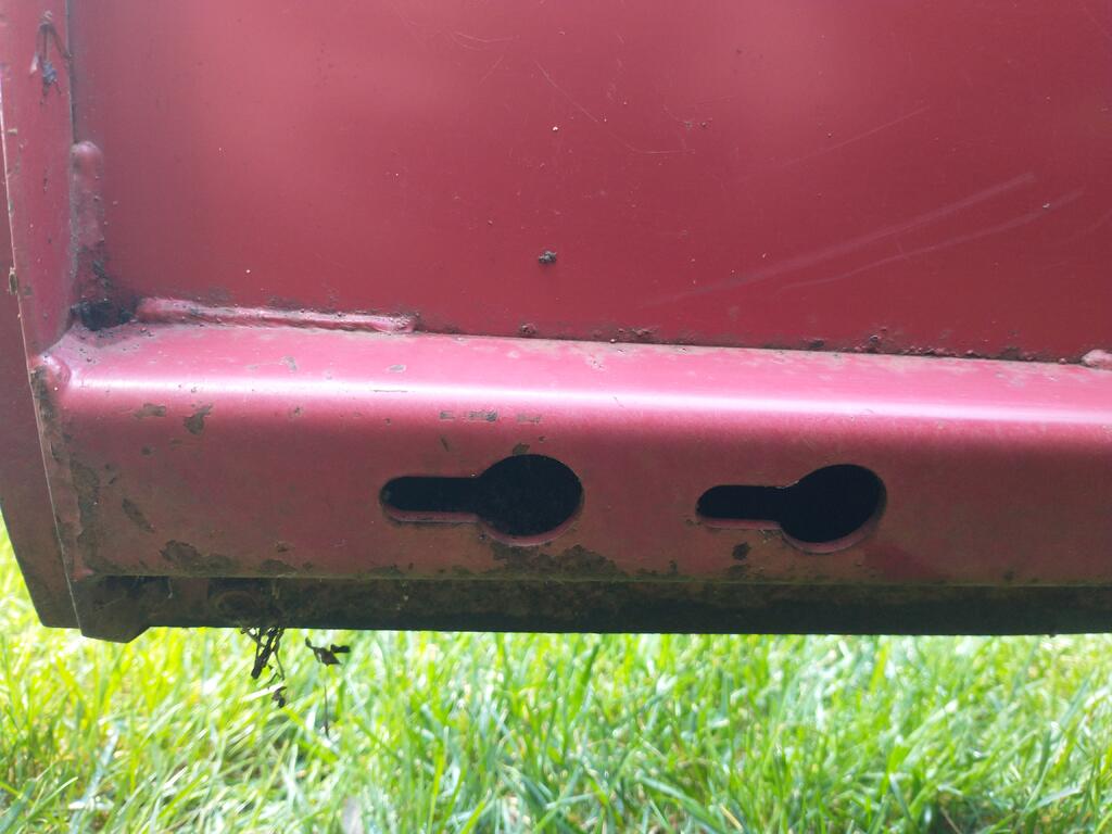

rmaynard 17,409 #1 Posted August 1, 2024 I have a model 79350, 48" snow plow on my 1996 416-H. However, I've never noticed these keyhole type holes in the bottom reinforcement bar on the bottom of the backside of the blade until today. I am curious what they are for. 1 Share this post Link to post Share on other sites
ebinmaine 79,524 #2 Posted August 1, 2024 If there is a set like that near both ends of the plow, those are for mounting shoes or plow feet if you like. 3 Share this post Link to post Share on other sites
c-series don 12,053 #3 Posted August 1, 2024 I agree with Eric, but other than the old style mushroom skids I haven’t seen factory ones that bolt in there? 1 Share this post Link to post Share on other sites

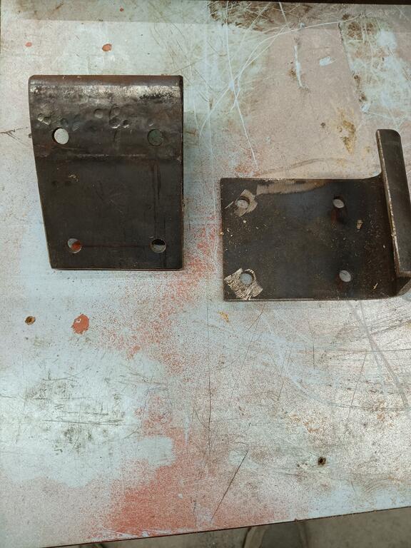

ri702bill 12,401 #8 Posted August 1, 2024 2 hours ago, ebinmaine said: If there is a set like that near both ends of the plow, those are for mounting shoes or plow feet if you like. Yup...I got a set with my 79350 plow, but welded 3/8" thick wear pads to the undersides. IF noone else posts a pocture of the OE ones, I can post one a bit later of mine... Share this post Link to post Share on other sites

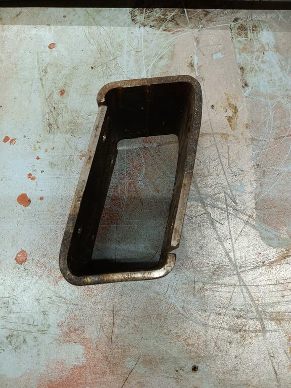

ebinmaine 79,524 #10 Posted August 1, 2024 Here's the aftermarket set I have. The part that touches the ground is 3" x 4" They're made of a hunk of 4 x 6 rectangle tube steel cut at the corners and heated and bent to the angle. Share this post Link to post Share on other sites

rmaynard 17,409 #16 Posted August 1, 2024 Only difference is my slots go horizontal, those are vertical, but that appears to be the answer. Thanks 1 Share this post Link to post Share on other sites

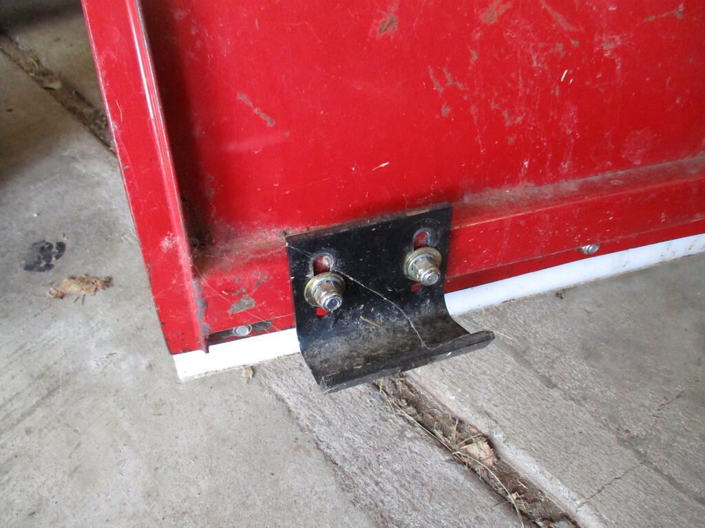

pfrederi 20,828 #21 Posted August 4, 2024 Official $70 skids 2 Share this post Link to post Share on other sites
rmaynard 17,409 #22 Posted August 4, 2024 2 hours ago, pfrederi said: Official $70 skids Cool. Thanks for the picture. 1 Share this post Link to post Share on other sites
