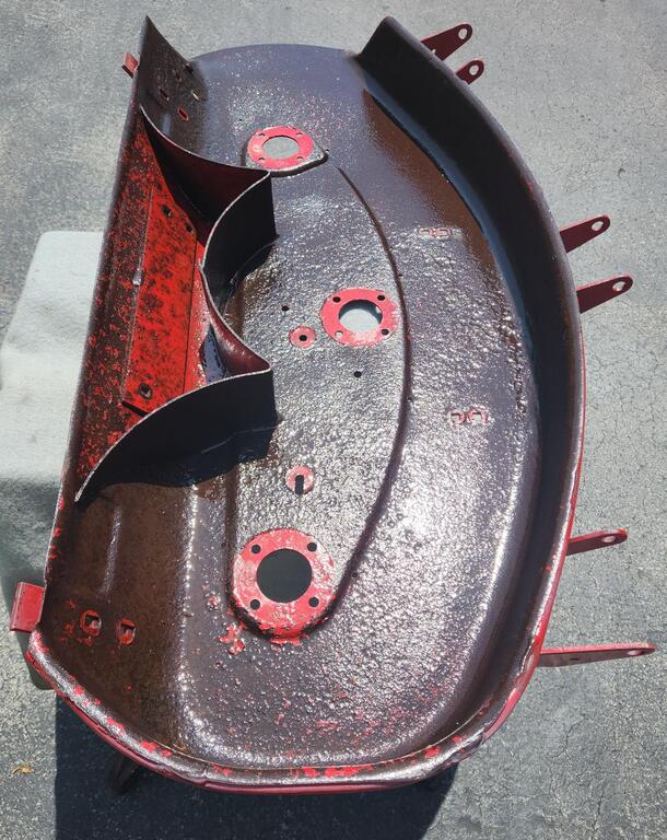

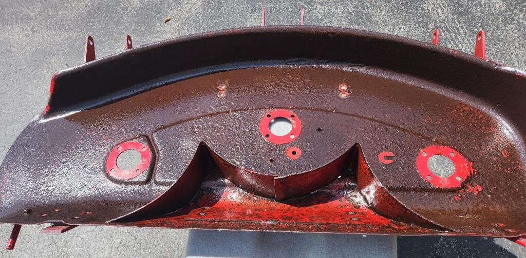

Brockport Bill 2,553 #1 Posted July 18, 2024 Pete and others on here advocate an "oil treatment" for underneath the mower decks for preservation purposes - i am currently doing a deck rehab -- i have typically cleaned rust off to bare metal by either having deck sand blasted... or by using 90 degree grinder disc to "sand" off rust -- then primed and painted. However, i recently got a deck that was in solid condition - no rust through holes, no fractures, or damage, with just modest rust underneath -- so i am trying the oil sun baking treatment to rehab the bottom of deck -- Pete has previously suggested baking in sun for "absorbtion" into metal . I was wondering others experience with this strategy but also... specifically.... how long in the sun to bake the oil -- and is one treatment adequate or multiple? thanks 3 Share this post Link to post Share on other sites
peter lena 10,125 #2 Posted July 18, 2024 @Brockport Bill thanks for the shout , do a 2 step treatment , ist is a lighter chain/ cable spray , 3/4 hours in direct sun , deck is hot , to touch , then an over spray with open gear spray , that will really tack up / start to seal , dry to touch . your very good base cleaning is vital , for a baked on finish . also the bare metal , will hang on to heavier oil better . as a dried seal coating , I also do my spindles and blades , in the fall , maybe a light touch up , mine is usually intact , no damage . that 2 step lube finish is on my decks for years , zero rust / rot , regularly mirror look under decks . when decks are propped up to wall in fall , touch up blades , and open gear spray . that solid deck you got , was the perfect specimen to do this on , been doing this for years , it stands up , probably the most important stage , is stop the , GRUNGE CYCLE , that will verify / show the difference . this works , pete Share this post Link to post Share on other sites

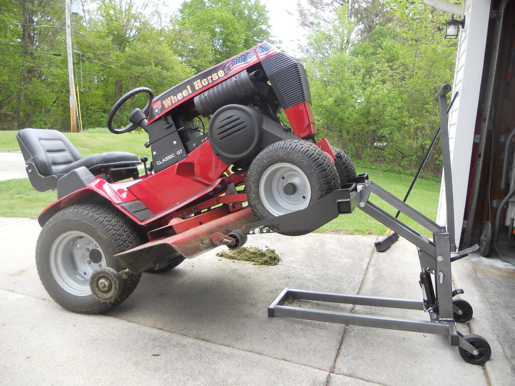

lynnmor 9,081 #7 Posted July 19, 2024 59 minutes ago, Racinbob said: I do give the decks a quick light coat of whatever oil I have handy in the fall when I put them to bed for the winter but that's it. I guess it just makes me feel better not leaving the bare metal exposed all winter. Totally agree with your post, the only difference is that I use Fluid Film for long term storage since it won't drip after it sets up and it penetrates around bolts. Now about that jack, I had one that wasn't up to lifting my 520's, the bottom mount for the hydraulic cylinder cracked and bent to the ground, be careful with the thing. 3 Share this post Link to post Share on other sites
peter lena 10,125 #8 Posted July 19, 2024 @C-85 many years ago , started using , LUBRIPLATE , CHAIN / CABLE SPRAY , as initial base lubricant , then after tacking up , semi drying , would over coat with , lubriplate , open gear spray , my 3 decks are stained black underside , none of it wears off . but today , pricing is nuts , similar NAPA , MACS open gear and also chain / cable spray , is about 8-9 $ , a can , the pictures of my deck underside , is how they always look , check them out for anything , correct . also give them a touch up at season end , and wall eye bolt spring held in place , bottom side out , for status check . BTW , every seam , joint , related underside of cars , joint oil slick in every area , doors , trunk , hood . zero rust / rot . have my C-85 , 42 years , no rust, rot , regularly gets a lubrication based , go over , paint buffs out clean / deep . go oily , pete 1 Share this post Link to post Share on other sites
Racinbob 13,290 #9 Posted July 19, 2024 10 hours ago, lynnmor said: Totally agree with your post, the only difference is that I use Fluid Film for long term storage since it won't drip after it sets up and it penetrates around bolts. Now about that jack, I had one that wasn't up to lifting my 520's, the bottom mount for the hydraulic cylinder cracked and bent to the ground, be careful with the thing. I may try that Fluid Film. Never used it. I do keep tabs on the lift as well as making sure the two safety pins are engaged Share this post Link to post Share on other sites
