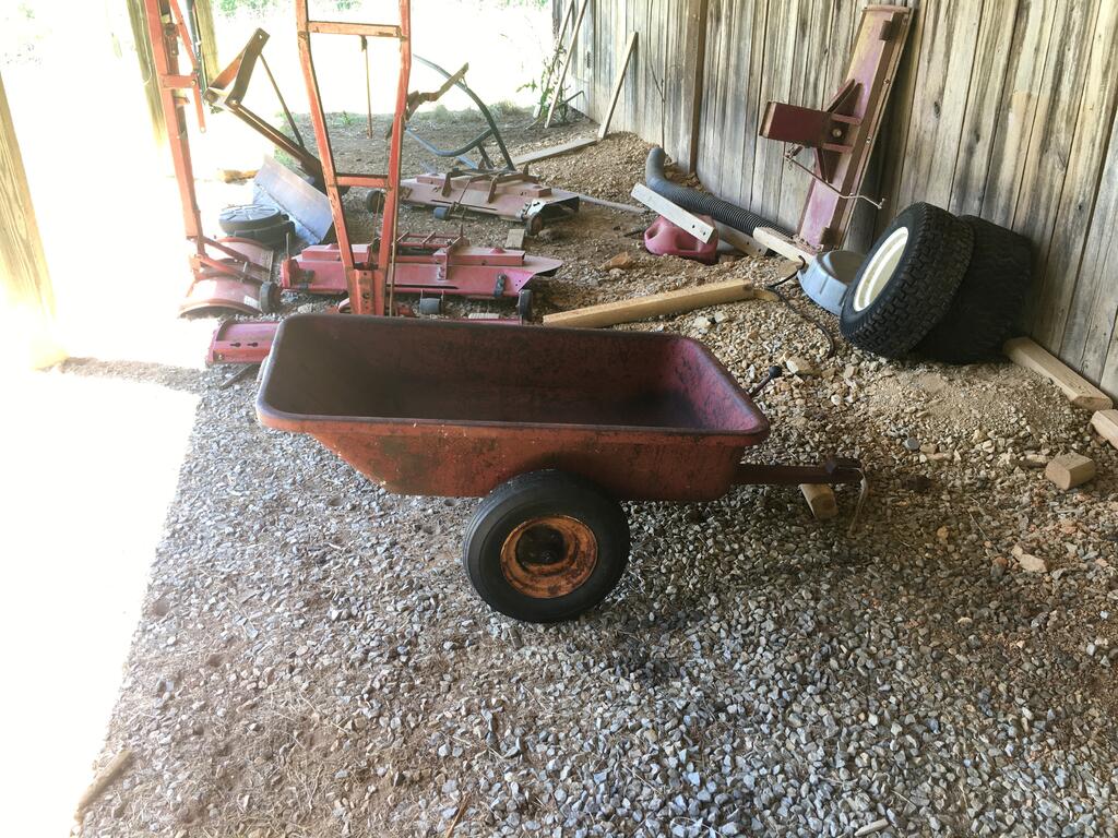

sqrlgtr 4,225 #1 Posted July 1, 2024 Just wanted to give a big thanks to Docwheelhorse for the cart, cafoose for hauling and handling transaction and Pullstart for letting cafoose know I was needing help with transportation. Finally home but worth the wait plus me and cafoose even done a little “horse trading” when he finally came home lol.. 6 7 1 Share this post Link to post Share on other sites
