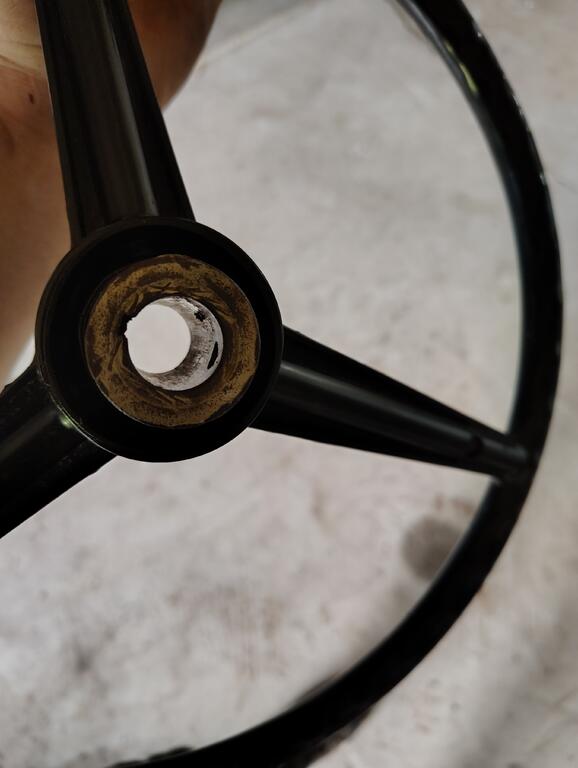

AlexR 3,084 #127 Posted August 11, 2025 1 hour ago, SylvanLakeWH said: Thinking about it, got a 6 pound sledge.. But also don't want to risk damaging the steering wheel. 2 Share this post Link to post Share on other sites
ebinmaine 80,468 #128 Posted August 11, 2025 8 hours ago, AlexR said: Thinking about it, got a 6 pound sledge.. But also don't want to risk damaging the steering wheel. The slow motion of a press would probably be better. 1 Share this post Link to post Share on other sites

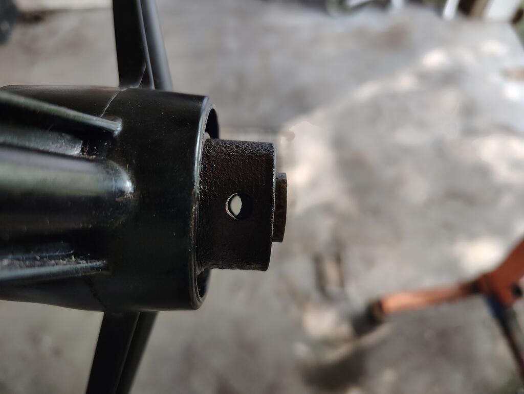

AlexR 3,084 #133 Posted August 12, 2025 Cut the shaft hit on it some more and got it to move again. And then it didn't move anymore either way. So took it over to the neighbors press and boy was it tight it took a ton of pressure to get it loose including having to push it back and forth a couple times. Hood ornament is cracked but if you have seen either of my other two tractors you will know that is not staying on anyway. Guess what's under the hood ornament that has never come off.. a hood stripe!!!! I was planning on putting one on anyway but it's cool to see it originally had one. Got some plans for the headlight and lens situation. 1 3 Share this post Link to post Share on other sites
ebinmaine 80,468 #134 Posted August 12, 2025 Victory! 1 Share this post Link to post Share on other sites

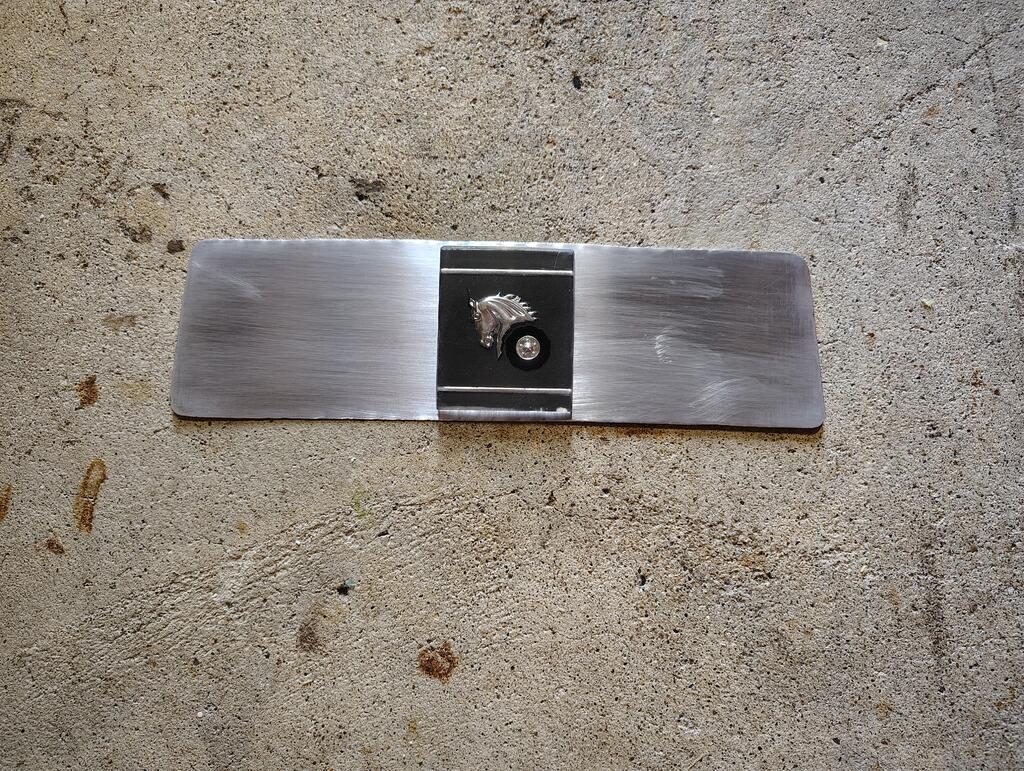

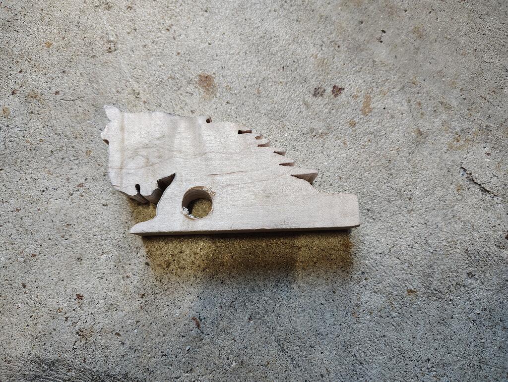

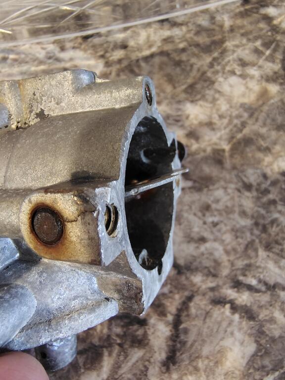

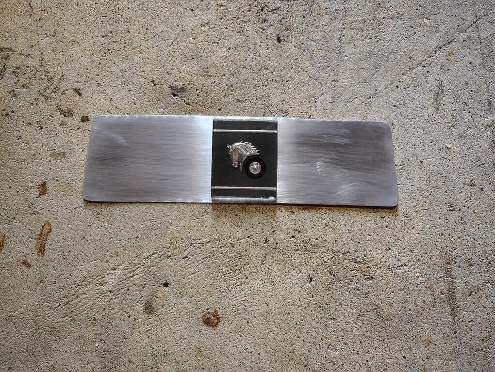

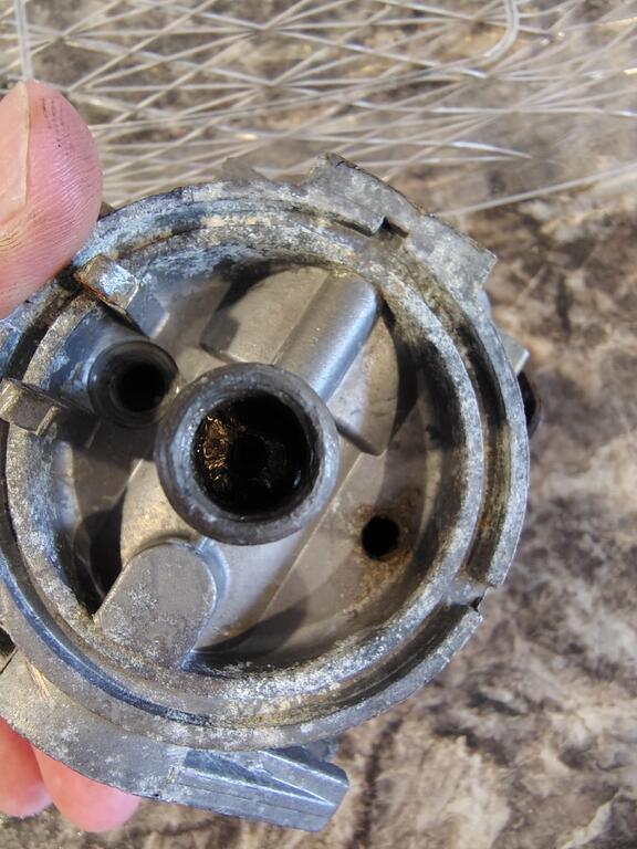

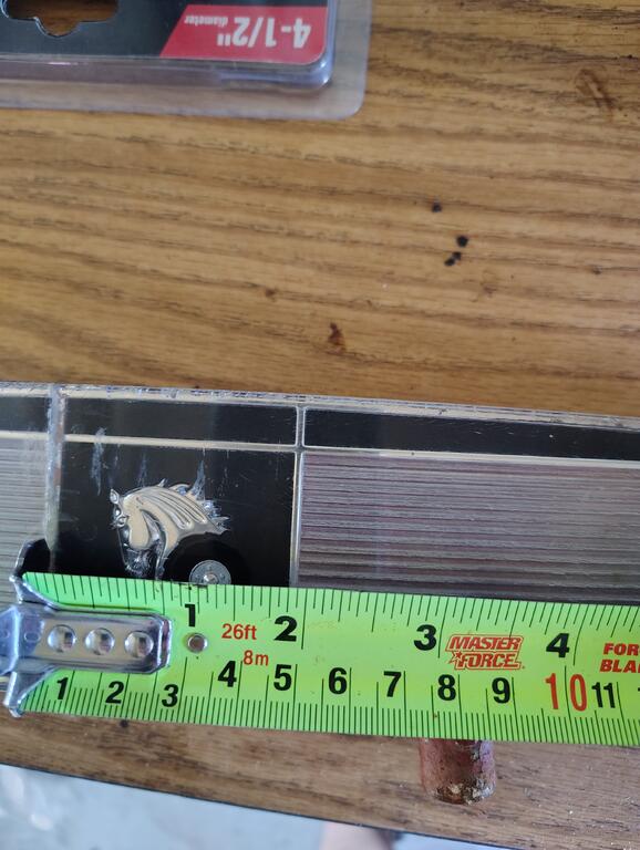

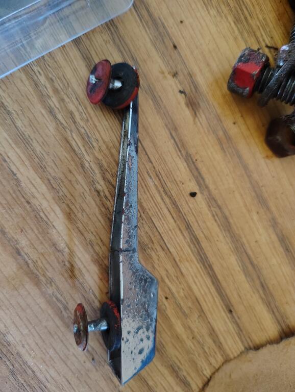

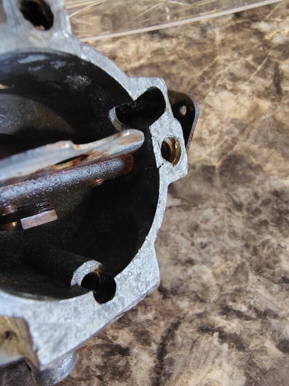

AlexR 3,084 #138 Posted August 13, 2025 Start of my idea for a for a headlight. Start of the new hood ornament May not be able to use this carb, ran it in the ultrasonic cleaner for a while. Air cleaner taps are all boogered up. And has cracks in the carb body. The jet tube/seat is also stripped out that along with the corrosion not sure it's coming out. And the bowl has holes haha second bowl I have that has holes. 2 1 1 Share this post Link to post Share on other sites

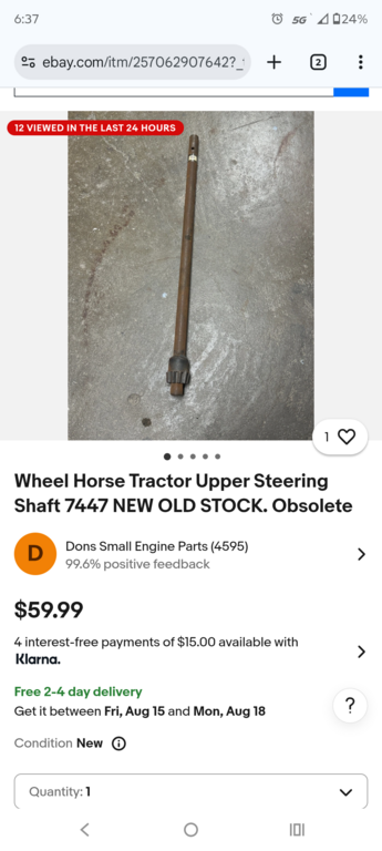

AlexR 3,084 #139 Posted August 13, 2025 So searching around on And came across this... Hmmm Share this post Link to post Share on other sites
Handy Don 17,386 #140 Posted August 13, 2025 2 minutes ago, AlexR said: And came across this I’m sure a member has at least one of these in their parts pile and can do better on the price. Heck, I’ll look tomorrow! 1 1 Share this post Link to post Share on other sites
SylvanLakeWH 32,305 #141 Posted August 13, 2025 im guessing @Pullstart, @WHX??, or @ebinmaine have a dozen or so in stock... 2 Share this post Link to post Share on other sites
ebinmaine 80,468 #142 Posted August 13, 2025 19 minutes ago, SylvanLakeWH said: im guessing @Pullstart, @WHX??, or @ebinmaine have a dozen or so in stock... I've already looked. Don't have a correct one here. I'd bet @WHX?? does though. 1 Share this post Link to post Share on other sites
AlexR 3,084 #143 Posted August 13, 2025 20 minutes ago, SylvanLakeWH said: I'm guessing @Pullstart, @WHX??, or @ebinmaine have a dozen or so in stock... Eb has none of the right length at least that he can find haha. I don't believe Pullstart does either. 2 Share this post Link to post Share on other sites
ebinmaine 80,468 #144 Posted August 13, 2025 1 hour ago, AlexR said: May not be able to use this carb No sir. I wouldn't. You have multiple options IMHO. Getting an aftermarket carb - to me - ISN'T one of them. But if that solves the issue it's a win. @76c12091520h Brian Badman may have a carb. Maybe Lincoln at A to Z Tractor in PA. 2 Share this post Link to post Share on other sites
AlexR 3,084 #145 Posted August 13, 2025 9 minutes ago, ebinmaine said: Getting an aftermarket carb - to me - ISN'T one of them. But if that solves the issue it's a win Since I already have a spare aftermarket carb that may just be what I go with for now. But yeah I don't think I would buy aftermarket carb, if given the option of having a original. So the carb that was on this engine was a #26 that was not original to this 14hp engine, and that carb got used for my 12hp 73' Wheelhorse. 1 Share this post Link to post Share on other sites
953 nut 68,880 #146 Posted August 13, 2025 A # 30 would be better for a 14 HP. 2 Share this post Link to post Share on other sites
AlexR 3,084 #147 Posted August 14, 2025 3 minutes ago, 953 nut said: A # 30 would be better for a 14 HP. Yep which is why I believe this engine didn't run as well as it should have, when I had it running. Since this is the earlier K321 engine with the small exhaust valve so technically a #28 carb is the correct one, but those are apparently fairly rare to come across. 1 Share this post Link to post Share on other sites
Handy Don 17,386 #148 Posted August 14, 2025 52 minutes ago, AlexR said: Eb has none of the right length at least that he can find haha. I don't believe Pullstart does either. The dimensions are probably somewhere in this thread, but would you mind reposting, please? 2 Share this post Link to post Share on other sites
AlexR 3,084 #149 Posted August 14, 2025 12 minutes ago, Handy Don said: The dimensions are probably somewhere in this thread, but would you mind reposting, please? 20 1/4" total length. The part number is 7447 The hole for the steering wheel roll pin is at 18 3/4" 2 Share this post Link to post Share on other sites
WHX?? 57,933 #150 Posted August 14, 2025 11 hours ago, AlexR said: 20 1/4" total length. The part number is 7447 The hole for the steering wheel roll pin is at 18 3/4" Save your money on that flea bay crap I will look when I get home. Sure I have one that will work. Up nort right now so it may be abit. Since yer a plow bro yours for shipping. 2 1 Share this post Link to post Share on other sites
