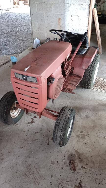

AlexR 3,112 #1 Posted June 29, 2024 (edited) Just picked up this 1972 Raider 14 today. Its been sitting outside for at least 5 years. Guy I bought it from at a rental property of his, said it was a old guy that owned it and he died a couple years ago. My plans with it are see how it runs (motor is free) and I might swap out the the 14hp into my 73' that was originally a 14hp but has a 12hp now. And then I am thinking of lowering it and swapping pulleys out to make it faster. It will get paint of some kind as well. Deck is there and I pulled it off but it's a bit of a mess, blades are locked up. Edited June 29, 2024 by AlexR 11 2 Share this post Link to post Share on other sites

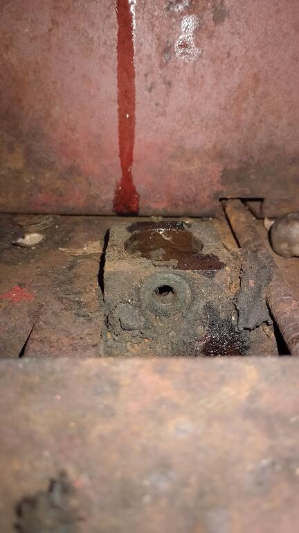

kpinnc 18,960 #2 Posted June 29, 2024 1 hour ago, AlexR said: Just picked up this 1972 Raider 14 today. That's a heckuva battery tray the previous owner came up with! Looks to have good bones! 3 1 Share this post Link to post Share on other sites
AlexR 3,112 #3 Posted June 29, 2024 (edited) 54 minutes ago, kpinnc said: That's a heckuva battery tray the previous owner came up with! Looks to have good bones! Yeah it would probably make a great weight tray for someone, but all the weight is on the hitch pin on the transmission so maybe not. And honestly I don't know why they did make that battery tray there doesn't seem to be anything wrong with the stock battery tray It is good, but it's messed up and worn out in enough places that I don't mind hacking away a bit at it. Like the PTO lever plate that holds the lever tight is welded to the steering tower. The wiring is a absolute mess which is fine I have a new key switch and wiring harness that goes to it so I can rewire it no problem. Gas tank is questionable it doesn't have the shutoff valve and bushing on it. And I am sure there are some things I haven't ran into yet. Edited June 29, 2024 by AlexR 1 Share this post Link to post Share on other sites

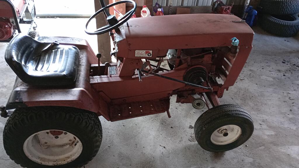

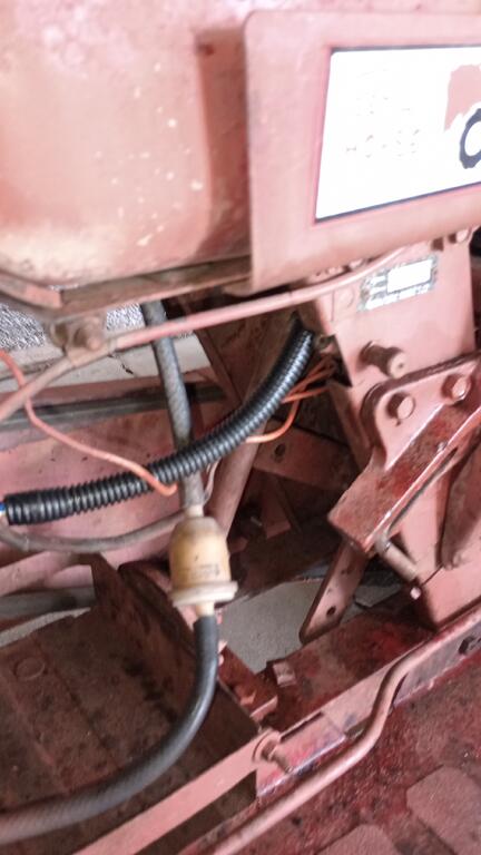

8ntruck 9,296 #4 Posted June 29, 2024 The fuel shutoff valve in this era of tractor was often in the side plate of the dash tower just above the lift lever. Looks like it might be there in your 2nd picture. Multiple turn knob sticking through the pannel with the actual valve inside. 2 Share this post Link to post Share on other sites
AlexR 3,112 #5 Posted June 29, 2024 44 minutes ago, 8ntruck said: The fuel shutoff valve in this era of tractor was often in the side plate of the dash tower just above the lift lever. Looks like it might be there in your 2nd picture. Multiple turn knob sticking through the pannel with the actual valve inside. That's good to know!! I noticed that but I didn't realize that was original and the way they did that. Thank you very much for that information. 1 Share this post Link to post Share on other sites

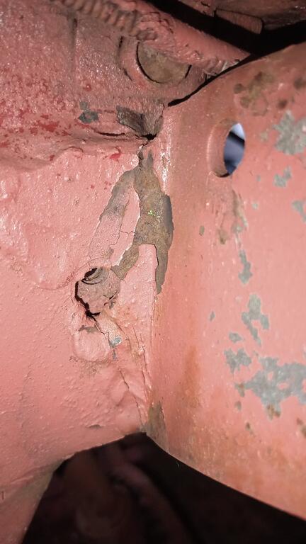

AlexR 3,112 #15 Posted June 30, 2024 Well the transmission is not limited slip or at least if it was it's completely worn out now. Spinning one tire the other tire spins reverse and if I hold one tire and spin the other there is very little resistance. I do hear a slight clunking/clicking so it's probably just completely worn out. Working on getting the oil changed out on the transmission to get any water out. Looks like they welded a bar to the hitch and it's a beefy bar 1 1 Share this post Link to post Share on other sites

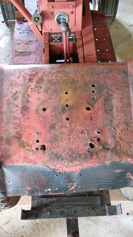

AlexR 3,112 #18 Posted June 30, 2024 Well the seat pan is not very good shape still might be salvageable but definitely wouldn't mind cutting it up. Steering is a bit sloppy which most of these tractors are, if they weren't greased regularly and used a lot. I drained the transmission which had quite a bit of water in it but looking through the fill tube and pulled the gear shifter to look through there it doesn't look bad at all. Refilled with fresh oil for now. Also drained and refilled engine oil which had like a tablespoon of water that came out before the oil. The gear shifter set screw seems like the threads in the transmission are stripped so will have to figure that one out later. Ripped all the wiring out except the ones from the engine to the rectifier, and removed the ignition switch which was not the correct one and was loose, I had a spare ignition switch and a stens wiring harness so that will not be hard to get finished up. The PTO lever plate at the steering tower is a mess it's welded to the tower and it's cracked at the angle. And the PTO itself at the engine seems a little loose. The headlight lens in the photo looks ok but it's not it's cracked in multiple places. The hitch pin of course is stuck so didn't mess with that to much right now Pulled the carb bowel it was dry and pretty clean so may not even need to mess with that. 1 Share this post Link to post Share on other sites
