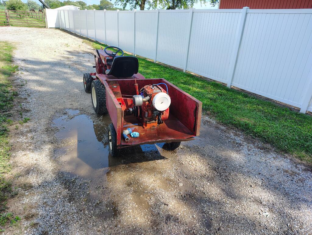

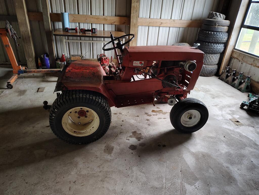

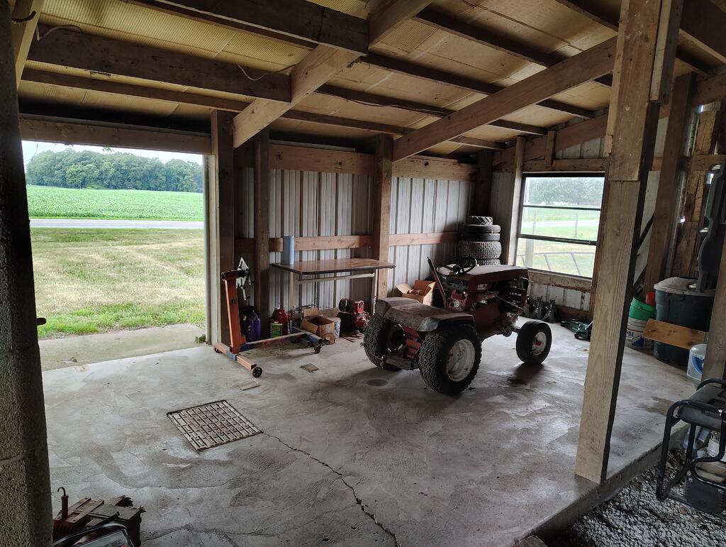

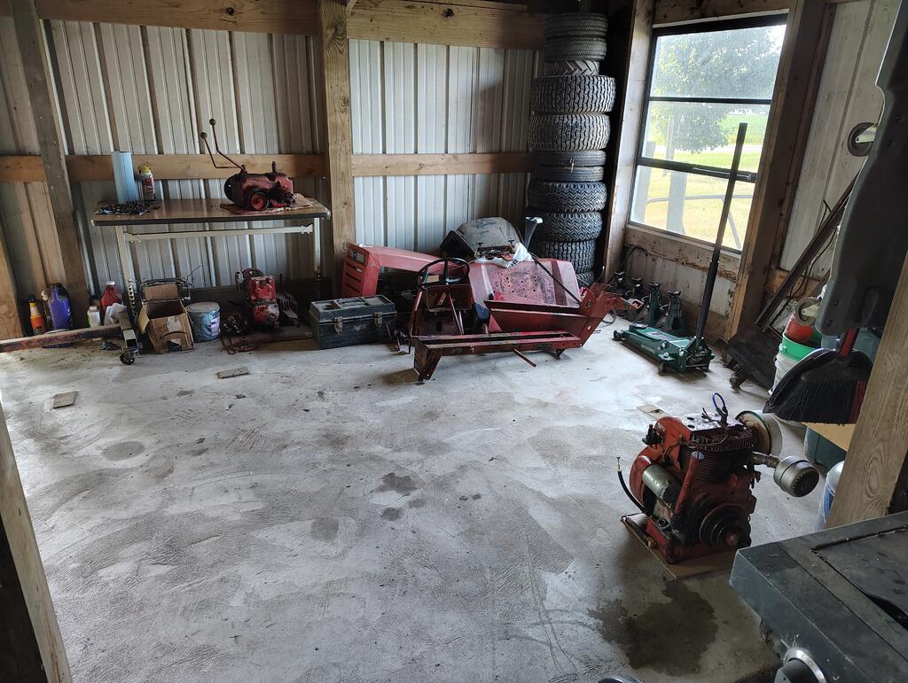

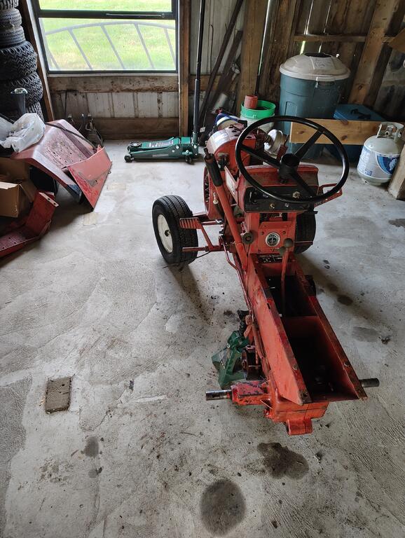

AlexR 3,136 #55 Posted July 19, 2025 Got my work area cleaned up naturally I forgot to take a before photo. But I added in a post for roof support that needed put in. And removed 4 other posts that weren't structural, this was used for cattle at one point and the posts were for a chute. With boards nailed to them of course. It really opened up the usable space removing those posts. Probably going to pull the tractor out and power wash it before taking it apart. Not sure if I will start that this week or not supposed to get pretty hot 4 1 Share this post Link to post Share on other sites

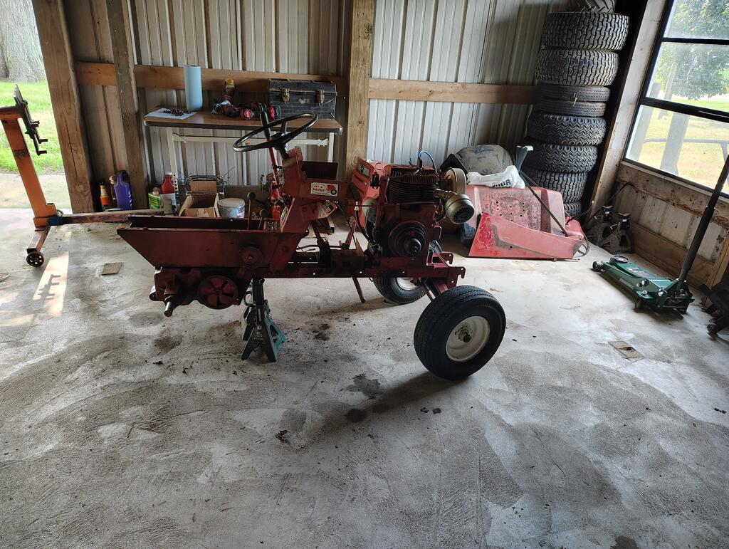

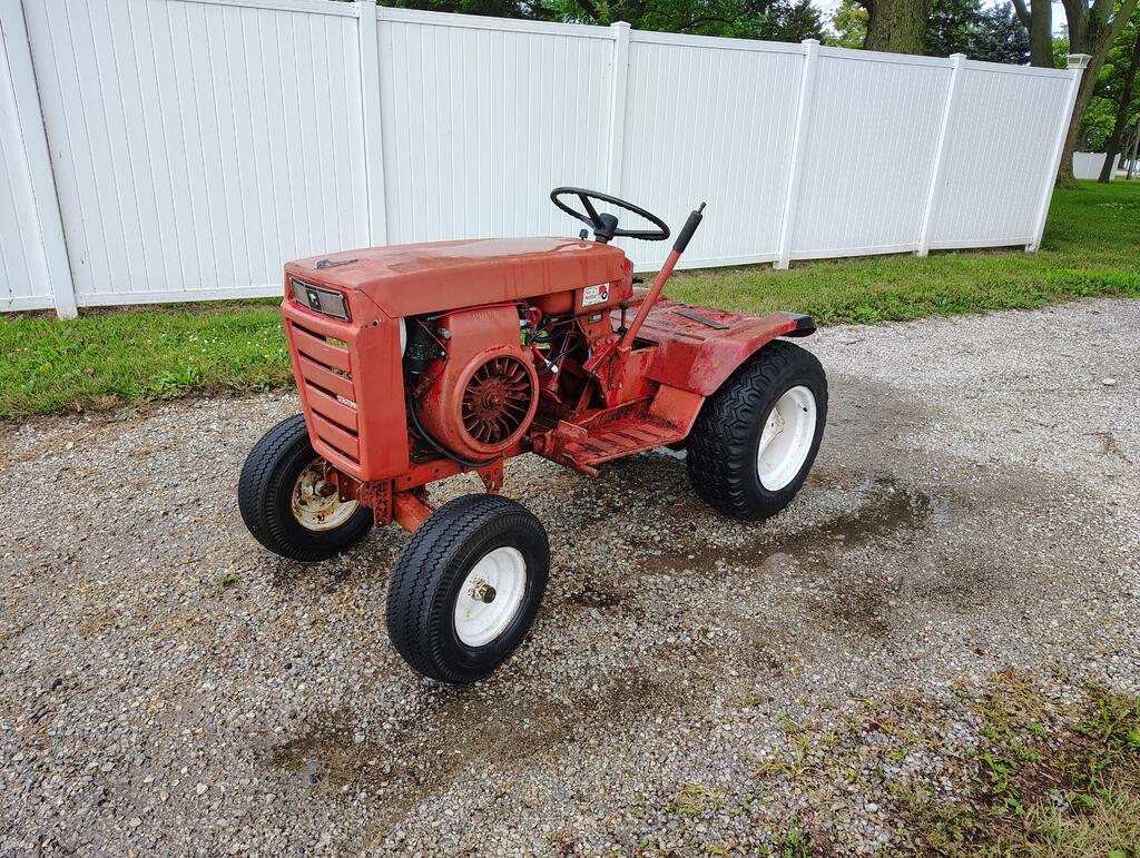

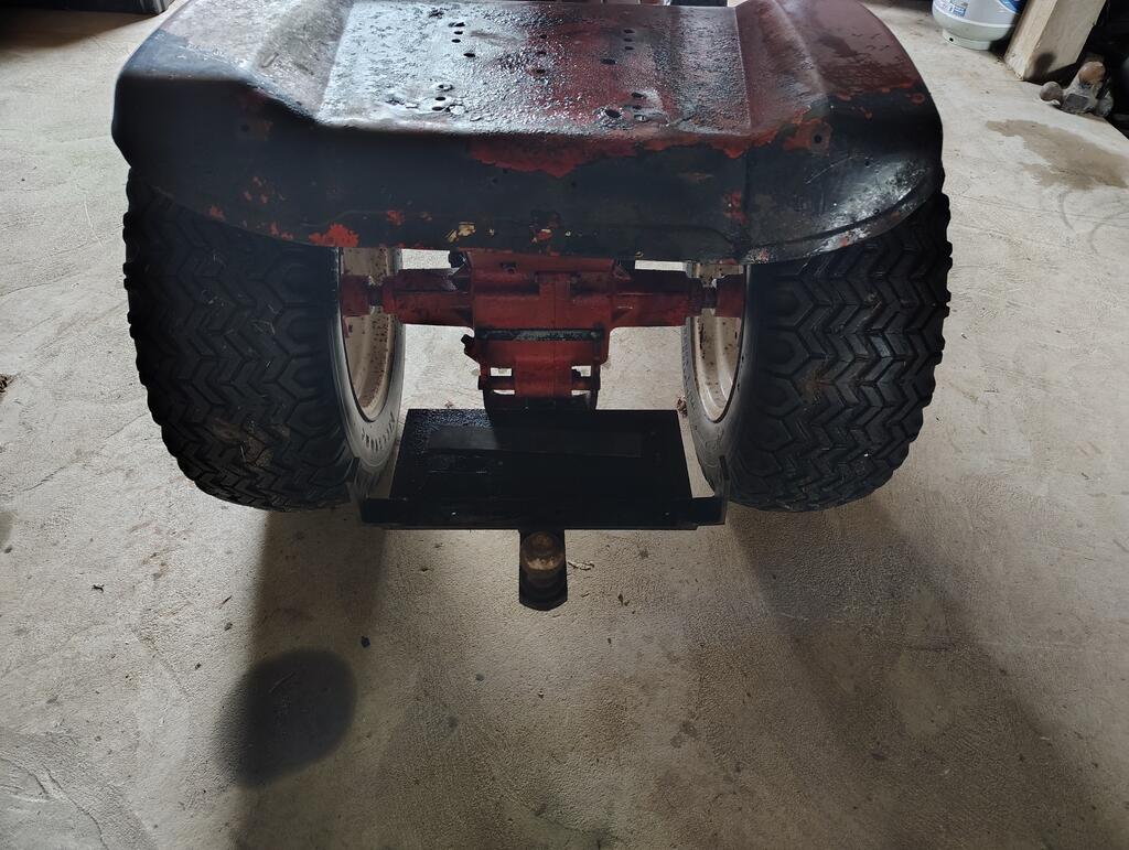

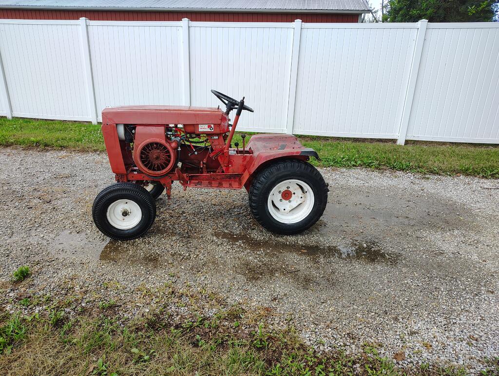

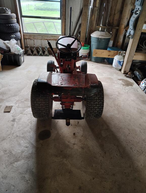

AlexR 3,136 #56 Posted July 20, 2025 Power washed the tractor off to make disassembly less messy. Then changed the rear wheels to see how they fit pretty positive I am going with the BKT 315 TR's And rear view with the old rims and tires. 3 1 Share this post Link to post Share on other sites
ebinmaine 81,046 #57 Posted July 20, 2025 IMHO the wide rear is a requirement. 1 1 Share this post Link to post Share on other sites
AlexR 3,136 #58 Posted July 20, 2025 1 minute ago, ebinmaine said: IMHO the wide rear is a requirement. Completely agree!! 2 Share this post Link to post Share on other sites

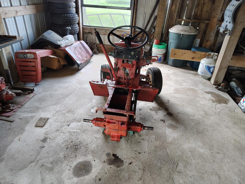

AlexR 3,136 #61 Posted July 21, 2025 Well I dealt with the heat today which is probably the coolest day this week. And started tearing this tractor apart. Got two of the harder things off the rear hitch pin which did need some convincing. And the rear hubs off, which were pretty stubborn but not completely frozen. Good news is the axles and hubs look decent at the key ways. Also got the steering wheel pin out, but soaking the wheel in penetrating oil for a bit before I try taking it off. The more I take apart this tractor is definitely worn. Fixable but worn, needs a lot of new parts. 5 1 Share this post Link to post Share on other sites

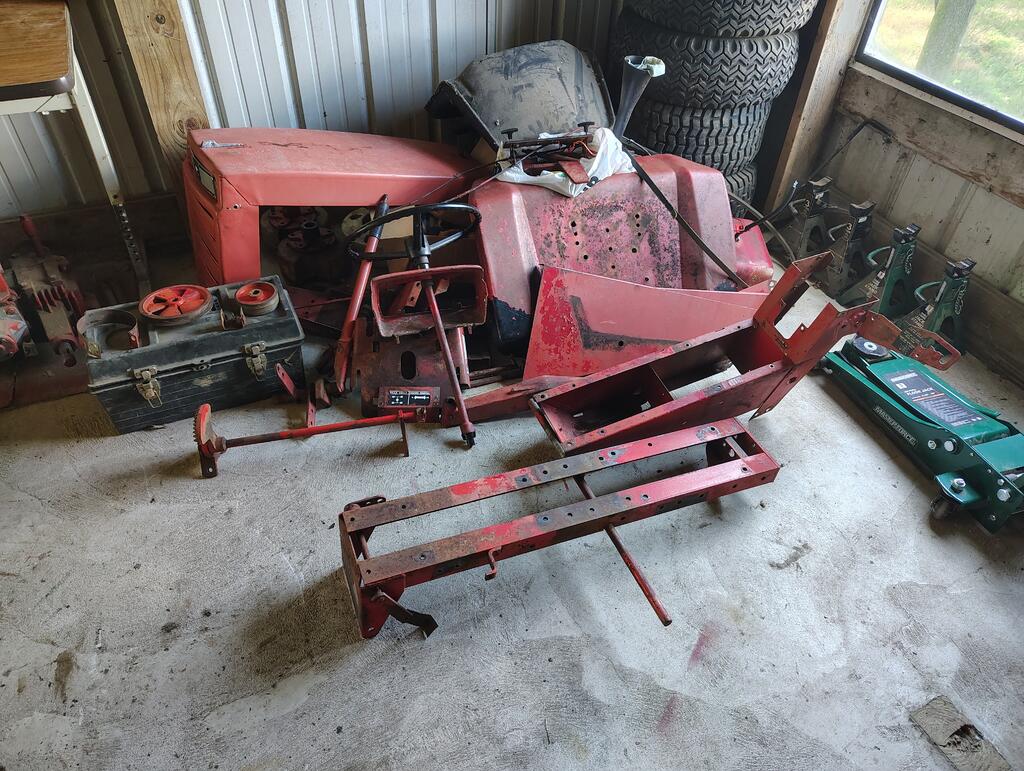

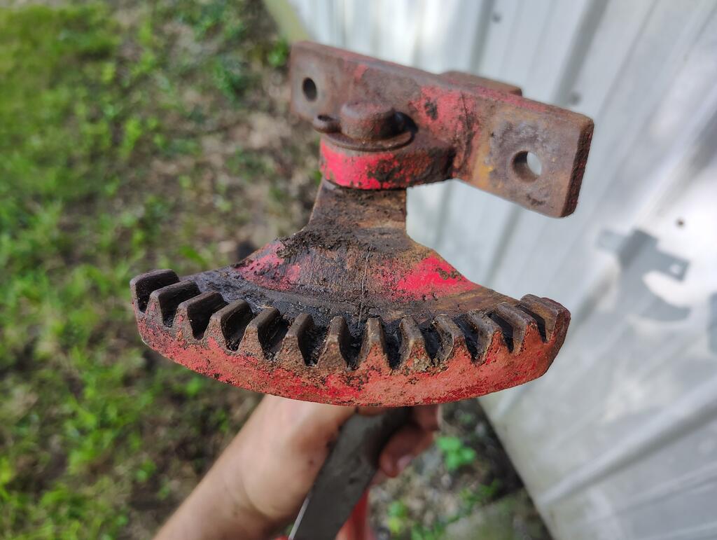

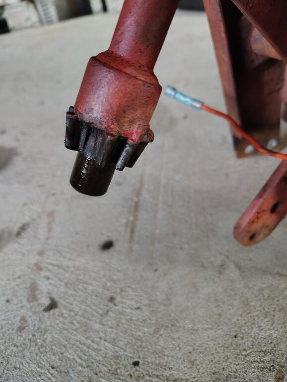

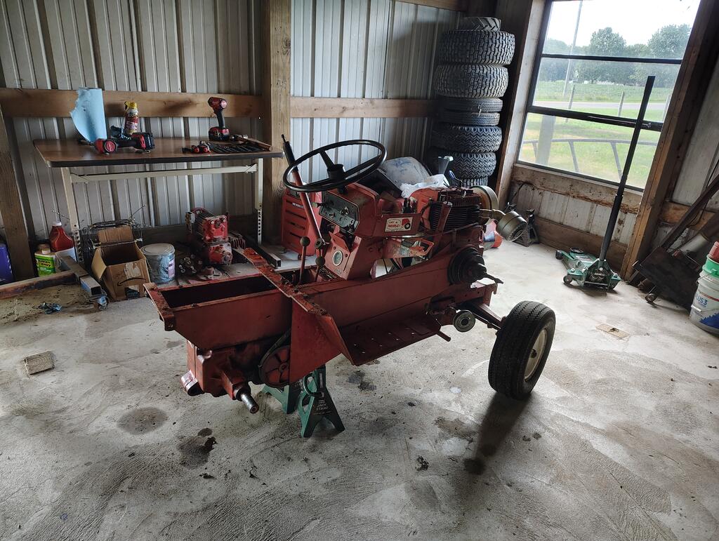

AlexR 3,136 #63 Posted July 22, 2025 And just like that it's blown apart. Still a few things left steering wheel still needs to come off. Steering shaft gear has a broken gear on it. Weirdly the fan gear and the rest of the teeth on the shaft gear don't look worn to bad. And got the pile of fasteners to get replaced. 4 Share this post Link to post Share on other sites
ebinmaine 81,046 #64 Posted July 22, 2025 14 minutes ago, AlexR said: And just like that it's blown apart. Niiiiice work! 14 minutes ago, AlexR said: . Steering shaft gear has a broken gear on it. Need one? We may have a spare.... 14 minutes ago, AlexR said: And got the pile of fasteners to get replaced. I've been using a combination of Bolt Depot in Hingham MA and McMaster Carr for nearly all of our hardware. Again, lemme know if you have needs. 1 Share this post Link to post Share on other sites

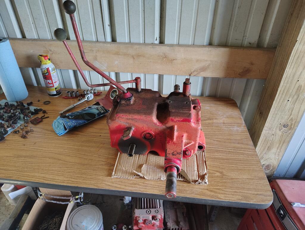

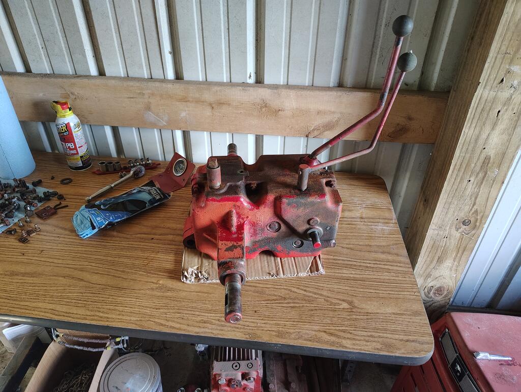

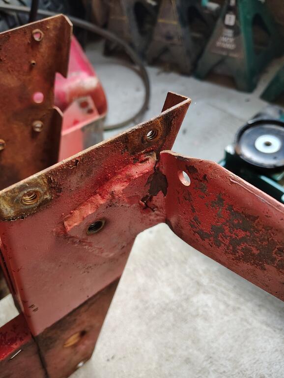

AlexR 3,136 #66 Posted July 24, 2025 The transmission, engine, frame, steering, and steering tower/box. Are now degreased and cleaned off. Next is taking the transmission apart to see if just the regular transmission rebuild kit will work or if I need the extra bearings. I neglected to take a closer photo but the brake "drum" has a big lip on the outside from probably some kind of improper brake material. So either I can get it turned down, or I can just get a "new" one from A-Z tractor. While talking about the transmission I have a question so the transmission shifter set screw. The threads are too far gone in the transmission so I have two options that I see. Both involve drilling bigger and tapping. So either helicoil and get the right set screw, or use a bigger set screw and just grind the end of it down to fit the shifter. Which would you guys recommend? And the other thing I have to fix is this PTO bracket that is supposed to bolt to the tower.. is welded. 2 1 Share this post Link to post Share on other sites
ebinmaine 81,046 #67 Posted July 24, 2025 33 minutes ago, AlexR said: While talking about the transmission I have a question so the transmission shifter set screw. The threads are too far gone in the transmission so I have two options that I see. Both involve drilling bigger and tapping. So either helicoil and get the right set screw, or use a bigger set screw and just grind the end of it down to fit the shifter. Which would you guys recommend? I personally haven't had great luck with helicoils BUT they likely weren't used correctly by Previous owners. I'd drill to the next size and grind the bolt tip down. 1 1 Share this post Link to post Share on other sites
ebinmaine 81,046 #68 Posted July 24, 2025 34 minutes ago, AlexR said: Next is taking the transmission apart to see if just the regular transmission rebuild kit will work or if I need the extra bearings. I've been into at least a dozen manual transmissions and two hydros. I've never replaced every bearing. In fact I've never done more than 4 or 5 per transmission. 1 Share this post Link to post Share on other sites
AlexR 3,136 #69 Posted July 24, 2025 19 minutes ago, ebinmaine said: I personally haven't had great luck with helicoils BUT they likely weren't used correctly by Previous owners. I'd drill to the next size and grind the bolt tip down. It would be the cheaper option as well. Thanks! 17 minutes ago, ebinmaine said: I've been into at least a dozen manual transmissions and two hydros. I've never replaced every bearing. In fact I've never done more than 4 or 5 per transmission. I doubt I will need those extra bearings kits, just want to make sure before I order. I'm going to make a pretty big order with Wheelhorsepartsandmore but his prices are honestly pretty good. And it's nice the amount of common wear parts that he offers 1 Share this post Link to post Share on other sites

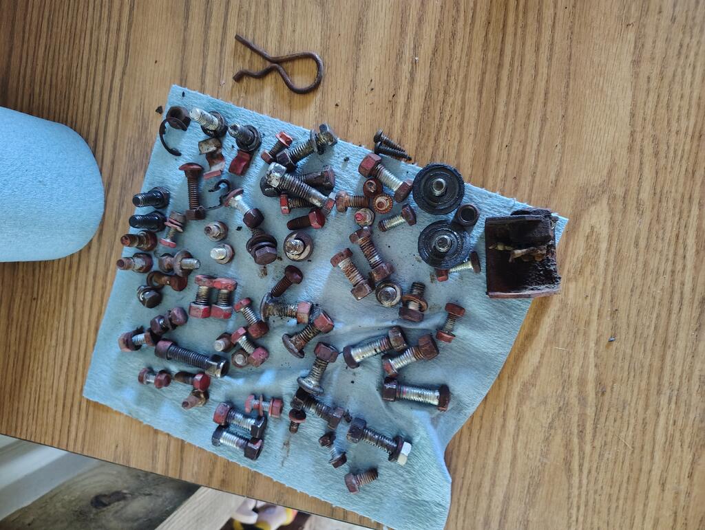

953 nut 70,058 #70 Posted July 24, 2025 On 7/22/2025 at 5:21 PM, AlexR said: And got the pile of fasteners to get replaced. I would clean up the old bolts and nuts and reuse them, they are better quality than most of the off-shore junk being sold today. 3 1 Share this post Link to post Share on other sites
AlexR 3,136 #71 Posted July 24, 2025 3 minutes ago, 953 nut said: I would clean up the old bolts and nuts and reuse them, they are better quality than most of the off-shore junk being sold today. I might with some of them. I am missing some fasteners and a couple aren't good. 1 Share this post Link to post Share on other sites
Handy Don 17,634 #72 Posted July 24, 2025 35 minutes ago, AlexR said: I might with some of them. I am missing some fasteners and a couple aren't good. Most of us (even @ebinmaine, I suspect 😁) have a collection of removed WH fasteners. I reuse any I can clean up that are NOT in high-stress or fatigue-inducing locations. But I work on workers, not show units. Waste not, want not. 1 3 Share this post Link to post Share on other sites
ebinmaine 81,046 #73 Posted July 25, 2025 1 hour ago, 953 nut said: I would clean up the old bolts and nuts and reuse them, they are better quality than most of the off-shore junk being sold today. Agreed. We build: 31 minutes ago, Handy Don said: workers So we build for strength, not originality. I use Bolt Depot because of their top shelf customer service and top quality parts. 1 Share this post Link to post Share on other sites

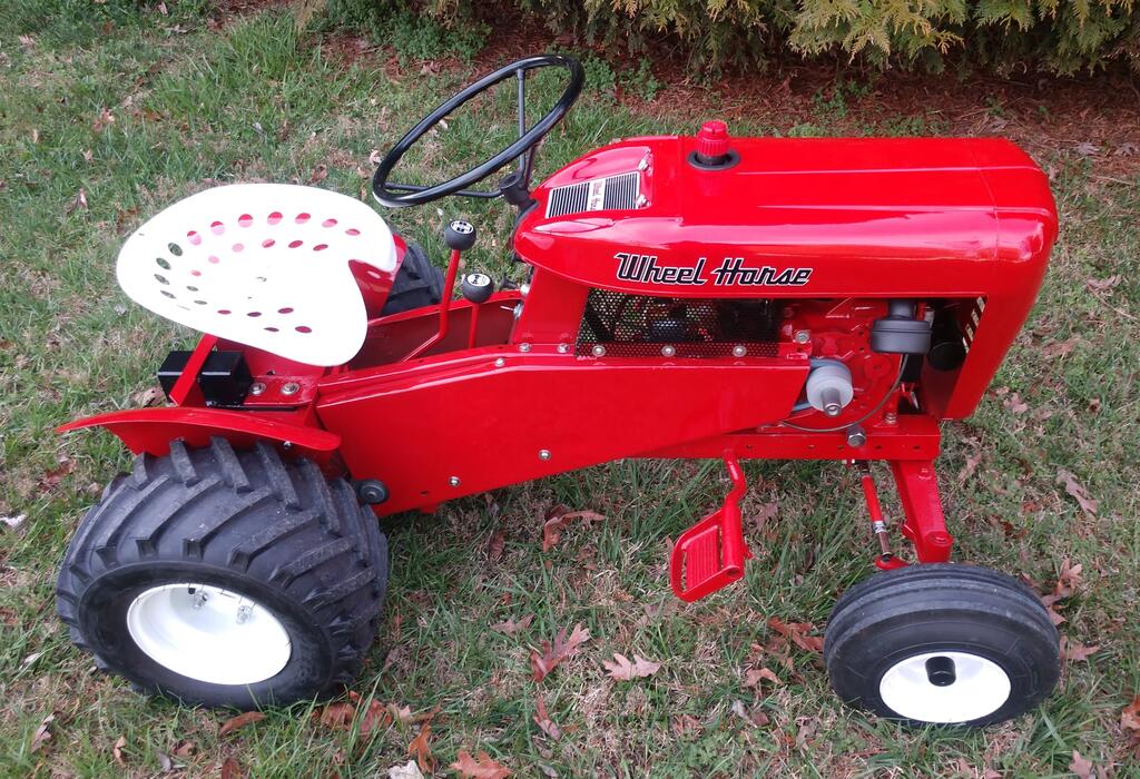

kpinnc 19,036 #75 Posted July 25, 2025 (edited) 45 minutes ago, AlexR said: It will still be a rattle can job, Done correctly, a rattle can job can be made to look very nice. The tractor below was rattle can painted with no clear overcoat. Prep work is everything! You just have to allow a few weeks for the paint to truly cure. Until then, it's easily scratched. Edited July 25, 2025 by kpinnc 2 6 Share this post Link to post Share on other sites
