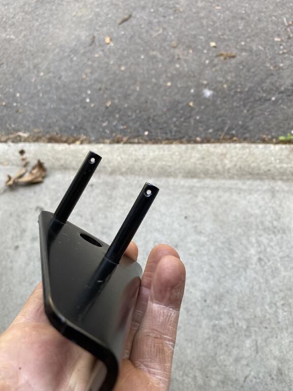

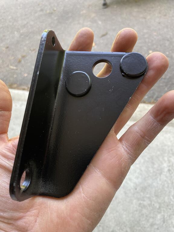

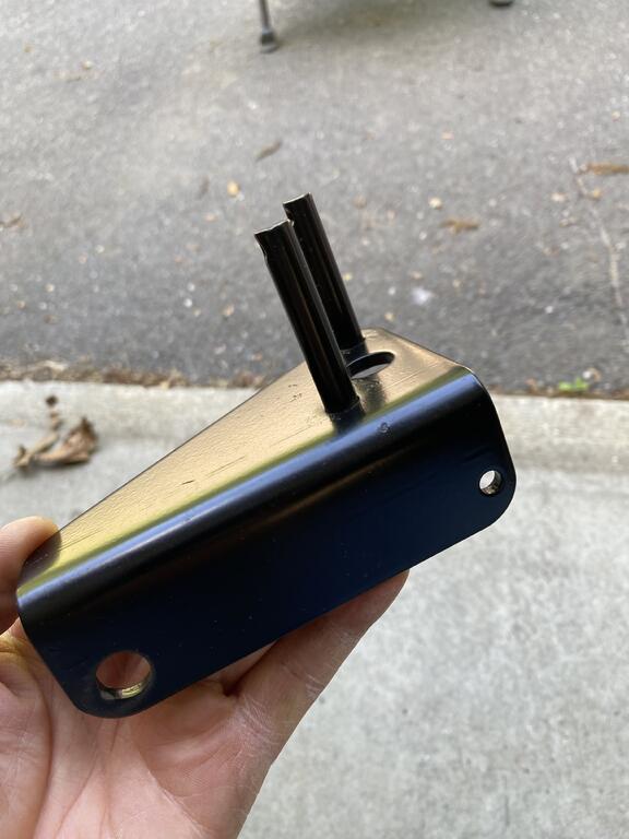

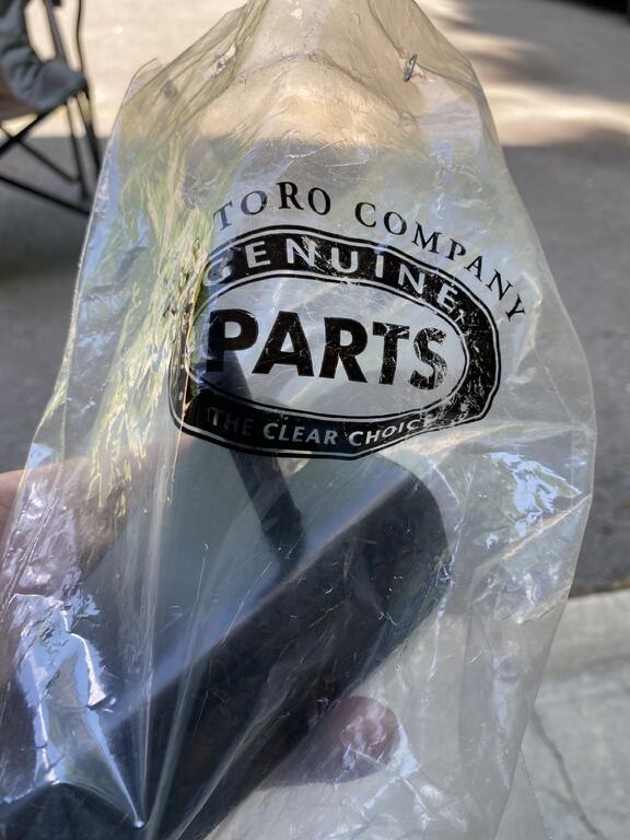

Sparky-(Admin) 24,668 #1 Posted May 31, 2024 Pulled this out of a pile of stuff I ended up with. Brand new in a bag but no part number, any thoughts? Share this post Link to post Share on other sites
ebinmaine 77,538 #2 Posted May 31, 2024 Looks like the piece that holds the brake shoe on the side of an Eaton 1100 1 Share this post Link to post Share on other sites

ebinmaine 77,538 #4 Posted May 31, 2024 2 minutes ago, Sparky said: Hmmm…no Eaton 1000’s here to compare it to. But I think the neighbor has one. Thanks! Now that I think about it a late '70s or early '80s sundstrand may also have that Share this post Link to post Share on other sites
JCM 10,780 #5 Posted May 31, 2024 Toro # 78-7740 Brake Pivot NLA 520-H @Sparky 1 2 Share this post Link to post Share on other sites

JCM 10,780 #8 Posted May 31, 2024 It looks like the same part as the ones on Parts Tree. I would have to go look at my 520 to be 100% sure. Let me know if you want me to verify. Did not list a price. Maybe 3 or $ 400 if it's for a friend. 3 Share this post Link to post Share on other sites
ebinmaine 77,538 #9 Posted May 31, 2024 20 minutes ago, Sparky said: And NLA…so priceless eh? Probably not a part folks need to often I suspect. Funny thing on that Mike. We've had two of those go through our shop in the last 6 months and they were BOTH BENT. 1 1 1 Share this post Link to post Share on other sites
Racinbob 12,812 #10 Posted May 31, 2024 49 minutes ago, JCM said: Toro # 78-7740 Brake Pivot NLA 520-H @Sparky Bingo! I have that part on my 314-H. 20 minutes ago, ebinmaine said: Funny thing on that Mike. We've had two of those go through our shop in the last 6 months and they were BOTH BENT. And guess what? IT WAS BENT! How in the he!! does it get bent? I found the part on Ebay but ended up straightening it. 1 Share this post Link to post Share on other sites
ebinmaine 77,538 #11 Posted May 31, 2024 2 minutes ago, Racinbob said: Bingo! I have that part on my 314-H. And guess what? IT WAS BENT! How in the he!! does it get bent? I found the part on Ebay but ended up straightening it. We're really not familiar with hydros around here but I assume it was because somebody had the brake adjusted too tight ...??!!?? Share this post Link to post Share on other sites
Racinbob 12,812 #12 Posted May 31, 2024 5 minutes ago, ebinmaine said: We're really not familiar with hydros around here but I assume it was because somebody had the brake adjusted too tight ...??!!?? I don't think so Eric. I don’t even think that would be possible. Something had hit the end of one of the posts. Hard enough that I had to chase the hole for the pin to get another one in. Now I wish I had a picture. I just figured it was a fluke and had never happened before. 1 1 Share this post Link to post Share on other sites

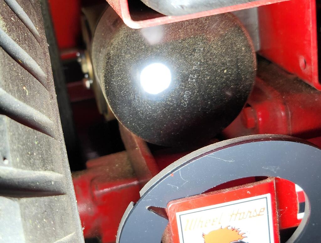

Racinbob 12,812 #16 Posted June 1, 2024 I'm 99% sure that I found out how this part gets damaged. I noticed mine when I had the left wheel off changing the tranny fluid. As I said I was able to get it back to a near normal position but it didn't make sense how it could have gotten bent. I decided to ignore it but then this thread showed up. I just went out and looked at it with the tire on. CHAINS! If you all saw the thread on my new to me 96 314-H you'll recall that it only had 122 hours on it and it was obvious it had never had a belt on the PTO. It had been used to push snow only. That pin that gets bent is in the perfect position for one on the chain links to catch it. I think I'll be OK because when I install chains they are guitar string tight and get tagged for not only which tractor but which tire on that tractor. In any case I'm glad I was made aware of the potential problem. 1 2 Share this post Link to post Share on other sites
Racinbob 12,812 #17 Posted June 1, 2024 (edited) 20 hours ago, Sparky said: And NLA…so priceless eh? Probably not a part folks need to often I suspect. Not your black one Sparky. Mine is red, Worth more. You can see the pins and their proximity to the tire. Edited June 1, 2024 by Racinbob 1 1 Share this post Link to post Share on other sites
