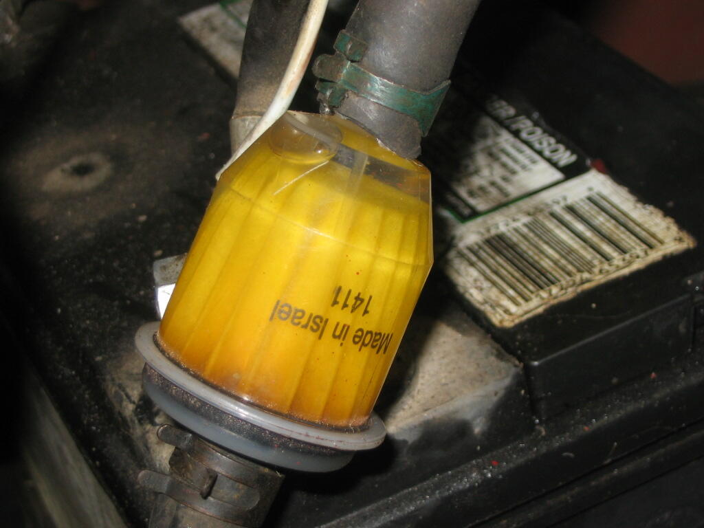

daveoman1966 3,883 #8 Posted May 31, 2024 (edited) Just to be sure... I had asked if the clear plastic fuel filter should be full when engine is running and, if not, is that an indication that the fuel pump is DOA. Some answered that it would not be. Today I swapped out the fuel pump for a known good one, and the fuel filter is now FULL...note the little bubble on top. Before I swapped out the fuel pump, one could only see a little bit of fuel. All is well that ends well, I guess. NEXT---needing a rebuild kit for the K341 fuel pump... WHERE CAN I GET ONE??? Edited June 1, 2024 by daveoman1966 1 Share this post Link to post Share on other sites

Handy Don 16,751 #10 Posted June 1, 2024 1 hour ago, daveoman1966 said: if the clear plastic fuel filter should be full when engine is running It depends on the angle at which the filter is aligned. If vertical (or nearly) as you have it and inlet slde up (as you have it), then it has to fill to get fuel to the engine. Lying on its side or with the inlet side down, it need not fill. Share this post Link to post Share on other sites

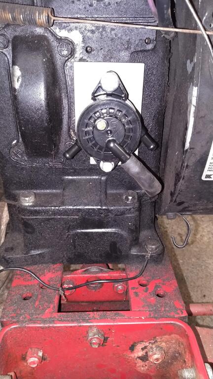

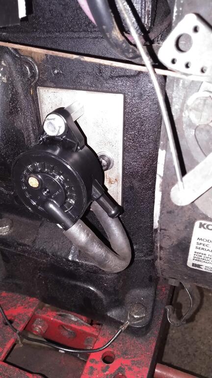

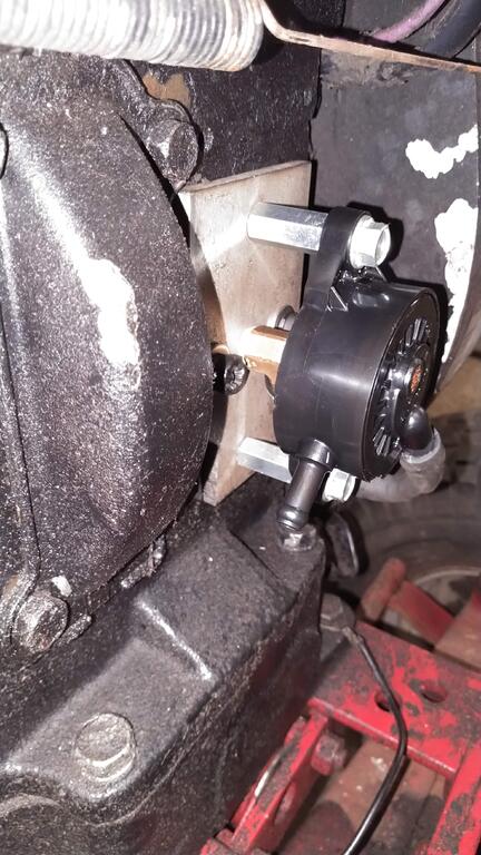

Bill D 2,877 #11 Posted June 1, 2024 I've changed out my mechanical pumps to vacuum pulse pumps. I made a mounting plate from stainless steel and installed the pump on that. Got them on three different machines. They work great. I use Briggs or Kawasaki pumps. If you go this route stay away from cheap Chinese pumps. The Briggs and Kawasaki pumps are made in Japan by Mikuni. 2 Share this post Link to post Share on other sites
