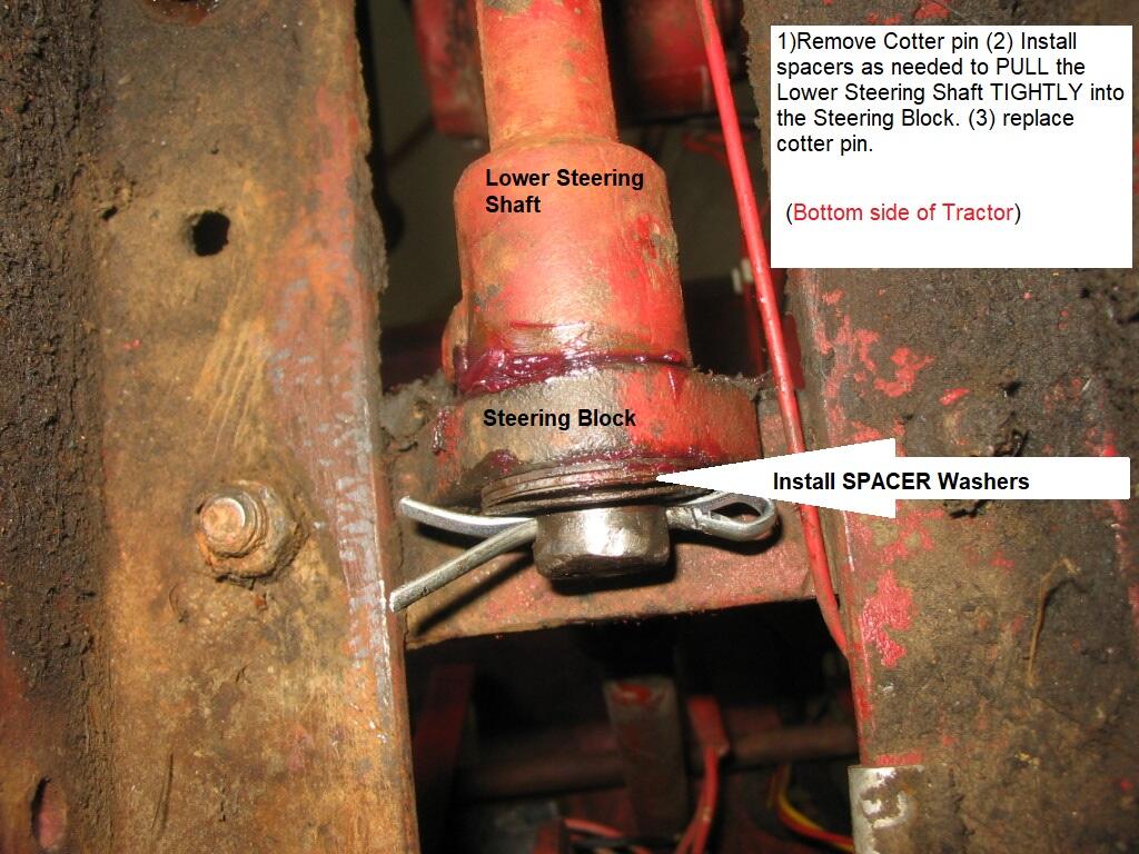

squonk 48,429 #5 Posted May 18, 2024 Steering block wallowed out. #5-25 in the diagram. Share this post Link to post Share on other sites

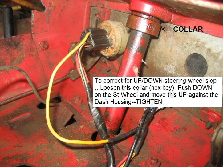

daveoman1966 3,885 #6 Posted May 18, 2024 Common issue. Get under the tractor and shim the lower steering rod like this: For the up/down of the steering column, (1) open the hood (2) loosen the 3/4" ID collar on the column and (3) move it up to be tight against the dash housing. Put some grease in there too. 3 Share this post Link to post Share on other sites
