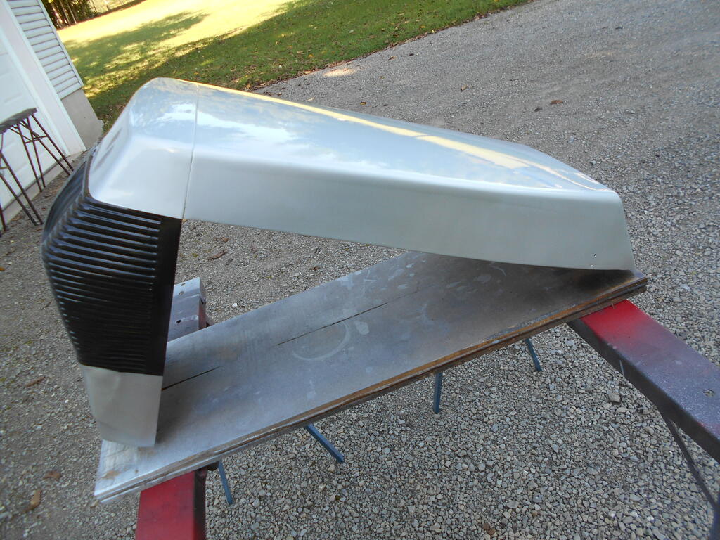

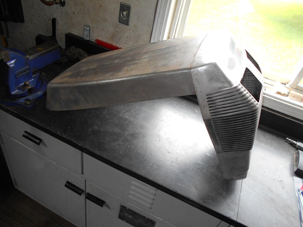

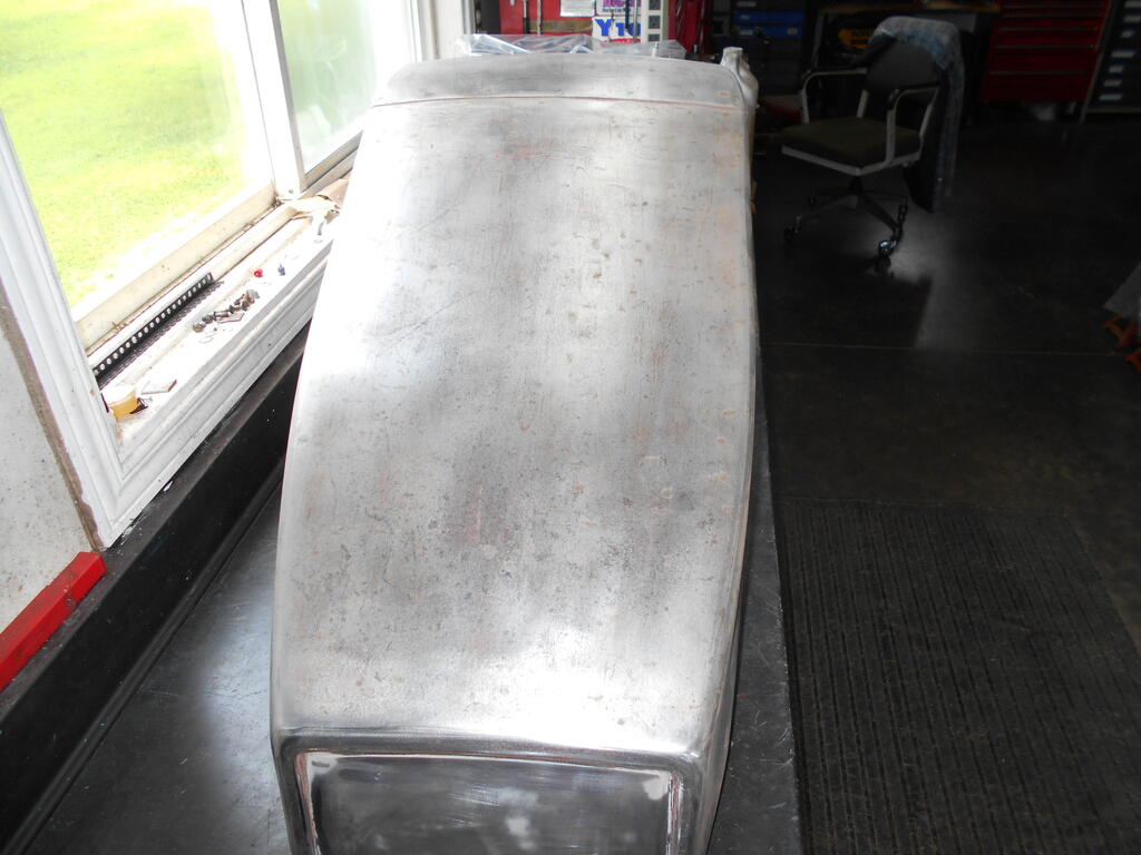

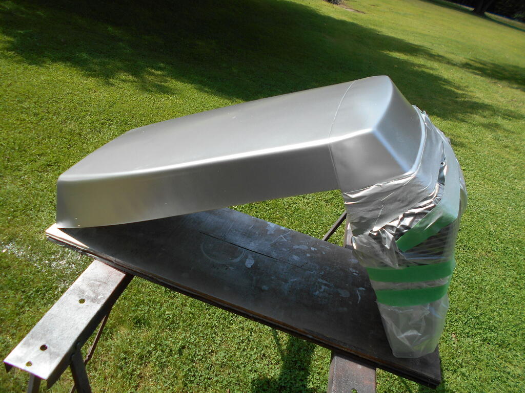

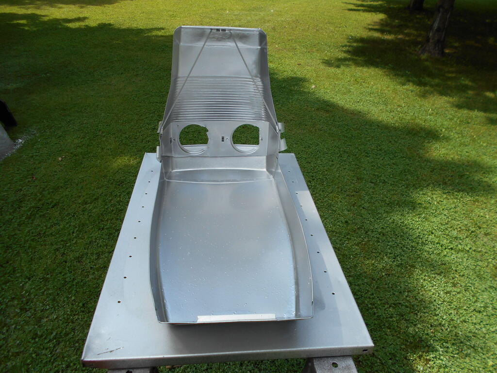

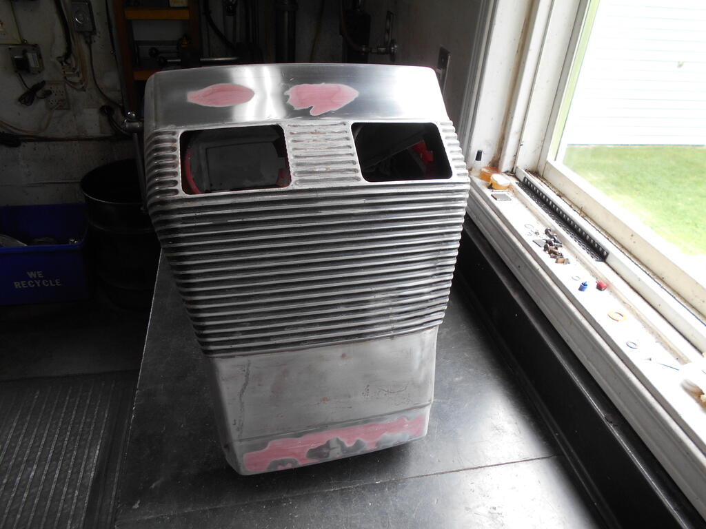

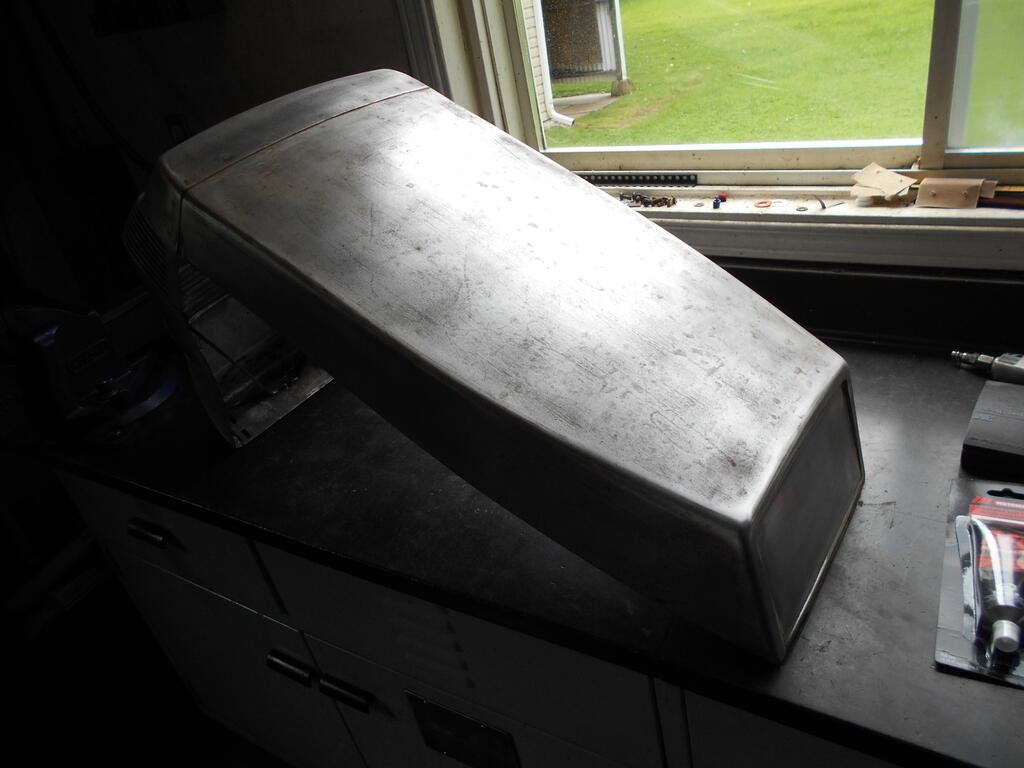

cleat 9,266 #181 Posted August 18, 2024 Hood sanded and spot putty applied to final level where holes were welded in and where there were dents. It is raining on and off for the next couple of days so I can't paint right now. 3 4 Share this post Link to post Share on other sites
sjoemie himself 3,177 #182 Posted August 19, 2024 That looks VERY clean. Not much pitting going on by the looks of it. 2 Share this post Link to post Share on other sites
cleat 9,266 #183 Posted August 20, 2024 16 hours ago, sjoemie himself said: That looks VERY clean. Not much pitting going on by the looks of it. Between the holes in the front, cracks on the bottom and no brace making it feel very flimsy I was on the lookout for a better hood. However, now that the holes and cracks are welded up and the brace welded in I thought I might as well sand it down and see how it looks. You are right, it looks pretty good with the scratches and surface rust sanded off. Now if my paint job turns out we will be good to go. If not I will sand it off and try again. Hoping to begin painting on Thursday if the weather forecast is correct about sunshine finally. 4 Share this post Link to post Share on other sites

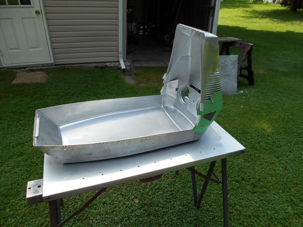

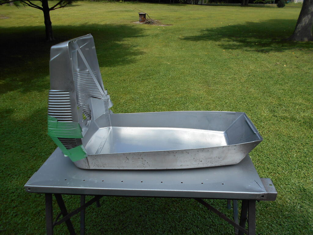

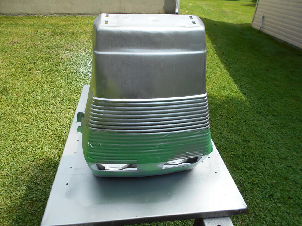

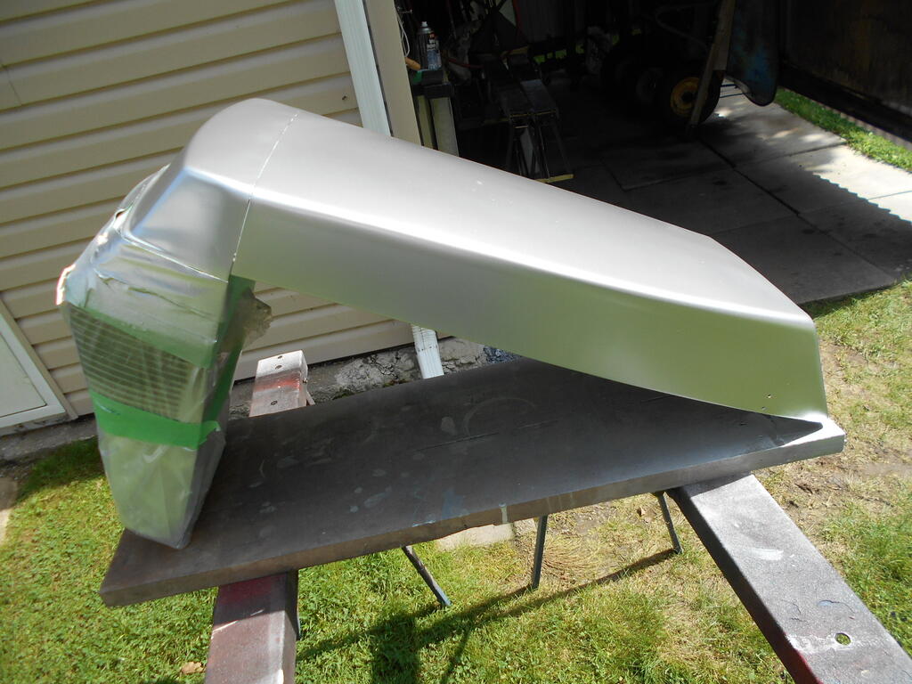

cleat 9,266 #184 Posted August 20, 2024 Got a break in the weather. Underside of hood primed. Not a perfect job but OK for my skills 5 1 Share this post Link to post Share on other sites

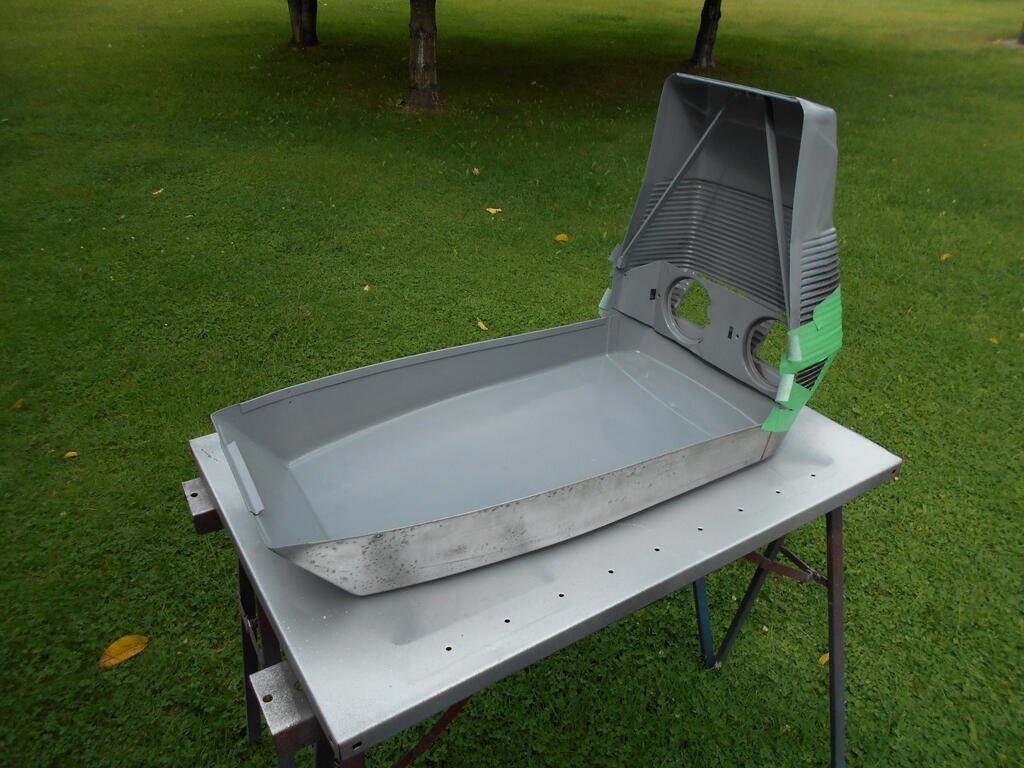

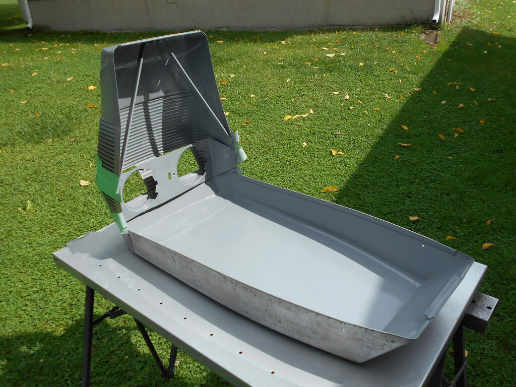

cleat 9,266 #185 Posted August 22, 2024 Underside of hood painted. Not perfect, there are bubbles in the paint for some reason. 3 1 Share this post Link to post Share on other sites

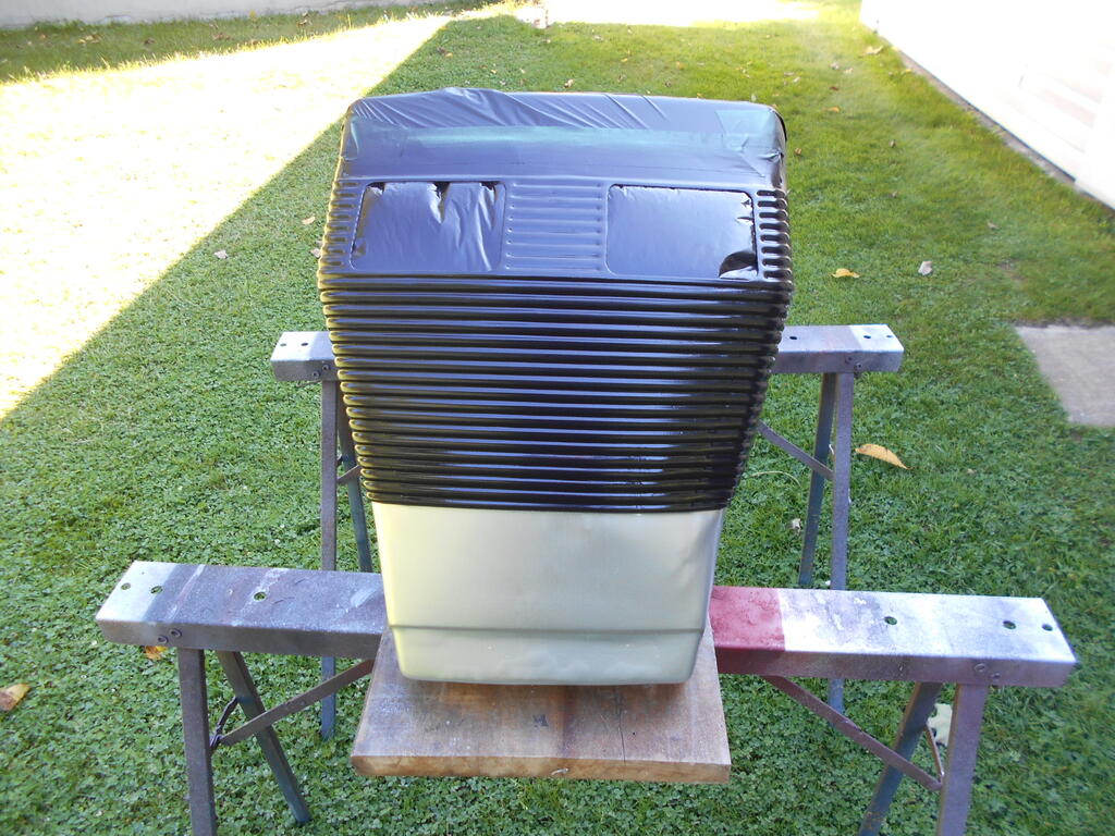

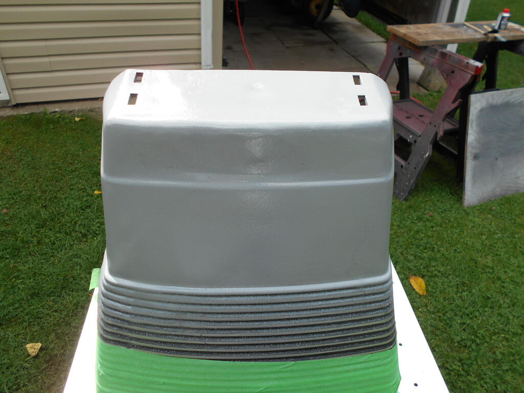

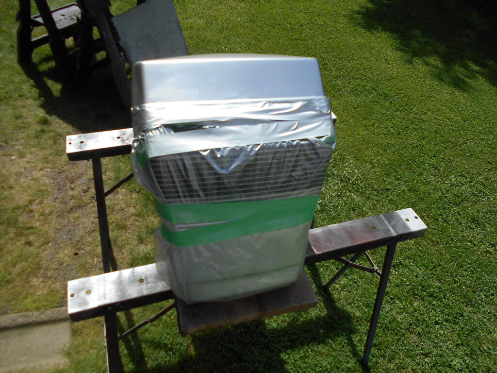

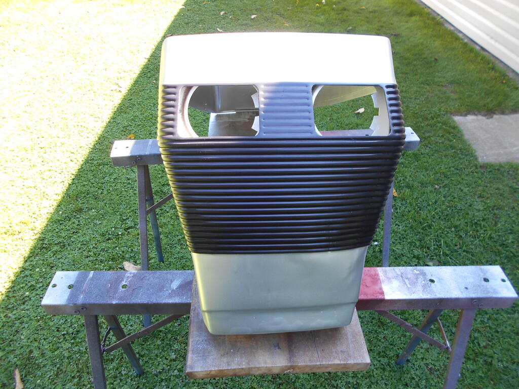

cleat 9,266 #186 Posted August 23, 2024 Hood primed and painted. After this dries for a few days I will do the black and clear. 3 5 Share this post Link to post Share on other sites

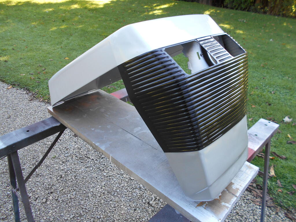

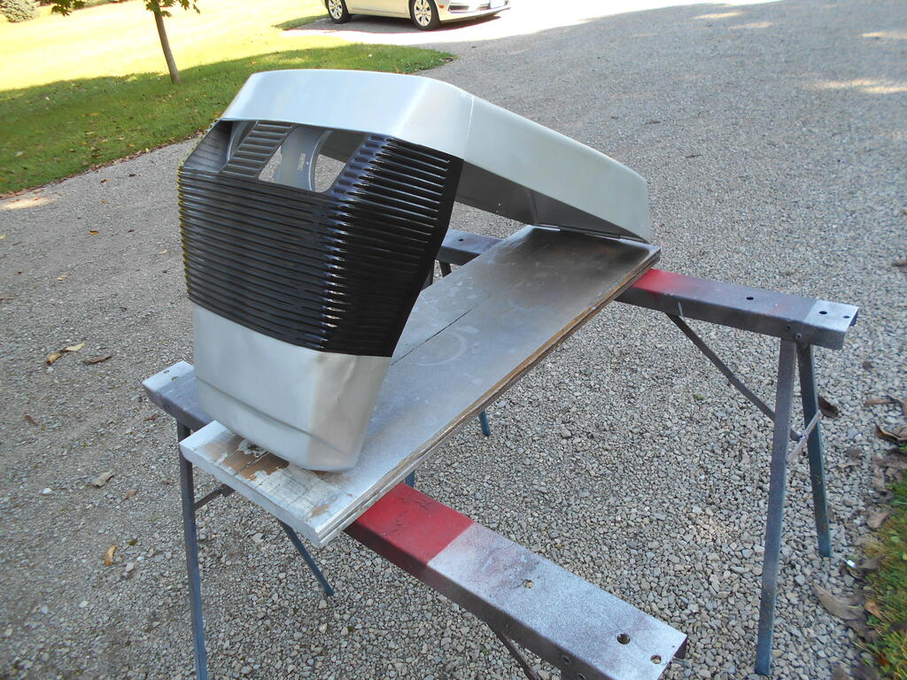

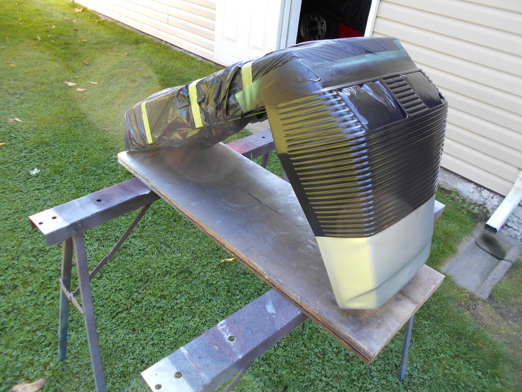

cleat 9,266 #187 Posted August 29, 2024 Hood black grill painted. 1 9 Share this post Link to post Share on other sites

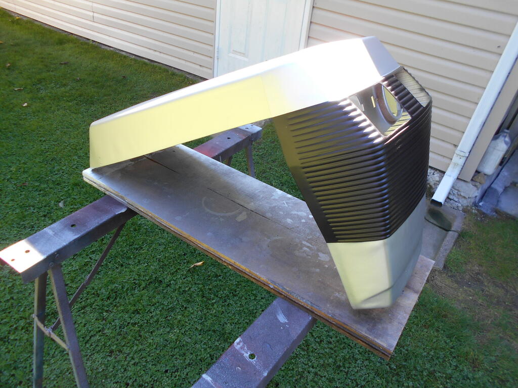

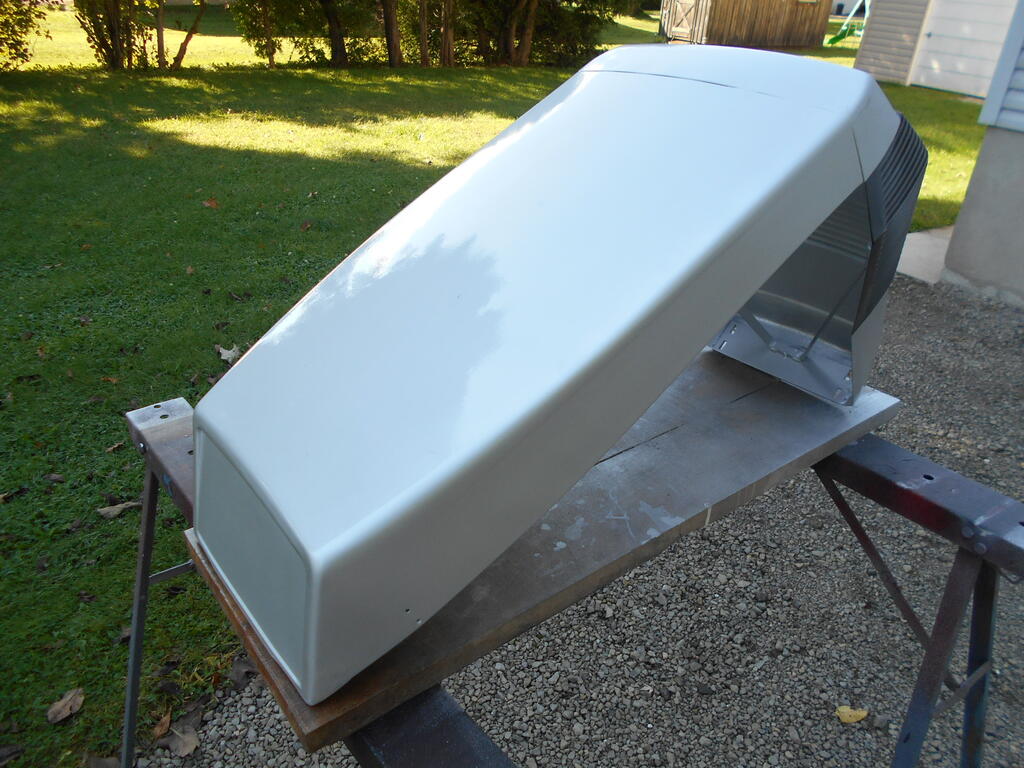

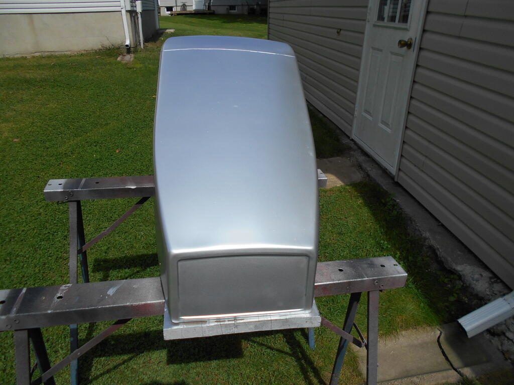

cleat 9,266 #188 Posted September 3, 2024 Hood clear coat done. 4 coats. 2 5 Share this post Link to post Share on other sites
ebinmaine 80,426 #189 Posted September 3, 2024 Looks excellent Cleat! 1 1 Share this post Link to post Share on other sites
kpinnc 18,915 #190 Posted September 3, 2024 1 hour ago, ebinmaine said: Looks excellent Cleat! Agreed!! Makes me wanna box up my 701 sheetmetal and send it to you! The color choice is awesome as well! 1 2 Share this post Link to post Share on other sites

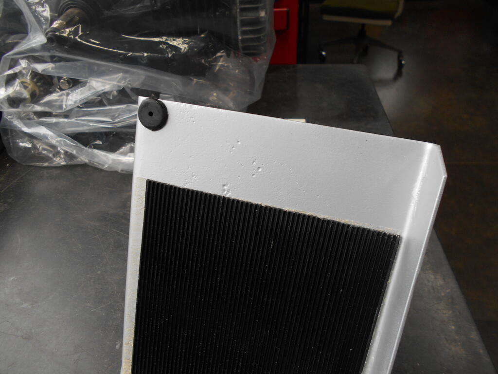

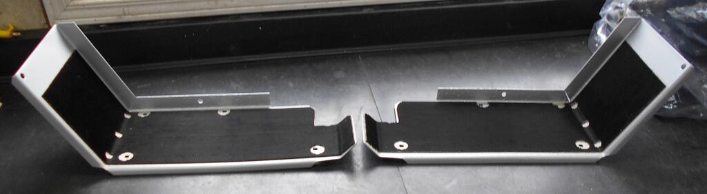

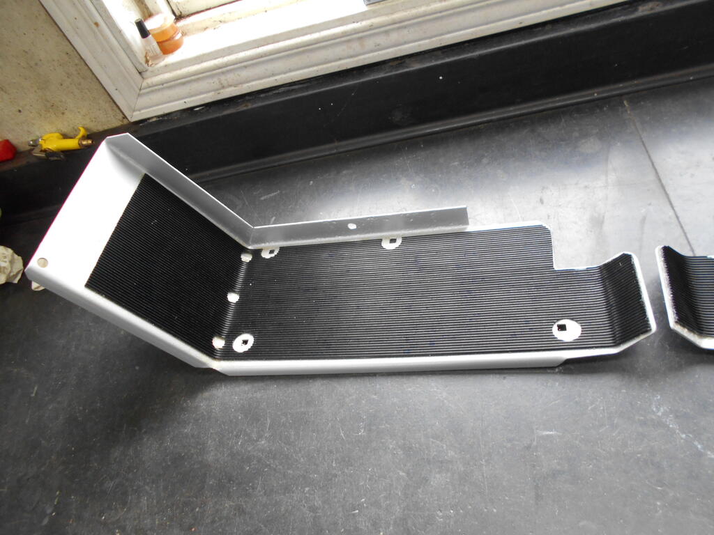

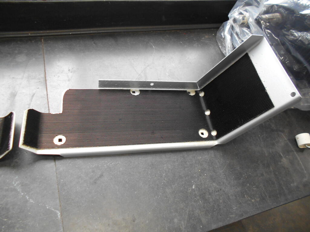

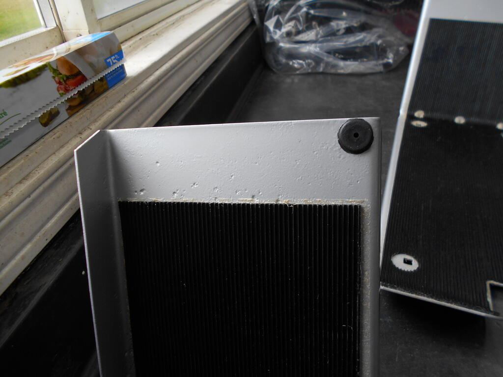

cleat 9,266 #191 Posted September 23, 2024 Footrest pads cut out and glued on. This is rubber sheeting that they ordered by mistake at work instead of gasket material years ago. I have used most of it up on all my tractors. Glue used is 3M 90 high strength spray adhesive used as contact cement. 6 1 Share this post Link to post Share on other sites
cleat 9,266 #192 Posted September 23, 2024 Footrest bumpers installed. 7 2 Share this post Link to post Share on other sites
Handy Don 17,358 #193 Posted September 23, 2024 2 hours ago, cleat said: Footrest bumpers installed. For sure you want to remember those! 1 Share this post Link to post Share on other sites
cleat 9,266 #194 Posted September 23, 2024 Funny thing is the parts manual for the GT1600 does not show them but the 520 manual does so I put them in. 1 Share this post Link to post Share on other sites
ebinmaine 80,426 #195 Posted September 24, 2024 51 minutes ago, cleat said: Funny thing is the parts manual for the GT1600 does not show them but the 520 manual does so I put them in. Were they OE on the GT1600 or was that part of the reason they were "price competitive"? Share this post Link to post Share on other sites
cleat 9,266 #196 Posted September 24, 2024 All I know for sure is the Work Horse came with the small footrest pads VS the 520 having the full length pad. As you see I installed the full length mainly to protect the paint. But also my 312's came with the small pads as well so I don't know where the cutoff is on those. The 312 parts manual does show the rubber bumpers though. They may have came on the Work Horse and the parts manual just overlooked them. 1 Share this post Link to post Share on other sites

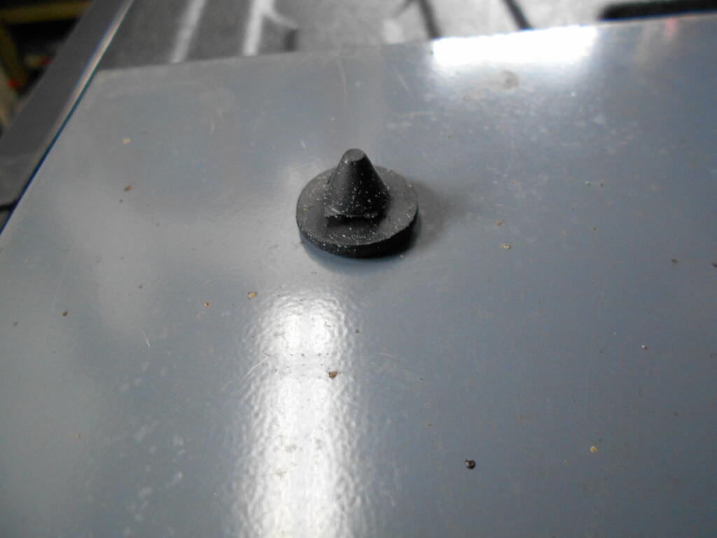

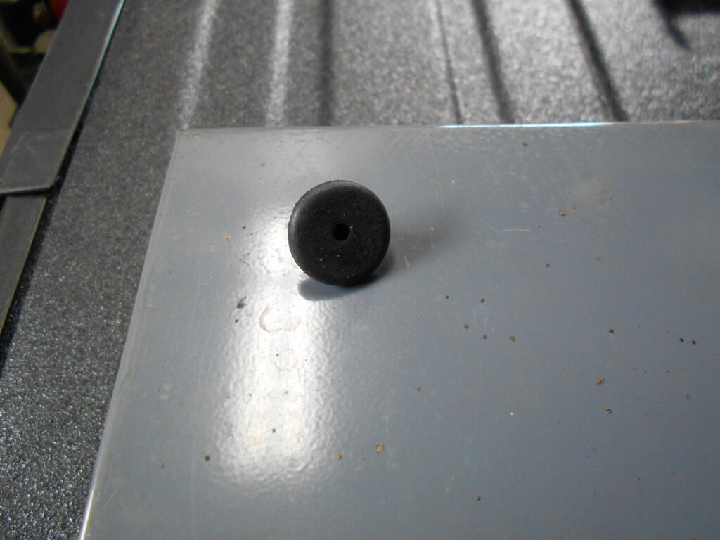

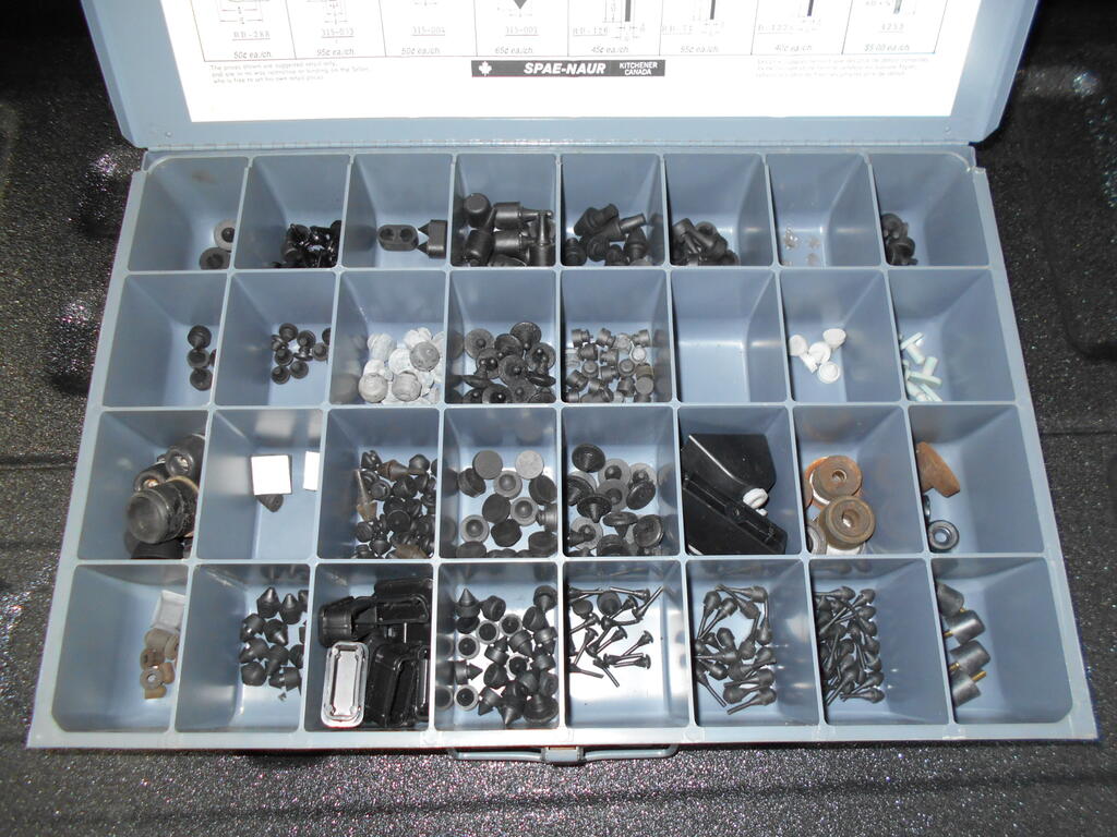

ebinmaine 80,426 #197 Posted September 24, 2024 6 hours ago, cleat said: As you see I installed the full length mainly to protect the paint. I do the same but I use skateboard/ stair tread safety tape. Basically sandpaper in 6" wide strips. What's the rubber bumper you're using? Source? My fenders tilt but I could use something to protect the fender from the "sandpaper". Share this post Link to post Share on other sites
cleat 9,266 #198 Posted September 24, 2024 4 hours ago, ebinmaine said: I do the same but I use skateboard/ stair tread safety tape. Basically sandpaper in 6" wide strips. What's the rubber bumper you're using? Source? My fenders tilt but I could use something to protect the fender from the "sandpaper". They came from this bumper assortment kit. It is this one. It is slightly too small so it does not snap into the hole as tight as I would like so I put a light coat of silicone on the bumper then popped it into the hole. Nice and secure now. Once the fender is in place it would be held as well. 3 1 Share this post Link to post Share on other sites

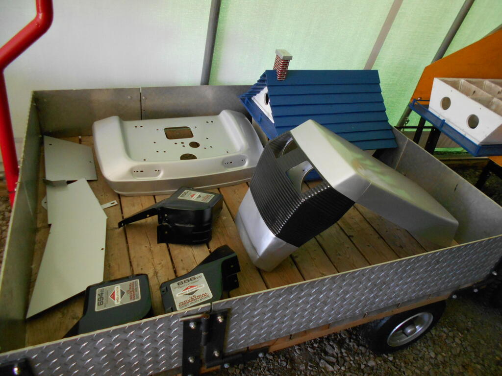

cleat 9,266 #199 Posted September 24, 2024 Hood, Fender, side covers, engine tins patiently waiting in the storage building. Paint will be well cured by the time these get installed over the cold winter months. 1 4 Share this post Link to post Share on other sites
kpinnc 18,915 #200 Posted September 24, 2024 3 hours ago, cleat said: Hood, Fender, side covers, engine tins patiently waiting in the storage building. Paint will be well cured by the time these get installed over the cold winter months. You are a patient man. That would keep me up at night! Looks so nice! 1 Share this post Link to post Share on other sites
