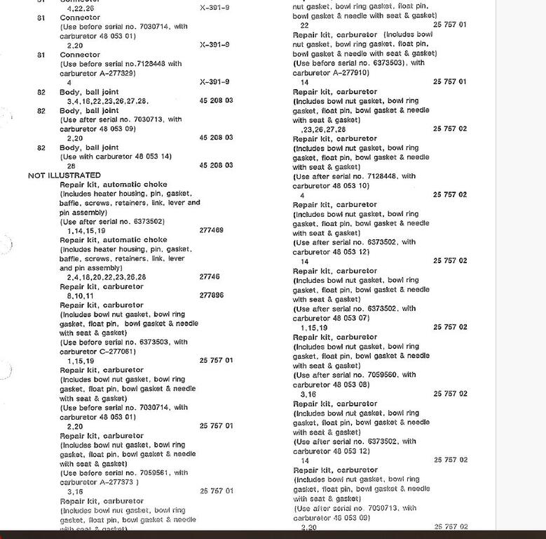

Parts manual shows two different carb kits.  What is eh spec number for your engine and the serial #

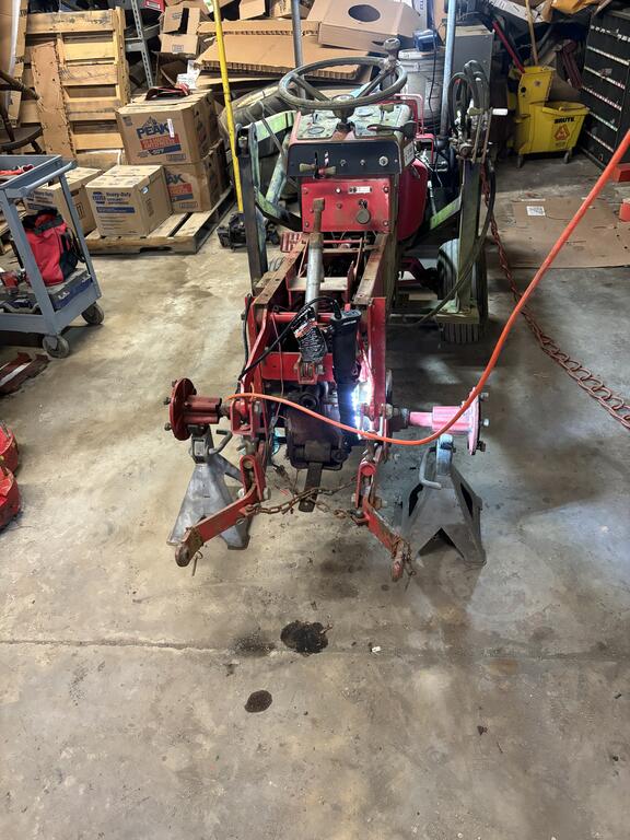

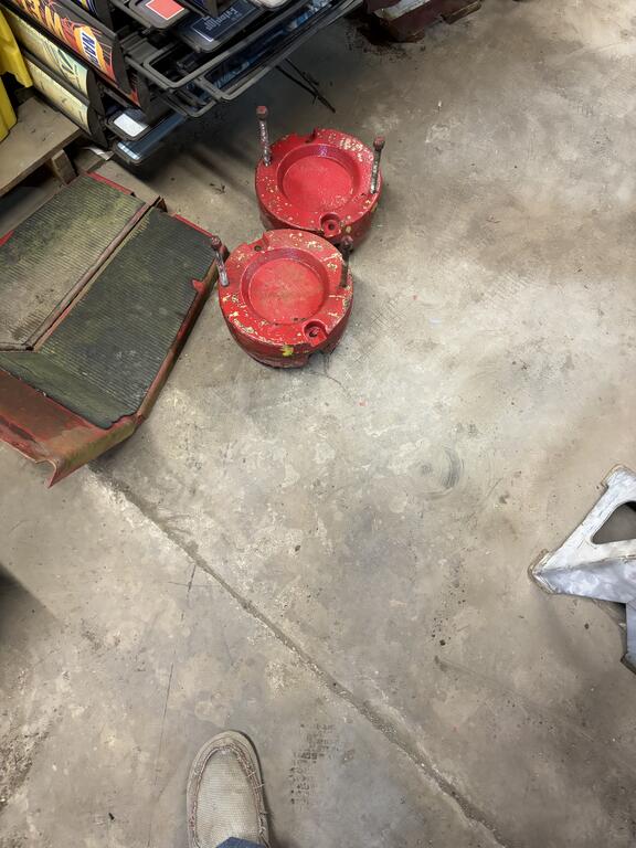

Just A little work done yesterday, got the weight and wheels off & up on stands :handgestures-thumbupright:

Based on the spec number that WH used the most 53105 The carb is variation 14.  However there is split between serial #s   older use 25757 01  later used 257502.  Will look at the serial # on my D200 later may give a clue...

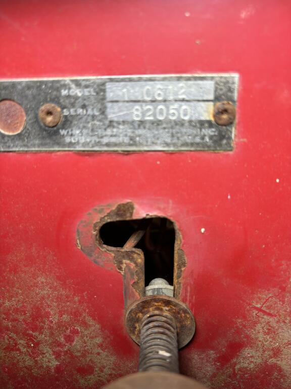

The I.D. plate off the tractor
  • Confused 1
pfrederi
That model number is for a  1975  D180 so you have the K 482 probably spec #35222 and is still carb variation 14.
The break point for 6373508  seems to be in mid 1974.  Hazard a guess you are after that so use the 2575702 kit

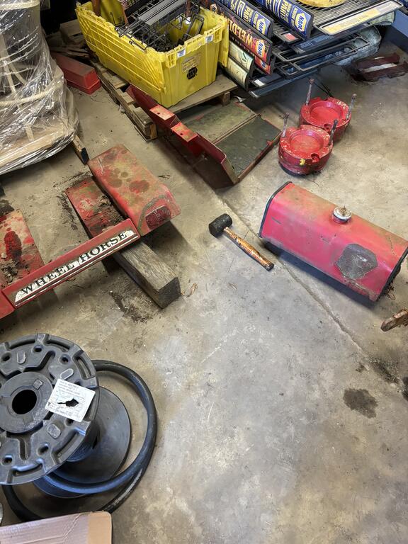

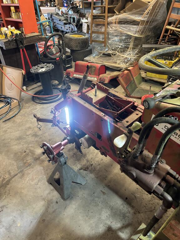

The Seat pan & Tank decided to go there separate ways thank goodness :handgestures-thumbupright:

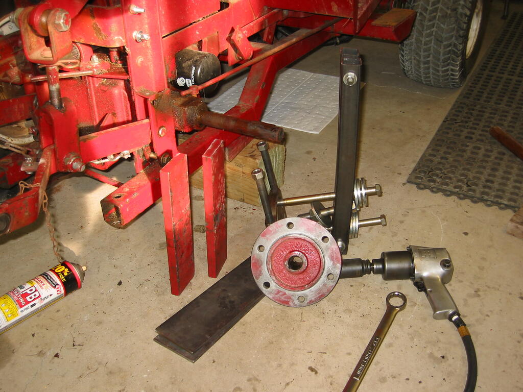

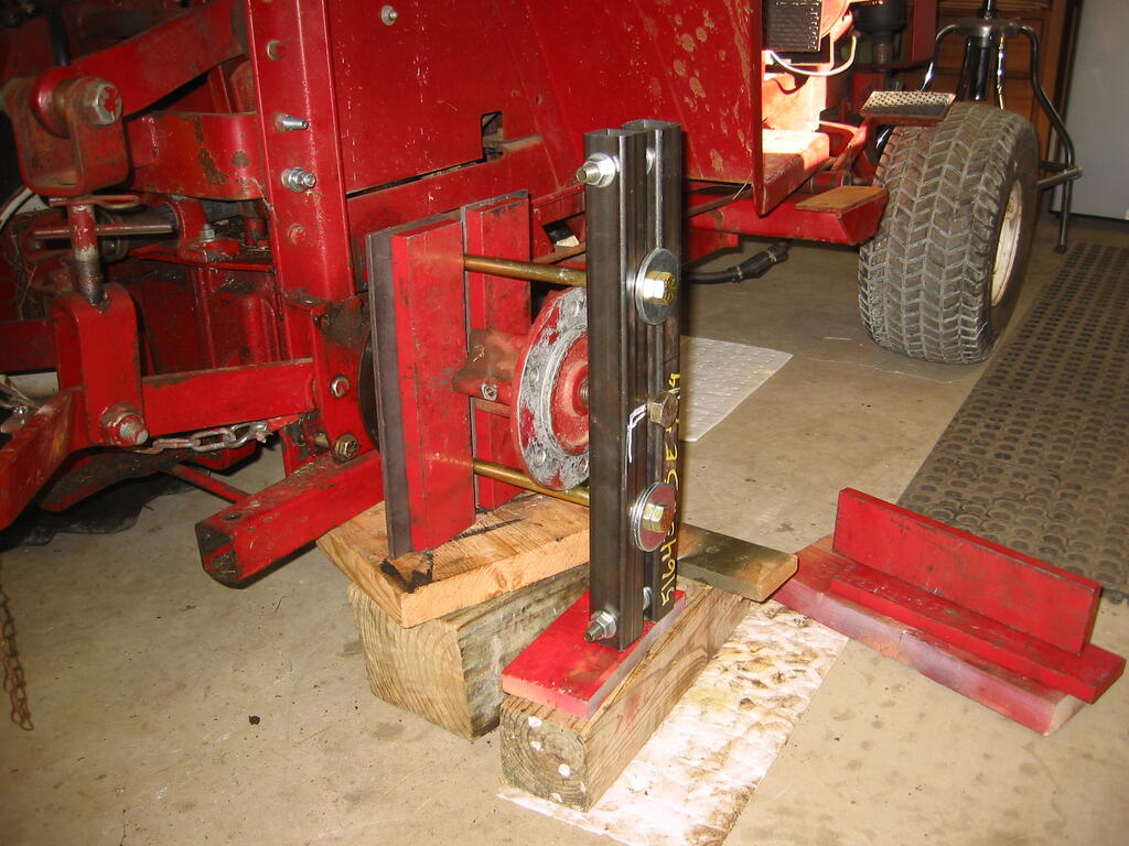

Any suggestions on getting the hubs off?? :ranting:
ebinmaine
That's a special science in itself.
A#1. Do NOT use a standard 3 jaw puller.
Any pics of where you're at?
  • Like 1
RED-Z06
And dont hit the back of the hubs...
  • Like 1

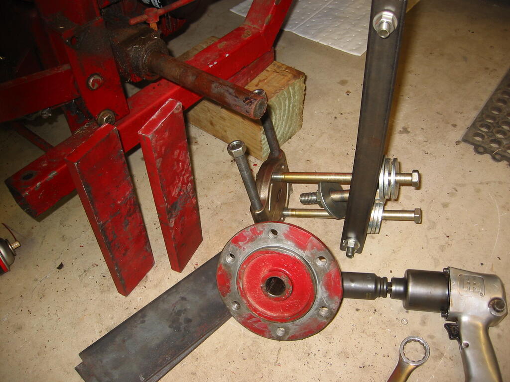

pfrederi
One of the more difficult tasks in WH land.  The body of the hub is much longer than other horses so there is more surface for rust to build a bond between the hub and the axle.  The flange is only slightly thicker than normal.  If you try to pull on the flanges you will mostly likely break it if the hub is stuck on .  You need to pull from the back of the hub.  This is how I did mine a few years ago...never hope to have to do that again.  You will note the square tubing has a bend to it.  It was straight when I started...
