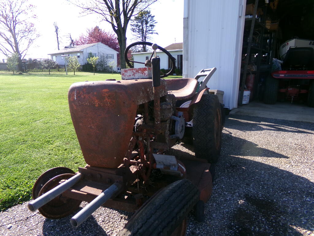

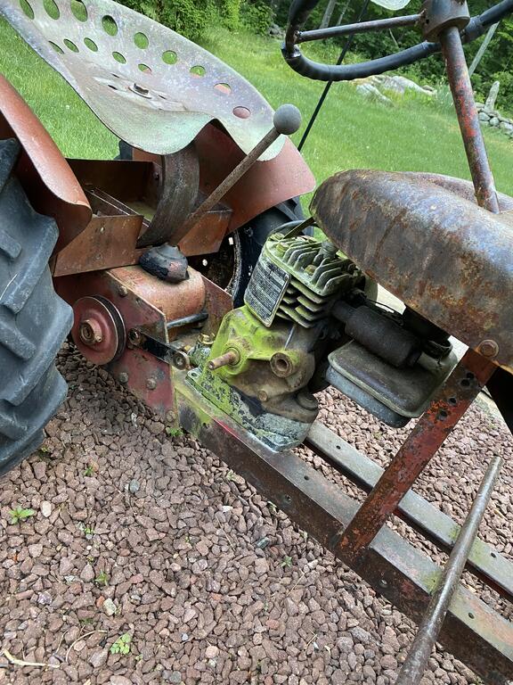

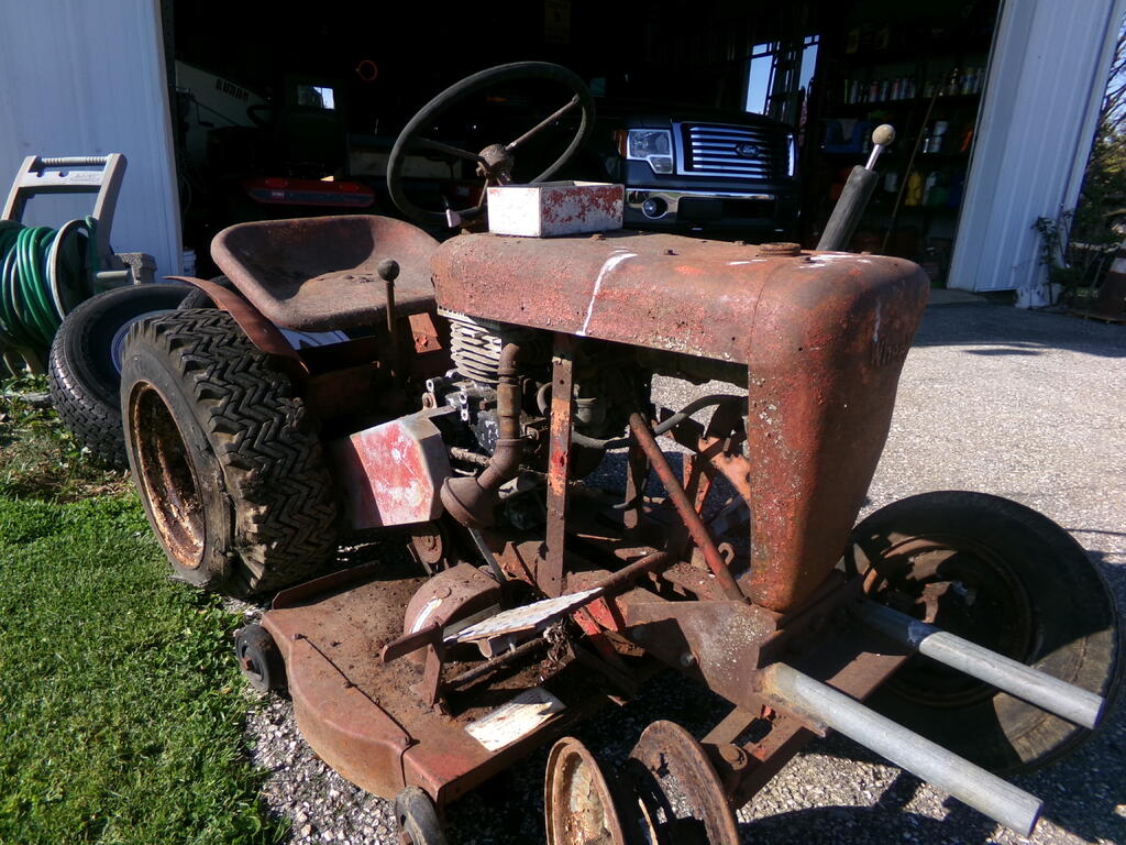

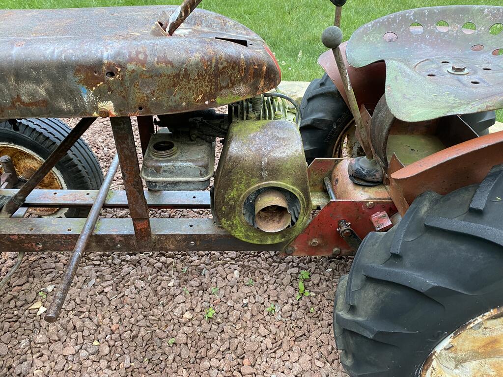

Ed Kennell 47,200 #1 Posted April 16, 2024 My neighbor is into old cars and just pulled in with this gem He found down in Md. Then he said he also had this in the bed of his truck. Said he brought it along in case I wanted it. Yep! Accepting all interest and info on it's ID. 4 10 Share this post Link to post Share on other sites
SylvanLakeWH 32,391 #2 Posted April 16, 2024 Nice truck! Nice ! (Early 60's RWP - Ran When Parked) Love the walrus tusks!!! Lucky man! 1 3 Share this post Link to post Share on other sites

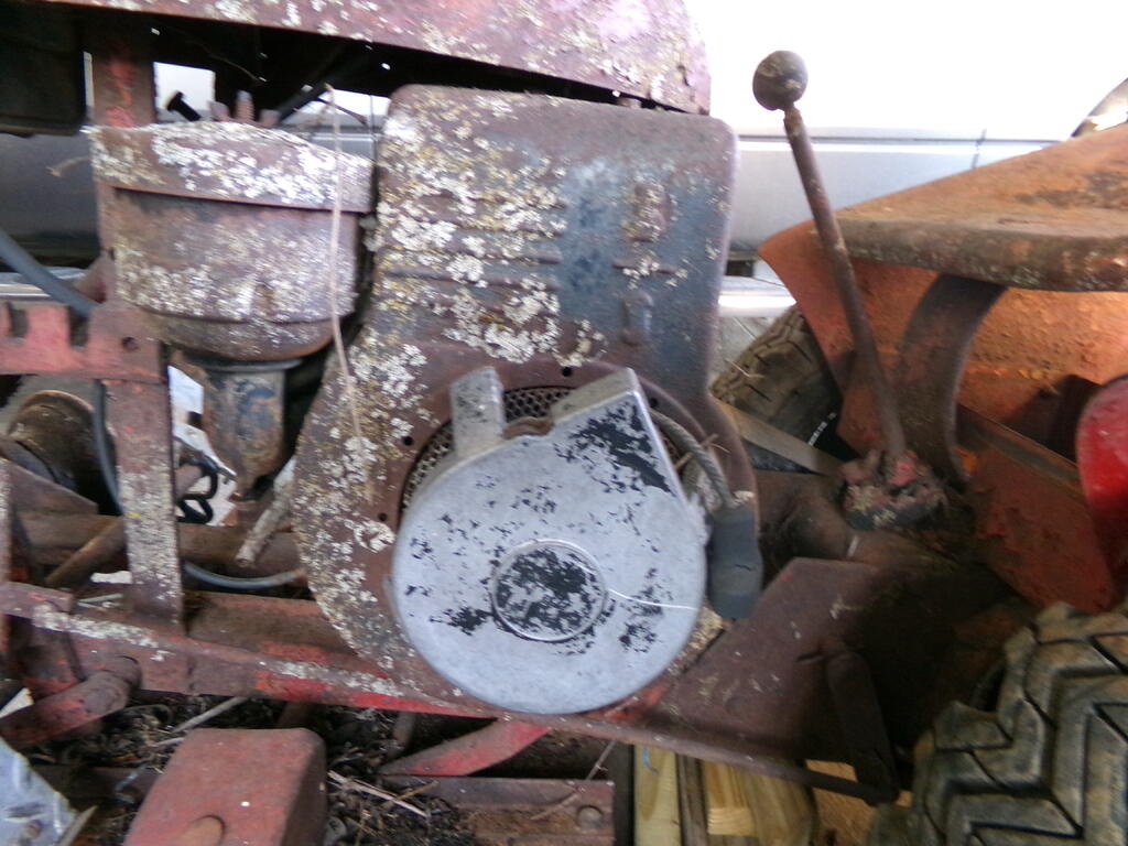

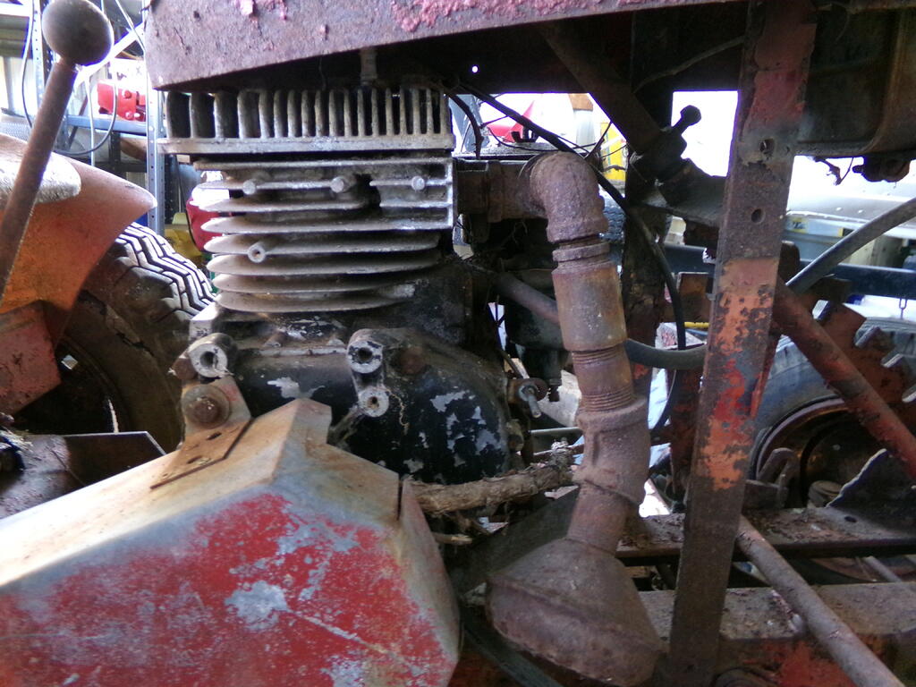

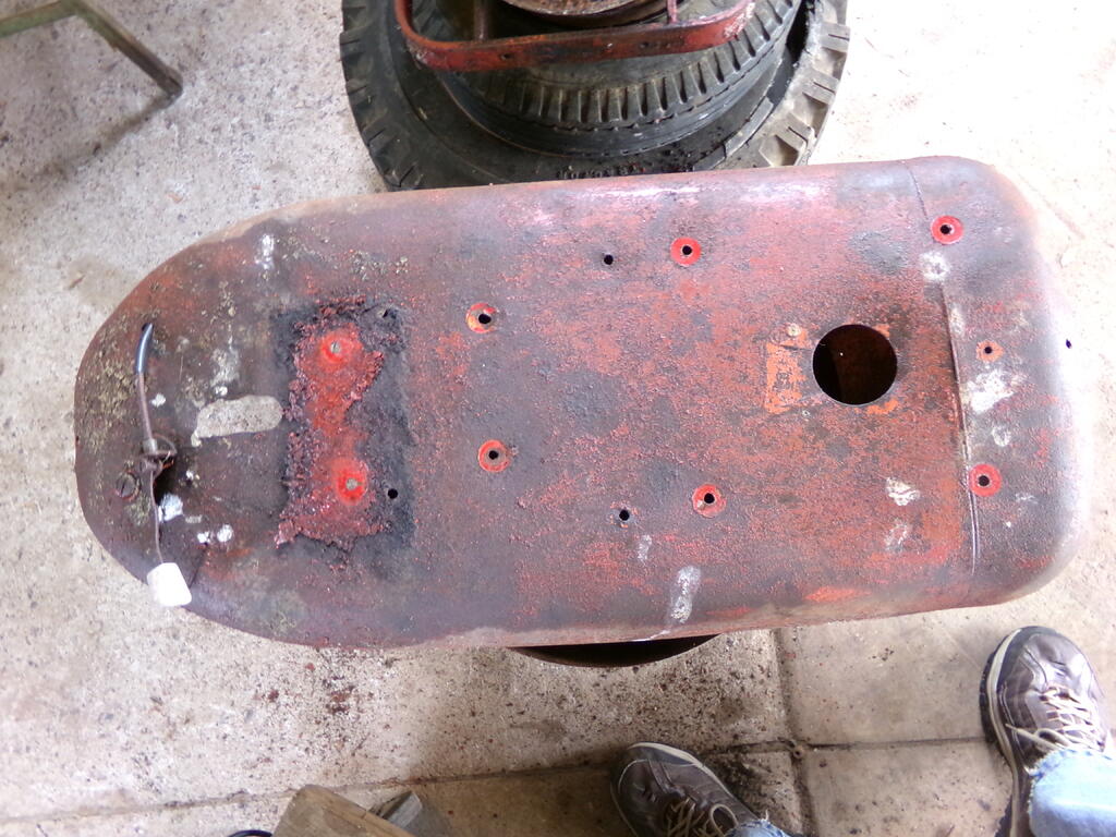

oliver2-44 11,730 #3 Posted April 16, 2024 Interesting RJ project. Wow, that Briggs engine has a Shower Cap Muffler.................Score 58/59 RJ Briggs not the original engine, but if it runs ......... Homemade belt guard, but nicely done. Left front rim might need a littttle fiberglass repair Seat should be a round hole seat. Dibbs on that square pan one, I might have a round hole one to trade you! Rectangular tube front axle is correct for RJ Hood has "Wheel Horse" stamped into it. Correct for 58/59 RJ Homemade foot rest. 3 Piece transmission. When you remove the tool box look if the top of the transmission has a date code cast in it. 4 1 Share this post Link to post Share on other sites
ri702bill 12,948 #4 Posted April 16, 2024 RR tire might need a tube...Ventilated RF rim might need a tire (and JB Weld) !! Nice score even if it ends up as "Yard Art". 1 Share this post Link to post Share on other sites

wallfish 20,571 #8 Posted April 17, 2024 A well weathered RJ-58. 1961 deck with a lift selector added on the tractor. Savable Trans likely has water in it. You should be able to read the cast code on the trans near the shifter. 1 1 Share this post Link to post Share on other sites

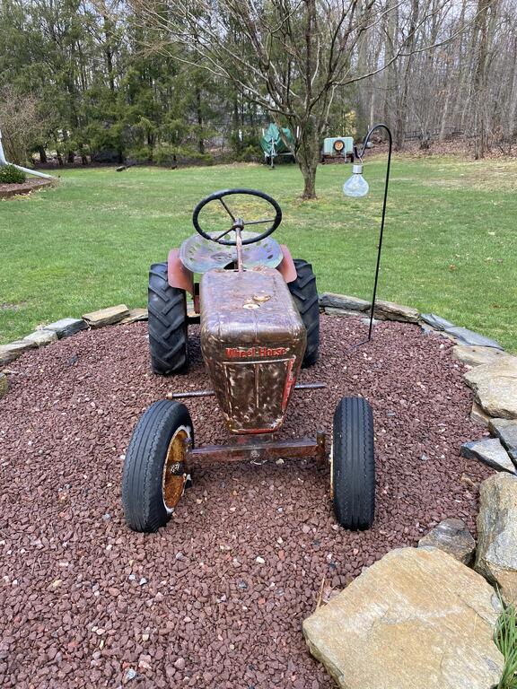

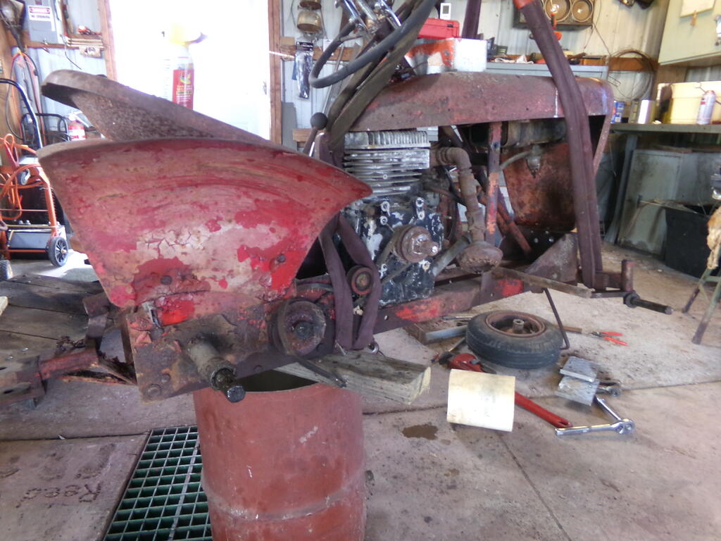

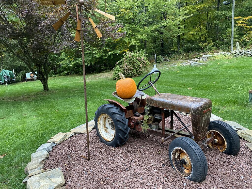

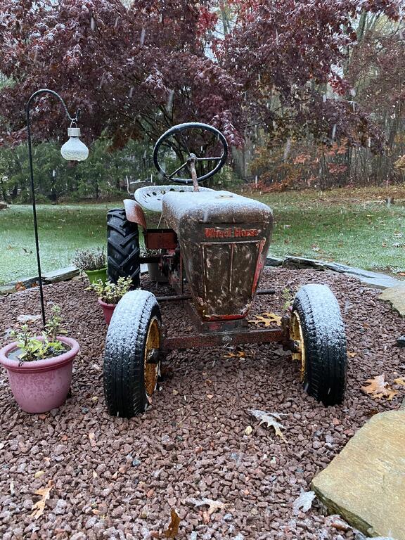

Sparky-(Admin) 26,278 #10 Posted April 18, 2024 11 hours ago, Blasterdad said: I've been looking for a "yard art" for a couple years now I'll probably find a crappy old blown up MTD or something & spray bomb it red. Except that MTD will look like trash and not “art” ! Nothing wrong with letting one retire. I clear-coated this one to stop it from rusting away. As you can tell I love showing it off as much as my running driving machines !! 4 3 5 Share this post Link to post Share on other sites

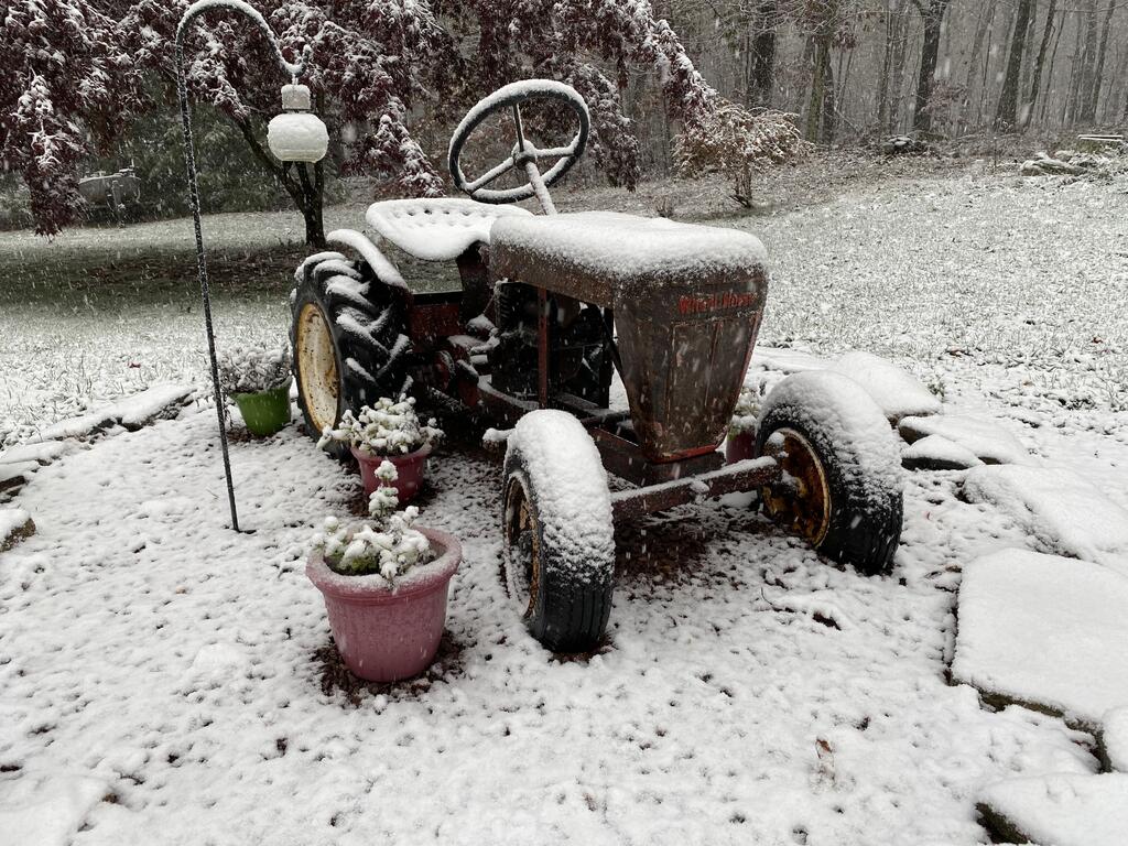

SylvanLakeWH 32,391 #11 Posted April 18, 2024 I give mine the @peter lena treatment... 3 2 1 Share this post Link to post Share on other sites
Pullstart 71,182 #12 Posted April 18, 2024 Other than giving it a Greasy Pete before storage, you could silicone the shifter shut, or better yet I set one out once for a Christmas lights holder and removed the shifter and siliconed a spray paint cap over the hole. 1 Share this post Link to post Share on other sites

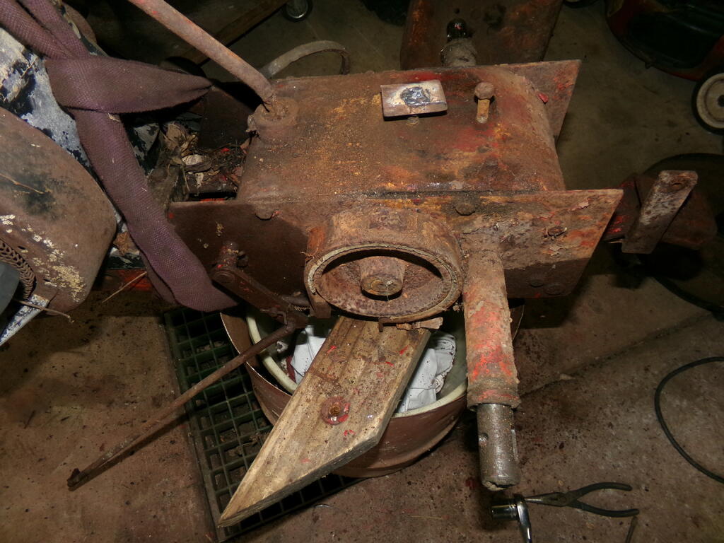

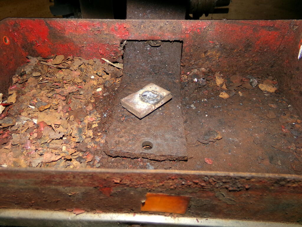

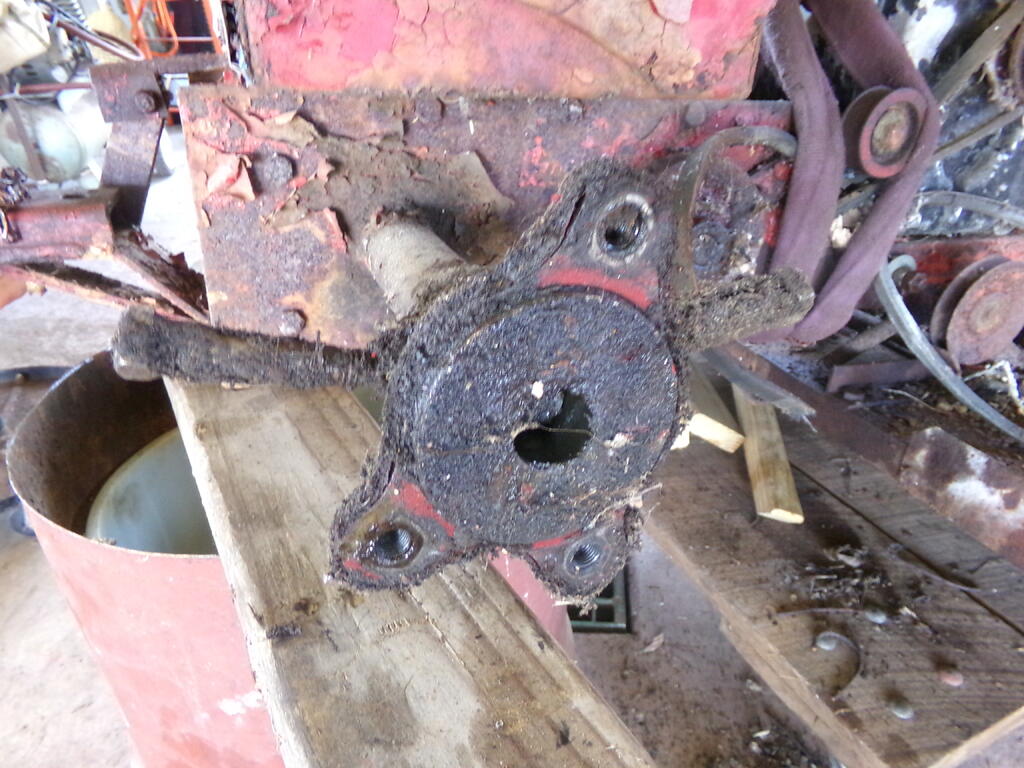

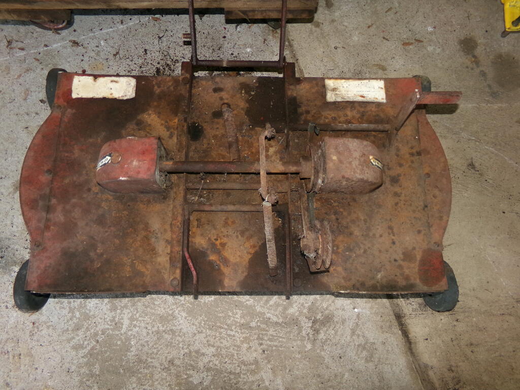

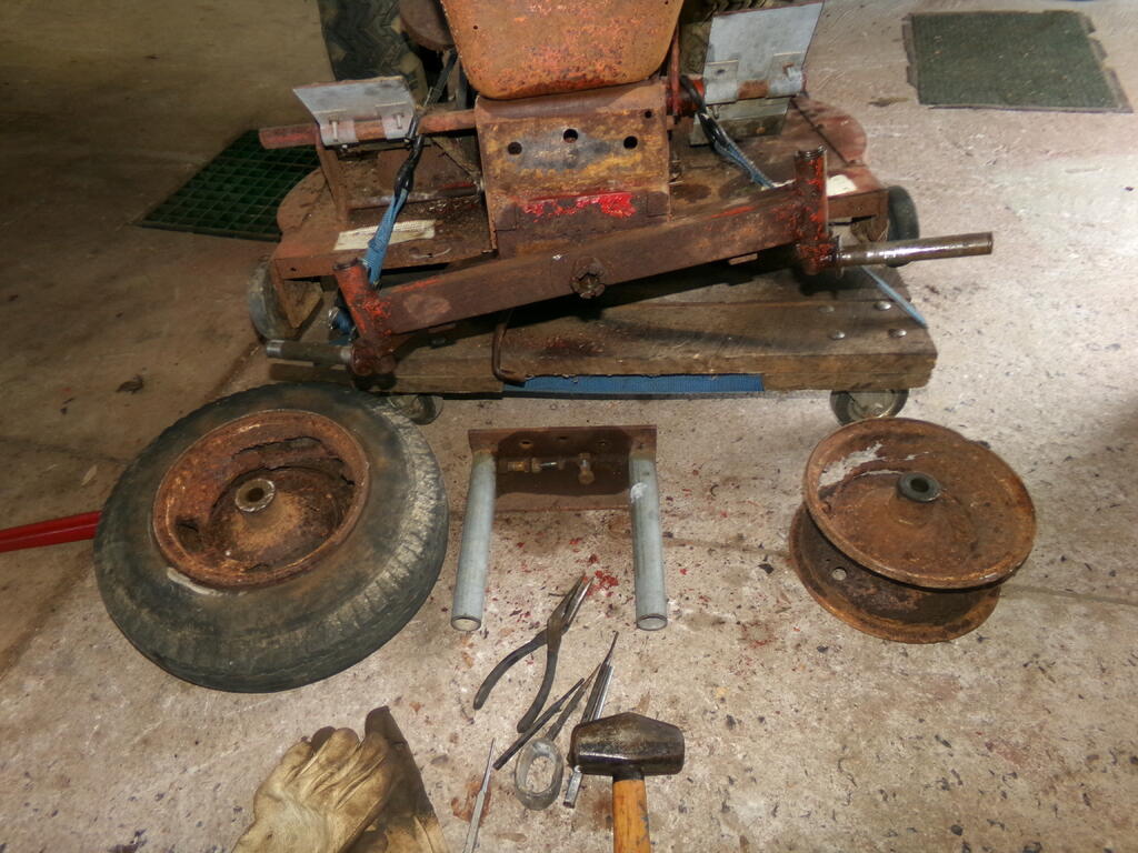

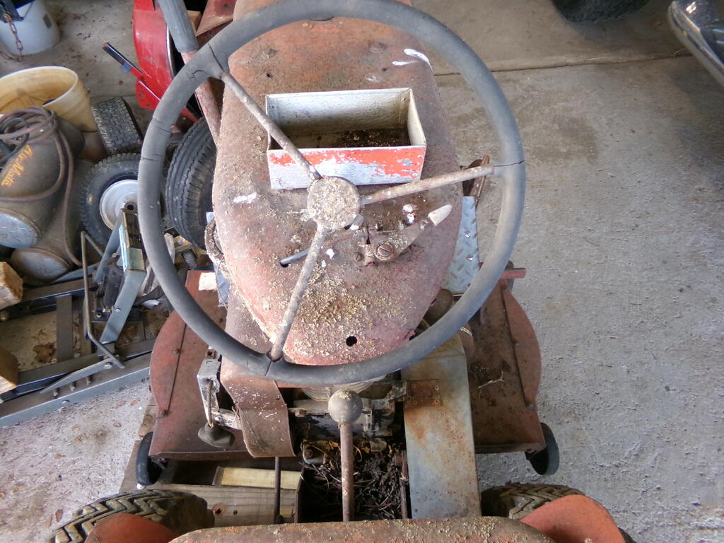

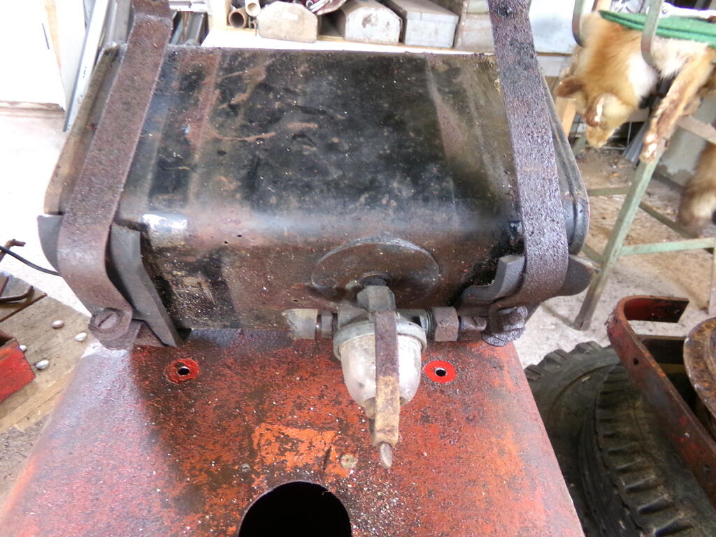

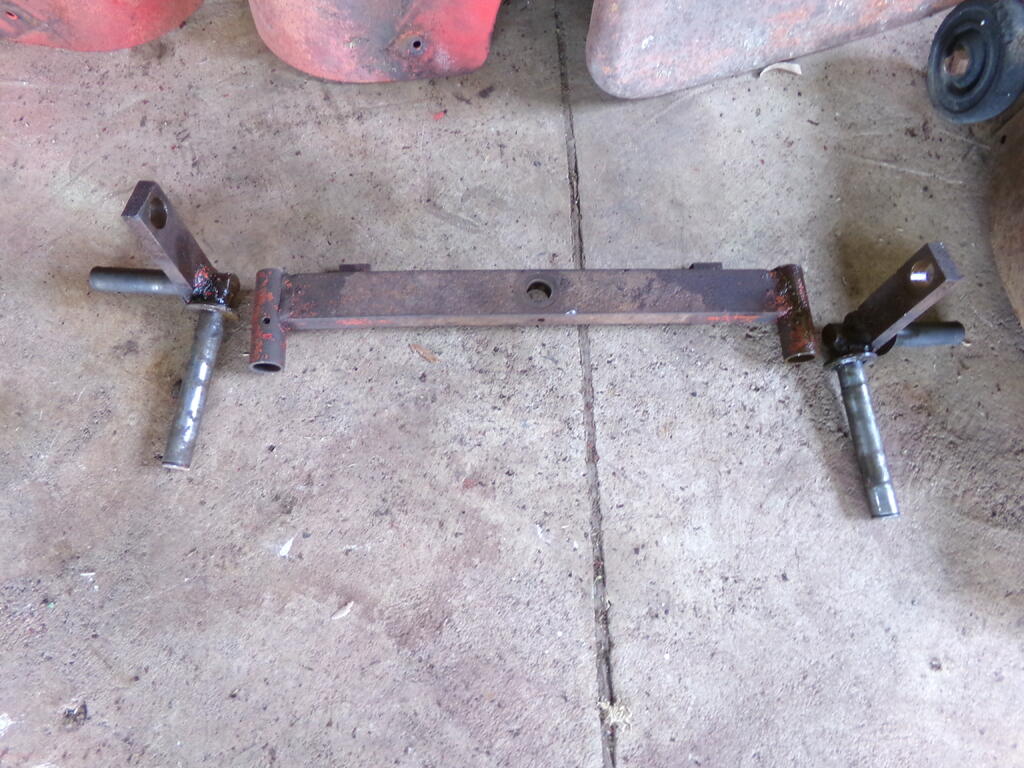

Ed Kennell 47,200 #14 Posted April 18, 2024 Had a couple hours this afternoon, So I took a closer look at Wally. I pulled his tusks. I don't know what the PO used them for, but they were bolted on with 3 grade 5 1/2" SAE bolts that are capable of pulling 36,000 lbs. Got the junk wheels and axle off. The spindles look good, but are still stuck in the axle and soaking. The rear wheels look OK and one is even holding air. The hubs, axles and keyways are OK. The tranny is free and works in all gear and needs axle bearings and seals. No water in the case. The shower head is rusted thru. Engine is locked and probably junk. Check these long hub set screws. The steering wheel is stubborn, but I will win. The deck shell looks good and the cast iron spindle support is not broke. It's locked up but I didn't attempt to free it yet. 1 8 Share this post Link to post Share on other sites

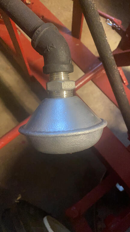

oliver2-44 11,730 #16 Posted April 19, 2024 4 hours ago, Ed Kennell said: The shower head is rusted thru. If the tapered back part is ok, I’ve seen where people rebuild the. By putting the front half of a pepper pot muffler on it. 1 1 Share this post Link to post Share on other sites
rjg854 13,334 #17 Posted April 19, 2024 I seem to remember @buckrancher making a new part for a showerhead muffler. 1 Share this post Link to post Share on other sites

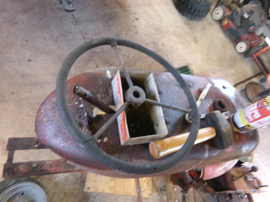

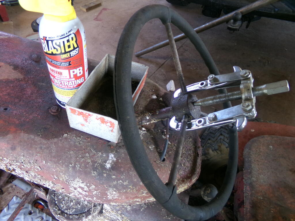

squonk 48,033 #18 Posted April 19, 2024 16 hours ago, Ed Kennell said: The steering wheel is stubborn, but I will win. The deck shell looks good and the cast iron spindle support is not broke. It's locked up but I didn't attempt to free it yet. Get a bearing separator and a bolt grip style puller on that. Way more power can be applied 1 1 Share this post Link to post Share on other sites

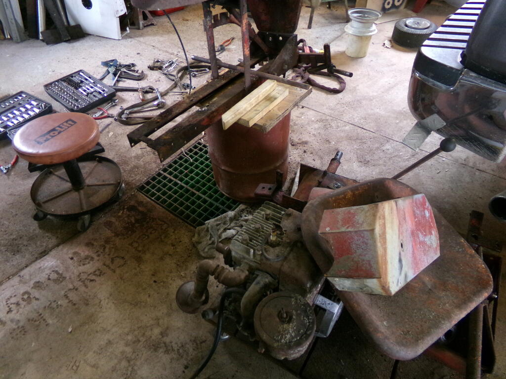

Ed Kennell 47,200 #19 Posted April 19, 2024 Well, Wally is a pile 0 parts now. The worse part was getting the frozen cotter pins out. I did have one bolt with most of the head missing. Had to weld on a new head. 2 Share this post Link to post Share on other sites
Lane Ranger 12,094 #20 Posted April 19, 2024 The shower head is rusted thru Ed : check if that shower head back is ok ! The back if good can have a new face put on ! You can pen off the old rusted one and pen on a new Pepper Pot Kohler muffler face on the old showerhead - they will fit perfectly! 1 1 Share this post Link to post Share on other sites

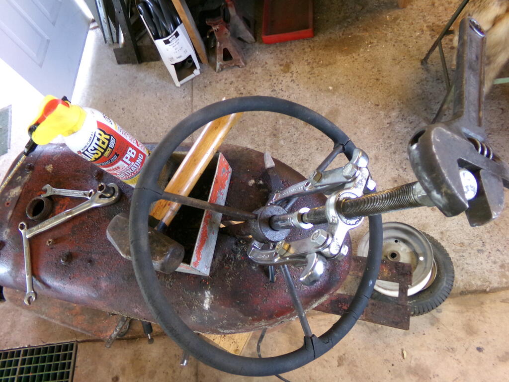

Ed Kennell 47,200 #23 Posted April 20, 2024 On 4/19/2024 at 11:31 AM, squonk said: Get a bearing separator and a bolt grip style puller on that. Way more power can be applied A bigger two jaw, bigger wrench, and one rap with the BFH and she left go. Now that only leaves the spindles stuck in the axle. 2 5 Share this post Link to post Share on other sites
Ed Kennell 47,200 #24 Posted April 21, 2024 (edited) Spindles are out. Clamped the axle in a big vise and twisted the spindles with a 36" pipe wrench. All looks good. Also got the steering shaft and the fuel tank out. Edited April 21, 2024 by Ed Kennell 4 3 1 Share this post Link to post Share on other sites
OoPEZoO 609 #25 Posted April 24, 2024 So, I met up with Ed yesterday and Sir Wally is now snuggly tucked away in my shop. I believe he is salvageable. Ed did the hard part, taking everything apart without busting anything.....well done sir, and thank you! I messed with the old Briggs a little this morning, and it freed up with just a little twist of the wrist. I stopped there as I'm assuming there is a lot of metal on metal with no lube inside. I'm going about trying to identify it right now. I can't seem to find any markings or stamping on the block, but I may not be looking at the right place. It is pretty cruddy and I can't coat myself in shop grease today due to other obligations. As far as the transmission, like Ed said, it appears to be free and shifting. I do not see any numbers cast into the top to identify it, but I believe it is 5003 due to the vertical tab on the side plate? I also don't want to touch it until I have time to clean it up and crack it open for fear of doing more damage. I believe it had been opened at one time, because it has gasket material sticking out from around the case, and if I read correctly, WH didn't use gaskets on these from the factory? So who knows what I will find. The rest of the tractor needs a solid going over with a lot of TLC, but everything seems solid and straight. There is a slight tweak in the steering shaft, but should be easily fixable. The frame and fenders are in great shape. Tool box and gas tank look salvageable. The back of the shower head muffler appears to be solid and salvageable. I'll soak the crap out of it and work slowly. Rear wheels are usable, tires are pretty much shot. The front wheels are gone, which is a shame as it appears finding something that fits correctly appears difficult and/or expensive. But I will manage and I'm not putting a timeline on it. If I have to, there are temporary options already in the shop. I was up until well after midnight last night researching and reading the RJ threads here. Especially with regards to rebuilding the transmission. I'm not sure what the end result will be with this guy. I believe that decision will have to wait until I find the internal condition of the engine and transmission. If the tranny is good, it will get rebuilt and continue to power Wally. Enginewise, if it is easily salvageable, I may reuse it. If not, then I'll be doing some bigger project brainstorming......probably of the electric driven nature. Either way, it should be fun. I'll start its own thread once some real work can begin. 4 Share this post Link to post Share on other sites
