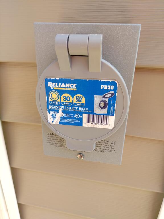

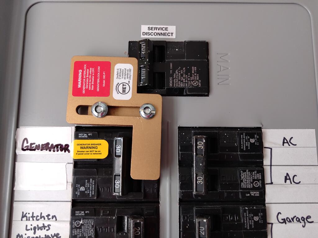

Racinbob 13,290 #10 Posted April 6, 2024 (edited) I use a 7250/9000 generator feeding the 200a main panel via a generator input recep in the garage (ignore the open panel, I'm currently installing a dedicated smoker recep) and a UL listed lockout device installed in the panel. It hots up everything. Plenty of power to run what we want but we don't use the electric clothes dryer in an outage. The two digital meters (upper right) tell me the voltage and amperage the generator is supplying. Gas furnace, water heater and range along with total LED lights and we're good to go with no worries. Phone reception here in the boonies is terrible and we need internet service for it so I have a UPS on the equipment. We get on the power company's website to get an idea how long we will be without power and decide if I want to fire up the generator. The white device right below the meters Has an inductive pickup with a wire wrapped around one on the incoming wires from the power company. I turn it on when I go to generator power. When it senses the power is back on it sounds a screech that will wake the dead. I also keep at least 20 gallons of no-booze gasoline in the garage, Edited April 6, 2024 by Racinbob 7 Share this post Link to post Share on other sites
Sparky-(Admin) 26,898 #11 Posted April 6, 2024 3 hours ago, Racinbob said: I use a 7250/9000 generator feeding the 200a main panel via a generator input recep in the garage Plenty of power to run what we want but we don't use the electric clothes dryer in an outage. The two digital meters (upper right) tell me the voltage and amperage the generator is supplying. Gas furnace, water heater and range along with total LED lights and we're good to go with no worries. Phone reception here in the boonies is terrible and we need internet service for it so I have a UPS on the equipment. We get on the power company's website to get an idea how long we will be without power and decide if I want to fire up the generator. The white device right below the meters Has an inductive pickup with a wire wrapped around one on the incoming wires from the power company. I turn it on when I go to generator power. When it senses the power is back on it sounds a screech that will wake the dead. Nice to see it hooked up correctly! So many people just do a dirty hookup. 5 Share this post Link to post Share on other sites

Racinbob 13,290 #15 Posted April 6, 2024 4 hours ago, Sparky said: Nice to see it hooked up correctly! So many people just do a dirty hookup. Thanks. I see that you did as well. I have little patience for those who don't do a proper tie it. So much can and does go wrong. A lot of people ask for my advice on this subject especially when we lived in Florida. I'm sure you do to. My first response to this, "if you're wanting to do it right I'll give you all the help you need. If not, don't even talk to me about it." 1 1 1 Share this post Link to post Share on other sites

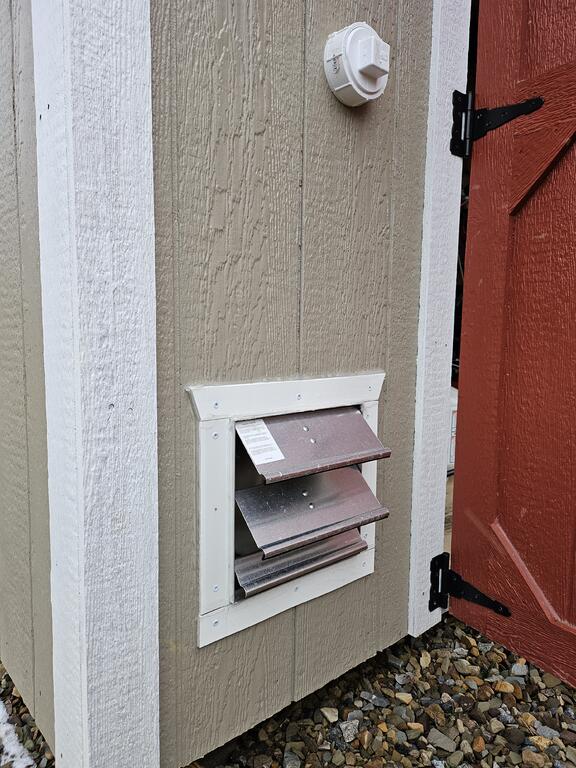

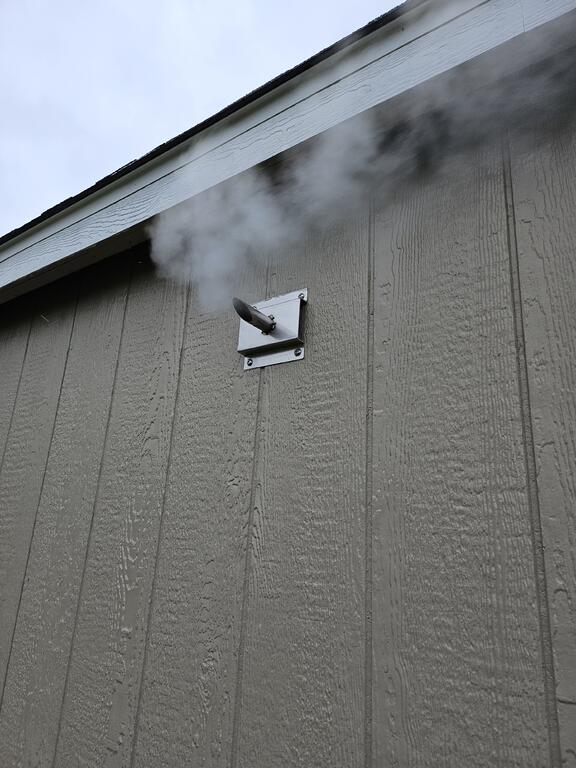

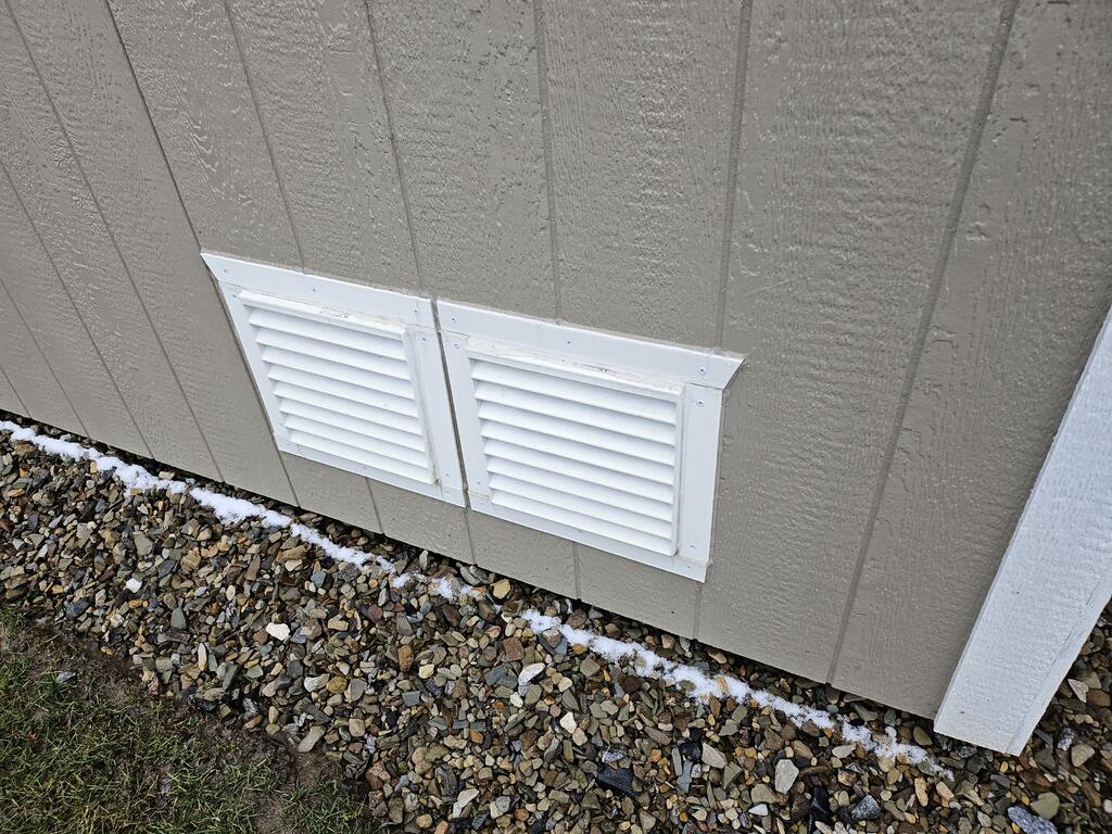

ML3 2,571 #16 Posted April 6, 2024 Electric start multi fuel Wen generator. Primarily run it on propane so then there's no carb issues w/stale gasoline. It's installed in shed. Battery always on a maintainer. Used soffit vents to draw air in & attic shutter vent to remove heat and any possible fumes. Also got the halon ball as a precaution. Exhaust purchased for indoor generator applications & is shielded entirely & especially where it passes thru shed siding. Have a 4" pvc pipe capped thru side of shed that I run the 30a cord to plug on back of house (about 14') Interlock switch assures main is disconnected if generator is in use. Control what I power with breakers. So in inclement weather generator stays inside, dry, etc. Also have a small Westinghouse 2200w inverter generator that also will run on propane. If its a summertime outage & furnace & other items don't need to run its way more fuel efficient. I made a 120v standard plug to 30a adapter cord. Actually the little generator will run the furnace. 4 3 Share this post Link to post Share on other sites

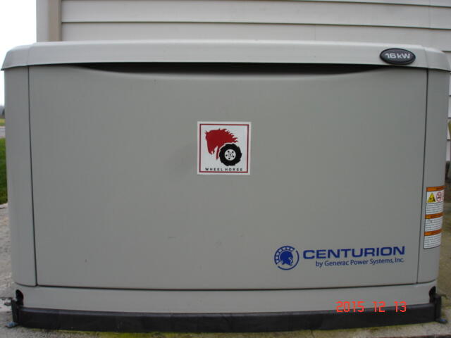

Marv 996 #24 Posted April 7, 2024 This takes care of me. 16000 watt whole house, automatic. Takes the manual / physical load off me. So glad to have it. Marv 1 Share this post Link to post Share on other sites
