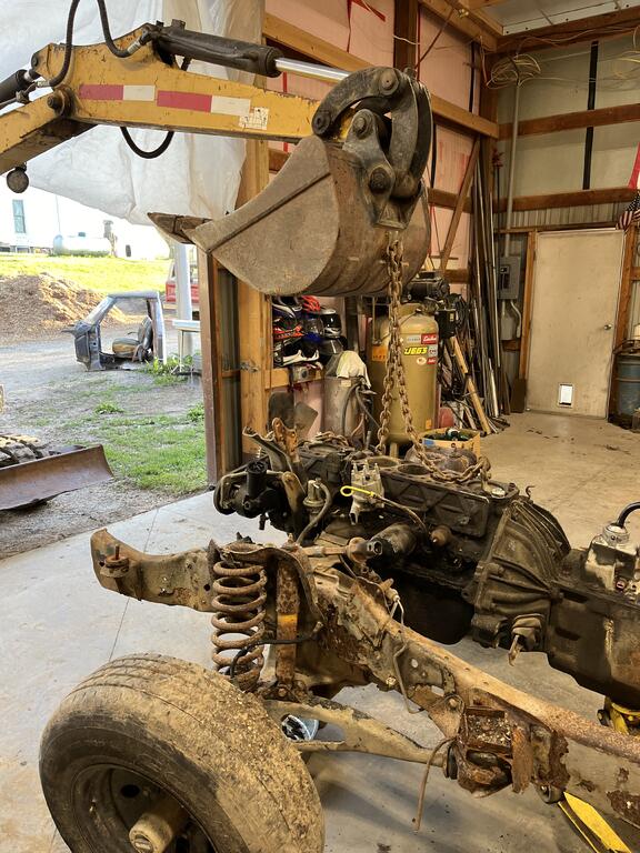

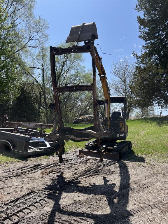

87 416-8 horse 430 #52 Posted April 30, 2024 Pulled the engine out with the excavator and the rear axel. Now it’s time to slice and dice the frame with the torch. 1 Share this post Link to post Share on other sites

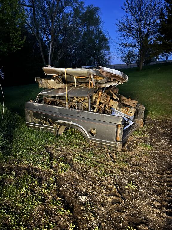

87 416-8 horse 430 #55 Posted May 1, 2024 The parts truck is now a pile of truck parts and scrap. Everything in front of the fuel tanks are parts. 1 Share this post Link to post Share on other sites

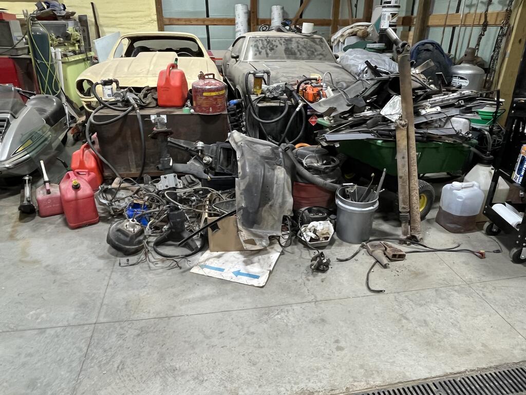

adsm08 4,899 #57 Posted August 12, 2024 On 4/30/2024 at 11:09 PM, 87 416-8 horse said: What's the not-yellow car? 1 Share this post Link to post Share on other sites
87 416-8 horse 430 #58 Posted August 13, 2024 4 hours ago, adsm08 said: What's the not-yellow car? It’s a 1971 Oldsmobile cutlass supreme. We have to do some frontend work and rebuild the transmission. 1 Share this post Link to post Share on other sites
adsm08 4,899 #59 Posted August 13, 2024 19 hours ago, 87 416-8 horse said: It’s a 1971 Oldsmobile cutlass supreme. We have to do some frontend work and rebuild the transmission. I was close. My dad has a 72 Pontiac Ventura and I was thinking the lines that I can see looked similar. 1 Share this post Link to post Share on other sites

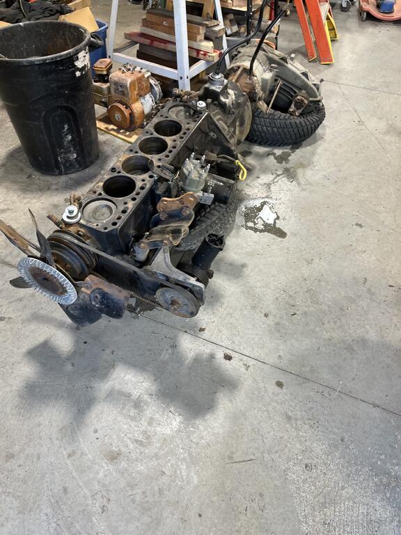

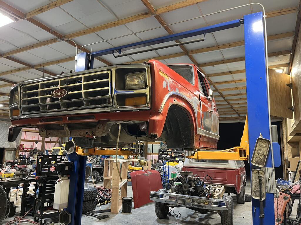

87 416-8 horse 430 #60 Posted September 12, 2024 The project has begun! A couple weeks ago I took the head from the parts truck engine to be ported out. It turns out it was cracked. Last night we pulled the cab and stripped the engine down. I’m going to have it bored out and the head ported out to let it breathe. Next I'm going to strip the frame down and repaint it with frame paint and primer. 1 1 Share this post Link to post Share on other sites

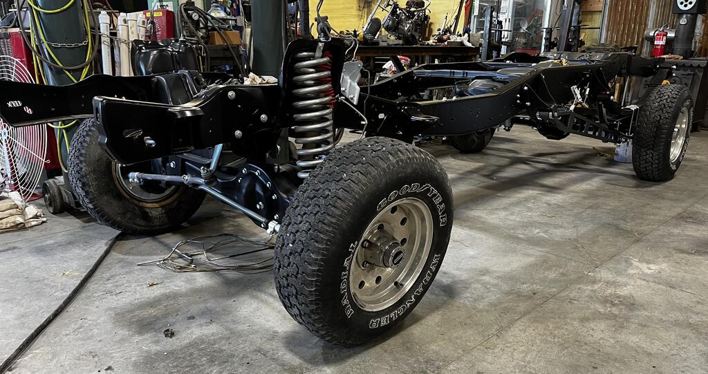

87 416-8 horse 430 #61 Posted October 19, 2025 Well I guess it’s been a little over a year since the last update… I’m still working on the truck around work and school and I’ve made some progress. The chassis is pretty much complete besides running wires and tightening a few things up. The project has snowballed a lot more than I anticipated, went from just cleaning the frame up to completely stripping it down and having every single piece of hardware zinc plated. Also went ahead and installed some traction bars to keep the axle under the truck with the power. I don’t know of if I mentioned before that I installed a 4” lift as well. I haven’t really touched the body yet but that’s coming up soon. The engine is back from the machine shop and ready for assembly once I get all the parts gathered up. I had an aggressive port job done on the head, bored the block .050” over to run flat top pistons from a 390fe v8, and decked the head .010”. I have a 268 comp cam I’m going to slip in then going to run a 4brrl Holley sniper and add some boost with a turbo. My goal is to be somewhere around 500hp. I have a lot of other plans but those come later. 4 2 Share this post Link to post Share on other sites
