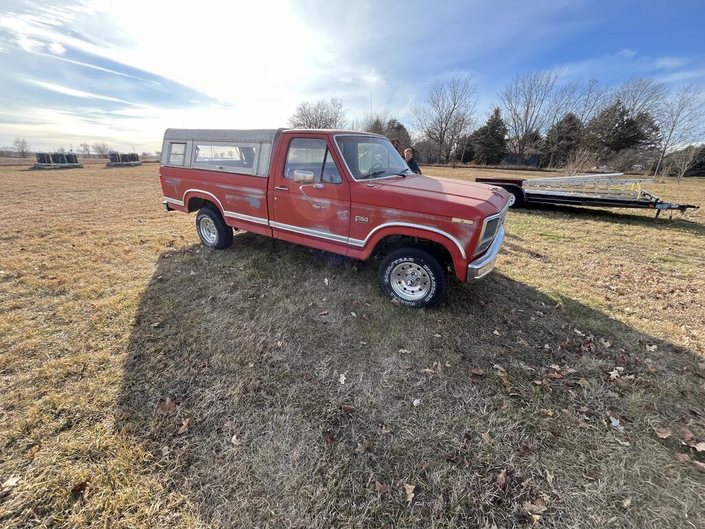

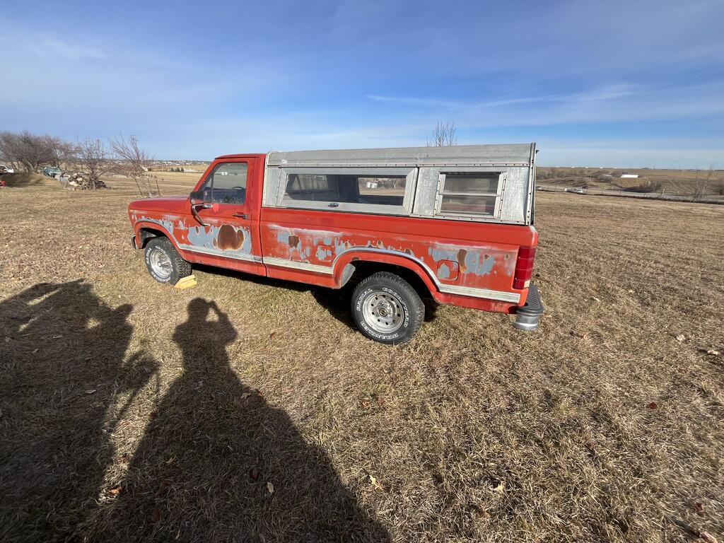

87 416-8 horse 430 #1 Posted April 5, 2024 This is a topic for the build/fix up of my 1986 ford f150. There may be a while in between the post because I work on it in my spare time when I’m not too busy. It has a 300 inline 6 with a four speed manual transmission. Regular cab long bed 4x4. 7 2 1 Share this post Link to post Share on other sites
87 416-8 horse 430 #2 Posted April 5, 2024 (edited) So far I’ve cleaned out the gas tanks, replaced rear tank sending unit, buffed it, cleaned up the wiring, installed HEI distributor, EFI split exhaust manifolds, and 2 barrel carb conversion. Im probably missing some things. My plans are to make a nice reliable truck to daily drive and enjoy. I still have a ways to go! Edit, if anyone has any suggestions or ideas let me know! Edited April 5, 2024 by 87 416-8 horse 4 Share this post Link to post Share on other sites

C-85 811 #11 Posted April 5, 2024 I may have missed it, but I didn't notice how many miles are on it, so that would be good to know. I worked at a new car Ford/Mercury/Lincoln/Merkur/Heavy Truck dealer for 14 years. I think the most popular vehicle that was sold was just like your truck! I can't say enough good things about the 300 4.9L, which unfortunately was the end of their straight sixes . I'm hoping that they don't use much (any) road salt in Nebraska and that rust won't be an issue. At the dealership I worked at our 'push truck' (the truck we used to push dead vehicles in the shop with a big rubber faced front bumper on it) was this same truck, what a workhorse it was! I hope you write about the progress! C-85 2 Share this post Link to post Share on other sites
87 416-8 horse 430 #12 Posted April 6, 2024 (edited) 4 hours ago, C-85 said: I may have missed it, but I didn't notice how many miles are on it, so that would be good to know. I worked at a new car Ford/Mercury/Lincoln/Merkur/Heavy Truck dealer for 14 years. I think the most popular vehicle that was sold was just like your truck! I can't say enough good things about the 300 4.9L, which unfortunately was the end of their straight sixes . I'm hoping that they don't use much (any) road salt in Nebraska and that rust won't be an issue. At the dealership I worked at our 'push truck' (the truck we used to push dead vehicles in the shop with a big rubber faced front bumper on it) was this same truck, what a workhorse it was! I hope you write about the progress! C-85 It has 53k original miles. Sadly Nebraska uses tons of salt. So the time it spent in Nebraska made it rust just a little bit. It has about a 4-5 inch hole in the floor and a bit in the rear of both box sides. Edited April 6, 2024 by 87 416-8 horse 2 Share this post Link to post Share on other sites
ebinmaine 80,078 #13 Posted April 6, 2024 3 hours ago, 87 416-8 horse said: 3 hours ago, 87 416-8 horse said: It has about a 4-5 inch hole in the floor and a bit in the rear of both box sides Luckily there are websites with pretty much whatever you want for this vintage truck. Plenty of replacement panels. 1 Share this post Link to post Share on other sites
87 416-8 horse 430 #14 Posted April 6, 2024 9 hours ago, ebinmaine said: Luckily there are websites with pretty much whatever you want for this vintage truck. Plenty of replacement panels. Yep, I got a replacement floor pan from summit racing for $45. I plan on fix the rust here soon. 1 Share this post Link to post Share on other sites
