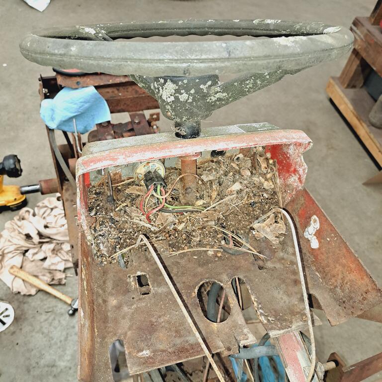

WHX?? 53,697 #1 Posted April 1, 2024 Since this is turning out to be a resto starting a new thread here. The original thread... Not much progress as some health issues really slowing me up. Some pics and progress by the end of the day right now I gotta try and climb up in the parts shed loft and see if I have a hood for @c-series don. 4 1 Share this post Link to post Share on other sites

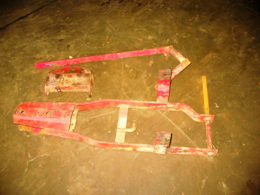

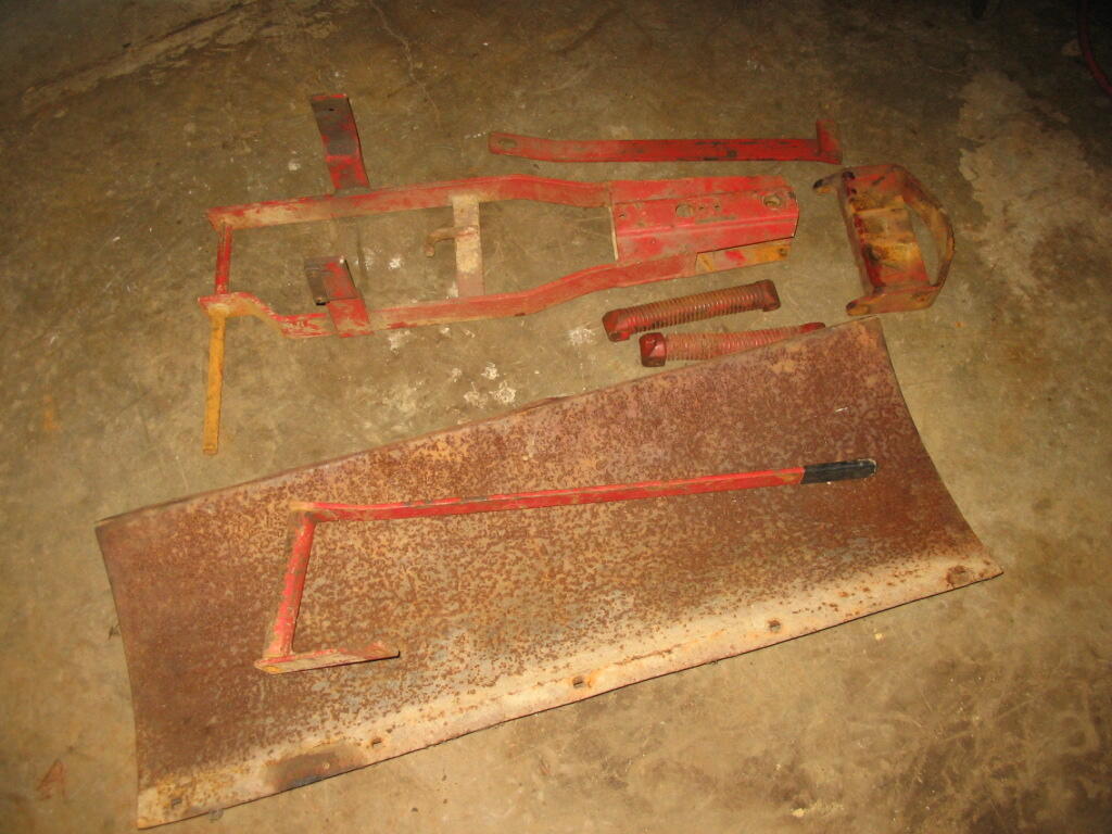

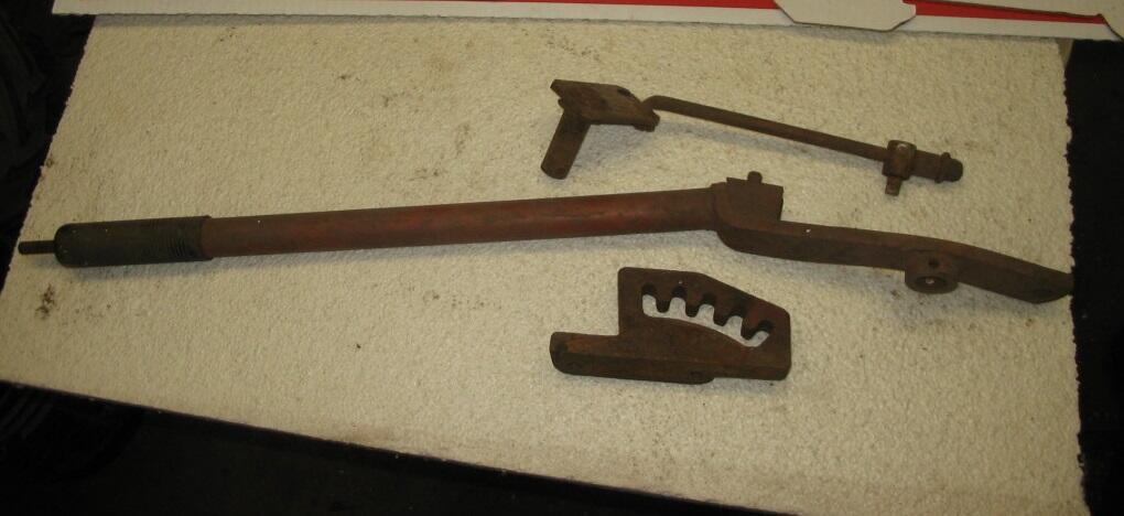

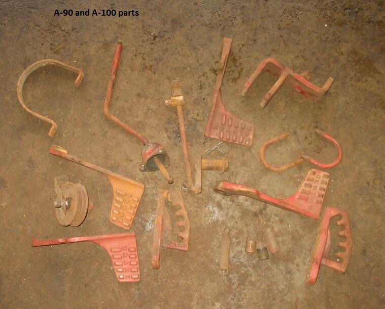

daveoman1966 3,881 #3 Posted April 1, 2024 I can likely find a hood for the A-90... Also have an assortment of other A-90 parts.... as well as a dozer blade. See pics. I am in n/w PA...40m southe of Lake Erie. 2 1 Share this post Link to post Share on other sites

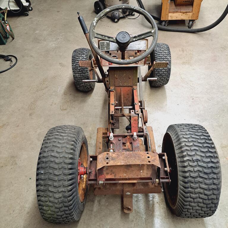

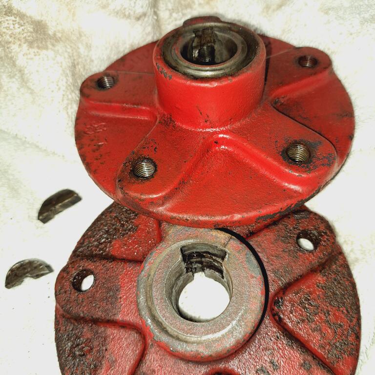

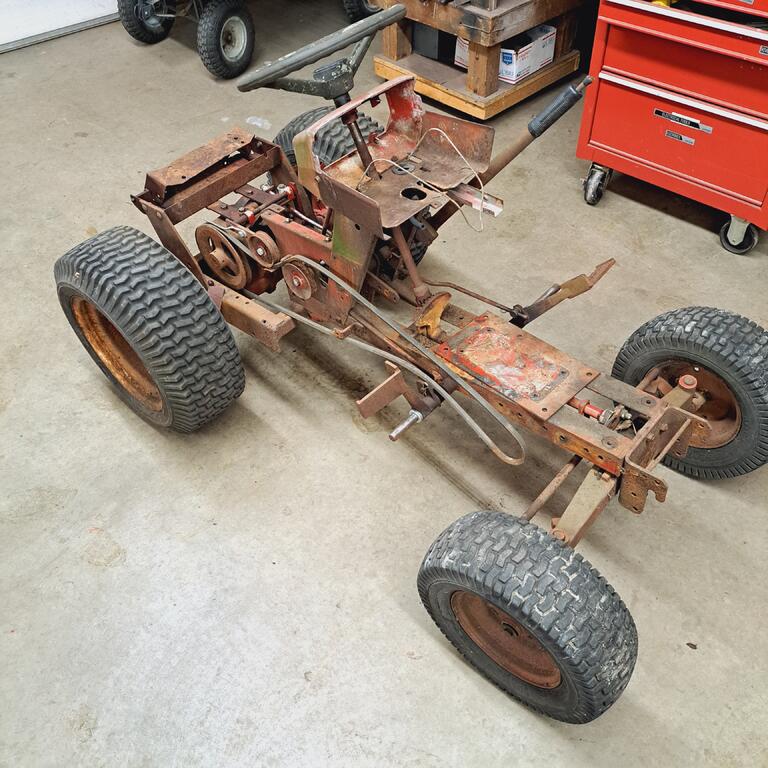

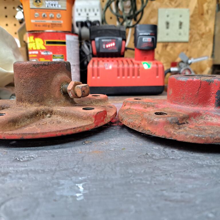

WHX?? 53,697 #8 Posted April 1, 2024 (edited) Shouldn't need any parts @daveoman1966 but thanks and will keep you in mind I do. For a basket case all parts were ther. She is a roller now. Steering was froze up solid. Fan gear, tie rods, spindles and everthing. I won in the end. Brake & clutch all freed up and workin as should. Hubs ... worst I ever seen. New keyways & crack in one I need to try and weld up. Was going to replace them but their not like standard hubs. Shorter and different diameter for the rim hole. Axles have the key very close to the axle bearing. Standard hub on the left. Edited April 1, 2024 by WHX?? 4 1 1 Share this post Link to post Share on other sites

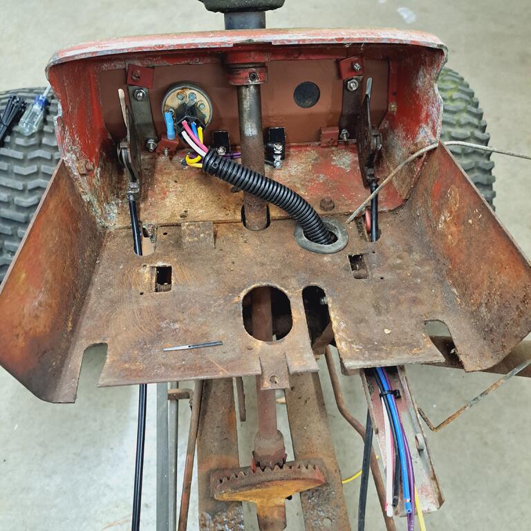

WHX?? 53,697 #15 Posted April 9, 2024 (edited) New switches & ig switch harness. Old ig switch cleaned up and checked good. Choke & throttle rusted tight. Managed to save one but had to replace the other. Edited April 9, 2024 by WHX?? 6 Share this post Link to post Share on other sites
