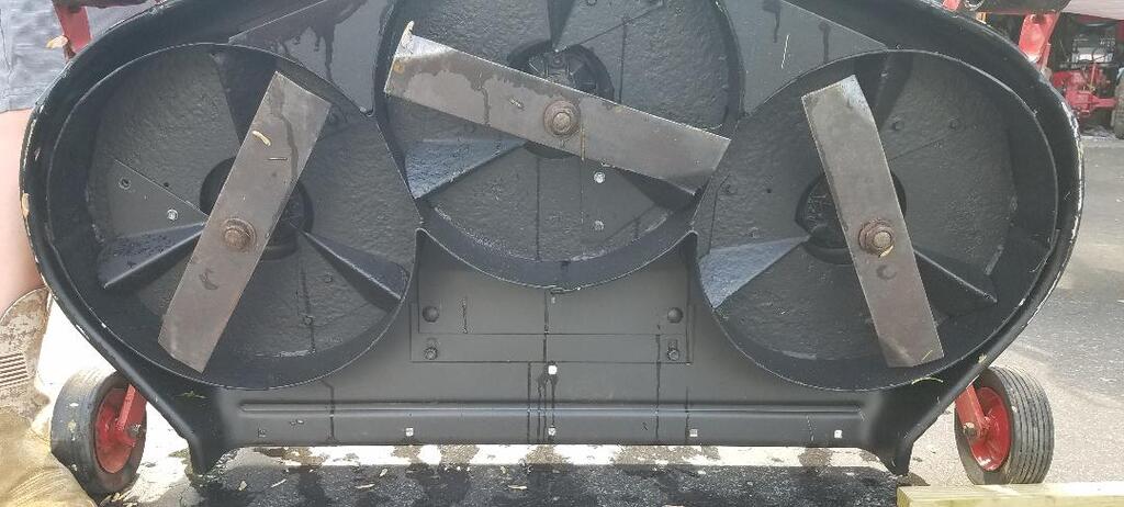

Lane Ranger 12,133 #6 Posted March 28, 2024 17 minutes ago, ebinmaine said: Is this an option that was marketed by Wheelhorse at some point? How do you know if a deck is just that? wheelhorse/toro made a recycling deck in 42 and 48 versions that is a mulched. I own one . Closed like a rear discharge and has a baffle system inside. 1 Share this post Link to post Share on other sites
ebinmaine 80,917 #7 Posted March 28, 2024 1 minute ago, Lane Ranger said: . Closed like a rear discharge and has a baffle system inside. Well that's interesting. Share this post Link to post Share on other sites

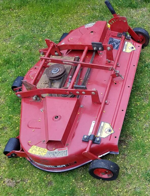

Brockport Bill 2,481 #8 Posted March 28, 2024 17 minutes ago, ebinmaine said: Well that's interesting. here is what 42 " recycler mower deck looks like from bottom - - also note the end of the deck from top side view there is a decal that says "recycler" 1 1 Share this post Link to post Share on other sites
ebinmaine 80,917 #9 Posted March 28, 2024 The things ya learn!!! 1 Share this post Link to post Share on other sites
Brockport Bill 2,481 #10 Posted March 28, 2024 the 42 rear discharge recycler is model # 78355 if you want to look it up -- from 1994-98 1 1 Share this post Link to post Share on other sites
JimSraj 585 #11 Posted March 31, 2024 (edited) Anyone know if the mounting hardware on a 42” recycler (78355)is the same as on a SD(78345)? Looks the same except for the brackets that hold the gauge wheel rod. Edited April 2, 2024 by JimSraj Wrong number Share this post Link to post Share on other sites
