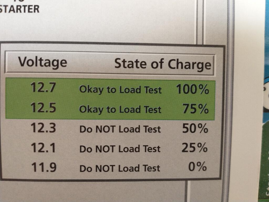

lynnmor 8,970 #11 Posted March 24, 2024 Here is some good information about charging voltage. Read the paragraph under minimum voltage. 1 1 Share this post Link to post Share on other sites
ebinmaine 80,078 #12 Posted March 25, 2024 20 hours ago, lynnmor said: Here is some good information about charging voltage. Read the paragraph under minimum voltage. Share this post Link to post Share on other sites
