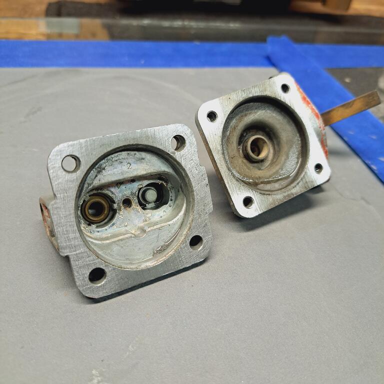

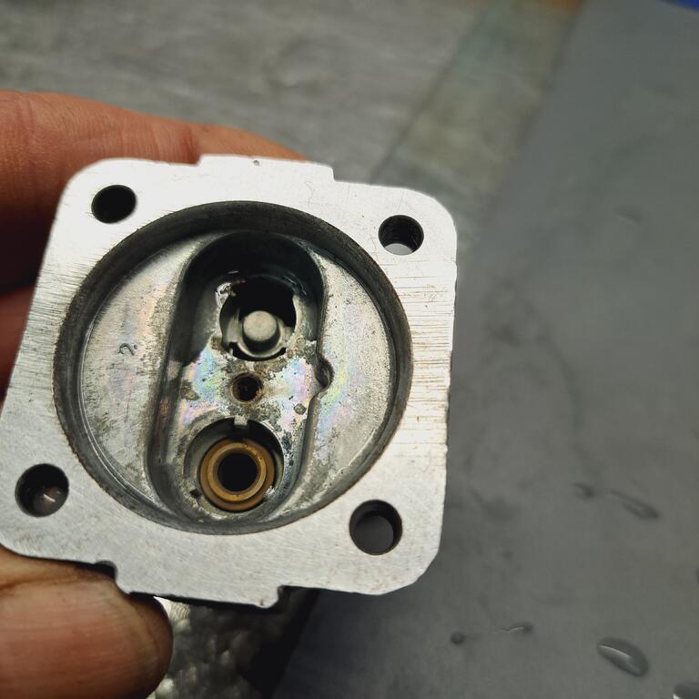

bdoss2006 1 #1 Posted March 9, 2024 I have an 8hp kohler engine (K181 I think?) on a wheelhorse. I have had trouble with the fuel pump leaking multiple times for years. It appears to have the original fuel pump. Before the latest repair, it was literally spraying gas from where the two halves come together with every stroke. I bought this rebuild kit https://isavetractors.com/fuel-pump-diaphragm-kit-for-kohler-k-m-series-metal-body-mechanical-fuel-pumps/?gad_source=1&gclid=CjwKCAiAi6uvBhADEiwAWiyRdrPpBDyVjw2MVaZWiG7wUBpNckt6YYYBU0E2MktdS9x0A81LOP-EFBoCY9MQAvD_BwE from Isavetractors, and installed it tonight. The leaking is slower but it sorta oozing as the engine runs. I dont know why it is still leaking. I made sure both sides were clean, and even sanded them slightly with 600 sand paper. Any ideas on what the deal is or how to fix it? 1 Share this post Link to post Share on other sites
953 nut 66,551 #2 Posted March 9, 2024 When you install the diaphragm in a fuel pump the arm of the pump needs to be pulling on the diaphragm whiler the screws are being tightened to prevent tearing it. 1 Share this post Link to post Share on other sites

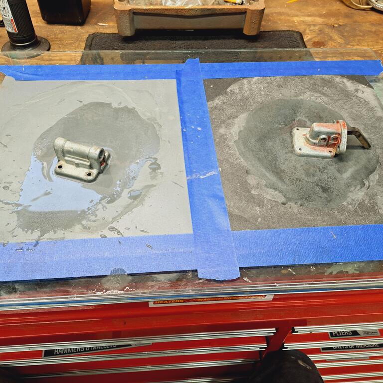

Handy Don 16,751 #3 Posted March 9, 2024 (edited) 13 hours ago, bdoss2006 said: ... leaking is slower but it sorta oozing as the engine runs. I dont know why it is still leaking. I made sure both sides were clean, and even sanded them slightly with 600 sand paper. Any ideas on what the deal is or how to fix it? The pump housings are relatively soft metal and all of the three I’ve touched were warped (how? I have no idea). I discovered this by placing each mating face on a good flat surface and noting that there were gaps that would prevent a tight seal when it was together. I used @ebinmaine’s head flattening advice to carefully and slowly flatten both faces before cleaning and reassembling. Also, similar to @953 nut’s comment, the diaphragm is NOT intended to stretch to pump fuel. that would wear it out very quickly. During installation, the diaphragm should “pucker” inside the central cavity. You may be concerned about wrinkles at the edges where it seals but these will flatten out as you tighten the halves together. Lastly, make sure to use a criss-cross pattern when tightening each screw a little at time until it's together. Edited March 9, 2024 by Handy Don 2 Share this post Link to post Share on other sites
WHX?? 56,844 #4 Posted March 9, 2024 (edited) Are you familiar with glassing heads? Fuel pump halves need the same treatment. It takes quite abit using 400 grit wet. They distort due to overtightening. Tighten halves just enough. Note between the screw holes. Glass until this spots are about gone. I've tried extra gaskets, sealer, filing but this is the only thing that works. Edited March 9, 2024 by WHX?? 4 2 Share this post Link to post Share on other sites

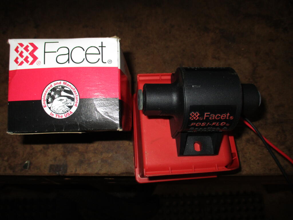

pfrederi 20,655 #5 Posted March 9, 2024 My solution for leaky mechanical pumps easier and faster...and close in price to a rebuild kit. lasts and lasts no danger of future gas in the crankcase... 3 Share this post Link to post Share on other sites
Marv 996 #6 Posted March 9, 2024 27 minutes ago, pfrederi said: My solution for leaky mechanical pumps easier and faster...and close in price to a rebuild kit. lasts and lasts no danger of future gas in the crankcase... I use the Facet pumps as well. They work well for me. I prefer them to the original pumps Marv 1 Share this post Link to post Share on other sites
oldlineman 1,734 #7 Posted March 9, 2024 I'm also a fan, those e pumps are the way to go in my humble opinion. 2 Share this post Link to post Share on other sites
23 Reo 235 #8 Posted March 11, 2024 What model posi-flo do you use? Share this post Link to post Share on other sites
oldlineman 1,734 #9 Posted March 11, 2024 Same as Pfrederi and Marv, a little more money but no problems with them. Bob Share this post Link to post Share on other sites
squonk 46,835 #10 Posted March 11, 2024 Napa 610-1051 1 Share this post Link to post Share on other sites
