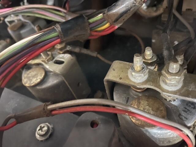

lynnmor 8,970 #33 Posted March 10, 2024 1 hour ago, AHS said: Are the gauges on the 520 supposed to light up? Im trying to get the tach to work. I know that 1991 and up had lamps in the gauges and they were always on with the ignition switch on. After looking at your wiring diagram I'm not seeing those lamps. The illuminated gauges have a rubber bulb socket pushed into a hole in the back side. The tachometer gets its signal from a gray wire that is attached to one of the outer terminals of the voltage regulator. It also needs a + & - connection. 3 Share this post Link to post Share on other sites
cleat 9,093 #34 Posted March 10, 2024 1 hour ago, lynnmor said: I know that 1991 and up had lamps in the gauges and they were always on with the ignition switch on. After looking at your wiring diagram I'm not seeing those lamps. The illuminated gauges have a rubber bulb socket pushed into a hole in the back side. The tachometer gets its signal from a gray wire that is attached to one of the outer terminals of the voltage regulator. It also needs a + & - connection. As lynmor said. The gray wire goes onto the terminal closest to the battery, you can just see it in this pic. 1 1 Share this post Link to post Share on other sites

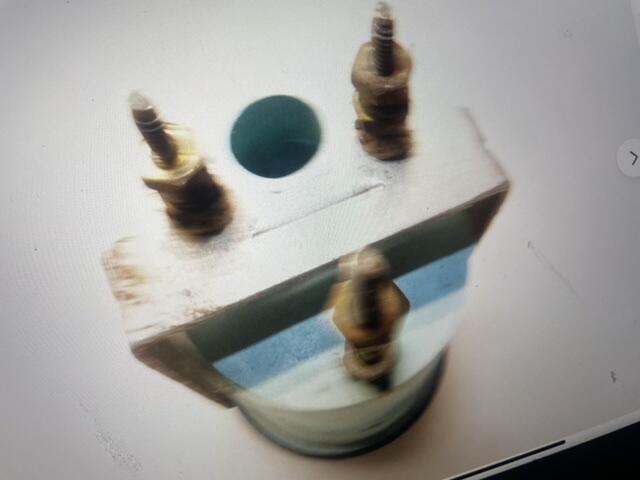

AHS 1,698 #38 Posted March 10, 2024 Does that look like it has lights? How do they come out? I swore I saw lights! 1 Share this post Link to post Share on other sites
cleat 9,093 #39 Posted March 10, 2024 The early 520's with the SW metal body gauges did not come with lights installed. They would go where the big round metal plugs are. When you turn the key on without starting the engine the tach should go to zero right away proving it is getting power. You should also see the fuel gauge go to the correct level and the volt gauge go to whatever voltage your battery is at. 3 Share this post Link to post Share on other sites

Handy Don 17,190 #42 Posted March 10, 2024 2 hours ago, AHS said: Does that look like it has lights? How do they come out? I swore I saw lights! So yeah, as @cleat noted, remove those round plugs and those gauges are “lamp compatible." Good luck finding lamps & plugs, though! (And if you do, one side will go to the “pink” instrument power wire and the other to ground.) 1 Share this post Link to post Share on other sites

cleat 9,093 #45 Posted March 10, 2024 30 minutes ago, Handy Don said: So yeah, as @cleat noted, remove those round plugs and those gauges are “lamp compatible." Good luck finding lamps & plugs, though! (And if you do, one side will go to the “pink” instrument power wire and the other to ground.) Or connect them to the green headlight wire so they are only on with the lights saving the bulbs from being on all the time. 3 Share this post Link to post Share on other sites

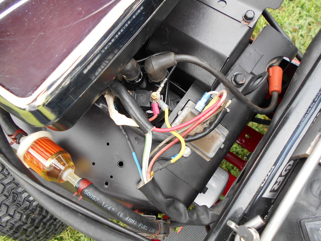

AHS 1,698 #47 Posted March 11, 2024 I’m 99% sure my tach is junk. My pink is at 12V, my ground is connected to ground, my signal wire is connected to the voltage regulator. I know this is newer than mine. Can you take a picture of your newer 520H, and i can copy the wiring? Share this post Link to post Share on other sites
Handy Don 17,190 #48 Posted March 11, 2024 2 hours ago, AHS said: my signal wire is connected to the voltage regulator. if you have a DVOM with a frequency range, you can test the pulse feed on the line coming into the tachometer. The exact frequency you observe isn’t important (it’s based on the number of coils in the stator and the RPM of the engine; faster engine=>higher frequency) but you’ll at least be able to see if there ARE pulses! 1 Share this post Link to post Share on other sites
Horse Newbie 7,405 #49 Posted March 11, 2024 2 hours ago, AHS said: Can you take a picture of your newer 520H, and i can copy the wiring Who are you asking to take a pic ? Share this post Link to post Share on other sites
