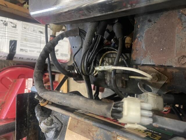

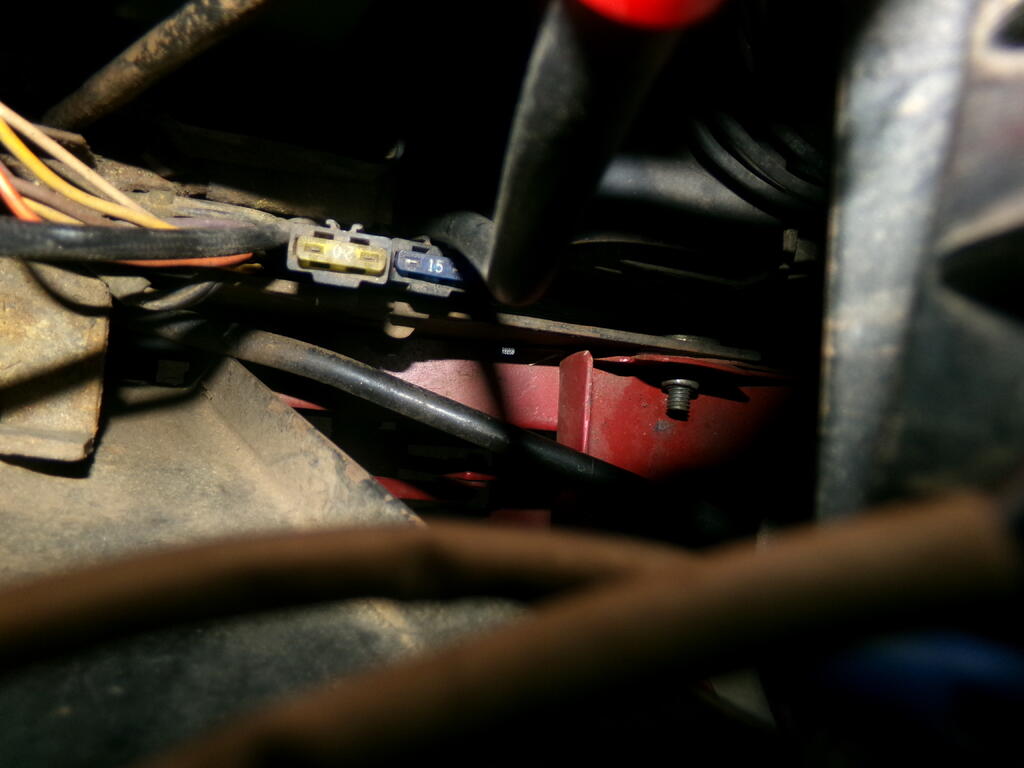

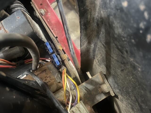

AHS 1,703 #13 Posted March 6, 2024 Ok, i messed with the 520 after work. I got 12V on the motor side of the 9 pin harness, (motor side, 12V black wire that connects thru the 9 pin connector to the red wire). In the picture there are two 15A fuses (it came that way, i swear!). Which one is supposed to be the 20A? The fuse next to the motor or the battery? I believe the 20A is next to the battery?? 1 Share this post Link to post Share on other sites

AHS 1,703 #16 Posted March 7, 2024 9 hours ago, gwest_ca said: Does your test switch for the idiot lights work? That circuit is connected to the 20 amp fuse and the 30 amp fuse at the engine. Remove 20 amp fuse and test no longer works? The other 10 amp fuse supplies the gauges but the 20 amp must be good before it will work. I have 2 15A circuits. I would like to know which one is the 20A, the fuse next to the battery or the fuse next to the engine. I have no idiot lights. 1 Share this post Link to post Share on other sites

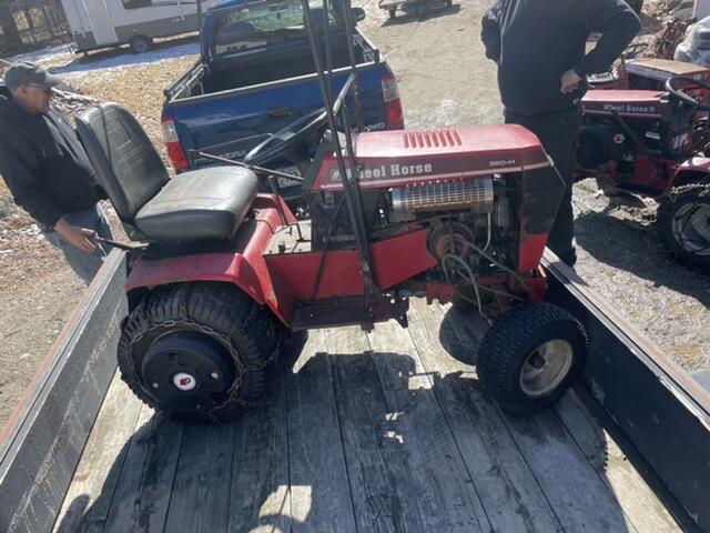

AHS 1,703 #17 Posted March 7, 2024 How about this, maybe i was a bit confusing. Take a pic of your 88-89 520H, please. (like the one down below). 1 Share this post Link to post Share on other sites
Handy Don 17,735 #18 Posted March 7, 2024 2 hours ago, AHS said: How about this, maybe i was a bit confusing. Take a pic of your 88-89 520H, please. (like the one down below). There is no extra risk if the tractor runs well with two 15’s. Worst case is a blown fuse and then I’d replace the blown one with the 20. 1 Share this post Link to post Share on other sites

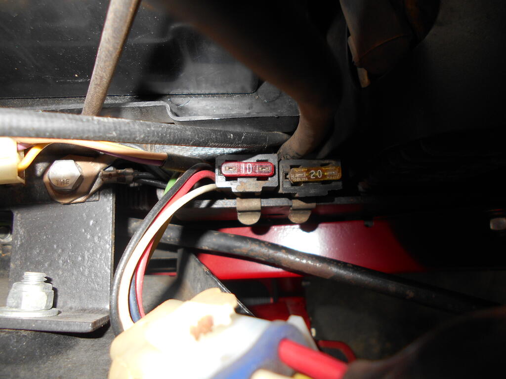

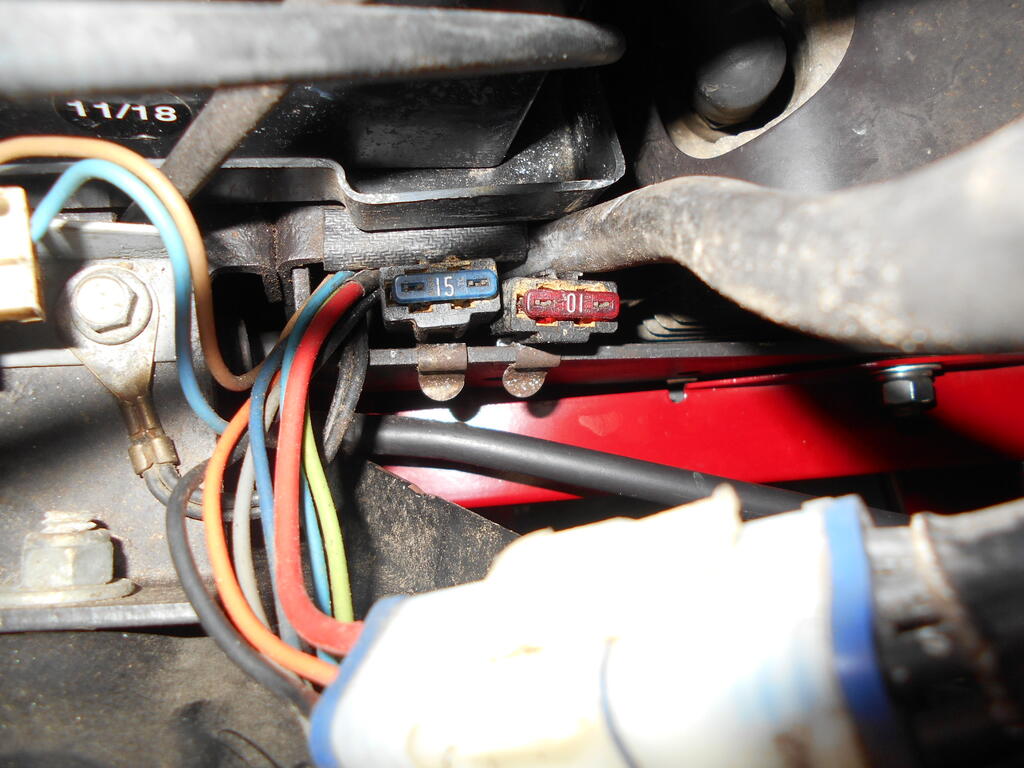

cleat 9,451 #19 Posted March 7, 2024 (edited) I took pictures of my 520H and my 520HC. The 520H has a 10 and a 20 fuse with the 20A close to the engine and it has power at all times irregardless of ignition switch being on or off. The 10A fuse has power with the ignition switch on. The 520HC has a 10 and a 15 fuse with the 15A away from the engine and it has power at all times irregardless of ignition switch being on or off. The 10A fuse has power with the ignition switch on. What this tells me is that fuse position is irrelevent as the fuse holder can get clipped on in any way. Biggest thing is to check for power and also wire colour as the constant power fuse will have red wires and the switched fuse will have pink and/or green wires. Edited March 7, 2024 by cleat 3 Share this post Link to post Share on other sites
Ed Kennell 47,952 #20 Posted March 7, 2024 (edited) Here's my '88 520H fuses. 20A to the rear and 15A to the front. Being 36 years old, no guarantee they are as designed from the factory. But the tractor runs fine with no starting or charging issues. Edited March 7, 2024 by Ed Kennell 2 Share this post Link to post Share on other sites

cleat 9,451 #23 Posted March 7, 2024 3 hours ago, AHS said: Ya, I have no continuity between my red wire on the 9 pin connector and the fuse… @cleat i guess I’ll have to take the belt cover off the and find out which wire go to what! It’s a lil more complicated than the 77 B80 to work on wiring! Ha! Actually if you ignore all the guage wiring it is not too bad The early 520's like yours are simpler and easier to work on (that is why I convert all of mine to be that way) without the extra relays under the battery. Also you already have the charge wire directly to the start solenoid which takes a lot of load off of the 9 pin connector. It should not be too hard to trace that red wire through the harness. 2 Share this post Link to post Share on other sites

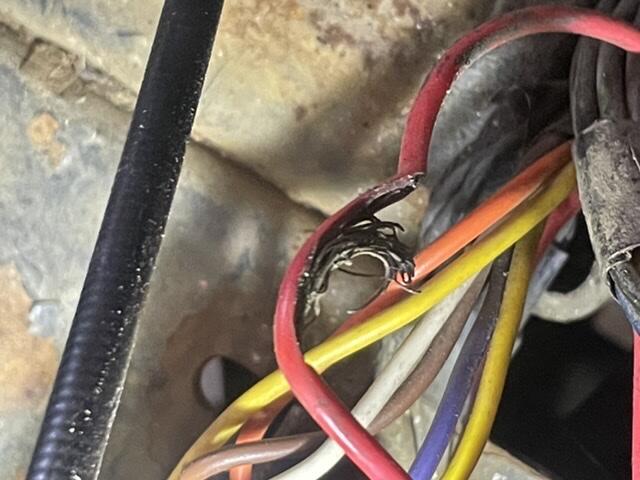

AHS 1,703 #24 Posted March 7, 2024 I found it!! I took the battery out and then i got to the spot in between the fuse and the 9 pin connector, where the break was. The gauges worked for a second then the fuse blew….but it started.. and ran like a champ. I noticed it wouldn’t idle down below 1000 -1300 rpms. I sprayed some throttle body spray at the rear part of the intake and it made a noise. The intakes gasket on the rear side is gone. I have so many questions about the Onan 20! Mine has 1500 hours on it and i wanna keep it running!! 3 Share this post Link to post Share on other sites
