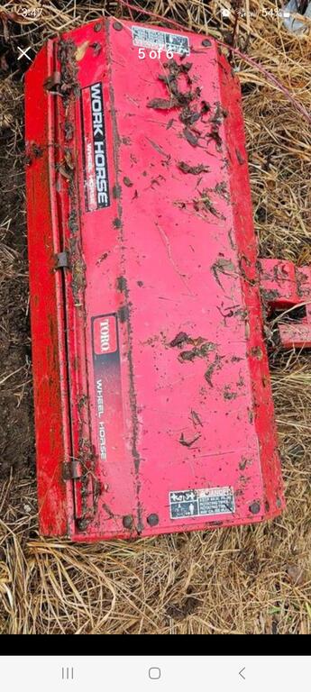

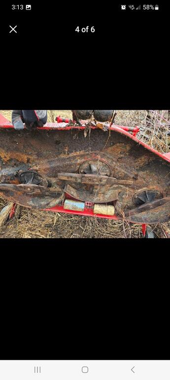

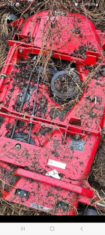

Cee245 861 #1 Posted March 2, 2024 Going to look at an XI tiller and 52" deck thats been sitting outside tomorrow. I don't know if seller has the tiller bracket, but he's pretty sure he has it. Too good of a deal to pass on... Have 2- 520xi's that would be nice to put tiller on and I guess the deck, I'd sell. 1 Share this post Link to post Share on other sites

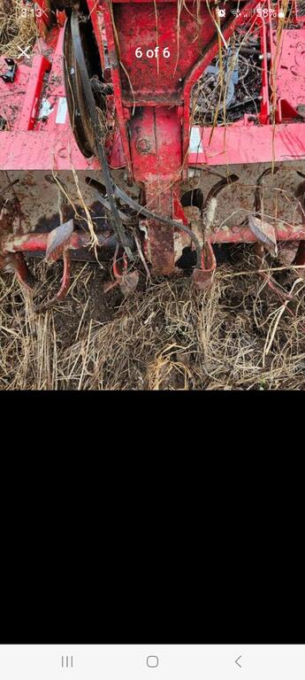

Cee245 861 #2 Posted March 2, 2024 Looks like they may clean up well. 2 1 Share this post Link to post Share on other sites

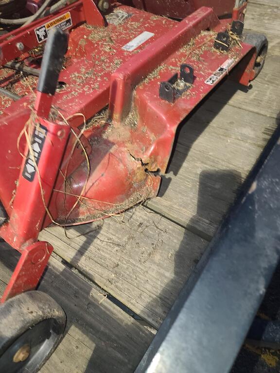

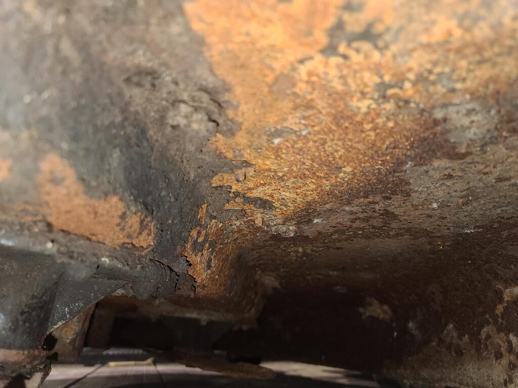

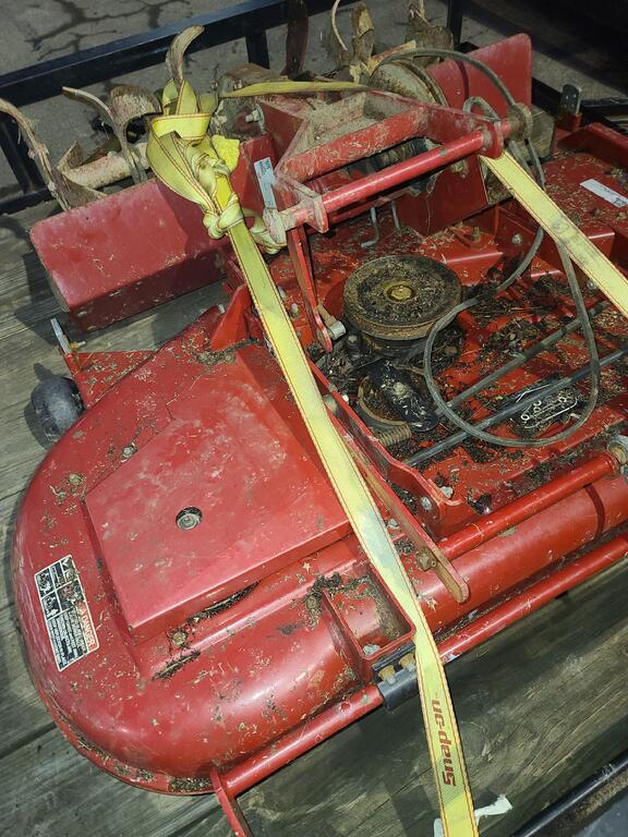

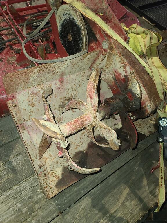

Cee245 861 #8 Posted March 3, 2024 These are in pretty good shape! The earlier pics make them look terrible. They are muddy and just plan dirty. Very solid. Little damage on discharge of deck. Not a hard fix. Tiller came with ALL attachments and brackets. Got lucky on this buy! Share this post Link to post Share on other sites

peter lena 10,088 #12 Posted March 4, 2024 @Cee245 personally would do a complete reversal to any rusting , crud neglect , found a warm dry place or outside in the sun , with an oil soaking penetrant will bake into the metal and stain it black , like to prop things up to the sun , at a 45 deg angle doing the oil soak . really sets a base line for recovery , of course bearing lubricant change , like a hi temp / stress grease / lube exceeding use factor . would not be surprised if related spindles are noisy / rough . brought back a lot of stuff , had to go back to ground zero , on verified maintenance, operational function was dramatic . also check out related , PTO mule drive areas , those bearings get smoky hot , lubrication failure , pete 1 Share this post Link to post Share on other sites

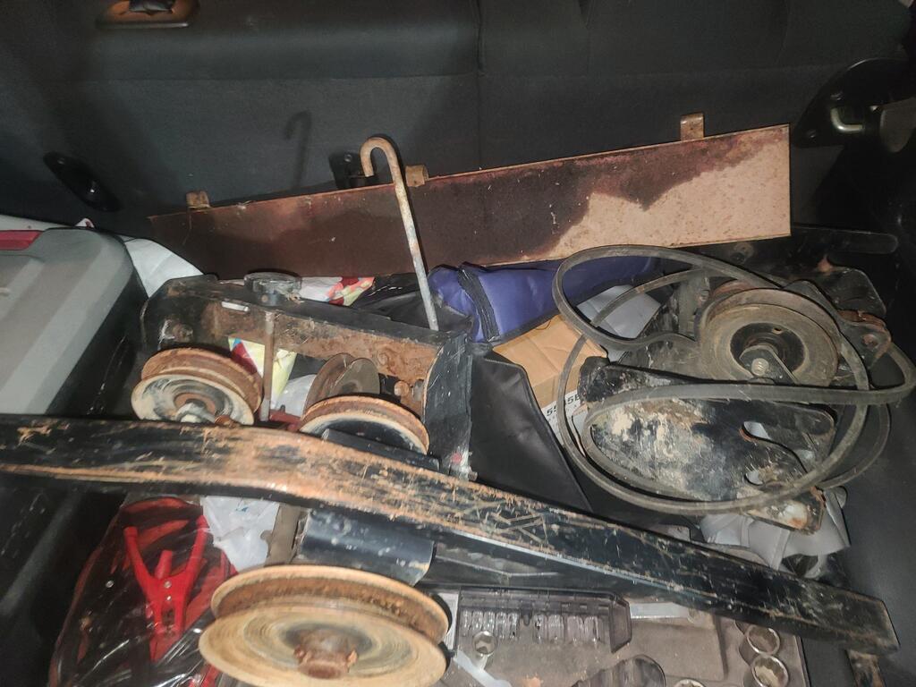

Cee245 861 #16 Posted March 5, 2024 Thanks @gwest_ca for the files! I looked at the files before checking it out and was wondering what all the extra stuff was. I believe i got the tiller mule and mower mule drive. Belt that came with is about to break, so there’s that. Share this post Link to post Share on other sites
