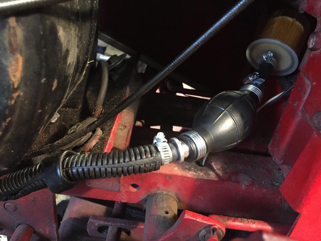

ebinmaine 80,755 #3 Posted February 28, 2024 Seconded. .. except I'd just go right ahead and clean the carb. THEN Adjust it. I'd check the fuel pump condition as well. They're not the best at pulling fuel that far while not primed. 6 Share this post Link to post Share on other sites
Ed Kennell 47,388 #4 Posted February 28, 2024 5 minutes ago, ebinmaine said: I'd check the fuel pump condition as well. Sounds like a candidate for a primer bulb. 7 2 1 Share this post Link to post Share on other sites
kpinnc 18,970 #5 Posted February 28, 2024 2 hours ago, Ed Kennell said: Sounds like a candidate for a primer bulb. Number one issue with a fuel tank under the seat. Makes mine fire on the second revolution. Saves your battery and starter too. 5 Share this post Link to post Share on other sites

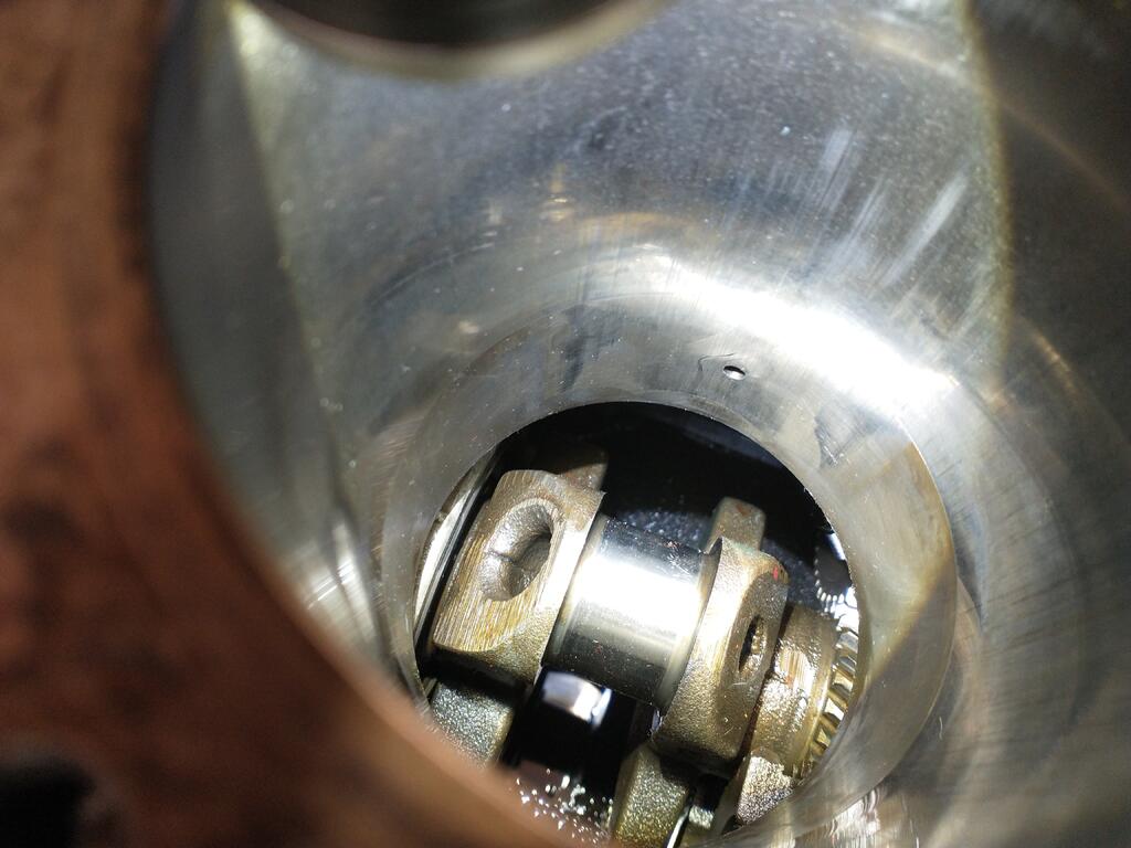

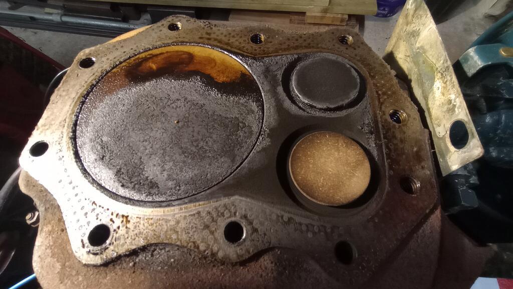

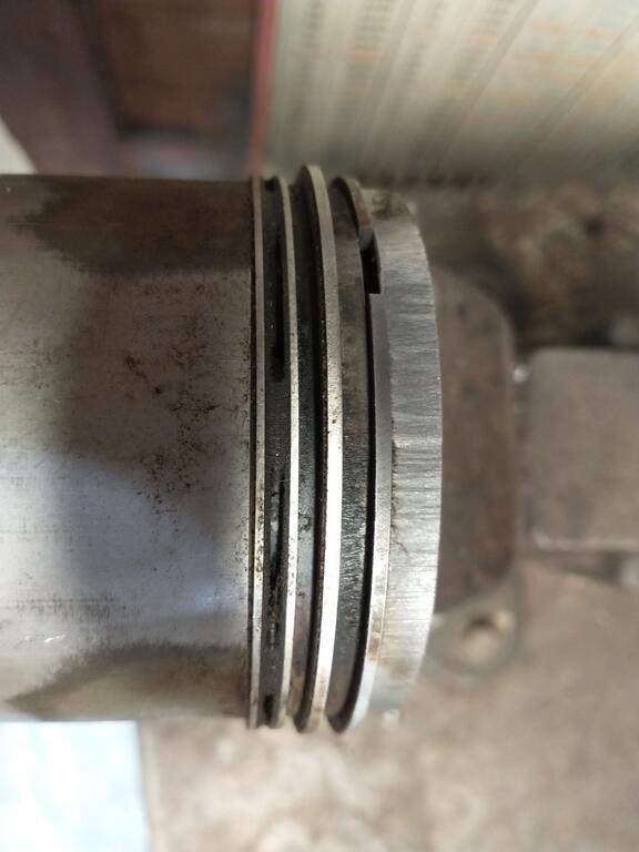

uk175horse 19 #8 Posted March 3, 2024 OK thanks for the advise so far - so I've already got a primer bulb in place as I saw the idea on another thread and the previous owner said they had to blow into the fuel tank to get it going! I'm a bit unsure how much I should actually pump it though before I end up flooding the engine? So I got started on taking the engine apart, removed the shroud and cleaned up all the cooling fins first. Then I set points to 0.02" and confirmed that they start to open when the flywheel hits the S timing mark, so hopefully timing is good. Going to clean up the carb and try and tune after this - I never try and change too many things at once, so I can figure out which thing helped - or broke it! So this is what I found today - but looks very heavy carbon deposits to me, and guessing the oil isn't too good..! Before and after photos after I cleaned it all up. Does it look OK after? I also measured the cylinder bore using a telescoping gaugue and digital calipers - looks like 3.749" when measured at 3 different points, so I guess its not too worn? 4 1 Share this post Link to post Share on other sites
ebinmaine 80,755 #9 Posted March 3, 2024 11 hours ago, uk175horse said: Does it look OK after? Looks good from my house. I don't have bore gauges so we "measure" by the @Pullstart "eyecrometer" Being an old kohler iron engine it'll be very forgiving. As long as the piston looks fairly tight in the bore we'll run em. 1 1 1 Share this post Link to post Share on other sites
Pullstart 71,264 #10 Posted March 3, 2024 If I haven’t already, It looks like you’re on the right track to getting a good runner! Do you have a large enough flat surface to give that head a good hone? Many people use thick glass and a sheet of sandpaper, I have a machined aluminum plate that works well. 3 Share this post Link to post Share on other sites

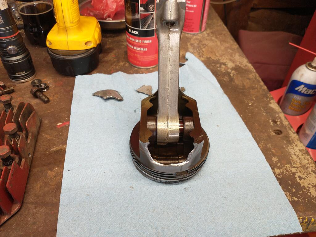

squonk 48,137 #14 Posted March 3, 2024 (edited) I got a shelf with some broken Kohler pistons and rods that say the eyecrometer only counts in hand grenades and horse shoes. Look at this cyl wall. Doesn't look horrible. This is the piston that was rattling around in it. Edited March 3, 2024 by squonk 2 2 Share this post Link to post Share on other sites

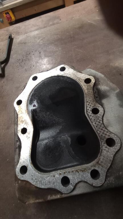

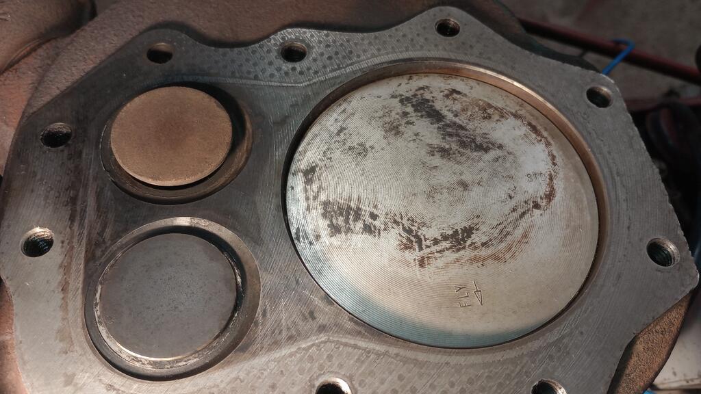

uk175horse 19 #15 Posted March 5, 2024 Wow that piston above is shocking , was it running like that? Right so I followed the suggestion to flatten the head, I've got a planer table which hopefully is very flat and some 400grip sand paper. New head gasket and re Torqued all the bolts. Never cleaned a carb before so will have to check that out. Got a bit carried away and opened up valve cover and check clearance. They are low, like 0.06 on intake, any reason the clearance should differ, like if P.O adjusted due to wear or something? Hopefully this engine has another few decades in it 2 Share this post Link to post Share on other sites

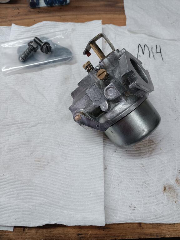

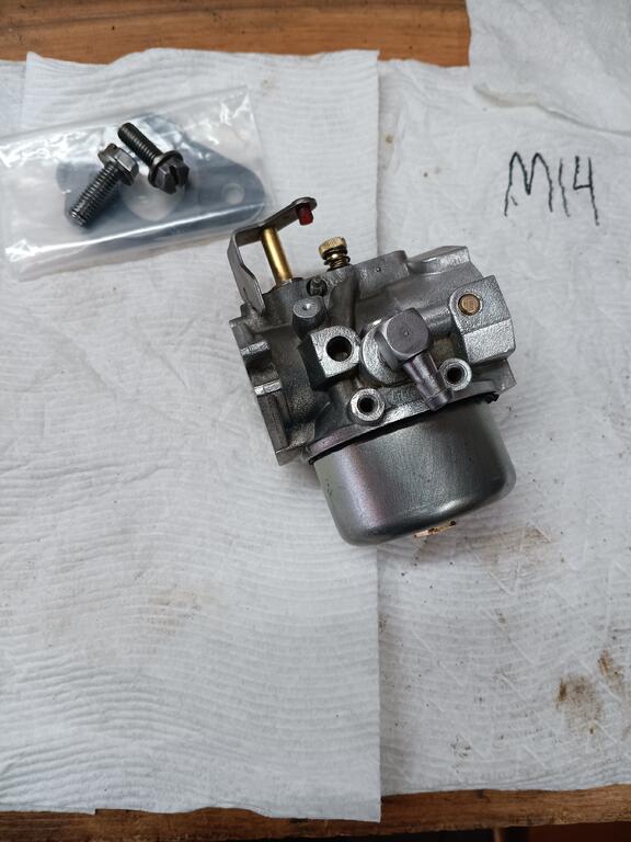

uk175horse 19 #20 Posted March 13, 2024 So turns out my clearance measuring was off ! Triple checked and intake was 0.010 (spec is 0.008-0.010) so set it the middle to 0.09 and exhaust is already at 0.018.. I wanted to get it running for a job so didn't get around to valve job yet, so put the head back on with new gasket. And.. typical the part I didn't touch failed , fuel pouring out fuel pump ! Got a new Chinese fuel pump but kept original to rebuild if worth it, replacement feels a bit of a poor product just looking at it... I gave the carb a good clean too. Going to fit the fuel pump and tweak the carb and will report back on the starting . But this is the way you learn ! Share this post Link to post Share on other sites

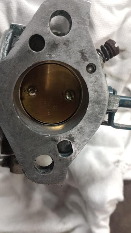

kpinnc 18,970 #21 Posted March 14, 2024 5 hours ago, uk175horse said: I gave the carb a good clean too. Going to fit the fuel pump and tweak the carb and will report back on the starting . But this is the way you learn ! Those butterfly screws look awfully shiny. Are they steel? Best to use brass screws in case one comes loose and is injested. Brass will crush down and likely won't damage anything. Steels screws will bust the head or piston. Brass screws and red loctite are far less likely to break anything... 3 Share this post Link to post Share on other sites
ebinmaine 80,755 #22 Posted March 14, 2024 8 hours ago, uk175horse said: Got a new Chinese fuel pump but kept original to rebuild if worth it, replacement feels a bit of a poor product just looking at it... I gave the carb a good clean too. After having several go bad I no longer advice using a cheap carb. Toss it on your desk as a paperweight and clean the original. It's very easy to properly rebuild an older Kohler. I'd be happy to share good written instructions if I can find them. The most important part is to check the throttle shaft to bore wear. 3 hours ago, kpinnc said: butterfly screws All the new cheapees I've seen ... and many of the older originals have steel screws. 1 Share this post Link to post Share on other sites

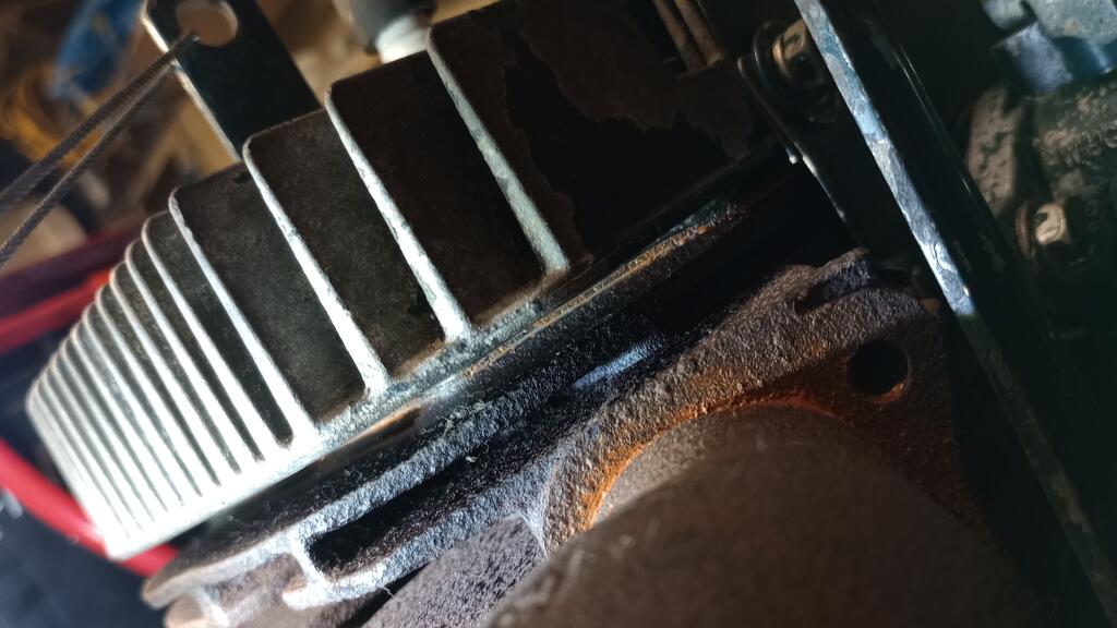

uk175horse 19 #23 Posted March 18, 2024 Not sure if it was clear but I'm definitely keeping the original carb , walbro adjustable model. Will see if I can source any brass screws too. So the good news is after replacing fuel pump with aftermarket manual one (and all I did before that!) the starting is much better , now it starts first time ! The bad news is that I think I messed up replacing the head gasket, I could see a bit of white smoke coming out around the head near the exhaust and the top cooling fin looks a bit oily. I checked the torque after and it was lower , so I retorqued again to spec , hoping that does it, or is it too late once a leak happens ? Can I take it off and add some gasket maker and refit ? Or are we talking another gasket and replace ? 1 Share this post Link to post Share on other sites
953 nut 69,410 #24 Posted March 18, 2024 11 hours ago, uk175horse said: I retorqued again to spec , hoping that does it, or is it too late once a leak happens ? Can I take it off and add some gasket maker and refit ? Or are we talking another gasket and replace ? Glad it is starting well. Retorquing is something the service manual says must be done. That should eliminate the problem, if nor a new gasket will be needed. 2 Share this post Link to post Share on other sites
Sailman 1,307 #25 Posted March 18, 2024 On 3/14/2024 at 4:51 AM, ebinmaine said: It's very easy to properly rebuild an older Kohler. I'd be happy to share good written instructions if I can find them. Don't mean to hijack the thread but I could use the instructions too @ebinmaine. Have a carb for my K 161 that I cleaned and rebuilt but doesn't seem to want to start the engine. Might be "the shaft to bore wear"? 2 Share this post Link to post Share on other sites
