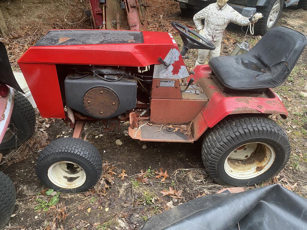

c-series don 12,631 #1 Posted February 14, 2024 (edited) I hear the C-175 is the feature tractor this year and the WHCC is looking to recreate the picture of one of them with the front mount mower carrier and 48” deck. Is anyone going to be able to put this together? I have this tractor, but it needs a full restoration. I also know where I can get the mower carrier and have a few 48” decks that need restoration. Plans for the total restoration may be on the back burner as my oil burner needs to be replaced very soon. Depending on the cost of this may dictate if I can pull it off. I won’t do it if I can’t do it 100%, I can’t do it half ass, that’s just me.In my opinion I think the black hoods are sharp looking tractors. Edited February 16, 2024 by c-series don 11 Share this post Link to post Share on other sites

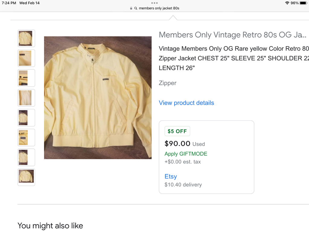

Sparky-(Admin) 26,644 #7 Posted February 14, 2024 How accurate is the pic going to be? Where will they find a Members Only nylon jacket 1 Share this post Link to post Share on other sites

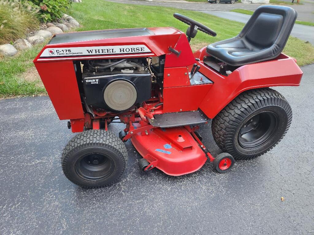

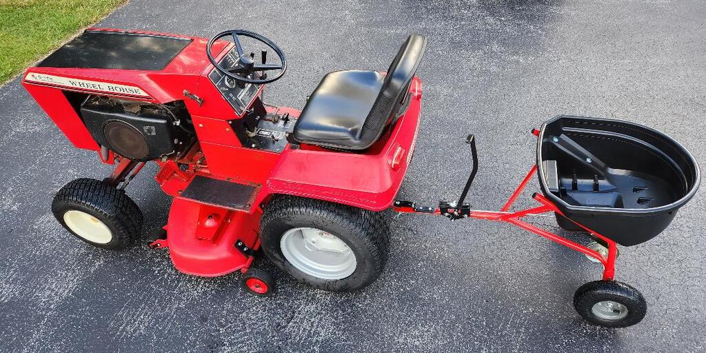

midpack 1,148 #9 Posted February 14, 2024 I have a C-175 hydro with a 48" deck that I use as my regular mower. It runs and cuts great! But it's not "pretty" lol 2 Share this post Link to post Share on other sites
rjg854 13,418 #10 Posted February 14, 2024 58 minutes ago, midpack said: I have a C-175 hydro with a 48" deck that I use as my regular mower. It runs and cuts great! But it's not "pretty" lol 1 1 Share this post Link to post Share on other sites

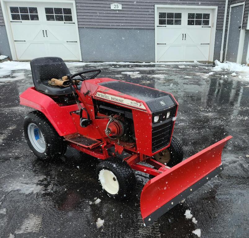

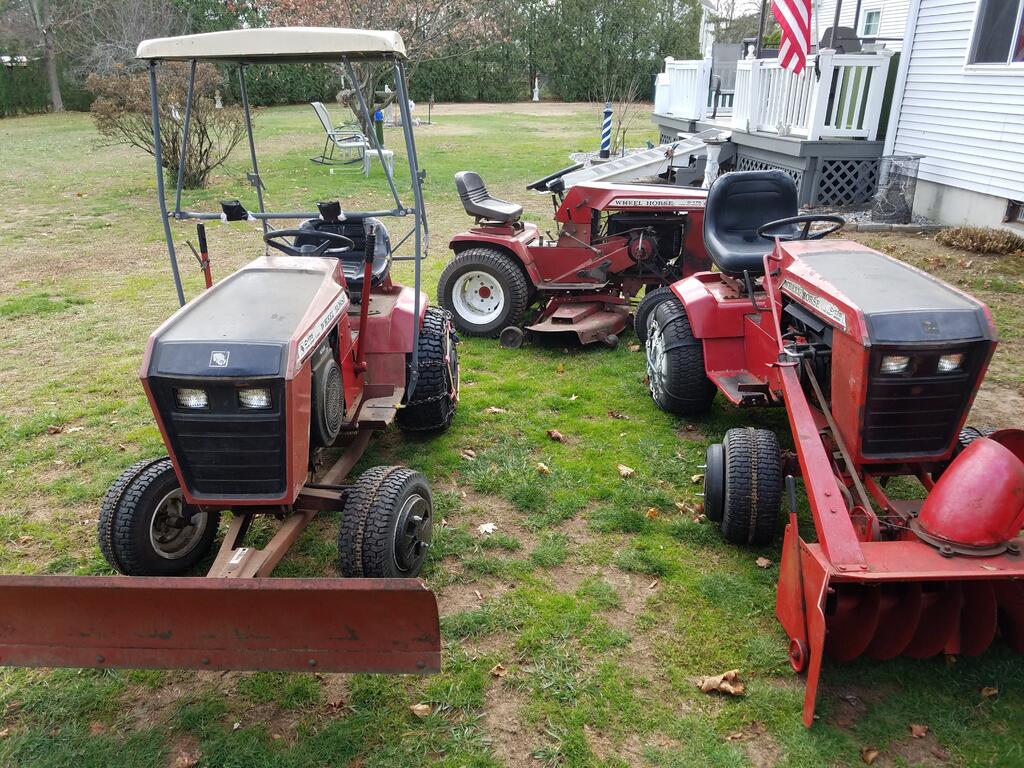

midpack 1,148 #11 Posted February 14, 2024 1 hour ago, rjg854 said: This is the best one I have at the moment, they all started off as C-175's but one has a Magnum 12 and the 3rd has a Magnum 18 2 2 Share this post Link to post Share on other sites

c-series don 12,631 #18 Posted February 15, 2024 (edited) 10 hours ago, Sparky said: How accurate is the pic going to be? Where will they find a Members Only nylon jacket That’s funny you say that because I thought the exact same thing. However I don’t see any shoulder straps? 😂 I may have to start perusing local thrift shops. Are those pants polyester? Might be a little hot wearing these items at the big show 😂 Dang it @squonk I need to look for the shoes too? Edited February 15, 2024 by c-series don 1 4 Share this post Link to post Share on other sites

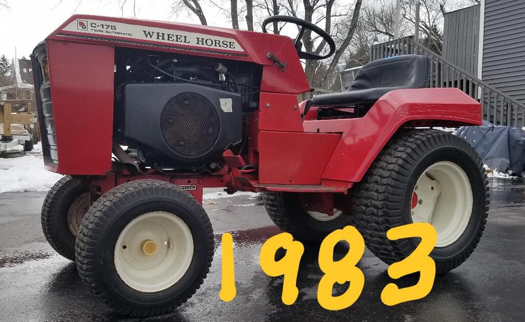

Brockport Bill 2,504 #22 Posted February 16, 2024 Good luck don -- sounds like awesome C175 project idea -- if anything like your results of your beautiful restored Workhorse I am sure the 175 project will be special -- I'm wondering if you plan to start a GOFUND ME page to buy the brochure guys jacket and shoes? I was able to acquire a couple C175s a few years ago -- an 83 Series 1, and a 84 Series 2, -- both apparently their original black hoods, plus the raised plastic seat pan fenders -- I have done some rehab on the 84 Series 2, but not much on the 83 Series 1 - both are in use -- that twins certainly have a great sound. Hoping to keep both running and in good condition - Bill 7 Share this post Link to post Share on other sites

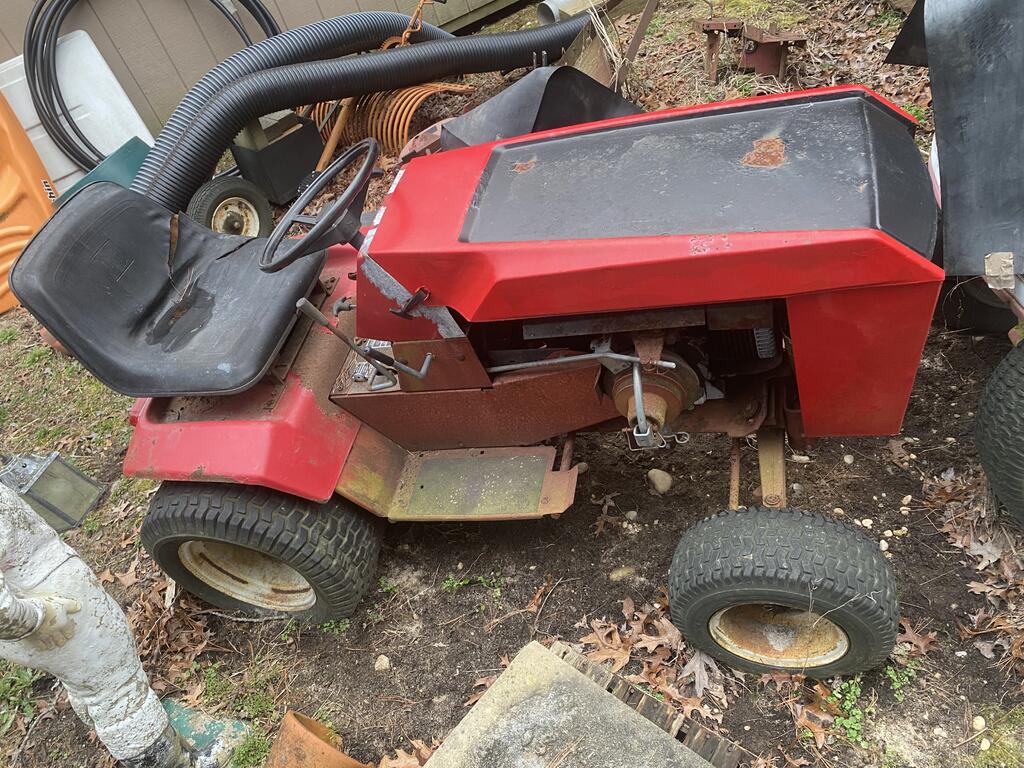

c-series don 12,631 #23 Posted February 17, 2024 Update: I dragged my C-175 out of the backyard and into my shop today. This tractor hasn’t ran in years. Purchased a new battery, filed the points, cut the fuel line so it wouldn’t suck up crappy fuel and sprayed some gas down the carburetor. Vroom! It started right up! Then I drained and cleaned the tank, replaced the fuel line and added a filter. Next I topped off the transmission, then drove it around. I have to say that I was one happy camper. The transmission is nice and tight and the hydraulic lift works fine too. I’m not sure but this may be on its way to a full blown restoration? Also more good news, @Sparky I found the jacket for the picture! 3 1 1 Share this post Link to post Share on other sites

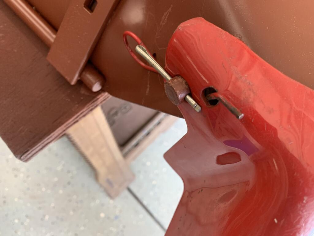

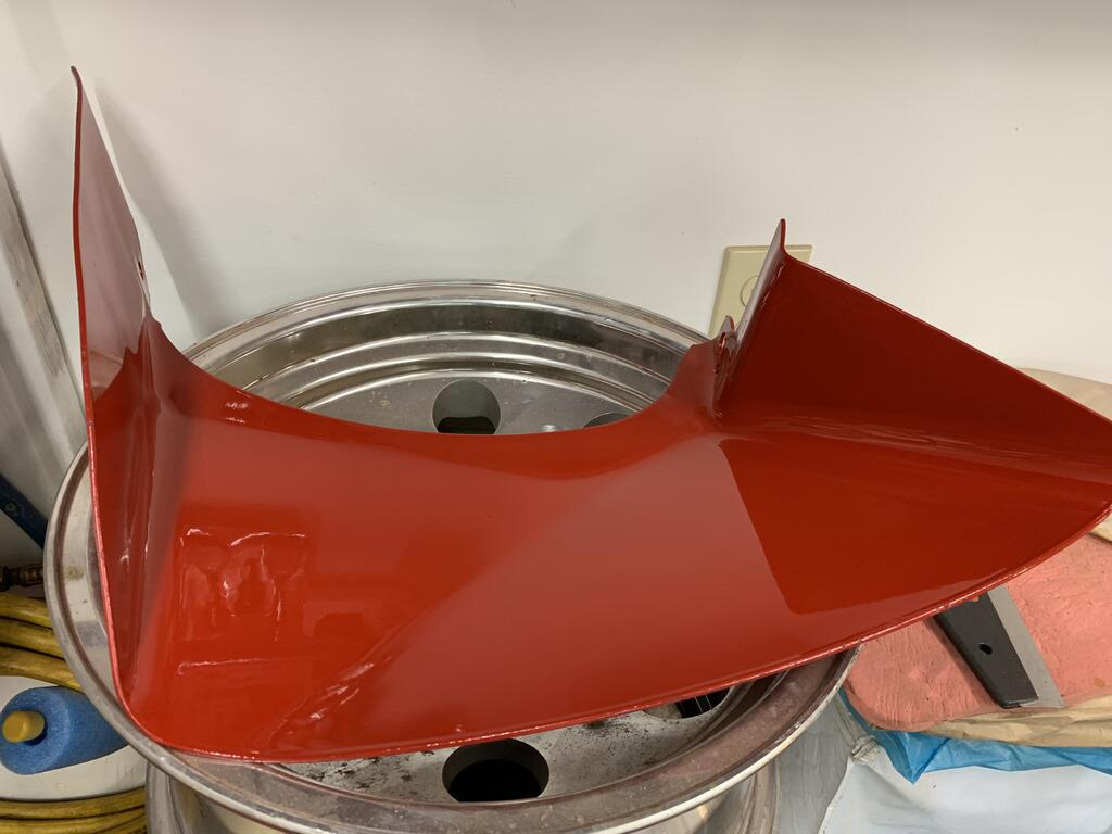

Horse Newbie 7,405 #24 Posted February 17, 2024 Referring to the 1st pic at the very top… Do all deck chutes mount under the deck opening as the pic shows ? Have I been trying to mount mine wrong on my 48 inch SD deck ? I thought they mounted on the outside… Share this post Link to post Share on other sites
JCM 11,427 #25 Posted February 17, 2024 I have a bunch of WH decks and on the 42'' the chute goes under and on the 48'' over on the SD decks. @Horse Newbie Both were bought new. 1 1 Share this post Link to post Share on other sites
