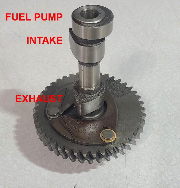

ebinmaine 80,755 #6 Posted February 2, 2024 5 minutes ago, Retired Wrencher said: . I am thinking of trying the cam arm type to see if the engine will run? It's come up on Redsquare about swapping from one style pump to the other in the past. The part in question is the actual camshaft in a Pulse type engine. I've not seen definitive proof that Kohler always used the same cam on both engines. I would NOT try to install a lever arm pump where a pulse pump was originally. Order the correct gasket for the pulse pump. It's very easy to install. Share this post Link to post Share on other sites
rmaynard 17,583 #7 Posted February 2, 2024 (edited) You can look into the hole where the pump mounts and see the cam shaft. If there is a lobe, you're good to go. Edited February 2, 2024 by rmaynard 2 Share this post Link to post Share on other sites

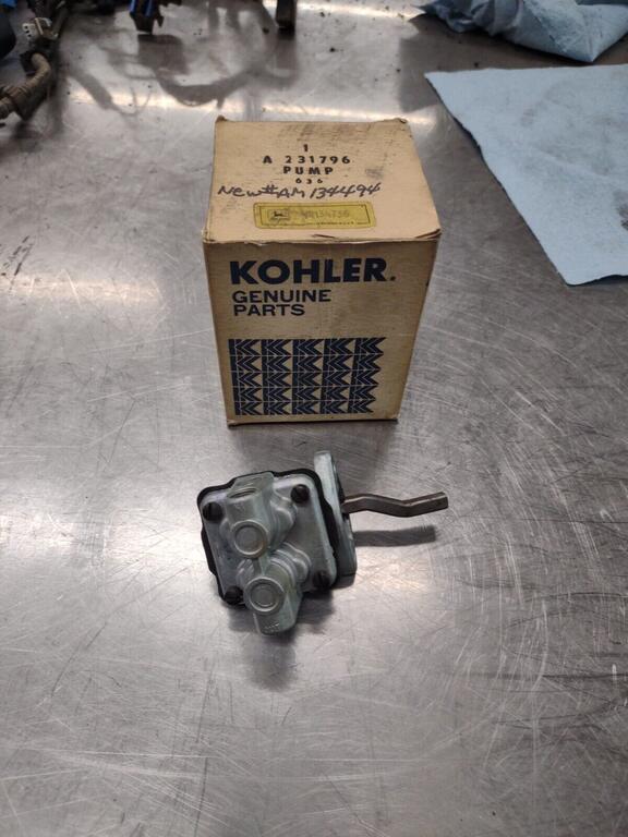

Mike'sHorseBarn 3,681 #8 Posted February 2, 2024 I've used the @buckrancher diaphragms before and usually keep a few on the shelf. In fact I used one this week on my 854 pump and now I only have one left so it may soon be time for another order lol As far as using a lever style pump I believe the cams have the lobe no matter if your engine has a vacuum pump or not. I only know that because I tried it on an 855 and I found one that worked. You have to use a pump with the offset lever. 3 1 Share this post Link to post Share on other sites
