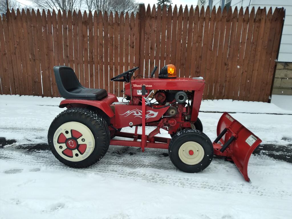

D_Mac 9,333 #2 Posted December 15, 2023 (edited) I plow with my 875. Pushes enough snow for me. Before that I used an 857. Edited December 15, 2023 by D_Mac 2 Share this post Link to post Share on other sites

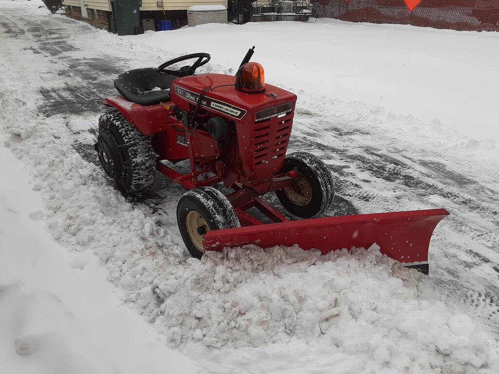

ebinmaine 77,278 #5 Posted December 15, 2023 20 minutes ago, Daron1965 said: I had the same idea for the light. Our local police require a yellow light at night when crossing roadways. Does B 80 take a long frame plow? I think it can use one but not sure. B80 is a mid frame tractor for 1974 and 75. Long Frame 1976 and 77. ALL use a Long Frame plow. You'll love a B80 as a plow rig. I've used mine as such. (since sold it) Trina has several 8 HP tractors. Plenty of power there. What you'll need is weight. WEIGHT is TRACTION. I absolutely recommend fluid filled tires. For lights you have many options. I'd recommend LED. There are tons of styles that can added by drilling, clips, or magnets. 2" diameter to 4" or whatever. You go back a few years in the YouTube channels for both me n Trina. We each have many videos of us plowing. 2 1 Share this post Link to post Share on other sites

ri702bill 11,232 #7 Posted December 15, 2023 6 hours ago, ebinmaine said: What you'll need is weight. WEIGHT is TRACTION. I absolutely recommend fluid filled tires. I fluid filled BOTH the front and rears on the 854, added wheel weights front and rear, and use 150 lbs of lead ingots under the seat. Use 2 link chains for maximum number of cross links. I have a choice of either a 42" or 48" moldboard - the smaller one is actually better in heavy snow..... 3 Share this post Link to post Share on other sites
ebinmaine 77,278 #8 Posted December 15, 2023 6 hours ago, D_Mac said: One of these days I will attempt fluid filling my tires. Not really sure how to do it. @squonk and @Pullstart both have good videos showing the procedure. Our first attempt here was made last year. Surprisingly easy. A little messy. Excellent results. 6 hours ago, D_Mac said: I really need the weight up front as sometimes steering is an issue. You may want/need to add a weight like we did on Trina's 867. Easy bolt on using angle iron and a flat hunk of steel around 45 lbs. Also consider front chains. 6 hours ago, D_Mac said: The 857 I had chains on the rears, the 875 I don't. I really don't notice much of a difference. That being said my snowblower gets most the work on the heavy stuff. Interesting to me that folks can move at all without chains. I've tried it here and had NO movement possibilities. But .... Nearly Every surface here is tilted. 18 minutes ago, ri702bill said: I fluid filled BOTH the front and rears on the 854, added wheel weights front and rear, and use 150 lbs of lead ingots under the seat. Use 2 link chains for maximum number of cross links. I'll add a solid second vote for front tire filling. My bigger plow tractor with a 60" wide blade NEEDS all the gription I can get. I use well oversized 20 x 8 x 8 front turf tires with 5 gallons of Rimguard in each one. This year I'm considering trying full wrap chains for front steering. Likely a rough ride... Not sure if I'll keep em on. Like the extra stuff under the seat. 2 1 Share this post Link to post Share on other sites
