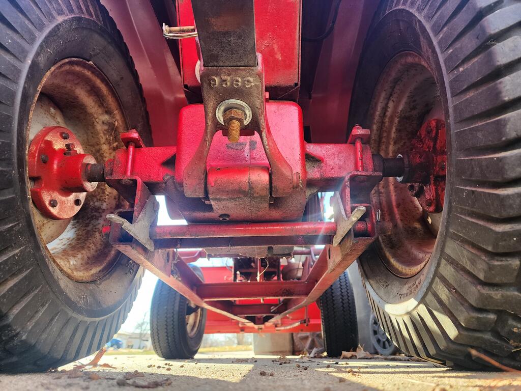

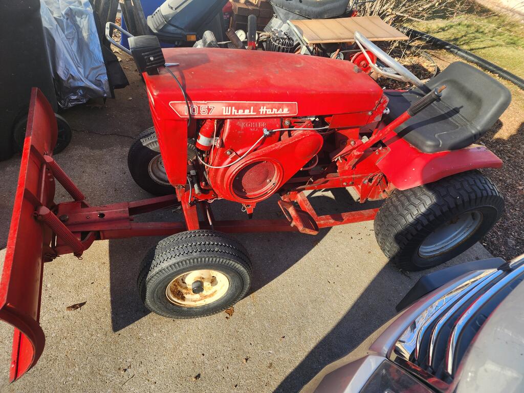

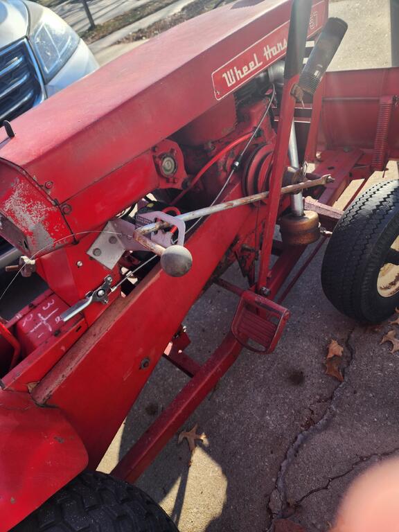

Brad Schroder 0 #11 Posted December 12, 2023 My research leads me to believe the 1057 is a long base. Here are some pictures. Share this post Link to post Share on other sites
Handy Don 17,562 #12 Posted December 12, 2023 1 minute ago, Brad Schroder said: 1057 is a long base Aha. Thanks! That will simplify your deck decisions. As noted above, adding either the adaptor plate or a modern Attach-a-matic to the front will give you a full range of options. Good luck. Share this post Link to post Share on other sites
Ed Kennell 47,597 #13 Posted December 12, 2023 30 minutes ago, Handy Don said: Aha. Thanks! That will simplify your deck decisions. As noted above, adding either the adaptor plate or a modern Attach-a-matic to the front will give you a full range of options. Good luck. Yes, add the front attach-a-matic and you can use many of the newer 3 blade decks. That style PTO engagement is the best Wheel Horse made. No safety switches and trouble free. You will need to remove that exhaust pipe to clear the forward routed belt. Looks like the right rear axle seal needs replaced. An easy fix if the hub comes off easy. Share this post Link to post Share on other sites

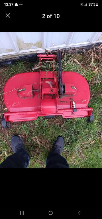

Brad Schroder 0 #19 Posted December 12, 2023 I'm currently looking into this one Share this post Link to post Share on other sites
Handy Don 17,562 #20 Posted December 12, 2023 1 minute ago, Brad Schroder said: I'm currently looking into this one Wow, that is a nice looking deck. To use it, though, you’d have to remove your existing PTO clutch and convert your mid hitch to have the “side saddle” PTO clutch assembly. Since your PTO is already the newer (and, frankly, stronger) style, my suggestion would be to look for a 3-blade, non-gear deck with a mule. You will need either the bolt-on mule (not very common) or both a front attach-a-matic and a “standard” mule. As fond as I am of these geared decks, they are a bit noisier and require higher maintenance than the 3-blade decks. 1 Share this post Link to post Share on other sites

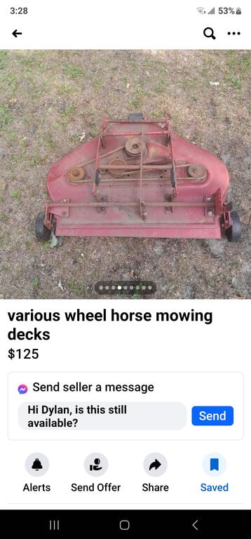

Brad Schroder 0 #25 Posted December 12, 2023 This is more like it, correct? Share this post Link to post Share on other sites
