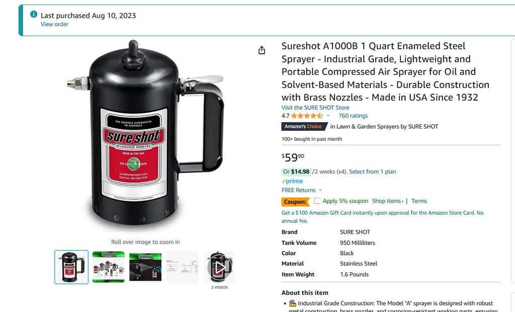

pfrederi 21,274 #7 Posted November 28, 2023 9 hours ago, ebinmaine said: The boys above have got you fixed up right. To clean an engine block here we do a few different things. Brake clean. YES. I buy it by the case of 12. It's a LOT less expensive that way. We also use cleaners to degrease like Incredible Pink. Or whatever other "color cleaner" you prefer. Purple. Simple Green. Etc..... We really like using the pressure washer with HOT water. That's excellent for degreasing. LOTS of wire brushing. Just before paint Trina does a thorough wipe down with acetone. I have three of these units they are excellent quality. Oldest is over 20 year old One for BrakeClean one for WD-40 one for paint thinner Gallon of brake clean at auto parts store isn't bad. 1 Share this post Link to post Share on other sites

Keaton 466 #9 Posted November 28, 2023 @pfrederi my dad has thoes break clean things at his automotive shop and he has a 55 gallon drum of break kleen and a charger system for it 1 Share this post Link to post Share on other sites
