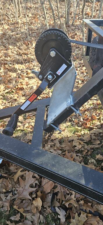

Docwheelhorse 2,993 #1 Posted November 25, 2023 (edited) Hello All, Happy Holiday Season!! Sick of your not so young back screaming at you when your trying to put a non running hydro on the trailer? Screaming obsenities pushing a tractor with flat tires or dragging a project out of weeds all while trying your best not to have a heart attack? Well for about $50 in parts you can make it easy... a spare tire carrier, a boat winch, a handful of longer nuts and bolts etc... The spare tire carrier lifts winch high enough so handle clears in complete circle plus keeps strap level and above front cross member. Strap is 23 ft long and gets beyond trailer even with gate down. Get them "sick" tractors onto the trailer and on way to ER the easy way. Maybe this idea has already been done or in some other similar fashion... just thought id post to give others an idea. I bought my setup at Cabelas... I think everything is available cheaper at Harbor Freight. I work for Cabelas and my discount made it cheapest option. $50 give or take is the regular price to everybody. Tony Edited November 25, 2023 by Docwheelhorse Added more pictures 5 3 1 Share this post Link to post Share on other sites

ri702bill 13,398 #4 Posted November 25, 2023 That setup also gives an almost straight pull - very predictable. The strap is way more user friendly than either wire rope or chain. Not a fan of either of the latter 2 whipping back at you - with lot of energy - due to an attachment failure. I for one ALWAYS place a moving quilt over the cable(s) when using a come-along horizontally - act like a "catch" blanket. There are plenty of YT Fail videos of ****** blocks coming thru pickup cab rear windows.... 4 Share this post Link to post Share on other sites
