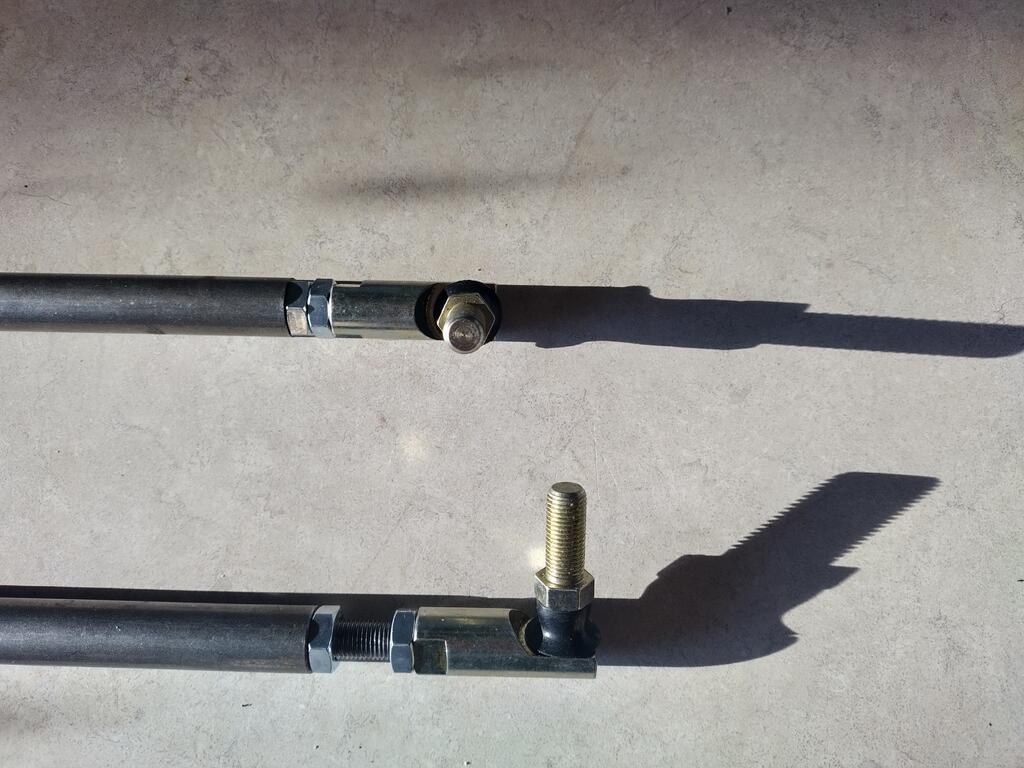

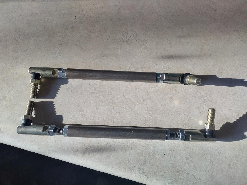

ebinmaine 81,283 #7 Posted November 23, 2023 Found the makins' for a nice adjustable set. Nice to have a home shop Parts Department. 4 5 Share this post Link to post Share on other sites

Retired Wrencher 7,045 #14 Posted November 24, 2023 14 hours ago, ebinmaine said: Found the makins' for a nice adjustable set. Nice to have a home shop Parts Department. That is the way to go when the originals wear out Eric. Easy to install. 3 1 Share this post Link to post Share on other sites

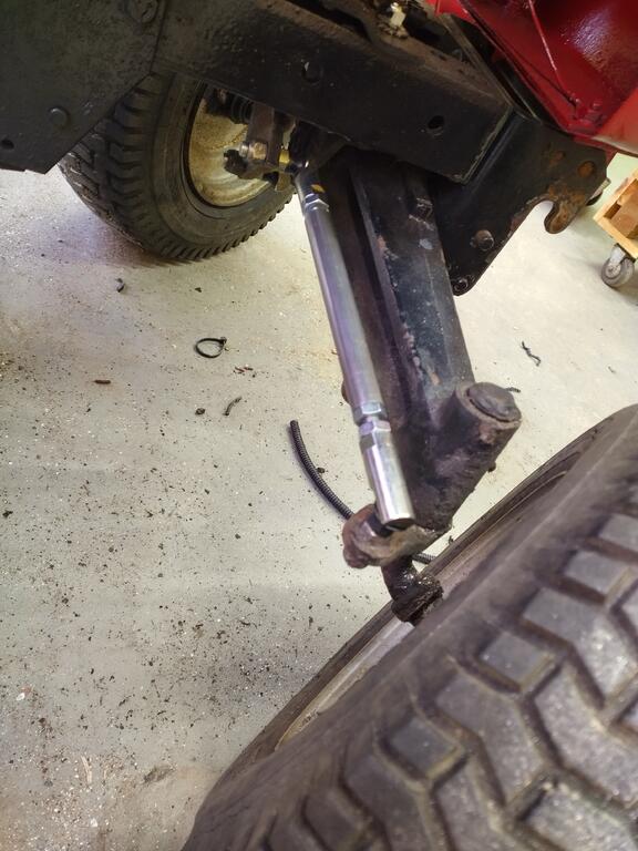

ebinmaine 81,283 #16 Posted November 24, 2023 I did find that this tractor had a bent spindle on the right side. A pipe wrench and a twist fixed that. I didn't remove the spindles to check anything out but I believe there's a real possibility that the left spindle is welded incorrectly. That tie rod is a bit longer than the other. 1 Share this post Link to post Share on other sites

ebinmaine 81,283 #24 Posted November 24, 2023 39 minutes ago, Handy Don said: correct geometry. The steering arm should be 90º from the axle and parallel to the ground 39 minutes ago, Handy Don said: Since you have a few spindles nearby, you can do some comparisons Going strictly by eye the left side looks pretty close. I can say for sure the right side was not. That one had a twist strong enough that I couldn't get the impact driver on the lower outer nut without hitting the tire. It's not off by a country mile. But the left tie rod is a little longer than the right in order to get the wheels to a decent position. While I agree I'm principle that the correct steering geometry is important, this particular tractor is going to work on a hillside where it won't see many flat straight spots. The steering system will be in a nearly constant state of correction and return. 1 Share this post Link to post Share on other sites
