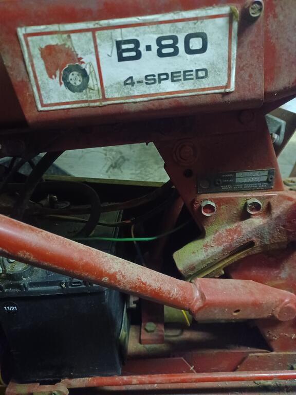

ebinmaine 80,279 #2 Posted November 21, 2023 What model of tractor? What brand belt? 2 Share this post Link to post Share on other sites
953 nut 68,501 #3 Posted November 21, 2023 8 hours ago, Donavon said: it popped wheelies Please define IT. Dose "IT" have a fabric covered belt? Does "IT" have a belt guard properly installed? 1 Share this post Link to post Share on other sites
Pullstart 71,098 #4 Posted November 21, 2023 I’m guessing B80, or 1054 based on his profile. Either way, the fellas up above are on to something. Belt quality/material, and belt guard usage are absolute musts to protect the life of the transmissions. 2 Share this post Link to post Share on other sites

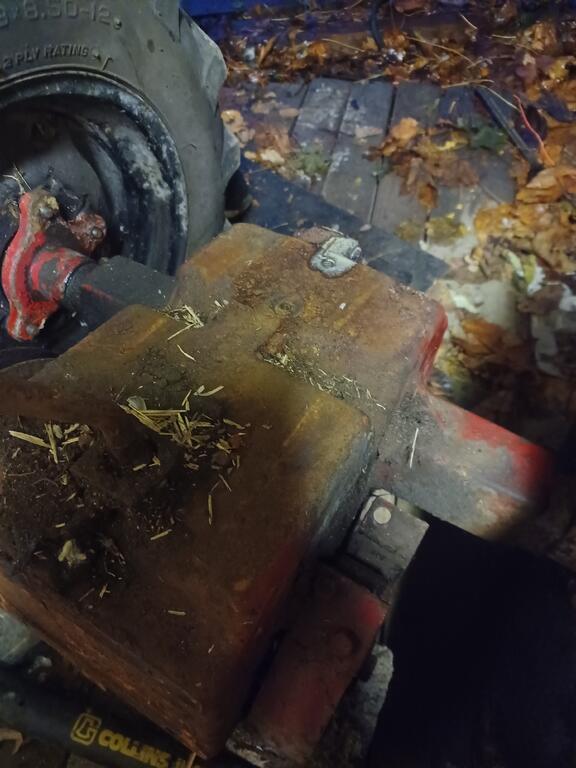

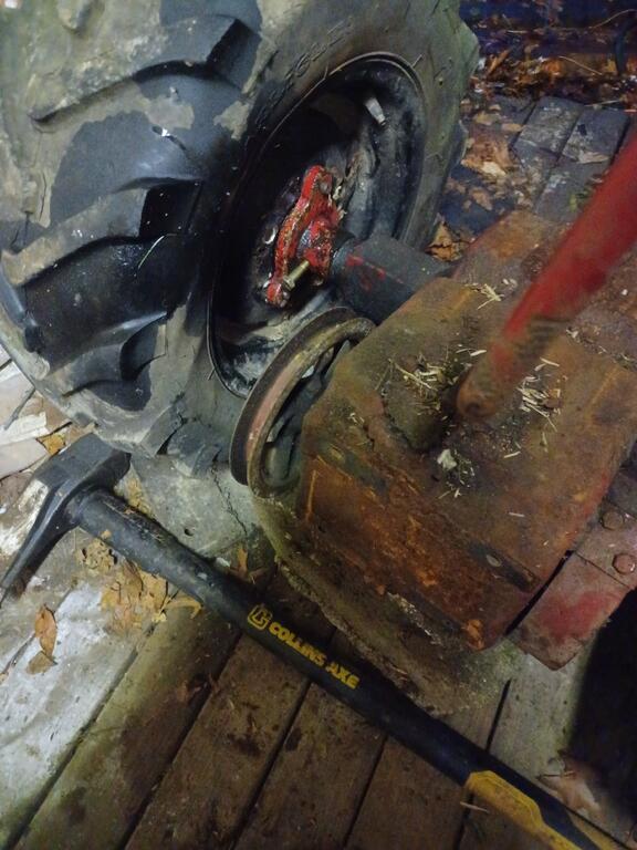

Donavon 20 #9 Posted November 21, 2023 Does this hub need fixed? Need answer asap 1 Share this post Link to post Share on other sites
Lagersolut 802 #10 Posted November 22, 2023 Yes on the hub - its wet drifted on axle and now rubbing the trans case - all the small stones/dirt that accumulate between hub and trans case with act like a grinder can ruin the bore . I rebuilt one ground and chipped out ....took another trans half case for seals to work 2 Share this post Link to post Share on other sites
Donavon 20 #11 Posted November 22, 2023 Original owner drilled the set hole for 5 hours DRY on the 3 bolt hub 4 Share this post Link to post Share on other sites
Pullstart 71,098 #12 Posted November 22, 2023 8 hours ago, Donavon said: Original owner drilled the set hole for 5 hours DRY on the 3 bolt hub Slow down a bit here. You need answers ASAP and there are tons of folks waiting to help. Read the responses and re-read your post (I like to read it out loud to hear how it sounds) to give us the tools needed for the help you need. 2 1 2 Share this post Link to post Share on other sites
953 nut 68,501 #13 Posted November 22, 2023 16 hours ago, Donavon said: Need answer asap Hope my response lives up to your expectations! Your hub needs to be held in place with a SET-SCREW, not a bolt. A set-screw is hardened steel and has a cupped end to grip the axie and the axle key. Here is a picture of a set-screw in case you don't know what one looks like. The axle seals can be replaced without taking the transmission apart. First you need to check the axle bearings to be sure they are in good condition. Jack up one side of the rear axle and see if the axle will move up/down or front/back. If there is any movement in either direction you need more than just seals. The seals can be purchased at NAPA or any good industrial supply house. Fore a 1" axle you will need a SKF-9815 seal; for a 1 1/8" axle the seal would be SKF 11050. While you are there get a couple new keys for the axles, chances are they need to be replaced also. Prior to installing the new seal be sure to smooth down any roughness on the axle to prevent damaging the new seal. 4 Share this post Link to post Share on other sites

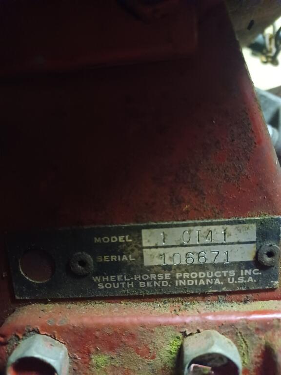

gwest_ca-(File Mod) 12,451 #15 Posted November 22, 2023 Just in case you have not found them yet 2 pages of info on the model 1-0141 https://www.wheelhorseforum.com/search/?q=1-0141&quick=1&type=downloads_file 3 1 Share this post Link to post Share on other sites

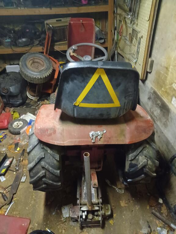

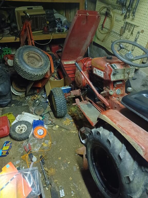

Landen Schonhut 0 #23 Posted February 12, 2024 Alr I got the plan, look at pics from the top of the condition of my tractor before you reply to answer please… So it’s been on hold for a while because the rebuild kit it really expensive. So what we are gonna to is put the shaft in and not touch the trans until we have the money. Do you think it will be fine with just a new shaft?? My grandfather said the new shaft will make it work just fine and not to touch the trans. That’s the plan. Does it sound alright? Share this post Link to post Share on other sites
oliver2-44 11,694 #24 Posted February 12, 2024 @Landen Schonhut We need a little more detail on what to look for in those pictures. What shaft are you talking about? If you don’t go through the transmission you really still need to fix that hub. Get new set screws as 953 said. Share this post Link to post Share on other sites
