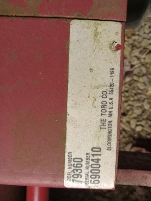

briankd 833 #1 Posted November 7, 2023 brought this home tonight from guy at work gave 100 bucks for it . wasn't used much still has original paint on sprockets and chain .going to put it on my c 120 have to fab a flag and lift tube i have pattern for both them also have some springs for my manual lift .if i get some work done on my c145 auto may put it on it . hopefully will get some decent snow buying this may scare the snow away 6 7 Share this post Link to post Share on other sites

briankd 833 #5 Posted November 7, 2023 This sat outside for about a year what the guy says I got it from Share this post Link to post Share on other sites

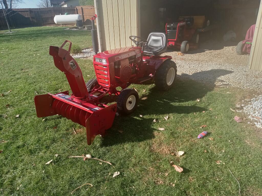

briankd 833 #6 Posted November 20, 2023 Cleaned up pretty good got the flag and lift pipe made along with chute rotation bracket that goes in mid hitch sometime this week have it on tractor and running 4 Share this post Link to post Share on other sites

briankd 833 #12 Posted November 23, 2023 Got installed runs great bring on the snow 4 Share this post Link to post Share on other sites
