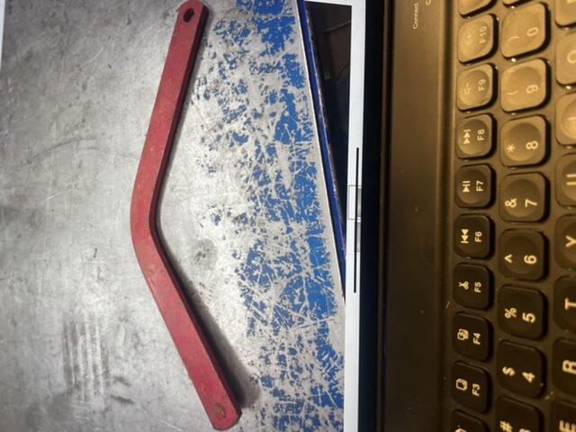

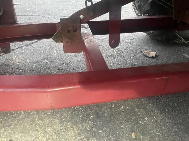

AHS 1,675 #1 Posted October 28, 2023 Ok.. let me see if i can explain this… up top i have the foot long straight lift bar set into the second hole. Down at the plow is where the problem is.. the lift bar is behind like 2’. Do they make a ‘c shaped 12” bar?’ I wonder if i put in the first hole at the top (closer to the front) if i can cheat a little bit by bringing the lift bar forward a little bit? Share this post Link to post Share on other sites

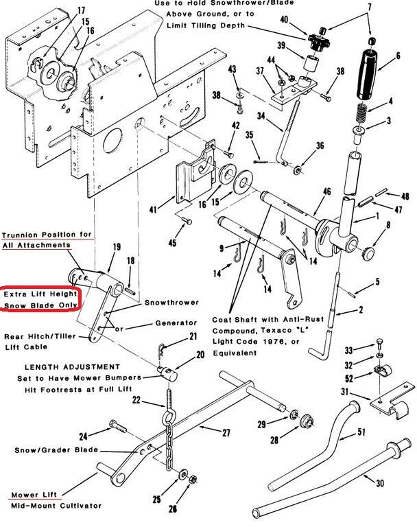

953 nut 65,692 #2 Posted October 29, 2023 You need to connect to the rock-shaft, not the mower lift bar. You can use a chain with a trunnion or a solid lift link. . 1 Share this post Link to post Share on other sites
lynnmor 8,787 #3 Posted October 29, 2023 Your drawing shows it connected to the mower lift bar. 1 Share this post Link to post Share on other sites
953 nut 65,692 #4 Posted October 29, 2023 (edited) 18 minutes ago, lynnmor said: Your drawing shows it connected to the mower lift bar. Not my drawing, it came from a Wheel Horse manual. The same or a similar chain can be moved to the "snow Blade ONLY holes. Edited October 29, 2023 by 953 nut fat finger 2 Share this post Link to post Share on other sites
elcamino/wheelhorse 9,363 #5 Posted October 29, 2023 @953 nut Thanks for posting the diagram, Dick. Put the plow on the 416-8 today, now I can check it to see if I have in the right hole. 3 Share this post Link to post Share on other sites
AHS 1,675 #6 Posted October 29, 2023 (edited) I have it connected in the middle hole. Maybe if i move it too the front hole, i can gain a little. A 6410 bar is what’s on here. What are those supposed to fit? Edited October 29, 2023 by AHS Share this post Link to post Share on other sites
ebinmaine 78,551 #7 Posted October 29, 2023 1 hour ago, AHS said: I have it connected in the middle hole. Maybe if i move it too the front hole, i can gain a little. A 6410 bar is what’s on here. What are those supposed to fit? That bar/ link should be straight. You can use either a piece of chain or a solid bar. The correct solid bar is around 11 inches long. Solid bar gives down pressure capabilities. VERY handy when trying to scrape hard snow or even ice. On my Automatic Tractor with the 60" blade I use a chain but the plow itself is so heavy it needs no additional downward pressure. I can get you measurements if it would help. Another thing you can do to lift the FRONT is to lower the REAR of plow frame. A spacer between the tractor axle and plow mount bracket will do the trick. I have 2 tractors here with that. 2 Share this post Link to post Share on other sites
AHS 1,675 #8 Posted October 29, 2023 @ebinmaine i put the. Plow lift in the front hole… NOW it line up perfectly with the plow! Only thing is getting my mower chain up there and clipped! 1 Share this post Link to post Share on other sites

peter lena 9,863 #15 Posted October 30, 2023 @AHS thanks to @953 nut for the blow up drawing ! note every / all the intended movement areas ? like a aerosol penetrating oil first , make the rust run out , then use an aerosol red spray grease , tell me how easily that set up moves , get some in lift lever upper spring push point , so it moves easily , cross frame bronze bushings , detail all of it , good luck , pete Share this post Link to post Share on other sites
