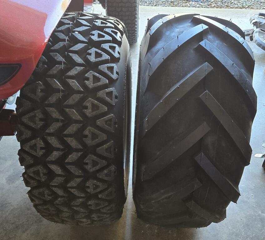

Bill D 3,213 #101 Posted January 13, 2025 2 hours ago, kpinnc said: Well I knew Deestones were smaller than advertised, but I was shocked by these. The ags are Deestone 23x10.50-12 on 8.50 wide rims. The Carlisles are 23x8.00-12 on standard 7.50 rims. Very little difference... Despite the size issues, they seem like good quality tires. I guess time will tell. 2 Share this post Link to post Share on other sites
kpinnc 19,105 #102 Posted January 14, 2025 13 hours ago, Bill D said: Despite the size issues, they seem like good quality tires. I guess time will tell. I agree. They are very heavy and seem to be good tires. Share this post Link to post Share on other sites

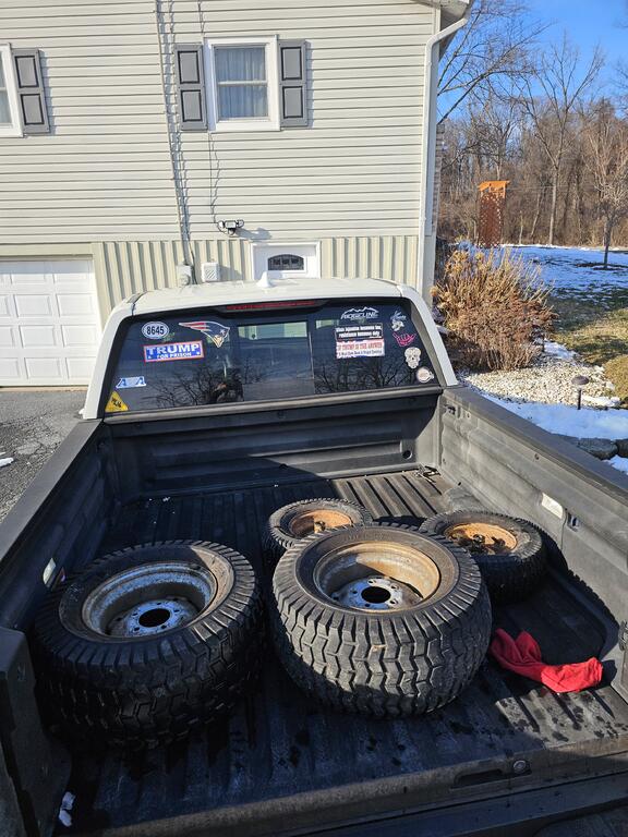

HyperPete 949 #124 Posted January 27, 2025 (edited) Tomorrow I get my tires swapped. Can someone suggest a reasonable price to list a pair of Carlisle 23x10.50-12NHS Turf Savers in decent condition for? I doubt I'll be swapping them back on, especially after filling the new AGs with Rimguard. Pic can be zoomed. Edited January 27, 2025 by Pete D Share this post Link to post Share on other sites
RED-Z06 2,720 #125 Posted January 27, 2025 7 minutes ago, Pete D said: Tomorrow I get my tires swapped. Can someone suggest a reasonable price to list a pair of Carlisle 23x10.50-12NHS Turf Savers in decent condition for? I doubt I'll be swapping them back on, especially after filling the new AGs with Rimguard. Pic can be zoomed. Used tires are a crap shoot, if a tire is in mint condition with no rust stuck on the beads, no repairs, no dry checking...id consider selling them for $35-$45ea...but I normally have 1 tire thats not perfect and can the pair. You can get new ones for about $90 shipped in that size and brand, or about $70 shipped in other brands. Share this post Link to post Share on other sites
