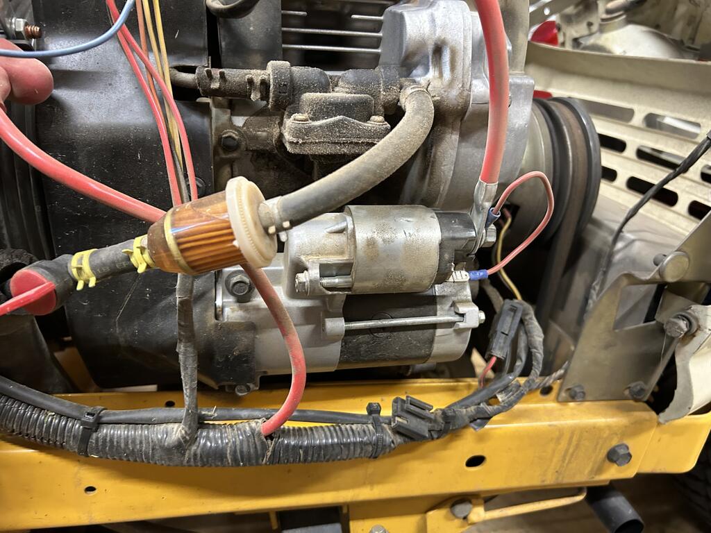

Horse Newbie 7,405 #29 Posted April 28, 2024 On 4/25/2024 at 8:31 PM, Bill D said: What engine is in your cub? I may have a starter if you need one? Let me check @Bill D , My Cub is cranking with Taryl’s “add a solenoid” trick, but I would like to get my hands on an OEM starter if I could. I will get back to you. 2 Share this post Link to post Share on other sites
ebinmaine 79,718 #30 Posted April 28, 2024 6 hours ago, Horse Newbie said: Taryl’s “add a solenoid” trick, What's this ? 1 Share this post Link to post Share on other sites
Horse Newbie 7,405 #31 Posted April 28, 2024 (edited) 5 hours ago, ebinmaine said: What's this ? @ebinmaine Eric, Let me know what you think… Edited April 28, 2024 by Horse Newbie 1 Share this post Link to post Share on other sites
ebinmaine 79,718 #32 Posted April 28, 2024 6 hours ago, Horse Newbie said: @ebinmaine Eric, Let me know what you think… Heckuva trick there... I don't see WHY it works.... 1 Share this post Link to post Share on other sites
Wayne0 1,574 #33 Posted April 28, 2024 It works because it bypassed the built in solenoid on the starter. Genius! 2 Share this post Link to post Share on other sites

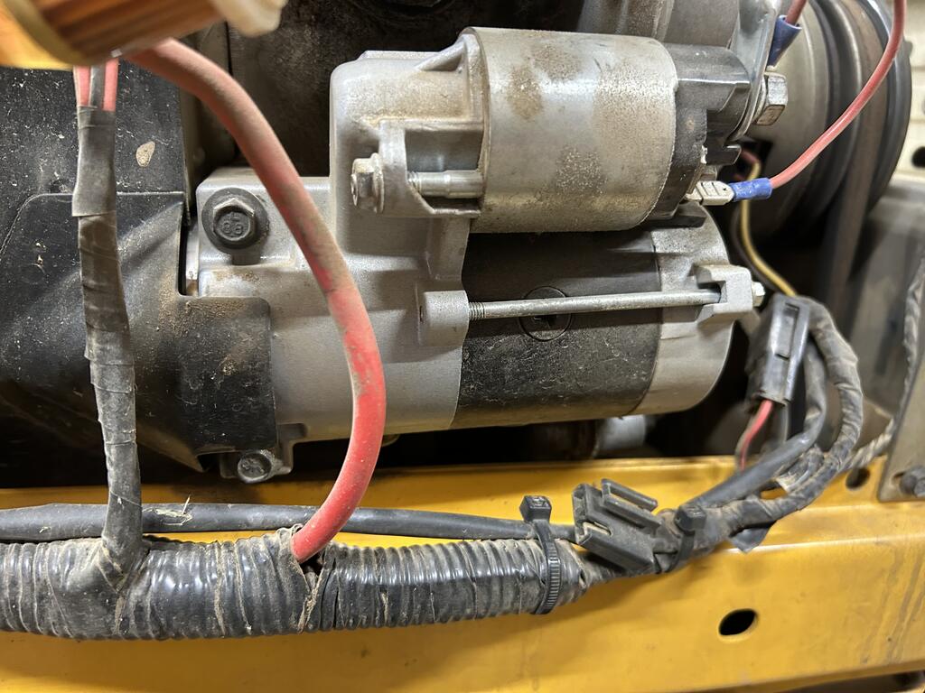

Handy Don 16,961 #34 Posted April 28, 2024 (edited) 13 minutes ago, Wayne0 said: It works because it bypassed the built in solenoid on the starter. Genius! It doesn’t bypass the original solenoid--the two solenoids are now in series. If he bypassed the original, he would NOT need that jumper across its two terminals. I’ve done this on one vertical Kohler and my suspicion is that the actuator in the original solenoid requires a good amount of current to work correctly. Any bad wiring fails it. I proved this to my satisfaction by direct jumping it to battery. plus. What Taryl has done (cleverly, for sure!) is use a new, less demanding solenoid to deliver battery voltage simultaneously to both the solenoid actuator connection (the small orange wire) and the starter motor input connection (the big red wire). Lots of strong juice and a good crank and start. Edited April 28, 2024 by Handy Don 2 Share this post Link to post Share on other sites

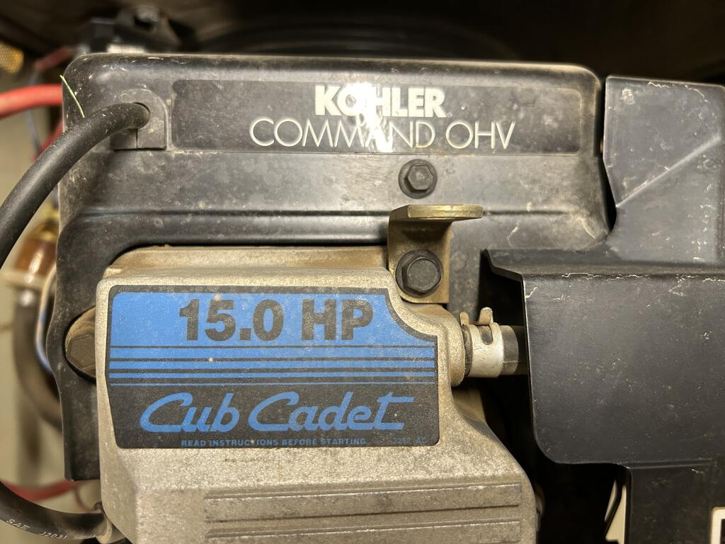

Horse Newbie 7,405 #35 Posted April 28, 2024 On 4/25/2024 at 8:31 PM, Bill D said: What engine is in your cub? I may have a starter if you need one? 20 hours ago, Horse Newbie said: Let me check @Bill D , My Cub is cranking with Taryl’s “add a solenoid” trick, but I would like to get my hands on an OEM starter if I could. I will get back to you. @Bill D , Here are a few pics of the Cub engine. I could not see any identifying marks on the starter… 1 Share this post Link to post Share on other sites
Bill D 2,996 #36 Posted April 29, 2024 1 hour ago, Horse Newbie said: @Bill D , Here are a few pics of the Cub engine. I could not see any identifying marks on the starter… Totally different engine. The starter I have is off a Kawasaki FH430V. 1 Share this post Link to post Share on other sites

Handy Don 16,961 #38 Posted April 29, 2024 I’m fairly sure that a feature of this style of starter is that the solenoid has two functions: 1) it closes the circuit from the battery to the starter motor, and 2) it pulls the pinion gear on the starter motor shaft into engagement with the ring gear on the flywheel. That extra function is what, I suspect, causes it to need a strong current to work properly. 2 Share this post Link to post Share on other sites
