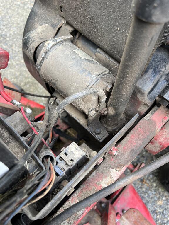

brewster 11 #9 Posted October 22, 2023 Thanks for all the posts. Per the request, here are pix of my old ‘n dead starter. The price I was told for a new OEM starter was about $350. Is that market? Thanks again 1 Share this post Link to post Share on other sites
953 nut 67,465 #10 Posted October 22, 2023 Have you used jumper cables from a known good battery directly to the engine block and the terminal shown in the photo? I see some discoloration on the oil fill tube and wonder if the cable connection may be bad causing heat at that point resulting in a voltage drop. 2 Share this post Link to post Share on other sites
squonk 47,419 #11 Posted October 22, 2023 26 minutes ago, 953 nut said: Have you used jumper cables from a known good battery directly to the engine block and the terminal shown in the photo? I see some discoloration on the oil fill tube and wonder if the cable connection may be bad causing heat at that point resulting in a voltage drop. Current could even be jumping to the fill tube. That is a terrible design. Should be a boot over that cable at least. 2 Share this post Link to post Share on other sites
elcamino/wheelhorse 9,363 #12 Posted October 22, 2023 @squonk Do you have a source for those boots? I have not been able to find them. My oil fill tube has the same discoloration. @brewster The old starters have a threaded hole for the small bracket to attach the starter to the base and probably provide a ground to the starter, new starters only have a hole that is not threaded. Just an FYI 2 Share this post Link to post Share on other sites
Ed Kennell 46,607 #13 Posted October 22, 2023 This is a $49 starter I installed 2 years ago. It may have been the one I needed to drill out the end cap and use my old longer bolts that in addition to holding the starter assembly together, also thread into the mounting block. It has been working fine with instant starts for two years. Do your starters and batteries a favor....add a primer bulb for instant starts. Here is my solution to the insulation of the positive lug on the starter. Slide a rubber 1" hose over the oil fill pipe. Don't damage the fill pipe O ring. 2 4 Share this post Link to post Share on other sites

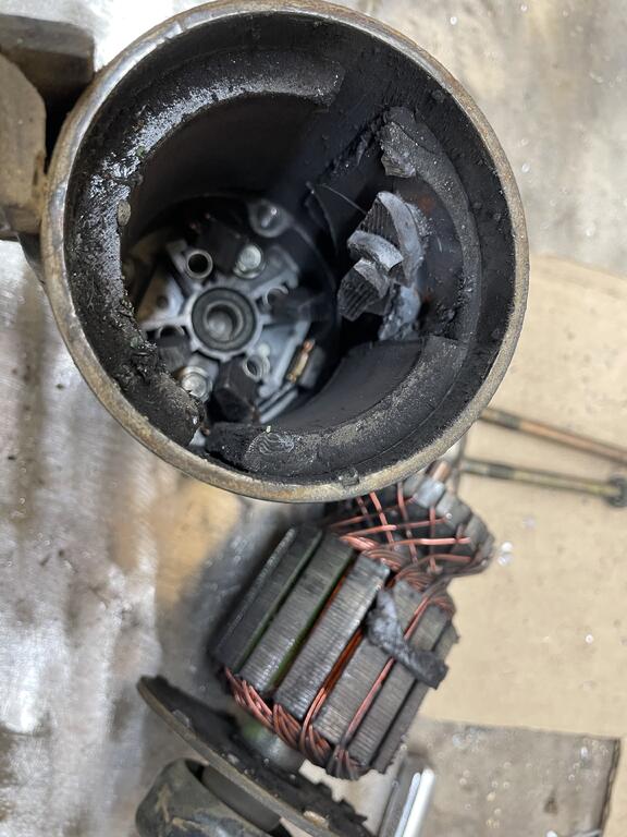

OoPEZoO 607 #21 Posted October 23, 2023 (edited) Crap.....I'm in the same boat. The starter on my 314-8 (K321 motor) has been a little "sticky" ever since I bought it almost 20yrs ago. Anytime it acted up, I could just give it quick smack and it would then start the tractor. I had the flywheel shroud off today and decided it was a good time to pull the starter and take a closer look. Damn it.....the magnets are trashed. Everything else looks to be in good shape. What a bummer. Edited October 23, 2023 by OoPEZoO 2 Share this post Link to post Share on other sites
squonk 47,419 #22 Posted October 23, 2023 The magnets are trash because you hit it. 4 Share this post Link to post Share on other sites
OoPEZoO 607 #23 Posted October 23, 2023 2 hours ago, squonk said: The magnets are trash because you hit it. True story.....but at the time, it beat pushing a tractor back to the garage. I cleaned everything up, removed the broken magnet pieces, lubed up the important parts, and put it back together. Surprisingly, it still seems to function fine. I'm going to see if I can milk it for another 20yrs. 1 2 Share this post Link to post Share on other sites
