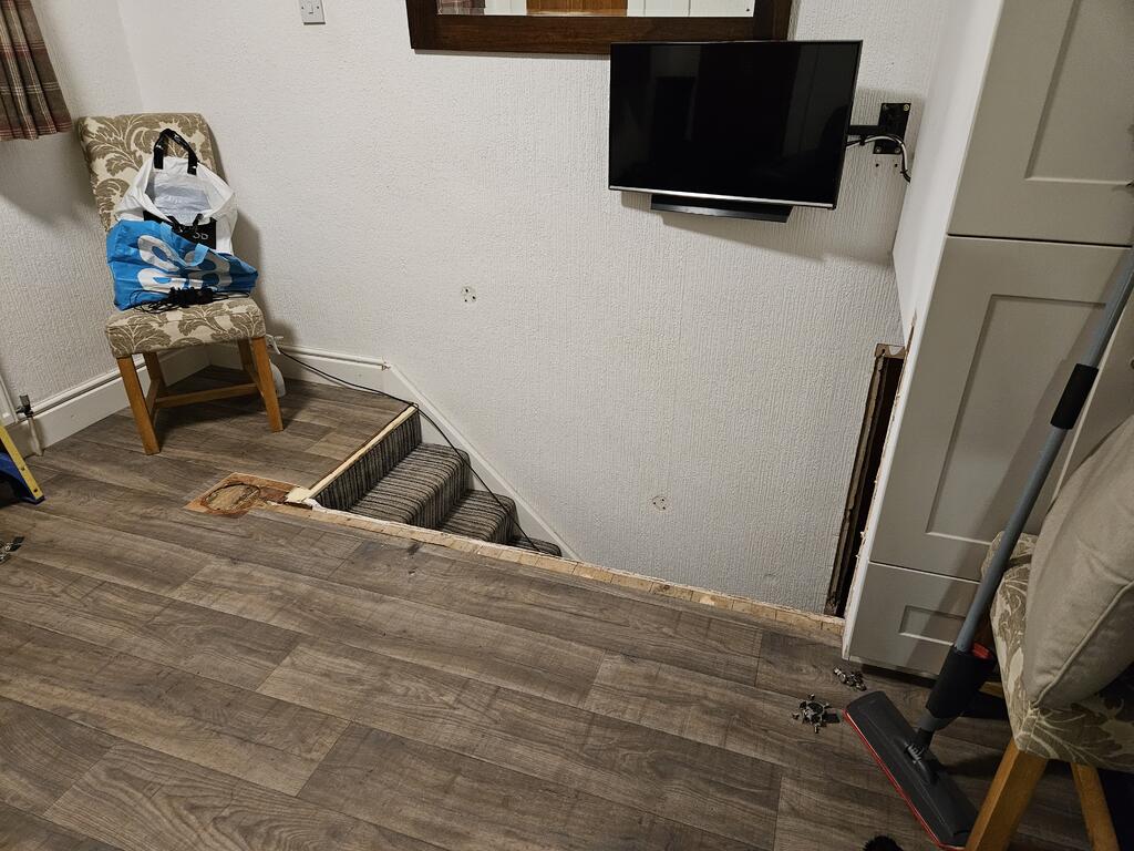

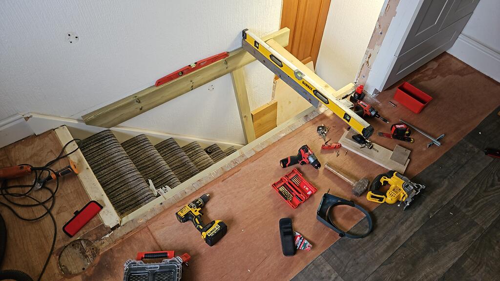

Mickwhitt 5,259 #1 Posted October 12, 2023 OK guys, the wonderful wife requires a trapdoor making to fit over a staircase that goes down into our garage. If we cover the stairs we can use the room as a separarate bedroom, but open it up if we need to use the stairs. There are companies that make such things and we had a quite today of £5,000 for a floor door 1.7m x 0.8m That's a lot of the folding stuff.... So I can make my own hatch no problemo, but what about the hinges? I've seen complex multi piece hinges that look quite fiddly to set up. And I've seen what look like simple bar and pin hinges which I'm pretty sure I can fabricate. Does anyone have any experience of making such a door in the floor. Especially the hinges, I need a clue to designing a suitable simple but strong hinge. Thanks guys. Mick 1 Share this post Link to post Share on other sites

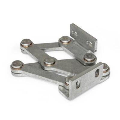

Mickwhitt 5,259 #6 Posted October 13, 2023 Gentlemen, again Red Square hits paydirt. I've had a look round the Web and found what I think are just the hinges for the job. 90 degree opening so they will hold the trap door up as a side wall when open to prevent falling in. perfect for the style of door i am thinking aboit. Plenty of literature with them so I'm going to buy a set to play with and develop the idea. To answer questions asked in your responses, yes its going to be weight bearing but it's along a wall so won't be stepped on all the time. Yes it's going to be flush fitting and as near invisible as I can achieve. I may look at some kind of actuator to lift it, probably electric, but air would be fun as I have a huge compressor feed. 3 Share this post Link to post Share on other sites

Mickwhitt 5,259 #8 Posted October 13, 2023 CCW yes the head clearance end will have a hinge up flap to allow me to walk down without banging my crust. Doing the work myself will allow me to design around the issues I find as I go along. Having a door made would be more expensive and not exactly as needed fir the conditions I have. I'm also going to hinge the floor trapdoor to the right hand side looking down the stairs to provide a barrier when it's open. 1 1 Share this post Link to post Share on other sites
953 nut 65,367 #9 Posted October 13, 2023 Have you considered using a set of "Swing Clear" hinges? Also, a solid door would be a very good option for the floor section. 1 Share this post Link to post Share on other sites

Mickwhitt 5,259 #11 Posted October 14, 2023 The idea is to create an extension of the floor area when we don't need stair access, so the door, flap, trap needs to be strong enough. Most of the ones I've seen online have a steel subframe with a thick ply deck, which is the way I am going to go. I'm using these special hinges as they are completely enclosed and invisible when the trap is shut, ideal for our purpose. Weight of the finished door is obviously a consideration as I have to be able to open it. But I'm looking into various options from gas struts to pneumatic lift cylinders, electric actuators look too slow. When the hinges arrive I will make a model of the trap to see how things fit before I get welding. 2 Share this post Link to post Share on other sites

Mickwhitt 5,259 #19 Posted October 15, 2023 Well, it's funny the mobile bed should come up... When we were just going to convert the room back to a bedroom I had that very idea. Track system to run the bed on and a pair of steel pin and socket supports on the wall to support that back corner. But she who must be obeyed would not sign off on the deal so it was shelved. As regards support for the door when closed I'm making a frame for it to sit in which is fully supported. Kind of stealing the best ideas from designs I've seen on Pinterest. I will run anything past you guys before I commit to it. Especially the control system. I would love air power as it is so quick and powerful, but I'm still thinking about it. 2 Share this post Link to post Share on other sites

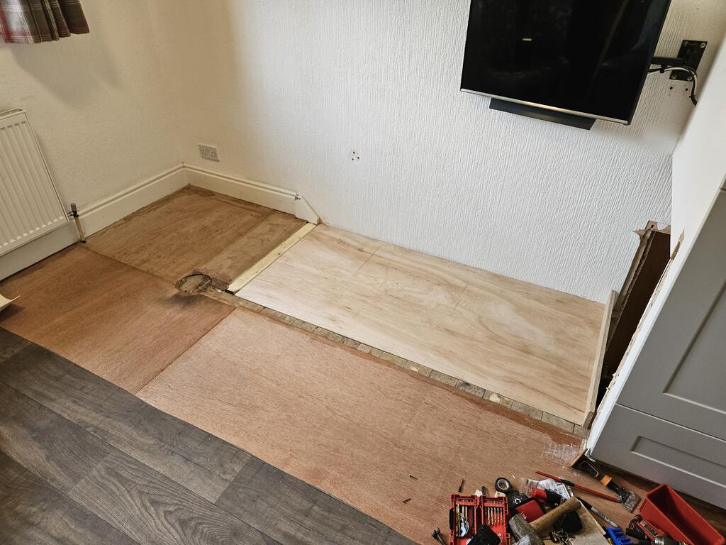

Mickwhitt 5,259 #20 Posted October 16, 2023 Bit of progress today, I fitted a wall plate to the hinge side and cut a piece of 19mm flooring ply for the trap door. Fitted a wall plate on the closure side and checked that all seems to fit OK. Next it will be making the frame and hatch for the head room access. Then hopefully the hinges will have arrived and I can start planning the support frame for the door. 4 1 Share this post Link to post Share on other sites

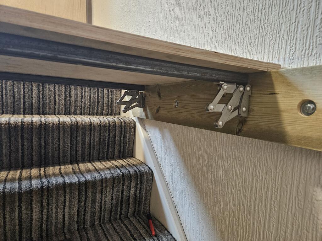

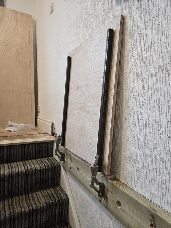

Mickwhitt 5,259 #24 Posted October 20, 2023 The new hinges have arrived and they are very solid. I've made a small version of the flap to see how the hinges fit and work. 4 Share this post Link to post Share on other sites
Handy Don 16,305 #25 Posted October 21, 2023 (edited) 6 hours ago, Mickwhitt said: The new hinges have arrived and they are very solid. I've made a small version of the flap to see how the hinges fit and work. Nicely done, sir. Great that the hinges are only supporting the door weight and only whilst the door is open. Carry on! Edited October 21, 2023 by Handy Don 1 Share this post Link to post Share on other sites
