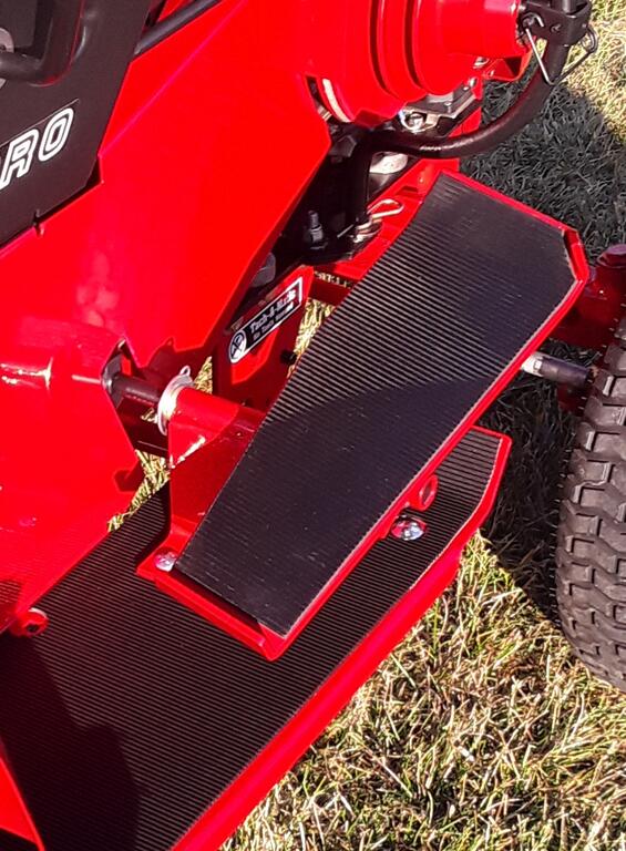

Bill D 2,990 #8 Posted October 12, 2023 I've made two different styles and it's tough to decide which I like better. I'm waiting for a couple of guys from Redsquare to stop by and take them for a test drive to get their opinions. After using the pedal on my 416H to mow last week I may have to make some minor changes as I find the pedal pressure a little heavy especially when going uphill. 1 Share this post Link to post Share on other sites

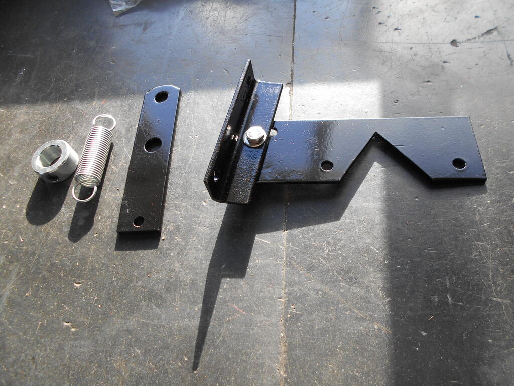

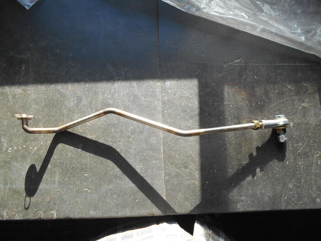

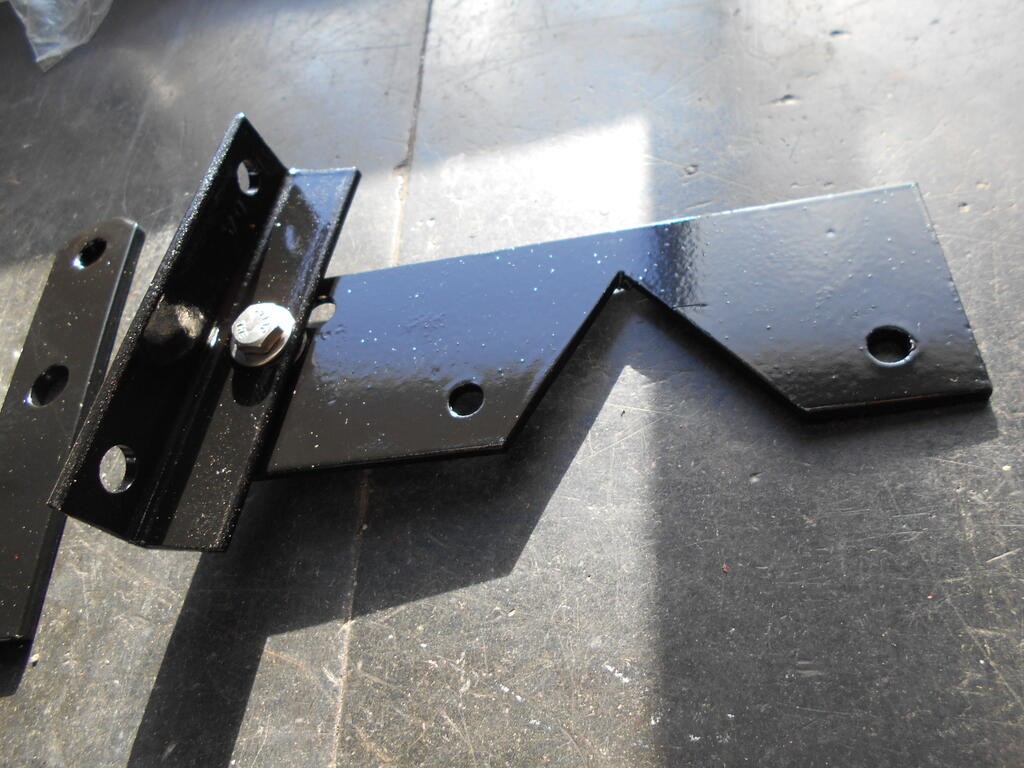

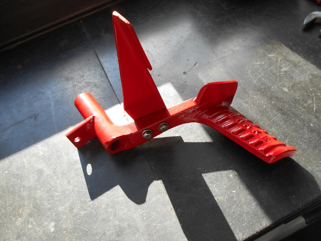

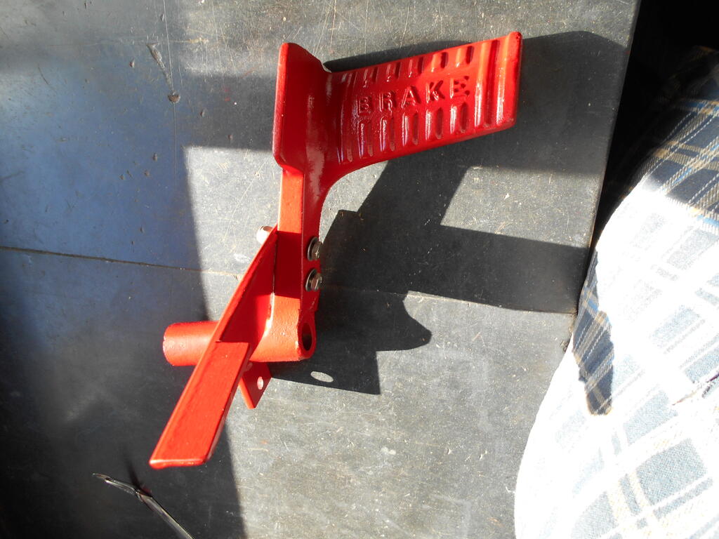

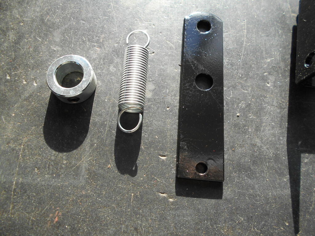

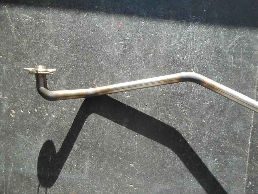

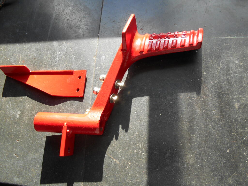

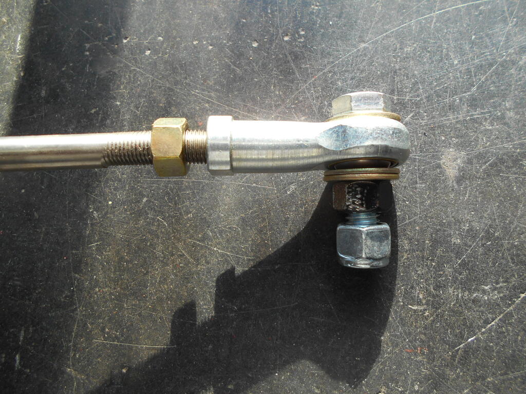

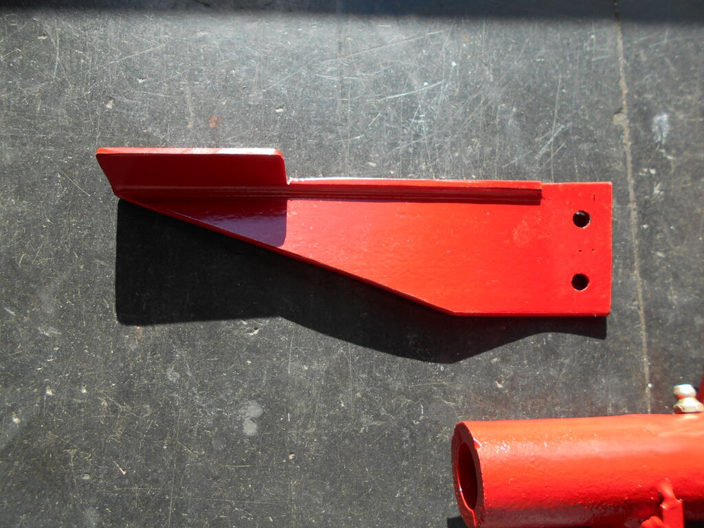

cleat 9,005 #9 Posted October 12, 2023 (edited) On 10/10/2023 at 8:22 PM, stuppy62 said: In the past I have purchased 3 Hydro pedals from Matt's Pedals. Does anyone know Matt and if he's still making these? Otherwise, does anyone know anyone making pedals, I'd like to buy 2. Thanks, Dave Not to undermine Matt and his great kits (I have bought 6 of them) but if you can remove one of the kits from a tractor it is not too difficult to copy. If he was still in business I would not even suggest this. Hardest part is the actual pedal but of you can get your hands on a brake pedal from an 8 speed machine you can weld a tab on the bottom for the rod connection and bolt on a piece of angle iron onto the side for the reverse pedal using Matts as a template. This is what I came up with. Reverse pedal is just a piece of angle iron cut away to leave what I wanted then bent to sit how I liked. Rest of the kit is mostly flat bar and angle iron. I duplicated the control rod using 3.8" rod then cutting fine threads on one end with a die for the rod end again using the original Matts rod as a template. I will not disclose any measurements, you must have an original to copy. Edited October 13, 2023 by cleat 1 Share this post Link to post Share on other sites
Damien Walker 297 #10 Posted October 12, 2023 Nice work! Share this post Link to post Share on other sites

cleat 9,005 #16 Posted October 13, 2023 4 hours ago, stuppy62 said: Cleat, that's a good idea that I could do! I wouid have to source 2 of the right pedals. That would be an ambitious project being that I have to remove kit , then put it back on! Thanks, I'll give it some thought, winter project! I bought 2 pedals off ebay fairly cheaply. I don't weld so I had a friend weld the tabs on the bottom for me. He said it was a bit tricky because the pedal is made of cast iron or steel. 1 Share this post Link to post Share on other sites
davem1111 2,282 #17 Posted October 13, 2023 26 minutes ago, cleat said: I bought 2 pedals off ebay fairly cheaply. I don't weld so I had a friend weld the tabs on the bottom for me. He said it was a bit tricky because the pedal is made of cast iron or steel. Pretty sure they are cast iron. This is why I'll probably just fab something myself... not so great welding skills. I guess if I had a spare right brake pedal I might give it a shot, but I'm worried that I'd be throwing money away if I bought one then tried to weld it. Share this post Link to post Share on other sites

cleat 9,005 #19 Posted October 13, 2023 Reading this manual that I just found on here of Matt's early kit seems like he used a brake pedal with a bolt on adapter. Wheel Horse Hydro Foot Pedal Instructions V1B.pdf I would stick with the ball bearing on the motion block that Matt switched to later on (likely how your kit is). 1 Share this post Link to post Share on other sites
Rick3478 454 #20 Posted October 13, 2023 9 hours ago, davem1111 said: Pretty sure they are cast iron. This is why I'll probably just fab something myself... not so great welding skills. I guess if I had a spare right brake pedal I might give it a shot, but I'm worried that I'd be throwing money away if I bought one then tried to weld it. Yeah, cast. So don't they already have a tab, just on the wrong side? Could you cut a piece with a hole big enough to fit over and around the pedal shaft, then bolt and braze it into place so that even if the braze cracks it can't move? So I tried to insert an image I just drew, but it won't let me. Apparently all I can do is attach it. 1 1 Share this post Link to post Share on other sites
