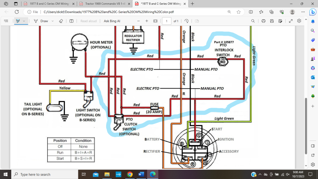

953 nut 68,140 #5 Posted October 6, 2023 You said it stalled with the snow blower on but was not a problem previously. Will energising the PTO without the snow blower stop the engine from running without the snow blower on the tractor? On later model the PTO switch has two switches in it. One switch will prevent the starter from operating when the PTO is engaged, the other half on the PTO switch is in series with the seat switch and will shut down the engine's ignition if there is no operator in the seat when the PTO is activated. The wiring diagram for a 1977 B and C series shows an electrical switch that will prevent starting with the PTO on but there doesn't appear to be a seat switch and nothing from PTO switch controlling the ignition. Share this post Link to post Share on other sites

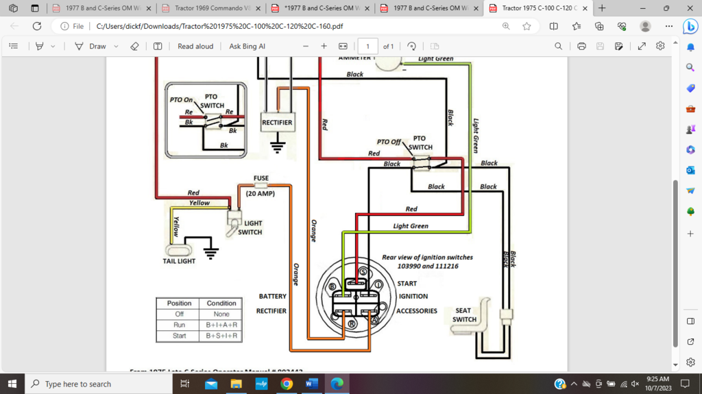

Racinbob 13,086 #6 Posted October 7, 2023 Richard, that is not the correct diagram. I was baffled when I read your post because I knew my 76 had a seat switch and you're right, it doesn't show it. Here is the correct diagram taken from the original owners manual. Apparently we need to be wary of those colored diagrams. 1 Share this post Link to post Share on other sites
953 nut 68,140 #7 Posted October 7, 2023 3 hours ago, Racinbob said: I was baffled when I read your post because I knew my 76 had a seat switch and you're right, it doesn't show it Thanks for posting this Bob. I couldn't think of a component that would cause this problem if it wasn't a seat switch. The drawing I pulled up from the files section was a bit confusing since it shows two PTO switches and lines that don't lead to anything that are calling out for a manual PTO and an electric PTO. Perhaps this is something Garry @gwest_ca can look into for us. Share this post Link to post Share on other sites
953 nut 68,140 #8 Posted October 7, 2023 The 1975 wiring diagram in our files section is like the one @Racinbob has shown us if @Pokk has a manual PTO rather than an Electric one. Keep the faith, we will figure this out! 1 Share this post Link to post Share on other sites

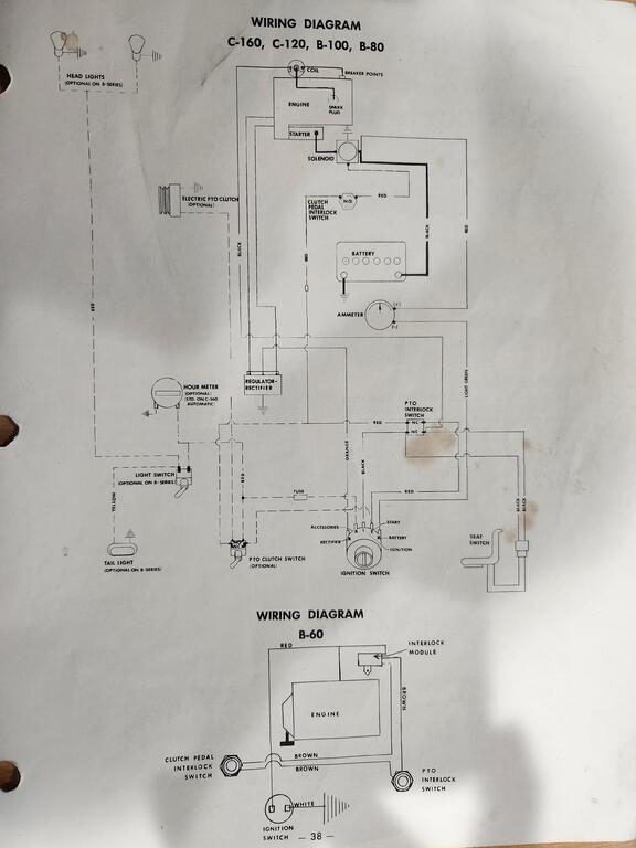

Phan 68 #9 Posted October 7, 2023 I found this on the internet Wheel Horse C160H 71-16KS01. It shows a wire to the seat which mine is missing the end wire connector of the seat (I might accidentally remove it). How/where can I connect it/buy it? Share this post Link to post Share on other sites
gwest_ca-(File Mod) 12,416 #10 Posted October 7, 2023 Read the notes here. 1 Share this post Link to post Share on other sites
gwest_ca-(File Mod) 12,416 #11 Posted October 8, 2023 20 hours ago, 953 nut said: Thanks for posting this Bob. I couldn't think of a component that would cause this problem if it wasn't a seat switch. The drawing I pulled up from the files section was a bit confusing since it shows two PTO switches and lines that don't lead to anything that are calling out for a manual PTO and an electric PTO. Perhaps this is something Garry @gwest_ca can look into for us. Models with electric pto clutch have the wiring on the left and controls the starter with the pto switch. Have forgotten which tractor models these are. Models with manual pto clutch have the wiring on the right. Single pto switch controls starter. 1 Share this post Link to post Share on other sites
953 nut 68,140 #12 Posted October 8, 2023 4 hours ago, gwest_ca said: Models with electric pto clutch have the wiring on the left and controls the starter with the pto switch. Have forgotten which tractor models these are. Models with manual pto clutch have the wiring on the right. Single pto switch controls starter. Do the electric PTO models have a seat switch? Seems rather odd that the 1975 drawing with a manual PTO has a set switch. and the electric PTO models show two switches. I have never owned either one so have no firsthand knowledge. 1 Share this post Link to post Share on other sites
