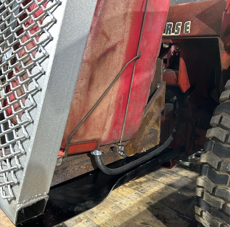

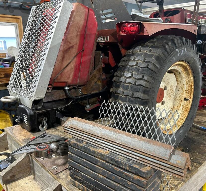

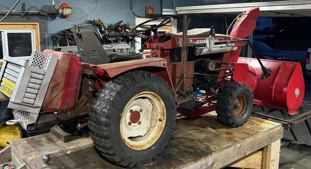

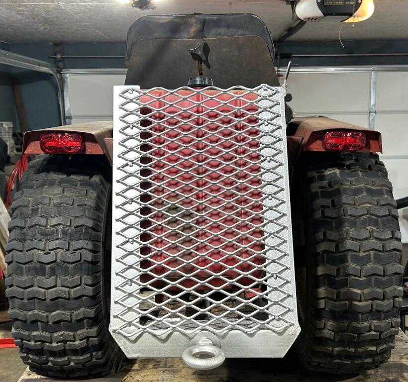

WHMan2012 180 #26 Posted October 8, 2023 Added a skid plate to the bottom of the gas tank / fuel line today, may have to make future changes but for now I'll go with this. May end up running the fuel line through a larger rubber line for more protection as well. Glad I started this project when I did, gives me time to triple check and change things, before the white stuff and cold weather gets here. Once I get my new drive belt I ordered and installed I'll roll her off the bench, it's just nice working on them up off the floor gives the back a break. 2 2 Share this post Link to post Share on other sites

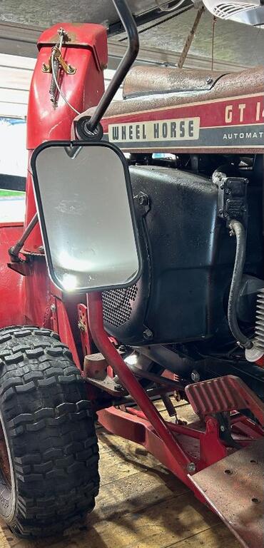

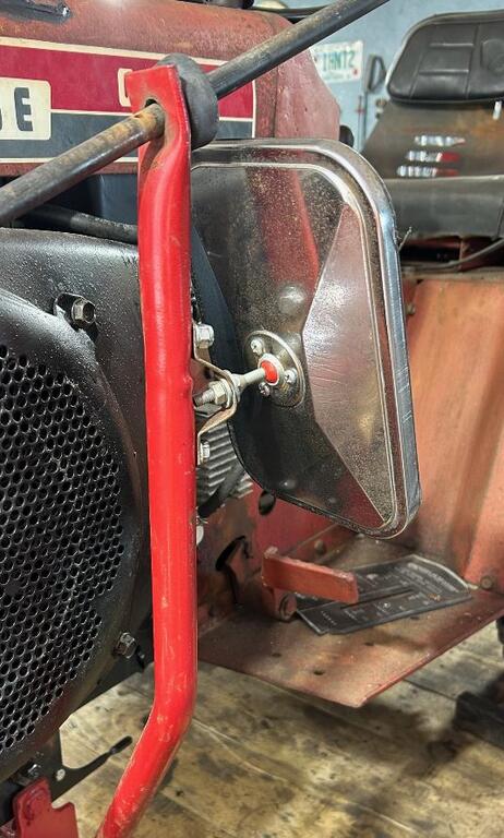

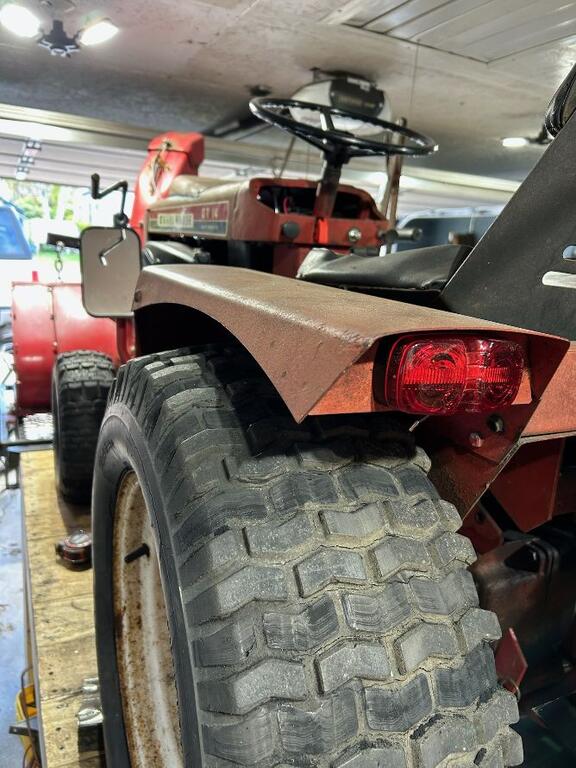

WHMan2012 180 #31 Posted October 9, 2023 I had this mirror kicking around the garage for a few years now figured I'd try it out here, only for the fact I live on a side street next to a College and have had a lot of close calls while cleaning up along the edge of the road. I will also be adding blinking lights to the back as well, because I live near one of their off campus buildings where they hold classes well into the night. If the mirror thing don't work, I'm only out 10 minutes of my time, so no big deal. As for the hubs I'll have to keep my eyes open for a good deal, people think just because they write vintage or antique next to it they can jack the price up 100%, it's crazy now not like it use to be that's for sure. 3 Share this post Link to post Share on other sites
ebinmaine 81,283 #32 Posted October 9, 2023 6 minutes ago, WHMan2012 said: for the hubs I'll have to keep my eyes open for a good deal Been a bit since I've bought a set. Check with Lincoln at A to Z Tractor in PA. He's been consistently lower than most of fleeeeBay for years. 7 minutes ago, WHMan2012 said: I will also be adding blinking lights to the back as well, because I live near one of their off campus buildings where they hold classes well into the night Can't speak for where you live but in Maine it's a State Law that any vehicle plowing in the road must have a flashing amber/yellow light visible from 360⁰ at all times while in a public way. 1 Share this post Link to post Share on other sites

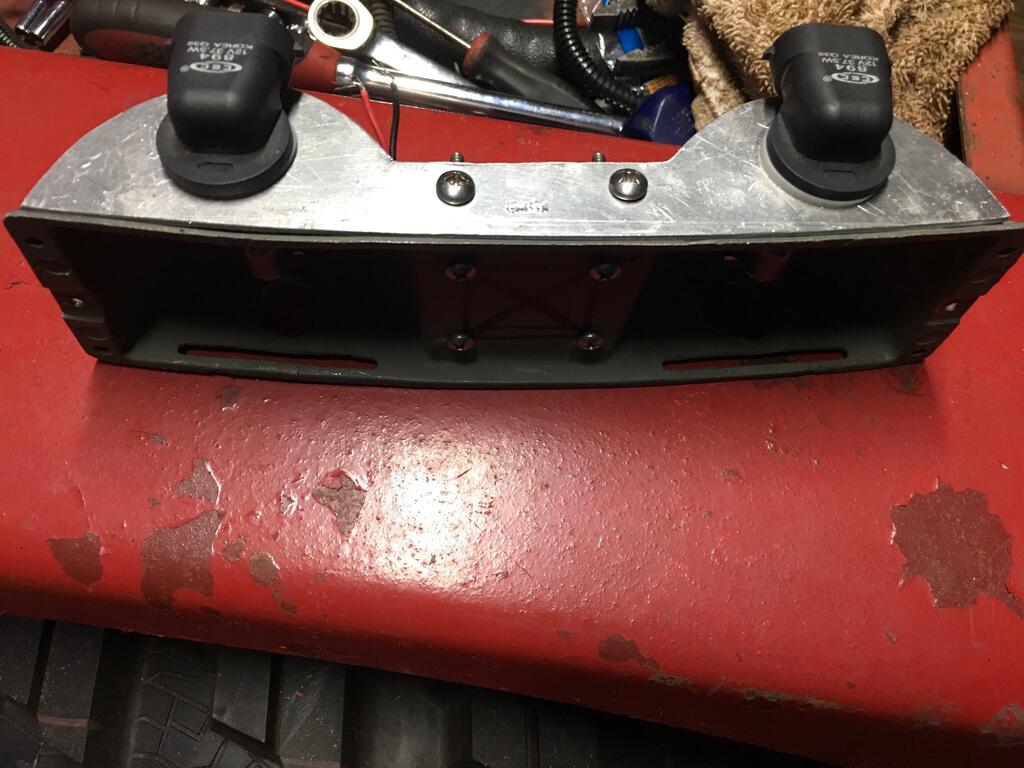

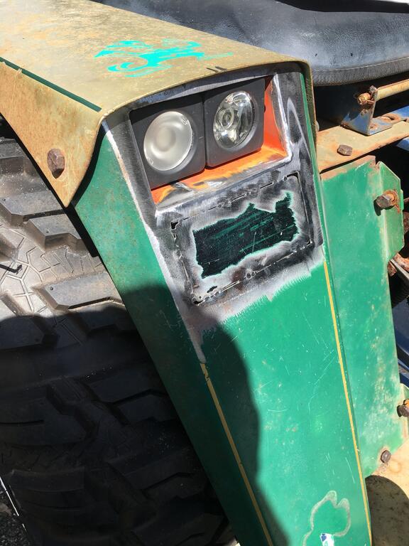

WHMan2012 180 #34 Posted October 10, 2023 Not sure what / or if any law we have here for blinking lights on vehicles except you can't have them on while go job to job down the road. I need more of a strobe light not a fan of those fast blinky lights some of these rescue vehicles have now a days, I swear sometimes I'm going to cause an accident while trying to avoid one. Anyone have some good ideas on a front led light that'll fit where the original one normally goes ? I did test mine before removing it but no luck, it was exposed to the weather way too long. I'd love to find someone local to fix my seat it's all there just came unstitched here and there, maybe even add more stuffing as well. By any chance does any have an extra dash piece the goes around the steering wheel ? If, not I can make something, just want to protect my wires and switches, Thanks again for the help and input, that's why I like this site ! 1 Share this post Link to post Share on other sites
ebinmaine 81,283 #35 Posted October 10, 2023 @19richie66 or @953 nut any thoughts on the LED lights? Would 3D guy Grey have a dash piece? Share this post Link to post Share on other sites
19richie66 17,951 #36 Posted October 10, 2023 (edited) 4 hours ago, ebinmaine said: @19richie66 or @953 nut any thoughts on the LED lights? Would 3D guy Grey have a dash piece? I believe he makes dash plates with a 3d printer. as far as lights go, you should be able to fit a couple 2x2 led pods in there. I put halogen 856 bulbs in mine with air conditioning and 2x2 pods in the fenders. They work great but my legs do get in the way of the inner ones. I am going to change them out for stock fenders again and rework something for them to fit in. Edited October 10, 2023 by 19richie66 2 8 Share this post Link to post Share on other sites
WHMan2012 180 #37 Posted October 10, 2023 Great ideas, I really like the fender lights. I love thinking outside the box and creating something that makes it mine, that's why I enjoy building these rigs. Thanks for the posts I may take your fender light idea and try something on mine, I like the look. 2 Share this post Link to post Share on other sites

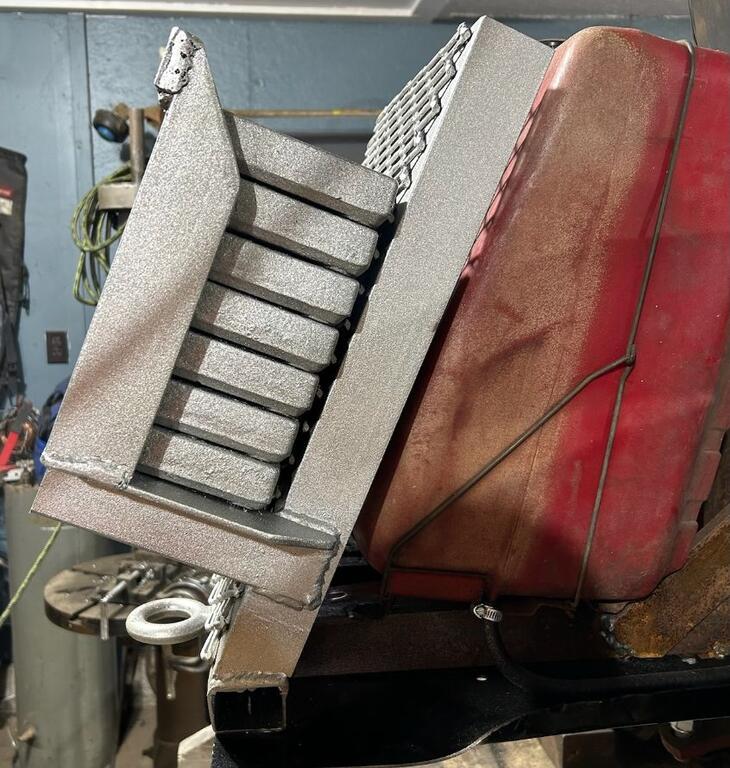

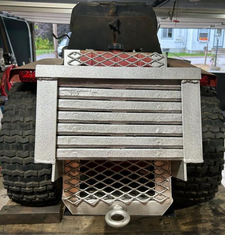

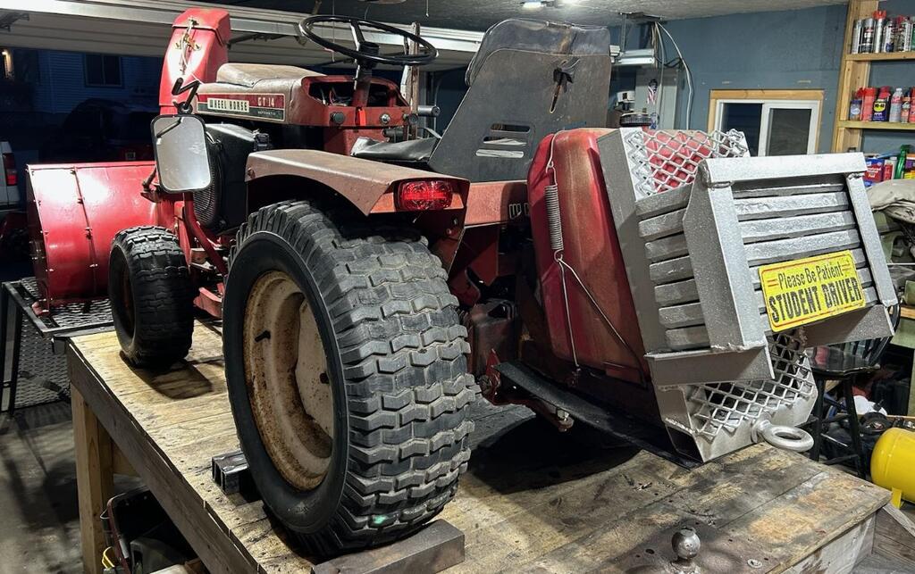

WHMan2012 180 #38 Posted October 10, 2023 Today I added 140#'s of weight to the back figuring the location plus the weight of fuel should do. Then I'll add some juice to the rear wheels once I get them squared away. Trying to get this done, Mt. Washington already recorded their first measurable snow over the weekend, it wasn't much but it's a sign Winter's just around the corner. 6 Share this post Link to post Share on other sites
ebinmaine 81,283 #39 Posted October 10, 2023 Looks excellent!! 1 hour ago, WHMan2012 said: Mt. Washington already recorded their first measurable snow over the weekend, it wasn't much but it's a sign Winter's just around the corner. You ain't wrong but don't let that big beast of a 🏔️ 🏔️ fool ya. 😅. 1 Share this post Link to post Share on other sites
19richie66 17,951 #40 Posted October 11, 2023 Does look nice. Might want to lop off the corners of your weight bracket at the bottom. That looks like a knee butcher. 👍 2 1 Share this post Link to post Share on other sites

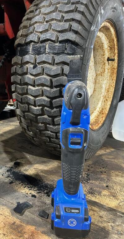

WheelHorseNut 222 #46 Posted October 11, 2023 On 10/7/2023 at 2:07 PM, WHMan2012 said: Found a great tool to cut tire tread and it works slick. I'm trying this way first to save some money then if this fails I'll try the rubber chains, just don't want to use real chains because our driveway is asphalt and also I help my neighbors and their driveways are asphalt as well. This is an awesome idea. I am curious to see how this works. Probably be great for loose dirt. 1 2 1 Share this post Link to post Share on other sites
