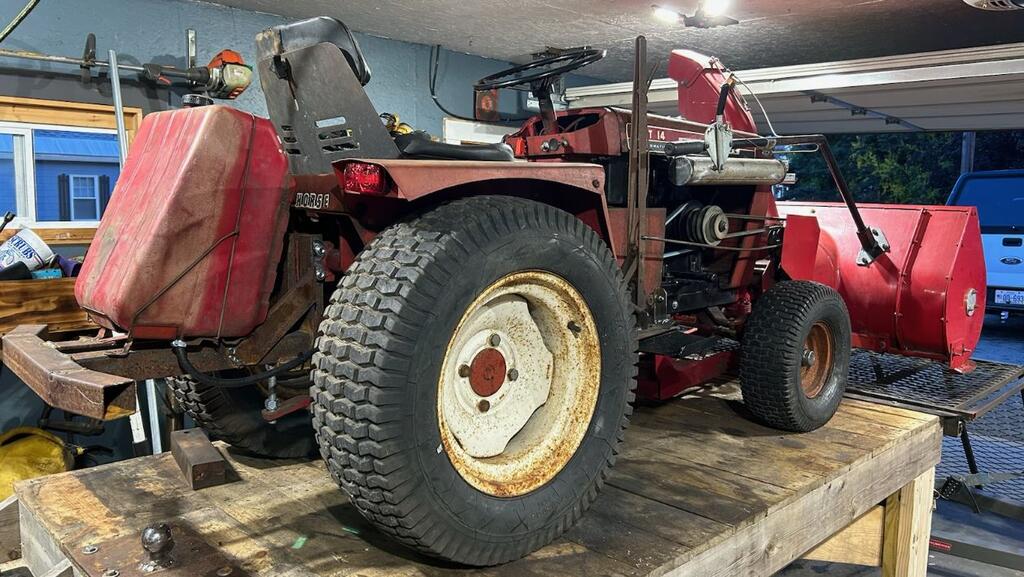

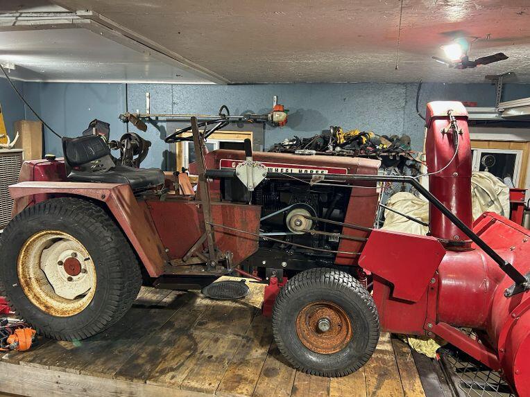

WHMan2012 180 #1 Posted October 4, 2023 Let me start off by saying I got bored this Summer lol ! I had posted my 2 - GT-14's along with my 2-stage snowblower earlier this Spring and after a while of no hits on that post and me with time on my hands, I decided to pull the 14hp Kohler off the GT-14 and a 20hp off a Sears SS tractor I had and make the ultimate snow blower rig for this Winter. Already bench tested everything and lets just say she didn't disappoint. the hydro is so quiet and it lifts this blower with no strain what so ever, which is the main reason for this conversion. Hope everyone had fun with their own projects, I know I sure did with this one. Thanks For Looking !! 1 15 Share this post Link to post Share on other sites

Moparfanforever 938 #10 Posted October 6, 2023 Are you planning ramming speed in reverse with the rear bumper !!! Is the fuel tank mount permanent?? I like 👍 the looks of all of it !! 1 2 Share this post Link to post Share on other sites
WHMan2012 180 #11 Posted October 6, 2023 LMAO No. lol no ramming just wanted something rugged and yes the gas tank mount is welded,but the bracket itself is bolted to the back of the tractor. Same goes for the extended foot rest on the right side, it's bolted up underneath the original foot rest using the holes that were already there. This was a project that on paper was going to be easy, but as I went along I found I had to modify certain things in order for the snowblower to work properly and for the pulleys to line up, along with raising the motor up and spreading the front tires, so the front axle could still have proper range of motion for uneven ground. The whole project was and still is pretty fun to build because there's no limits and most of the extra pieces I needed to do this I had sitting in buckets of spare parts or up on a shelf, so it helped keep the cost down. 3 1 1 Share this post Link to post Share on other sites

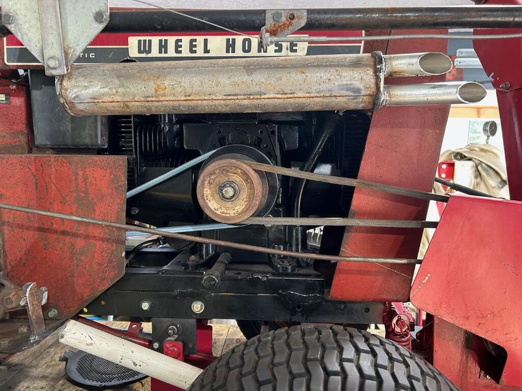

wallfish 20,618 #13 Posted October 6, 2023 Just noticed that last update pic You're gonna want to go bigger on that blower drive pulley on the engine. or move it to that bigger one. You got the power with a 20hp so at minimum match the PTO pulley size of the tractors it was desinged to be used with. Too small is going to slow that baby down so any snow with moisture won't go through fast enough. I use a 2 stage on a 520 (20 HP) and want go smaller on the driven pulley at the gearbox to add speed. 2 1 Share this post Link to post Share on other sites
ebinmaine 80,755 #14 Posted October 6, 2023 8 hours ago, WHMan2012 said: The whole project was and still is pretty fun to build because there's no limits and most of the extra pieces I needed to do this I had sitting in buckets of spare parts or up on a shelf, so it helped keep the cost down I agree with @wallfish Best part of the build process is the whole build process. Some folks like to use em when they're done and I do too.. but I also VERY much enjoy the creative part. And ... "Use what ya have" A favorite saying around the acreage here. 2 Share this post Link to post Share on other sites
WHMan2012 180 #15 Posted October 6, 2023 I was wondering about my pulley size as well, but like with all my projects my A.D.D. kicks in lol and I find myself here, there and everywhere then I go back and start double checking things. I will be going bigger because that is the whole purpose when building these projects is to go big or go home lol. I may just space the pulley out to line up with the next one in line or flip it, stay tuned for updated photos on that and other add ons, thanks and I really appreciate the input, anything to help make it perfom or work better I'm all ears, thanks . 2 Share this post Link to post Share on other sites

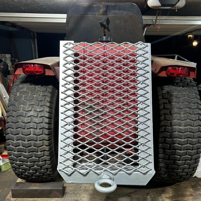

WHMan2012 180 #16 Posted October 6, 2023 (edited) Today I spun the pulley around this size is a little smaller than the one Wheel Horse uses, but it's all I have for now and it's bigger than the other one I originally had. Luckly I had a good belt as well hanging on the wall, so no money spent today lol wifey will be happy. After that, I built this little guard to protect the gas tank from the driver ( That'd be me ! ) who never looks back and likes to have inanimate objects stop him instead of brakes lol. I also shortened it up a little bit on the sides to expose the rear tires more in hopes of not getting hung up in snow banks or anything and added a ring to throw a hook through in case I get in a situation I can't get out of. The only reason I painted this and nothing else is I don't want to get hit from behind while clearing my driveway, so I figured a Metallic Silver should reflect the light better than rust colored metal,lol. Edited October 7, 2023 by WHMan2012 1 5 Share this post Link to post Share on other sites

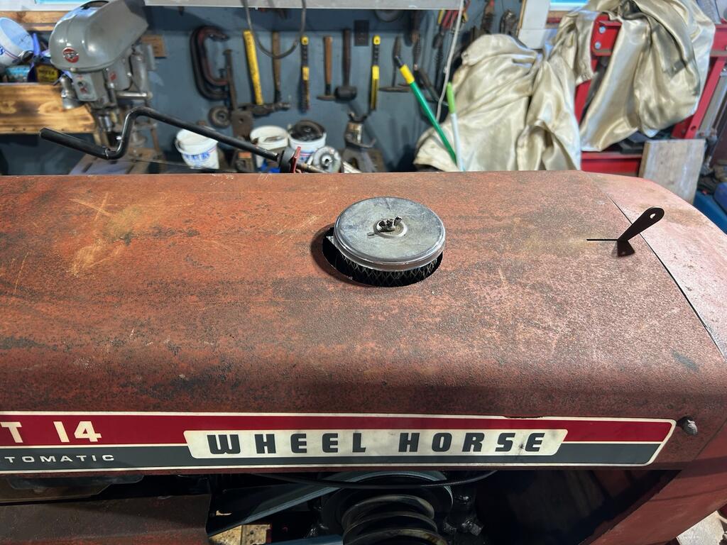

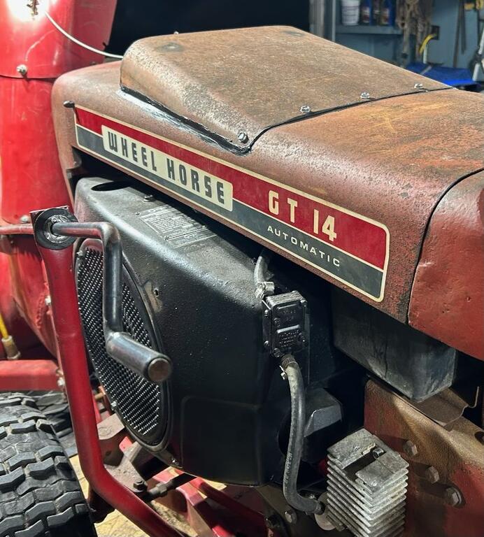

WHMan2012 180 #25 Posted October 7, 2023 Added a hood scoop today to cover up the air filter to keep the weather out, still may add a screen to the front to help out as well. I'll clean up the excess seam sealer once it's dry. 4 4 1 Share this post Link to post Share on other sites
