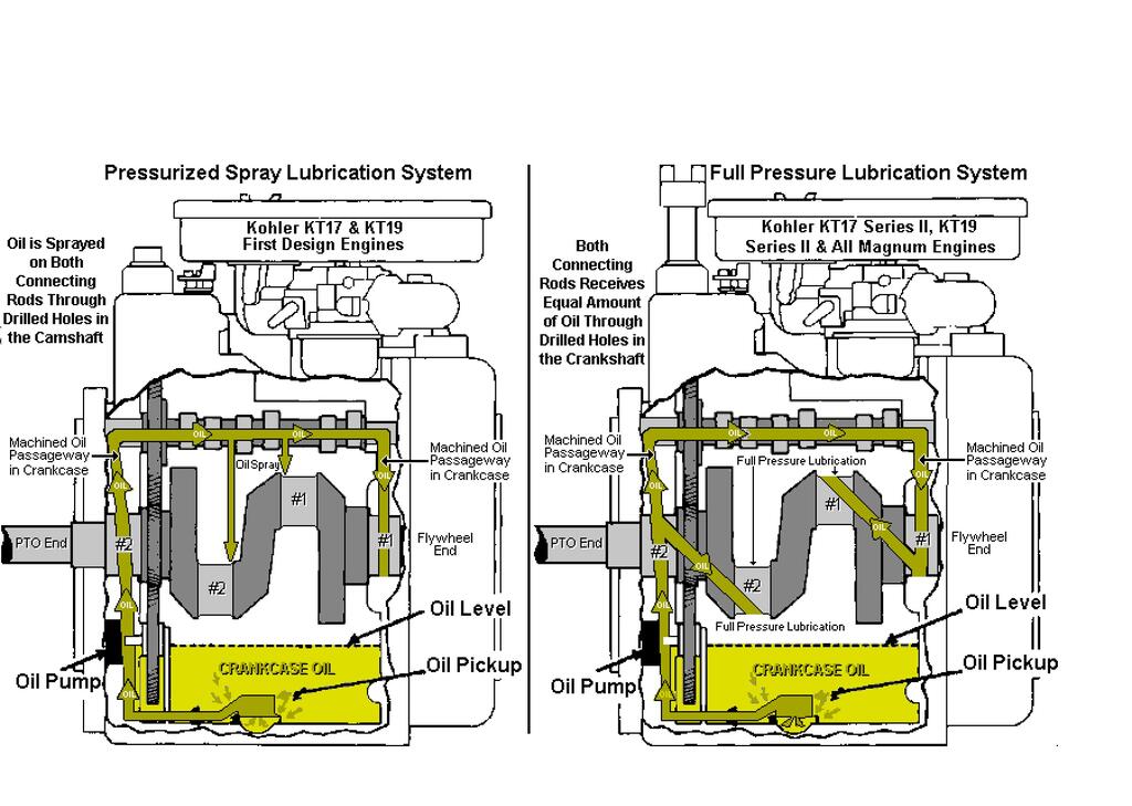

8ntruck 8,602 #10 Posted October 3, 2023 I'm thinking that a series 1 does not have provisions for an oil filter, and the series 2 does have oil filter provisions. Curious if the KT 17 series 1 had the same oiling issues that the KT 19 series 1 did. Share this post Link to post Share on other sites

Brockport Bill 2,216 #13 Posted October 4, 2023 here are 2 photos of what is my understanding shows the 2 different features of the Series 1 and Series 2 engine - Share this post Link to post Share on other sites

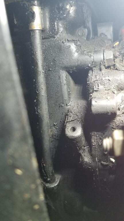

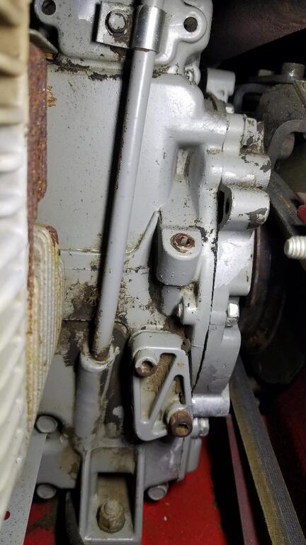

Brockport Bill 2,216 #14 Posted October 4, 2023 i have found the Series 1 or 2 engine model indication on the tins and the air cleaner to be unreliable since so many have been changed over the years 1 Share this post Link to post Share on other sites
ebinmaine 77,332 #15 Posted October 4, 2023 8 hours ago, Brockport Bill said: here are 2 photos of what is my understanding shows the 2 different features of the Series 1 and Series 2 engine - Bill it appears from my reading and asking questions that the earlier Series 2 engines did NOT have the oil filter boss. We have a pair of 1986 417As that we have no reason to believe have been modified and neither one has the boss to add an oil filter. Share this post Link to post Share on other sites
Brockport Bill 2,216 #16 Posted October 4, 2023 4 hours ago, ebinmaine said: Bill it appears from my reading and asking questions that the earlier Series 2 engines did NOT have the oil filter boss. We have a pair of 1986 417As that we have no reason to believe have been modified and neither one has the boss to add an oil filter. I have a c175 from 83 that's series 1 and a 84 c175 with series 2...it's certainly challenging to confirm various models with certainty?? 1 Share this post Link to post Share on other sites
ebinmaine 77,332 #17 Posted October 4, 2023 21 minutes ago, Brockport Bill said: I have a c175 from 83 that's series 1 and a 84 c175 with series 2...it's certainly challenging to confirm various models with certainty?? Agreed. Especially in your case where that's right near the year split. 1 Share this post Link to post Share on other sites
