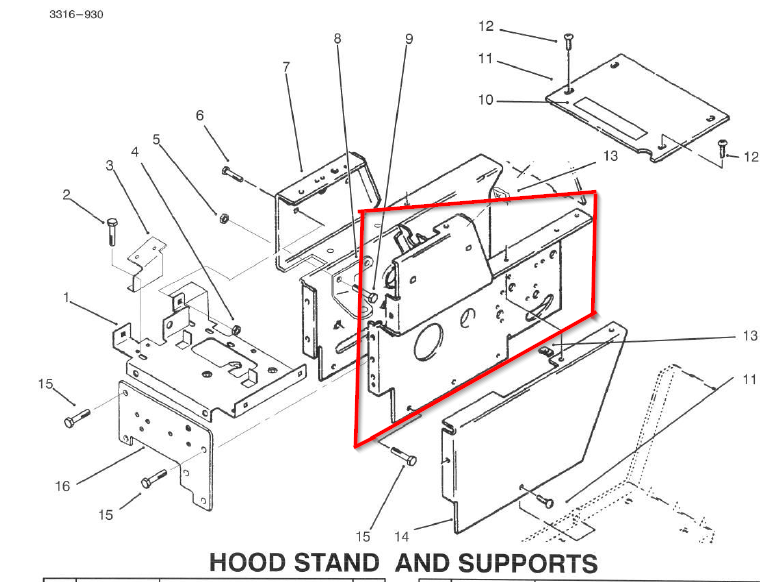

davem1111 2,453 #1 Posted September 19, 2023 I'm curious as to whether this might work. Background: I have a "partial" 417-H tractor, and a bunch of parts from a 520-H. What I'm wondering if it is possible, is using the tower tins, console and hood from the 520-H on the 417-H frame. It seems that the major concern would be the position and angle of the steering column, but also whether there are bolt holes in the right places and if stuff will line up properly. Also, I have a 520-H wiring harness so hooking up the various gauges and ignition switch should not be too challenging. The biggest challenge *might* be getting the steering wheel off the 417, which I haven't tried yet. The hood has the 520 style "cut out" for the console, so I can't use it with the 417 tower/console - that's one large motivation for looking into this. One other consideration is, I have a Kohler 17hp twin, which I believe was rebuilt but is not on the tractor. I should probably mount that on the tractor (or somewhere) and see if it runs before getting too deeply into this, but wanted to see if there were any major reasons not to try pursuing this idea. Thoughts? 2 Share this post Link to post Share on other sites

Lee1977 7,813 #4 Posted September 19, 2023 (edited) I think the frame will not be a problem. The 417-8, 417-A and the 1988, 1989 520-H all have the same frame number 110648.r. Can't go by Toro frame numbers as they changed ever year 1990 and later, but the only difference would be the reduction steering. You will need the upper section of the 520 Hood stand as it's wider. and the upper steering support as it is bolted to the barttery plate the later models with upper controls it's part of the plate. The one shown was made for the bushing but I added the bearing. Edited September 19, 2023 by Lee1977 1 1 Share this post Link to post Share on other sites

Handy Don 17,736 #6 Posted September 19, 2023 (edited) 21 minutes ago, Lee1977 said: the only difference would be the reduction steering. I agree. You might need an extra pair of holes for the reduction assembly at the base of the hoodstand, depending on when the frame for the 417 was made. The steering shaft for the reduction steering is different than for the regular steering (different diameter shaft going into the steering base and different gear angle/tooth count) so maybe you won’t need the 417’s current shaft? If not, cut the shaft and get better access for removing the steering wheel if you need it. Not hard to get another standard steering shaft, if needed. Edited September 19, 2023 by Handy Don 2 1 Share this post Link to post Share on other sites

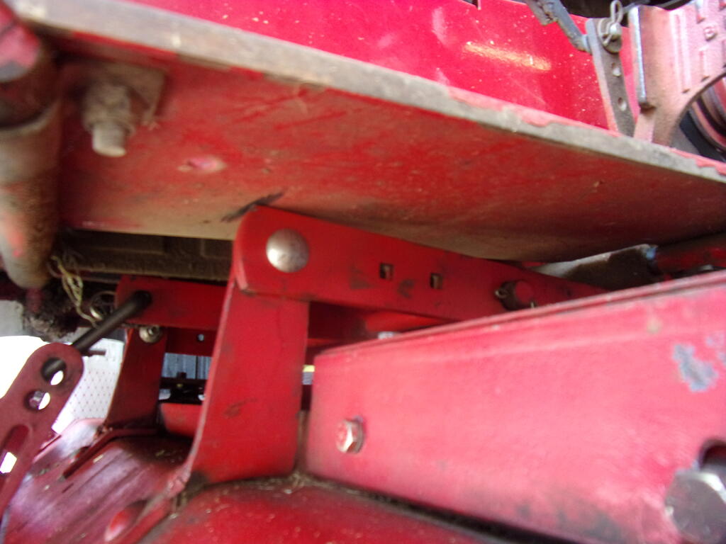

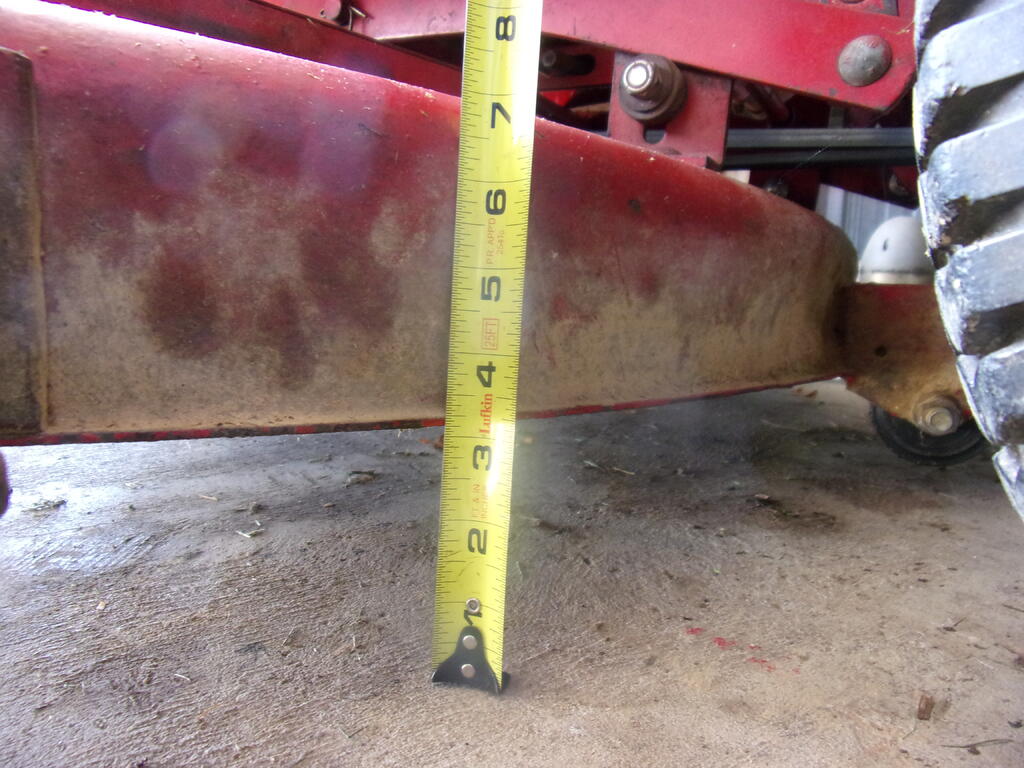

Ed Kennell 47,955 #8 Posted September 19, 2023 (edited) Here's my 417A with 48"SD deck. You could raise the front another inch by lowering the front stop bolt, but I think the rear of the deck would still be limited by the foot rest. The deck frame is up against the foot rests. The rubber bumper has been removed. Edited September 19, 2023 by Ed Kennell 3 1 Share this post Link to post Share on other sites

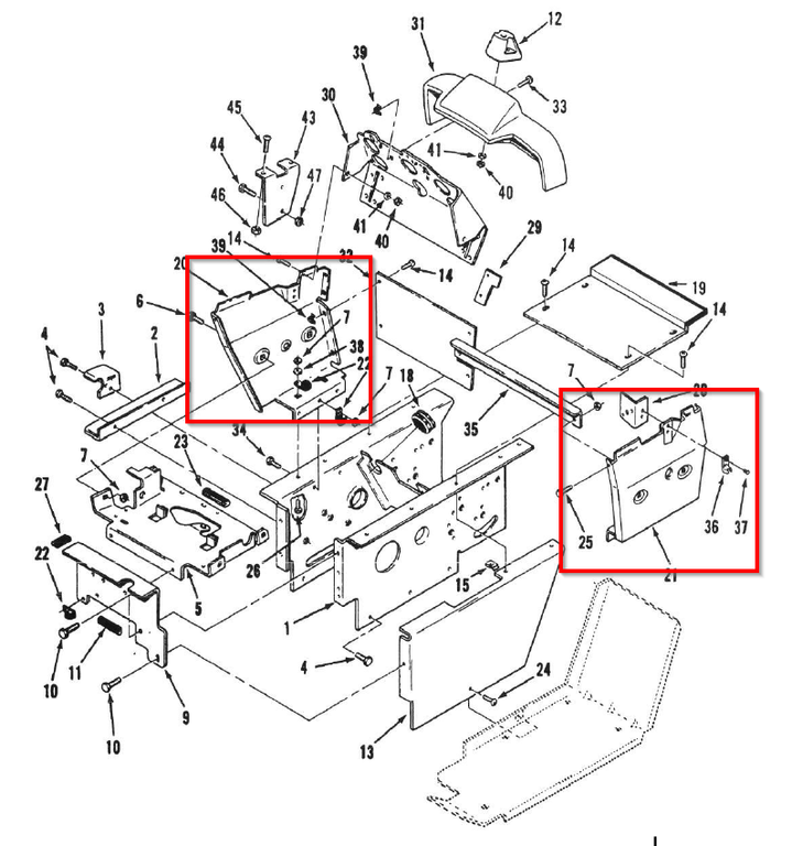

davem1111 2,453 #10 Posted September 23, 2023 I took a little time to look at this tractor and some of the parts, and I see a pretty big challenge with this idea. The 416-H has "one piece" side tins for the hood stand/console mount: However, the 520-H has 2 pieces per side, and I don't have the bottom pieces, only the top. So unless I get the bottom pieces, I'd have to cut off the top half of the existing 416-H tins, drill a bunch of holes to bolt on the 520 tops, and hope that I got everything lined up well enough so the hood would close and look right, as well as mounting the console on it: The other challenge is a common one - I tried to get the steering wheel roll pin out, and it won't budge. I was trying to use a closely sized allen wrench or a bolt to hammer on, and they both bent. I suppose I could buy some proper roll pin drifts/punches but I don't have a warm fuzzy feeling that those would work either. So if I want to pursue this I'm probably looking at cutting the steering column, which I hate to do. My welding skills aren't great, and I suppose I could just buy a new column but am trying to keep the budget as close to $0 as possible, here, working with what I have. Then again, if I stick with the 416-H hood stand tins, I don't have a hood that will fit so I'd have to buy one of those. Duh. Guess I'll have to ponder this for a while. 2 1 Share this post Link to post Share on other sites
ebinmaine 81,283 #11 Posted September 23, 2023 27 minutes ago, davem1111 said: the 520-H has 2 pieces per side, and I don't have the bottom pieces, only the top. So unless I get the bottom pieces That 520H doesn't have them eh? 28 minutes ago, davem1111 said: I tried to get the steering wheel roll pin out, and it won't budge. I was trying to use a Most tasks are easier with the right tool. In this case you really do NEED the correct GOOD quality punches. To remove the pin you'll likely need to "base" the column against the wall or doorway. @JCM has done it successfully. He may have pics. 1 1 Share this post Link to post Share on other sites
Handy Don 17,736 #12 Posted September 23, 2023 1 hour ago, davem1111 said: suppose I could buy some proper roll pin drifts/punches but I don't have a warm fuzzy feeling that those would work either Surprisingly, with good bracing, a few days of penetrant, the right punch, and a firm smack, those pins DO come out! Using a flat-ended tool can mushroom the top of the pin somewhat making the pin harder to remove. 1 hour ago, davem1111 said: side tins for the hood stand/console mount I’ve only worked with the stands from the 500’s. The lower section, #1 in the diagram which i think of as the tunnel, is one piece integrated with cross-bracing welded in. I can tell you the upper sides have to go on in the right sequence or else you find yourself unable to reach places that need a bolt or nut and have to back up. Trying to make a 400 bottom work with 500 tops seems a very dicey proposition. Believe it or not, I HAVE a 500 #1 bottom on a parts tractor that I am trying to unload. See the classifieds and PM me if we should discuss further! 1 1 Share this post Link to post Share on other sites

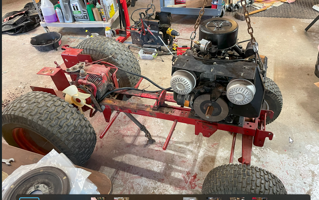

davem1111 2,453 #25 Posted September 24, 2023 Old 417-H tower is off. Steering wheel still embedded in the tower top housing, tried to use a roll pin punch and it is still refusing to move, will probably have to cut the column. Putting the K17 on the frame. Hoping to see if it runs before I get any farther. Do I need anything other than power to the starter and a gasoline IV? Share this post Link to post Share on other sites
