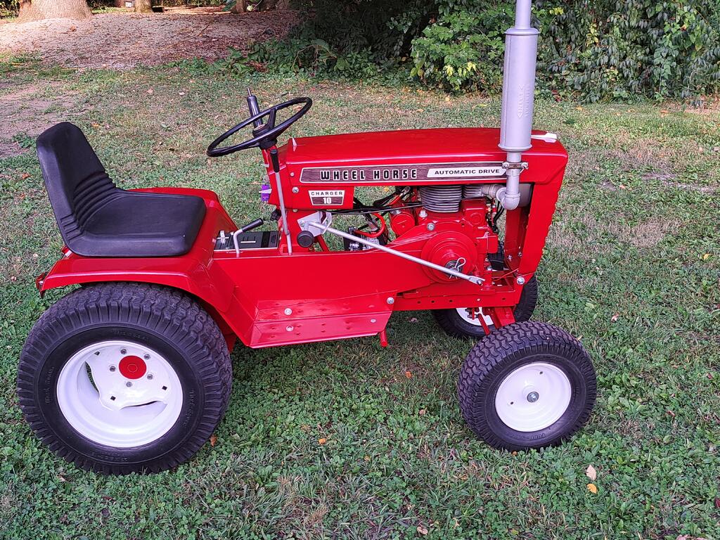

wallfish 20,510 #28 Posted September 20, 2023 Noticed the pulley grooves on the PTO are painted. Not a big deal for attachments on those but if the drive pulley is painted in the groove it may want to grab all the time or suddenly. If you have any issues clutching it or if it pops wheelies, clean the pulley groove. Just an FYI 1 Share this post Link to post Share on other sites
Mike_eash 59 #29 Posted September 20, 2023 7 hours ago, wallfish said: Noticed the pulley grooves on the PTO are painted. Not a big deal for attachments on those but if the drive pulley is painted in the groove it may want to grab all the time or suddenly. If you have any issues clutching it or if it pops wheelies, clean the pulley groove. Just an FYI Thank you yeah it was something I wasn't sure about painting but I figured it couldn't hurt anything. Didn't think about grabbing Share this post Link to post Share on other sites

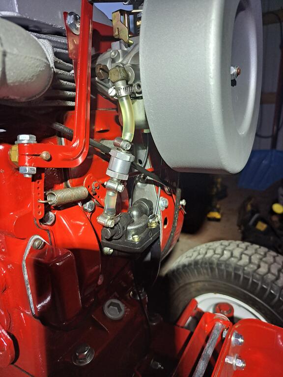

peter lena 10,015 #33 Posted September 21, 2023 @ MIKE-eash , https://www.amazon.com/EVIL-ENERGY-Return-Petrol-Aluminium/dp/B085G7JVSM?th=1 fuel check valve , mount it VERTICALLY just after fuel pump , arrow facing up . that will hold a fuel charge right there for start , very easy , that zinc will enhance the oil , use a measuring cup , think its 2 QZ , PER QT OF OIL , read bottle . been spot on in my engines . experiment with those springs , you want a , soft pull , just enough to assist . lubricated cable , those old engine designs , while very strong , will not stand up to screaming rpm , that added zinc will show itself , in running ease , have it in 5 engines . related throttle / choke arms/ levers , have other holes in them , attach spring . I went to perforated steel , for an easy go to mount point . try a before / after , spring pull effect . super lube cables and all related linkage . also add to governor end shaft points , ensuring free swing , MAKING SENSE ? like doing operational detail , verify as you go . have these and many other , changes on my horses, they work , pete Share this post Link to post Share on other sites
Mike_eash 59 #34 Posted September 21, 2023 6 hours ago, peter lena said: @ MIKE-eash , https://www.amazon.com/EVIL-ENERGY-Return-Petrol-Aluminium/dp/B085G7JVSM?th=1 fuel check valve , mount it VERTICALLY just after fuel pump , arrow facing up . that will hold a fuel charge right there for start , very easy , that zinc will enhance the oil , use a measuring cup , think its 2 QZ , PER QT OF OIL , read bottle . been spot on in my engines . experiment with those springs , you want a , soft pull , just enough to assist . lubricated cable , those old engine designs , while very strong , will not stand up to screaming rpm , that added zinc will show itself , in running ease , have it in 5 engines . related throttle / choke arms/ levers , have other holes in them , attach spring . I went to perforated steel , for an easy go to mount point . try a before / after , spring pull effect . super lube cables and all related linkage . also add to governor end shaft points , ensuring free swing , MAKING SENSE ? like doing operational detail , verify as you go . have these and many other , changes on my horses, they work , pete Thank you I bought the zinc and will be trying a few things you mentioned Thanks I'm always open to new and better ideas Share this post Link to post Share on other sites

pfrederi 21,050 #42 Posted September 24, 2023 15 minutes ago, Mike_eash said: Thanks for the ideas always happy for more I put on check valve plus I put in the zinc .Engine runs great! however I got my wheels back from powder coat First time actually driving it since restoration and I noticed engine surges slightly under load. By under load all I did was go up a hill in my yard probably 45° nothing major which is a little concerning to me that I would get even slight surging I believe my carb settings are good Any thoughts on what it could be?? Thanks again Carb setting are just guides all the old farm tractor manuals say take it out an run it then re adjust to get best [performance 2 Share this post Link to post Share on other sites
Mike_eash 59 #43 Posted September 24, 2023 20 minutes ago, pfrederi said: Carb setting are just guides all the old farm tractor manuals say take it out an run it then re adjust to get best [performance Thanks I will try some readjusting Share this post Link to post Share on other sites
peter lena 10,015 #44 Posted September 24, 2023 @ Mike-eash agree with @pfrederi makes me think you might have a float setting issue , starving for fuel , on a slope ,think you need some tinkering with that. how does it react to a carb cleaner? hand on linkage ? have often used my hand to cover carb intake , and pull fuel thru jetting , while using carb cleaner , also loosen your gas tank cap . might have a vent plugged , starving gas flow . think you are right on the edge of getting some solid run time . might even hook that up to a separate gallon on of treated gas . done that a number of times , separate gas line from jug to carb . get some run time on that , have a fuel filter on that ? also look on line for a carb .run in procedure , pete Share this post Link to post Share on other sites
Mike_eash 59 #45 Posted September 25, 2023 22 minutes ago, peter lena said: @ Mike-eash agree with @pfrederi makes me think you might have a float setting issue , starving for fuel , on a slope ,think you need some tinkering with that. how does it react to a carb cleaner? hand on linkage ? have often used my hand to cover carb intake , and pull fuel thru jetting , while using carb cleaner , also loosen your gas tank cap . might have a vent plugged , starving gas flow . think you are right on the edge of getting some solid run time . might even hook that up to a separate gallon on of treated gas . done that a number of times , separate gas line from jug to carb . get some run time on that , have a fuel filter on that ? also look on line for a carb .run in procedure , pete New carb, New filter , New lines cap has open vent checked! Had flat tire today am going back to tire shop and will tinker with carb settings then see how it runs under load everything else seems to be spot on 1 Share this post Link to post Share on other sites
