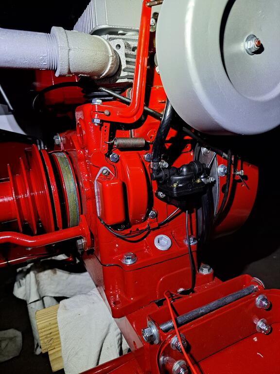

I am trying to get more rpms out of my 10hp kohler. The manual says 3600 I am at 2700rpms
I can get 3600 if manually hold the throttle open .
I have the Governor shaft turned all the way ccw
But the governor always brings it back down. I know there is a way to adjust it
but I'm a little lost
Can someone smarter then me help
Thanks in advance

Agreed - moving the spring ends up or down the levers changes the top RPM. Don't overdo it - 3550 with the normal load - mower deck engaged, snowblower engaged is ALL you want.
  • Like 1
ineedanother
Agreed. If you are confident with your carb adjustments my next step would be to move the spring down one hole on the governor arm (left side of your pic) and see what you get. If needed, I would go to the bottom hole.
I would always confirm good carb adjustments before tinkering with linkages though but that's my routine...

Changing the spring holes affects how responsive the governor is. I would not change that given your description.
You need to add a bit more tension to the spring so what you need to change is whatever is limiting the throttle travel.

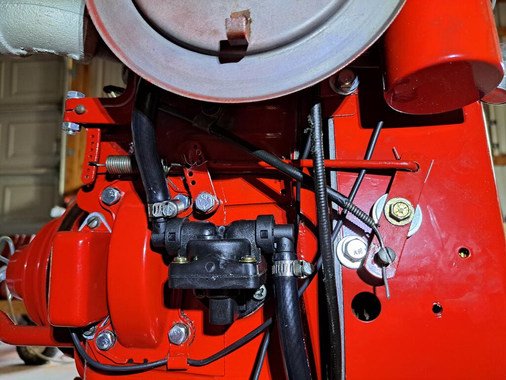

Ed Kennell
19 minutes ago, ineedanother said:
This is assuming that adjusting your throttle cable won't give you more tension on that spring which is what it looks like you need.
                                             :text-yeahthat:   It looks like you need to loosen that throttle cable wire and sheath .  And then set it to get full throttle range without a kink in the wire.
  • Like 1
Howie
Yeah, I think removing some of that conduit would do wonders. Most of mine have about twice that
in inner wire sticking out there. You are not getting the movement of the linkage to get enough tension
on the governor spring.

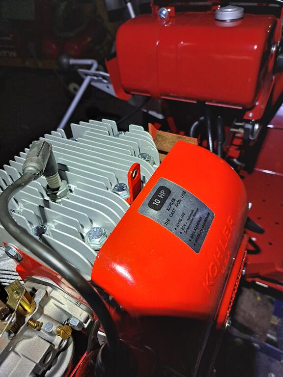

Thanks for the picture I know where my high speed stop is. But before you laugh remember I'm a newbie and this is where it was when I bought the wheelhorse. I always wondered why it was there 😅

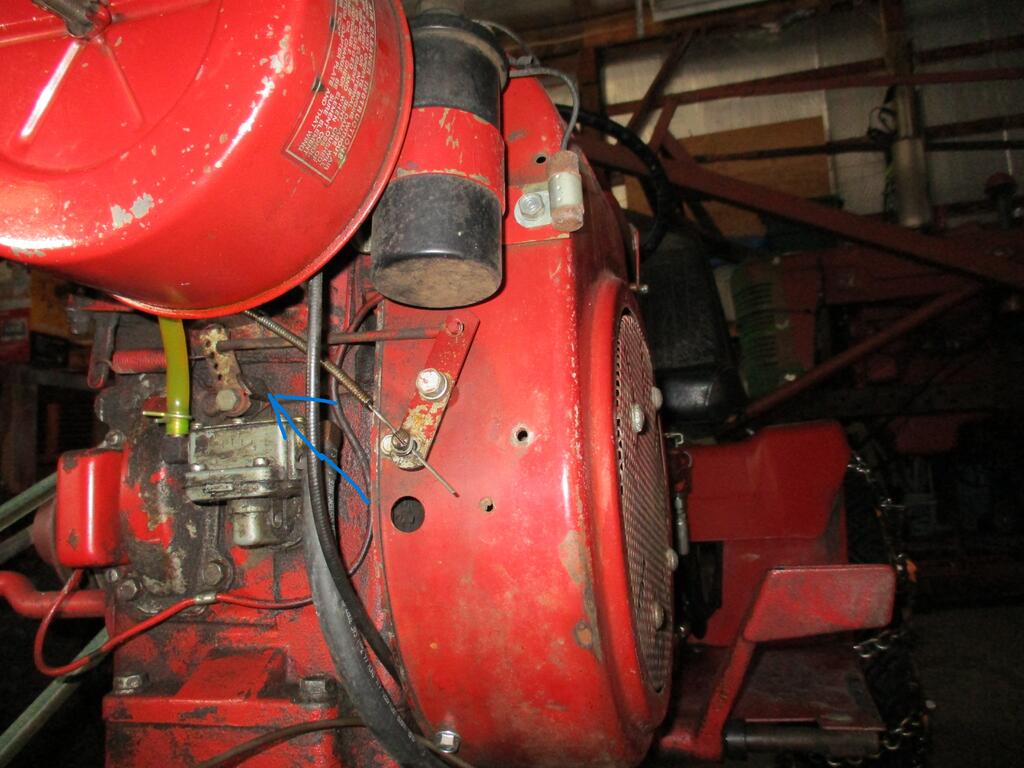

Ed Kennell
Well, that is the engine lift lug.  Will it work for a high speed stop...maybe?
Ed Kennell
Again, look at the picture of Pauls throttle wire.     Readjust yours so it has a straight pull on the throttle lever.
  • Like 1

wallfish
Throttle lever all the way to full. Loosen the clamp that holds the throttle cable conduit on.It's under the carb on your engine.  Start the engine and now pull that conduit back through the clamp until the high RPM is achieved. Lock the clamp holding the conduit. Viola, your done
This will also limit the high RPM at that setting as you can't move the throttle any farther than all the way
You can do it in steps without the engine running but it takes much longer. With the engine running, it's incorporating the spring tension of the governor.

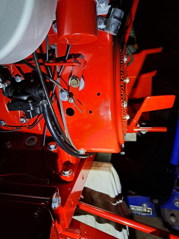

Thanks I like your idea! My rpms are now to high but I am understanding how this works now I believe I can get now
Thanks again everybody!!

Mike_eash
15 minutes ago, wallfish said:
:handgestures-thumbup: Yup, now slide that conduit back towards that lever where the cable connects.
Or, Did you change spring holes in the arms?  It was a little tight on the cable length between the end of the conduit and the connection but typically if it doesn't limit the movent then it's ok
I just did it exactly how you told me too!!
I'm at 3520rpms and I'm leaving it right there
  • Like 2

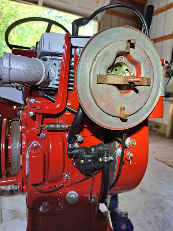

Mike_eash
Here are some pics of my adjustments
3520 rpms
But now I'm wondering if I need that high speed stop. It bothers me a little now that I know I'm supposed to have one. Ignorance truly is bliss sometimes 🤣🤣🤣
