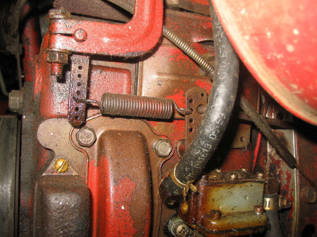

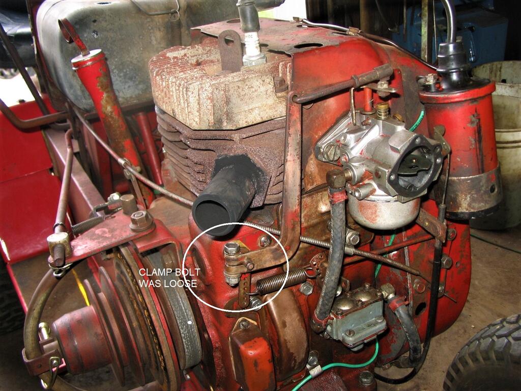

daveoman1966 3,884 #11 Posted September 8, 2023 As stated, I have two C-160 Auto with exact same K341s engine. I removed the air filter(s) and all the carb/gov/throttle/choke linkages are hooked up EXACTLY the same. (I've also put 'rebuild' kit in each carb.) So..... NEXT.. How does one go about SETTING THE GOVERNOR??? I can see that a P.O. has messed with it... but how do I get it RIGHT?? ps...image 2462 is good. image 2477 REVS. Share this post Link to post Share on other sites

ineedanother 2,885 #15 Posted September 9, 2023 (edited) Hey Dave, since you said that the PO has messed with the governor, I suspect that the one in question is the top pic. Pretty easy. Loosen the governor arm. Clamp a set of vise grips on the shaft so the weight of the grips rotates the shaft counter-clockwise. Push the throttle linkage to the left (to the idle position, which rotates the arm on the governor shaft) Tighten the arm on the shaft (do not overtighten as to "stretch" the clamping end of the arm). Done. Edited September 9, 2023 by ineedanother 1 Share this post Link to post Share on other sites

daveoman1966 3,884 #17 Posted September 10, 2023 HOORAY FOR ME.... I WON. Finally, I was rewarded with a SIMPLE solution to the K341 engine rev issue: The Clamp on the Governor arm was NOT tightened to the Gov Rod...just loosely fit by P.O. Reset the Gov arm as per 'INEEDANOTHER' above, clamped it tight in position and PRESTO...no more over-rev. YEAHHHHH. Thanx y'all... 3 3 1 Share this post Link to post Share on other sites
