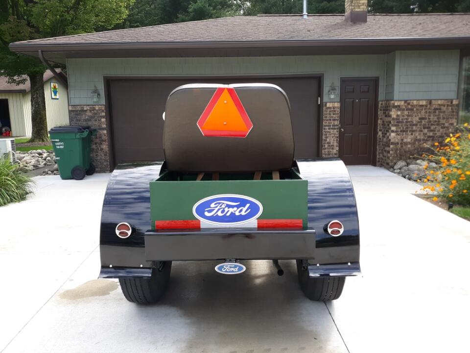

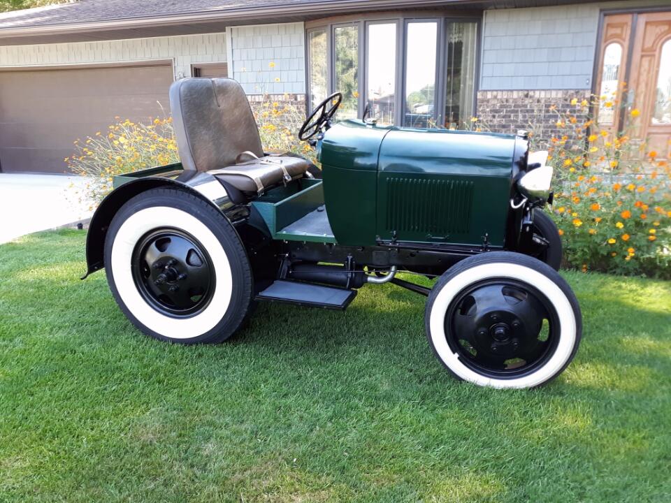

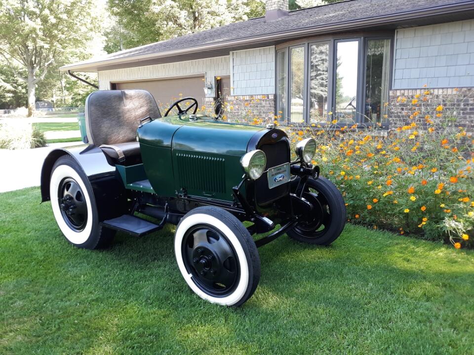

Rob J. 1,945 #1 Posted August 24, 2023 I recently picked up a new to me tractor and the gentleman I bought it from has one of these. It’s not something you see very often. From what I understand these were kits to convert a tractor into a car/truck. I need to find more info. How cool is that? 4 9 Share this post Link to post Share on other sites
Rob J. 1,945 #2 Posted August 24, 2023 Well it’s actually a 1929 1/2. Share this post Link to post Share on other sites
WHX?? 58,388 #3 Posted August 24, 2023 That one looks nicely done. Usually their all ratty. Be a show show cruiser fer sure. @wallfish 4 Share this post Link to post Share on other sites

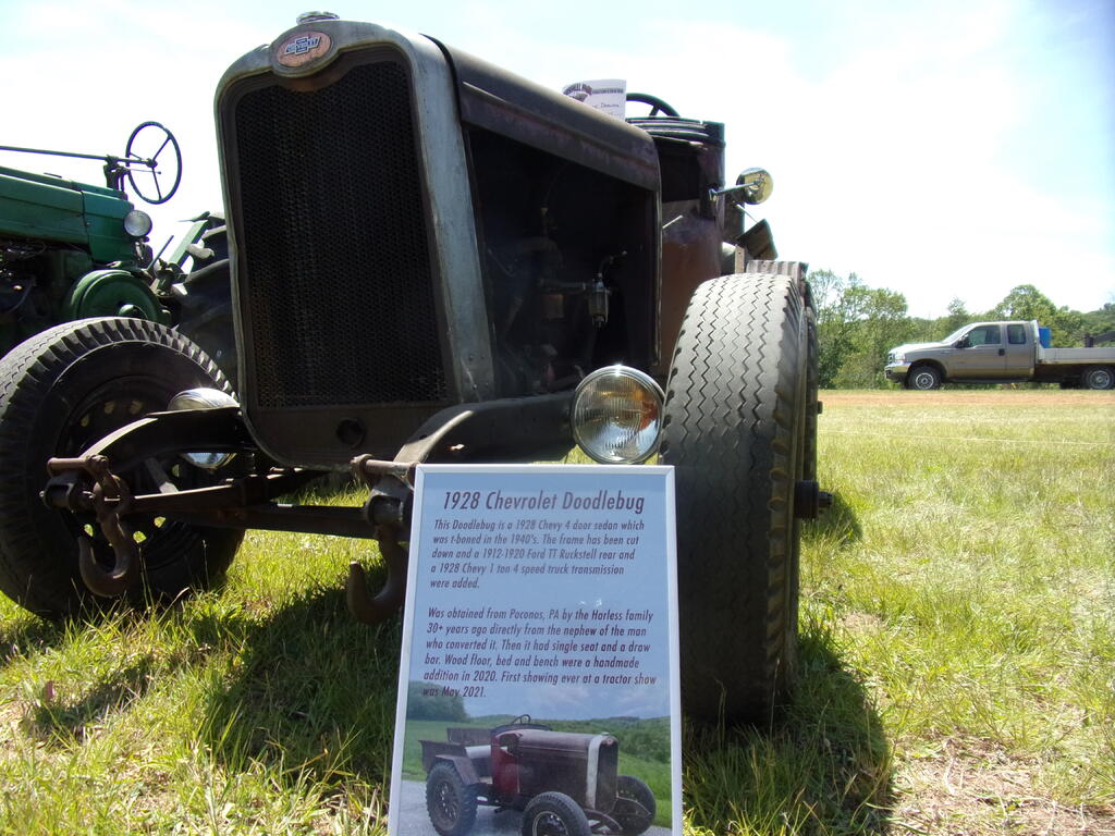

Ed Kennell 47,956 #5 Posted August 24, 2023 Lots of Model A Ford doddlebug tractors in my area. They usually have a second transmission in series or a Ruxell 2 speed rear to supply lower gearing. Most were built in the 1940s when new tractors were not available due to the war. This is the first parade queen iI have seen. Beautiful work. Here's a local one made from a Chevy body. 4 3 Share this post Link to post Share on other sites

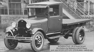

Darrenw85 764 #6 Posted August 24, 2023 (edited) Here's one I seen at a local show. Edited August 24, 2023 by Darrenw85 Updated image 1 1 2 Share this post Link to post Share on other sites
